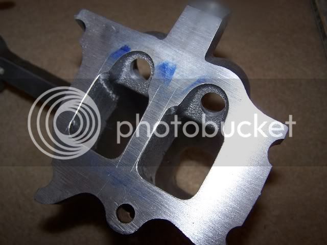

I think the shaped inlet ports are only found on the 3F-E head as thats where the injectors sit when the injection rail is bolted up. If I understand you correctly.
Hard to see in this pic but the injection rail seen at the bottom of the photo matches the inlet ports

You can see on the second photo on this page that their is some slight machine work to the kidney to accomadate the exhaust port better.

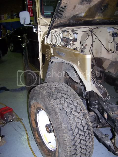

While I was under the hood today observing the dribble of brake fluid down my booster, it made me wonder if the intake on the 3FE set up will clear it. I have seen a lot of posts on that subject. Does the booster need replacement with the mini-truck unit to provide clearance? It looks like a tight fit there.
I belive your correct from what I have reading but:grinpimp:
I drive on the other side of the road so my brake booster is opposite to your US ones.

Hard to say what porting and polishing gains for the flow as the valves were done at the same time, it all certainaly helps. Porting was matched to the manifold gasket I belive, If you look closely at the photos you can see the lines that the ports were opened up to. Pic 4 I think marked on the head.

Here's a photo of the intake maiifold which has been ported to match the head, the hole at the top of th port is where the injector sits.
