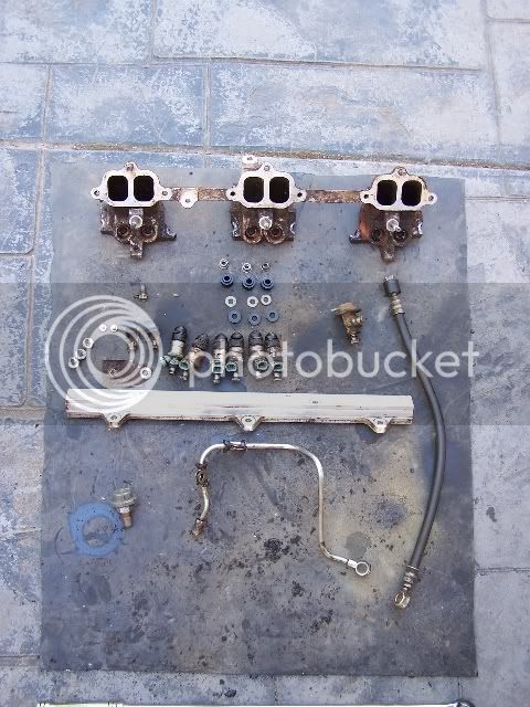

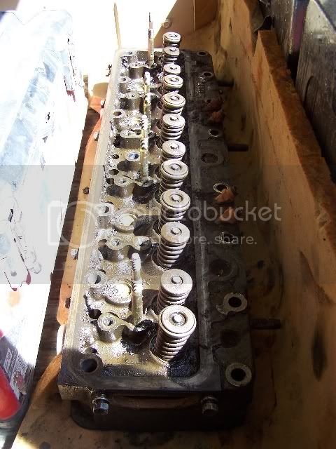

Anyway stripped the head down inlet manifold and exhaust. Would have been nice if the unit was all in one peice but cant grumble at the price. the EFI had been removed and all the vacume lines pulled plus a few other bits. Will have fun putting it back together
But on the whole the head looks good no black oily cylinders either.
The head will make a trip to work for a good clean up in our industrial tool washing machine :idea:
Just need to score a 2F head gasket to check that all is as it should be compared to the 3F-E one. Every one says it matches but no way I'm shelling large out to find out it has issues

Well the the head is SPANKIN and off the the engine builders on Monday.
The injection rail came up well too, just have to sort out what injectors we are to use to suit the Turbo

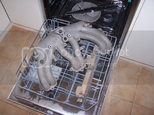

Before
After

Oh yes the heads all good no cracks :cool:
Check your sig line on that last picture..... I bet she's complaining now! Nice dishwasher...
