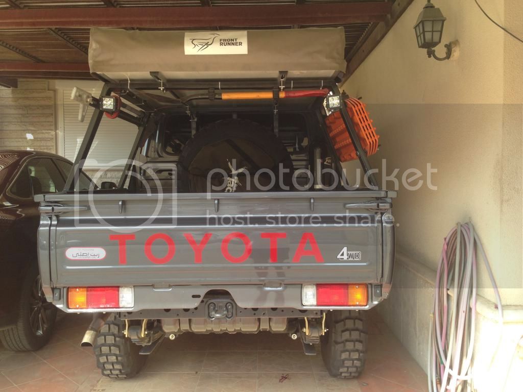

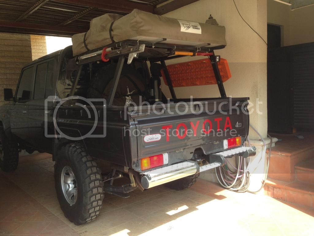

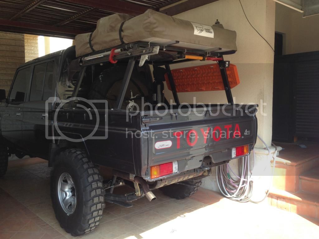

The OEM rear bumper on the 70 series pickups are softer than a pillow. Standing on it alone is enough to cause to bend. Aside from the softness, you could also not use a Hi-Lift jack due to the cylindrical shape of the bumper, with no secure mounting points.
So out came the bumper.
It looks a lot cleaner like this, but again no Hi-Lift mounting points, and obviously very exposed in case of getting rear ended, or climbing up a steep incline.

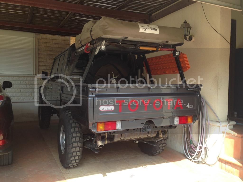

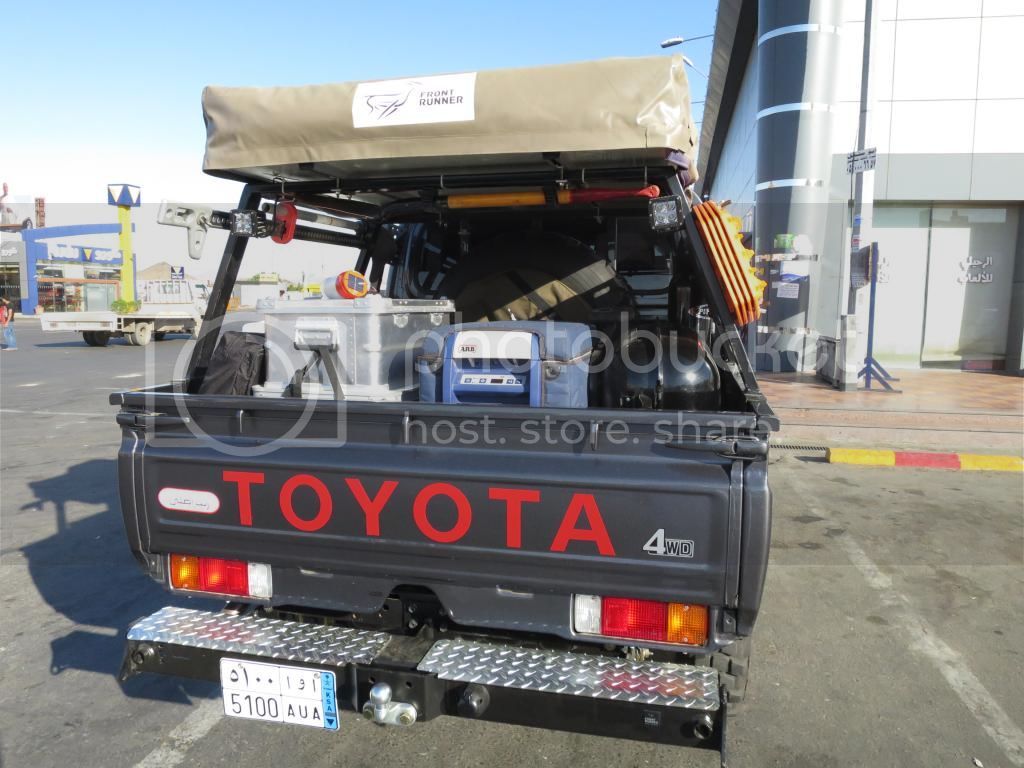

I had a Front Runner rear bumper shipped in from Dubai. It sits a bit lower than I had hoped for, but its sturdy as hell. Its not a proper towing system, yet is rated for up 2000kg towing.

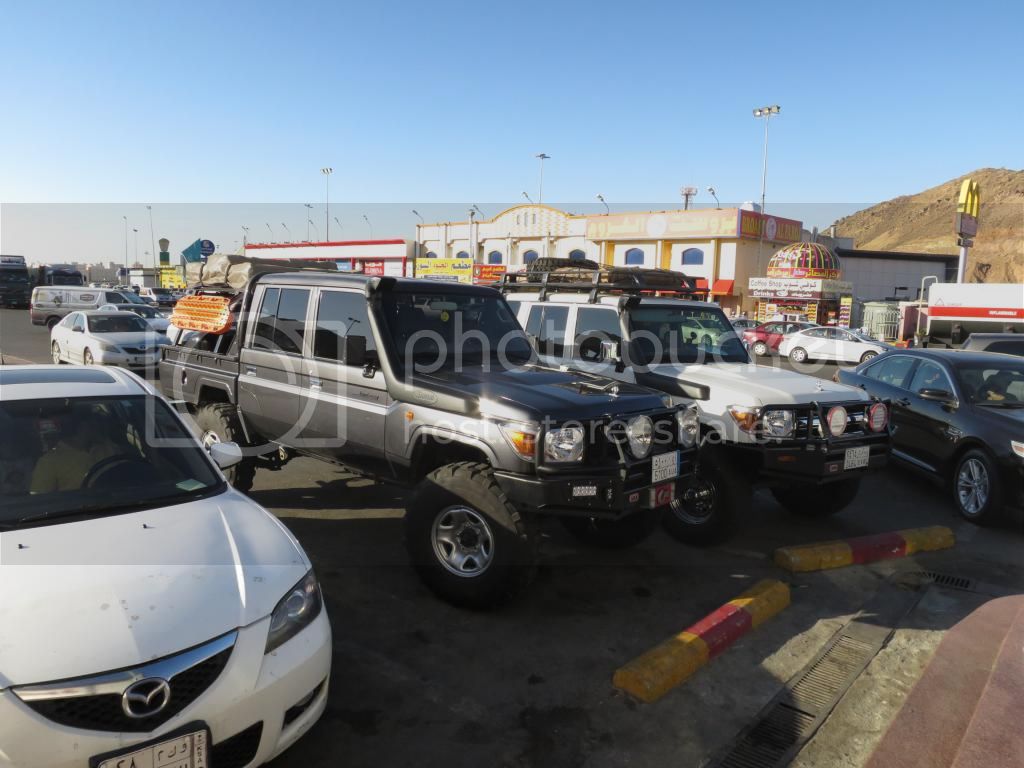

Then we set out a couple of weeks ago on a trip that was long overdue. This is Tito's nicely equipped GRJ76

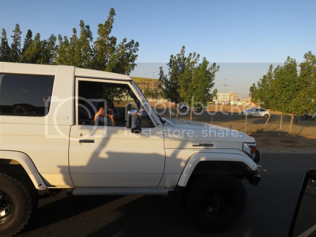

@safir joined us with his son in their 2006 FZJ74, running a 2" OME with 285/75/16 BFG and a rear ARB locker.

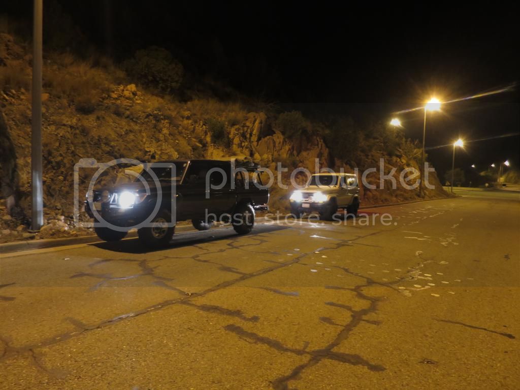

We went up a mountain pass around the back of Makkah, which is still being paved, so technically still not an open road.

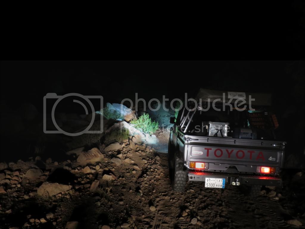

It was devoid of any vehicles, was pitch black, and had no guard rails. We climbed from sea level to about 7500ft in 26kms. Once at the top, we veered off a side road to get to the trail head. We're really in the boondocks, and you feel it late at night in the quiet twisty mountain roads.
At the start of the trail.

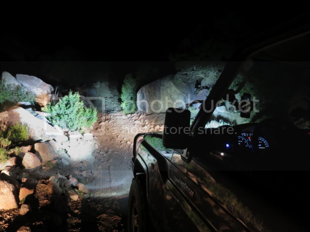

Nothing beats wheeling at night. You know no one else is on the trail. The air is crisp. The stars are out. There are no sounds but the clatter of the diesel motor. This is what we dream of when you have a moment to yourself.
Could not get many pictures of the trail up to the camp site, as I was navigating, we were late, and I was nervous the other two would not make it as the trail was steep, and off camber in several places. With the kid in Safir's 74, at certain times I thought he'd tell me he's turning back as its too hairy. Luckily he didn't and we made it to the top.

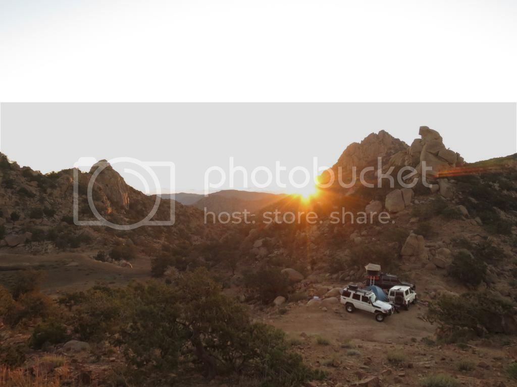

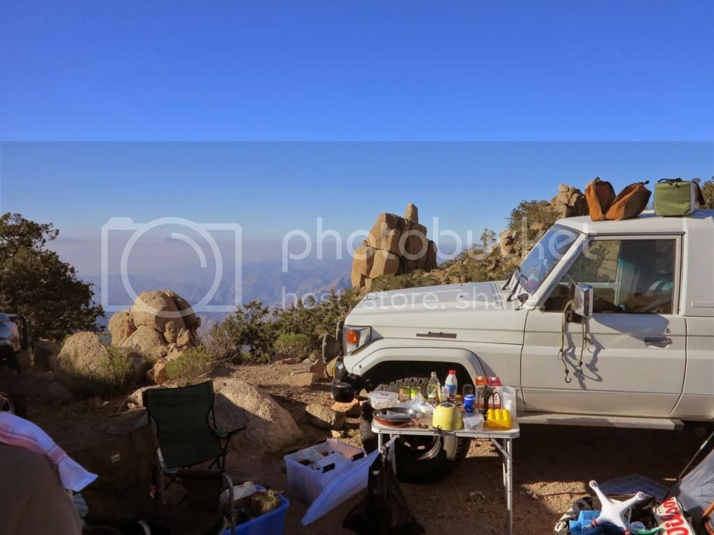

After a cold nights sleep at 8100ft, we are greeted with a clear sky, and magnificent sunrise
The view from my tent.

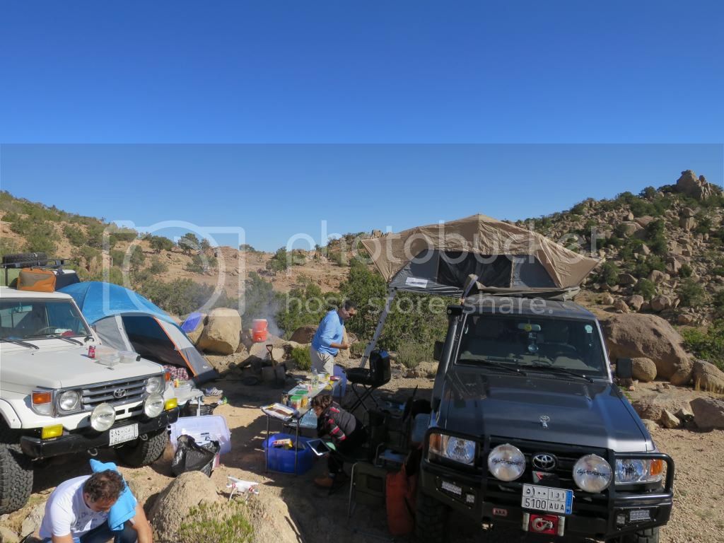

The penthouse
Breakfast prep with a view
Saf back where he belongs, in the kitchen
The most important meal of the day
The valley down below, looking out west
The area surrounding the campsite

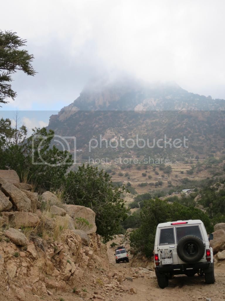

After breaking camp, we start to make our way down as the fog rolls in

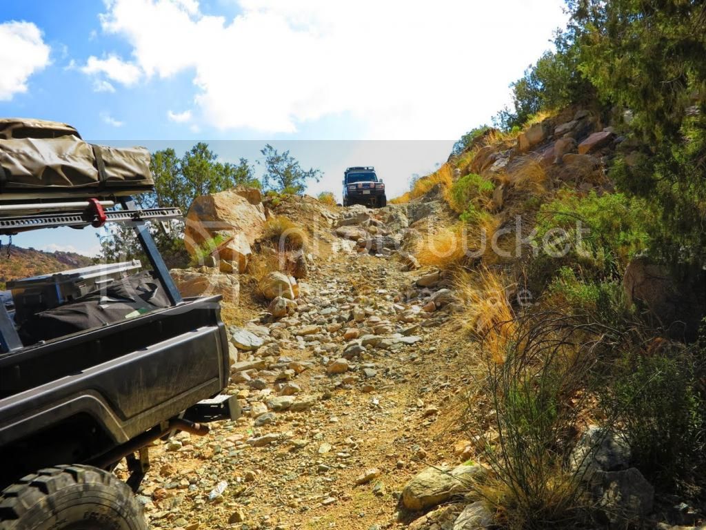

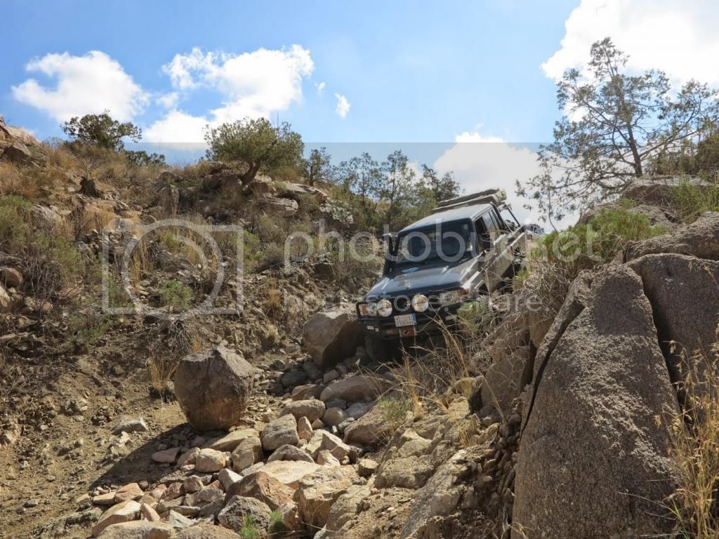

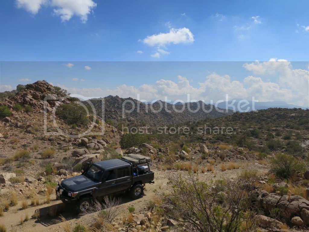

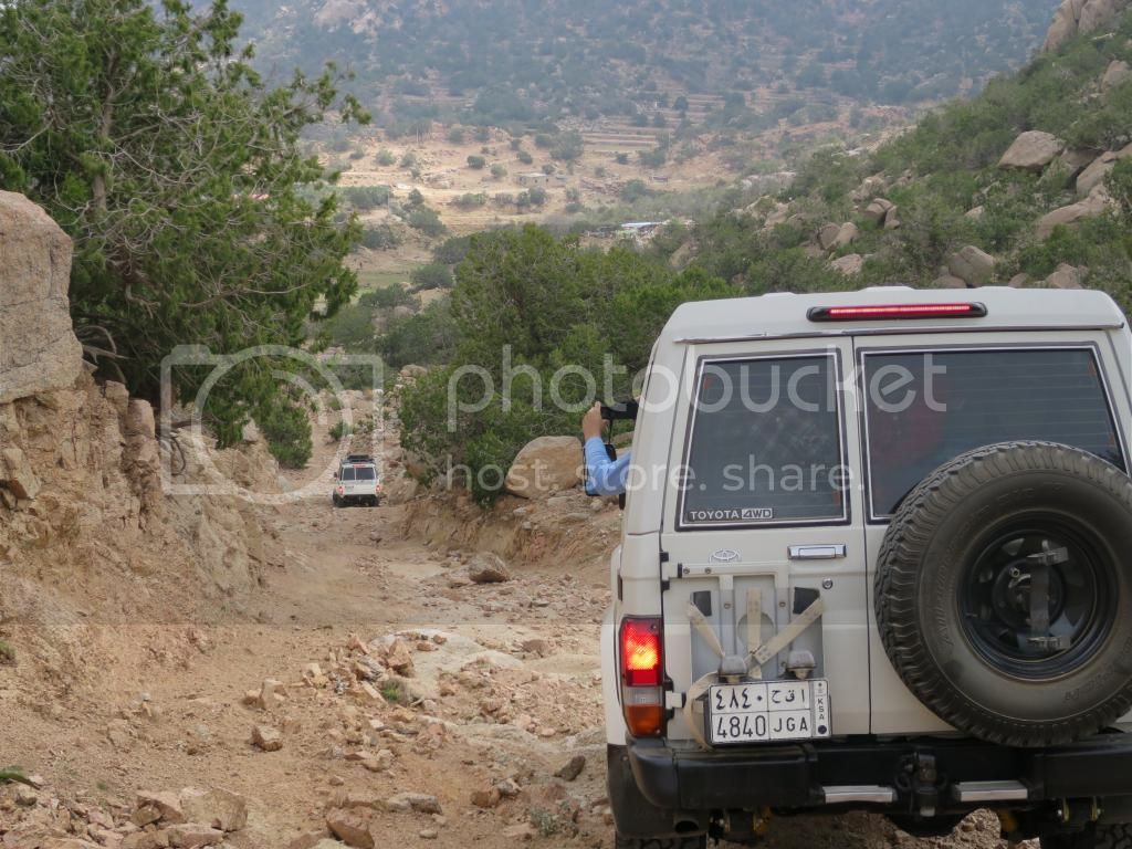

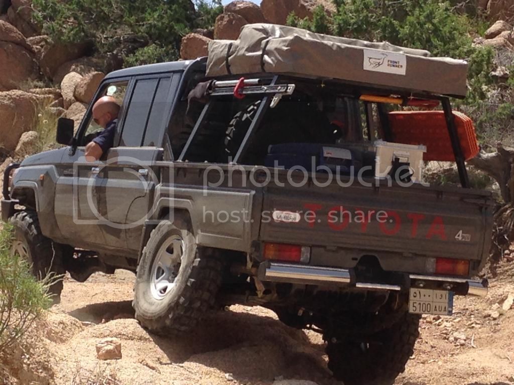

We had numerous trails mapped out, and after bumping into a local who lived there, who told us the section we're on is impassable, with nothing but time, we decided to ignore him and try to see for ourselves.
Some sections had fallen boulders, loose rock, and deep rutted tracks. We made it through, but not without a few sweaty palms

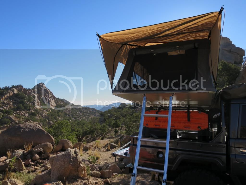

- I wanted to run a roof top tent without putting it high on the roof. The tent can be run above the bed of the DC while still being within the same height as the cab, thus keeping center of gravity lower.
