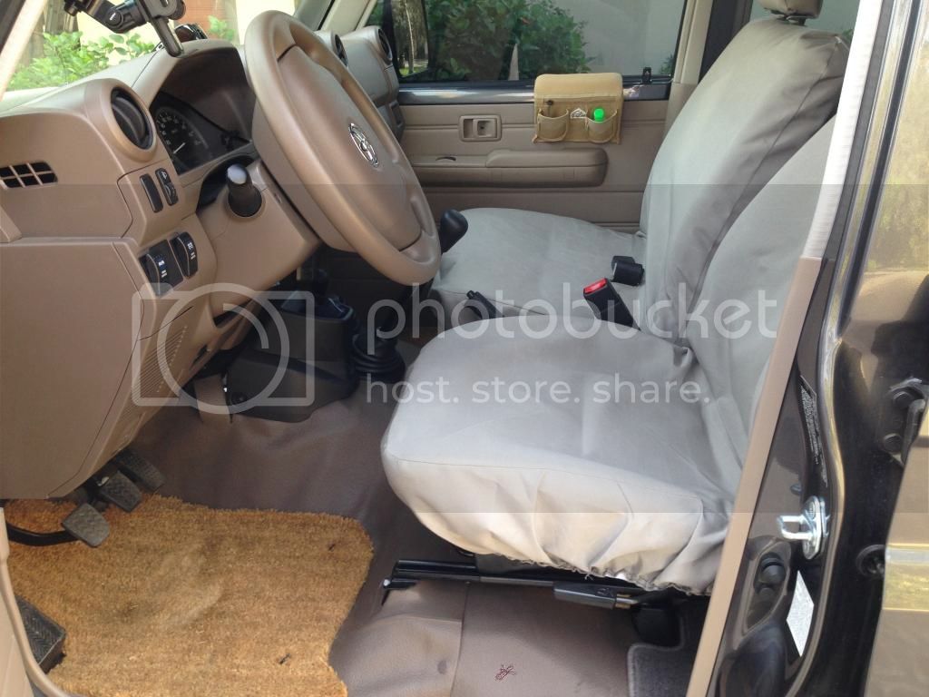

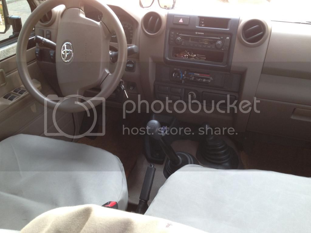

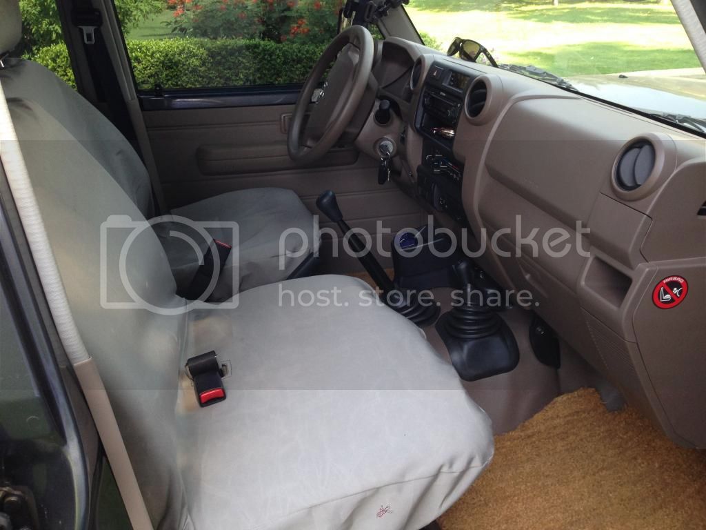

Would love to see the interior.

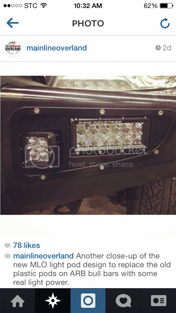

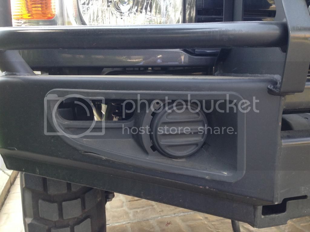

Next up I stumbled on this cool image on instagram of a shop out in the East Coast of the US that makes a very functional solution for the useless ARB bumper spot light location.

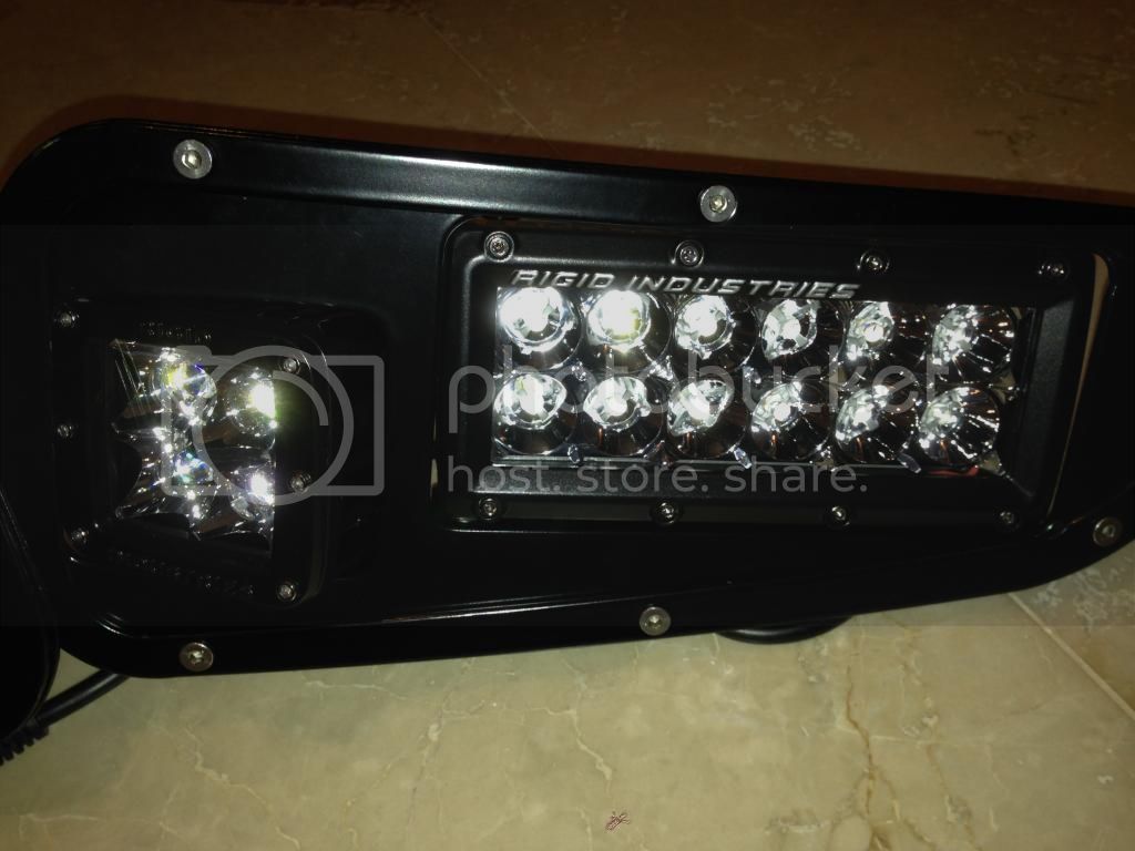

This is the image I found, and after getting in touch with Matt at Main Line Overland, who was super helpful, within two weeks the light pods were shipped.

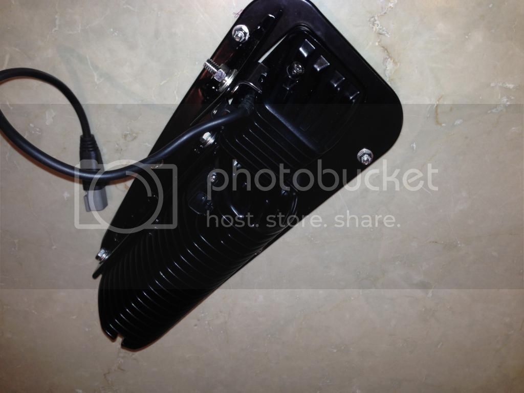

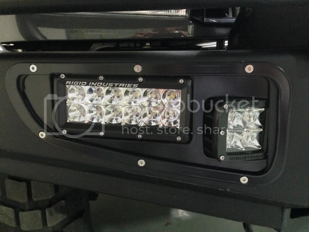

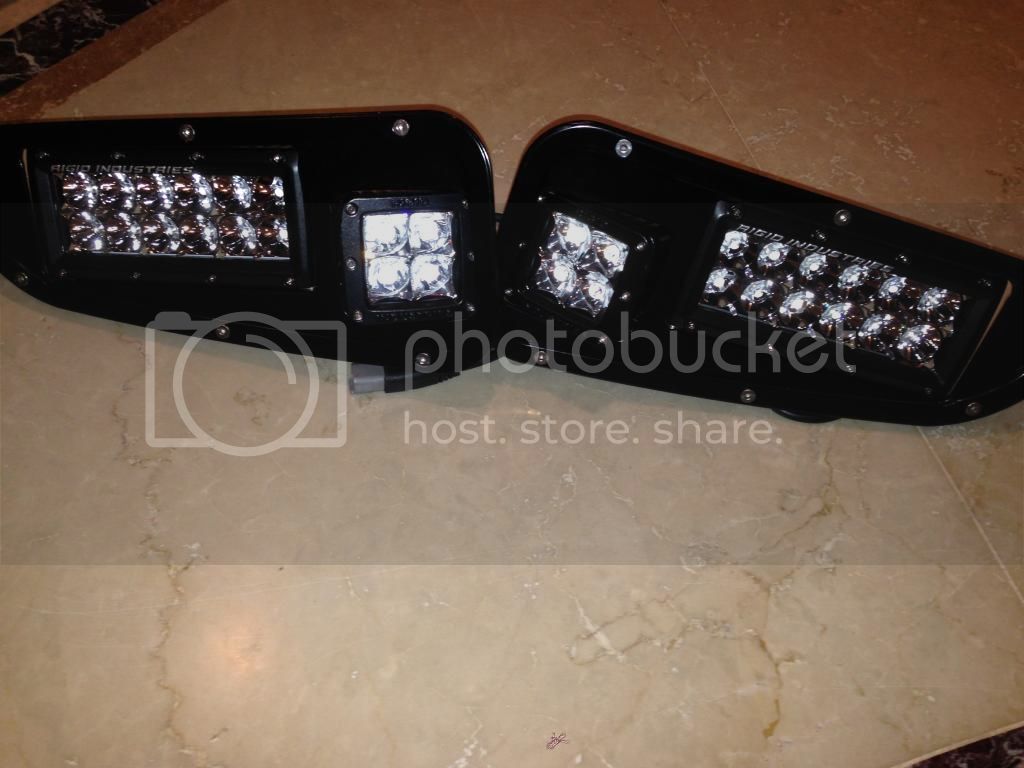

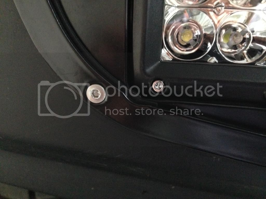

The pods as they arrived.
Everything comes assembled and ready to be bolted on
The quality is outstanding
The fit was perfect, and installation was a breeze. Just mount the pod, drill the holes and voila
They're a standardized item that fit all the ARB bumper slots.

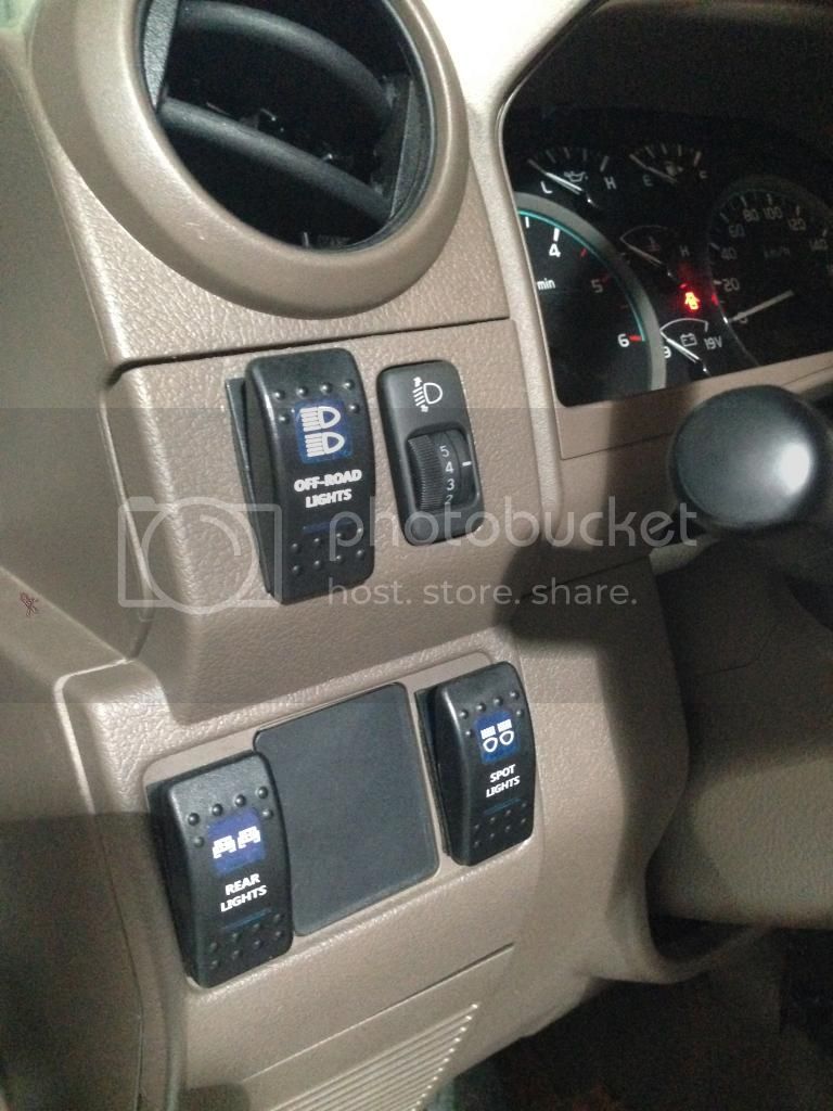

The switches for the spots, the light pods, and the rear camp site lights.

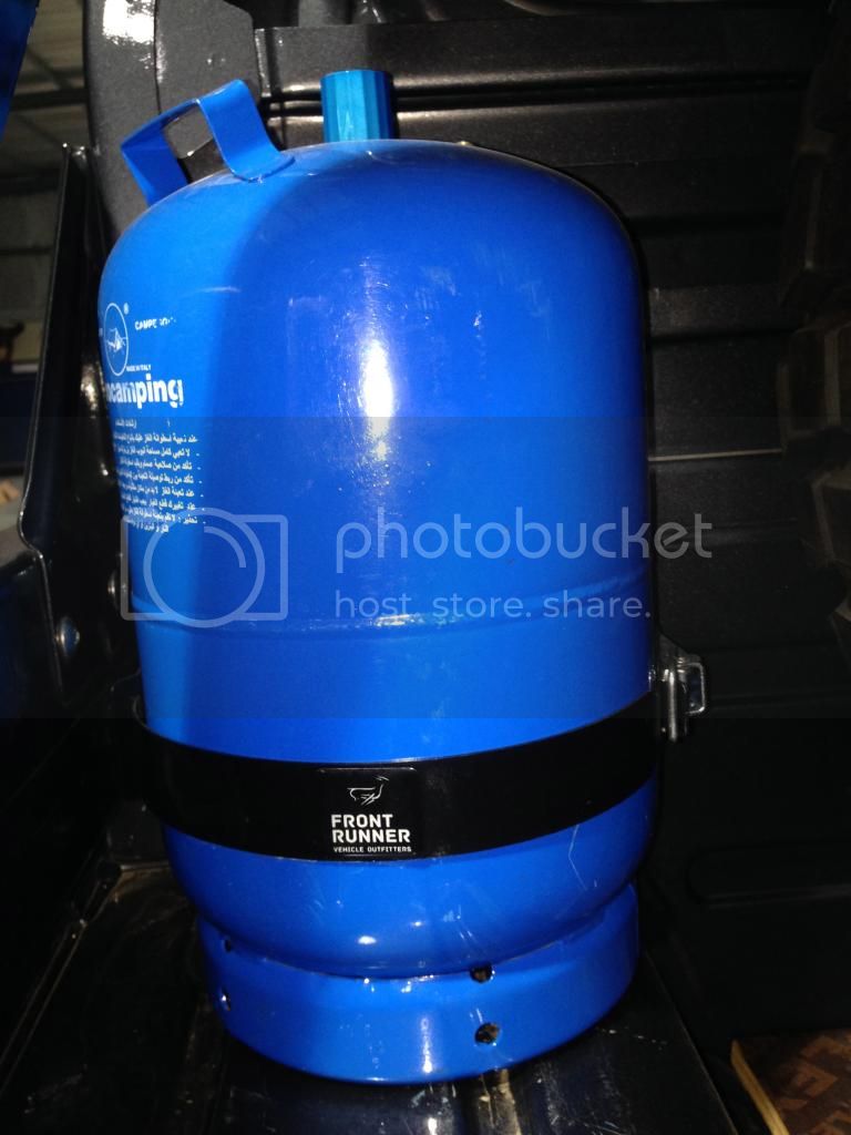

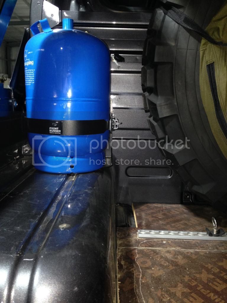

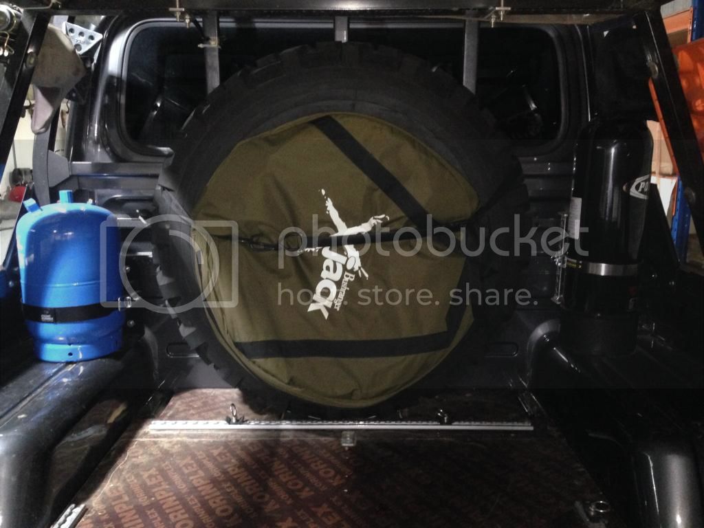

Next up I mounted a propane canister using the Front Runner canister clamp

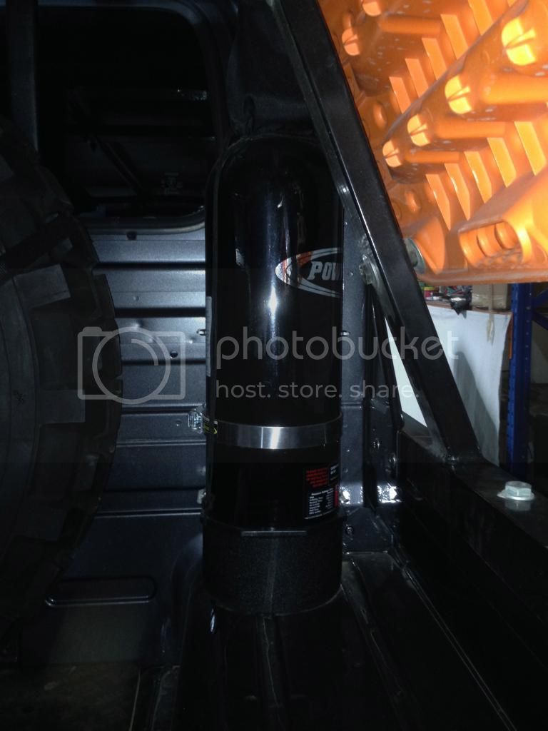

The Powertank mounted at the other end
The rear set up

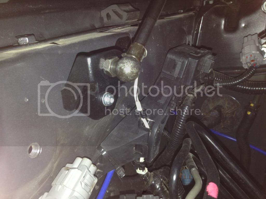

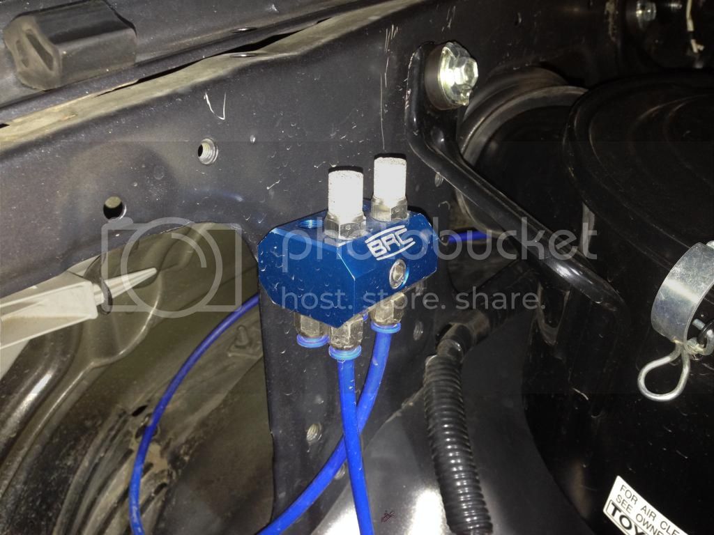

I also routed both diff breathers to the engine bay

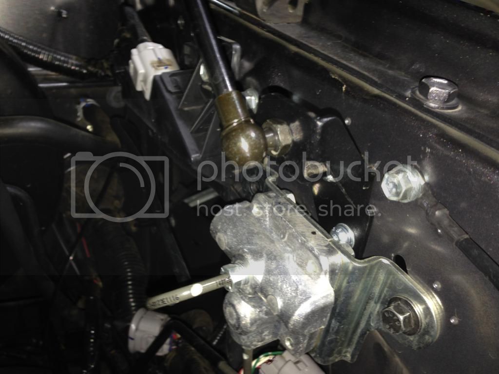

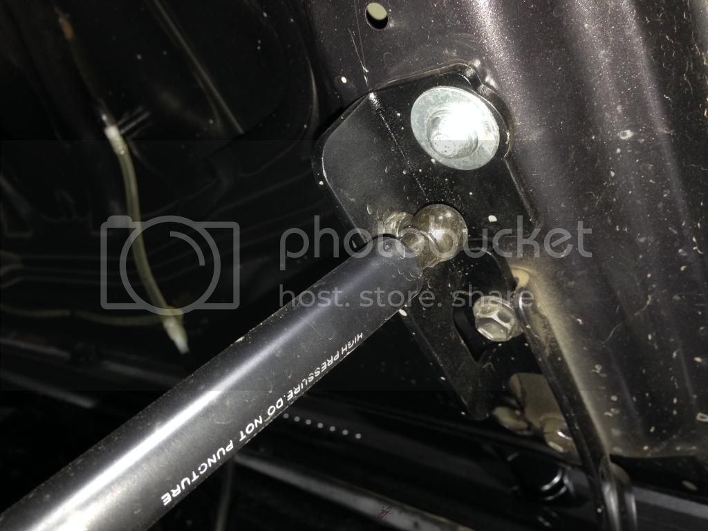

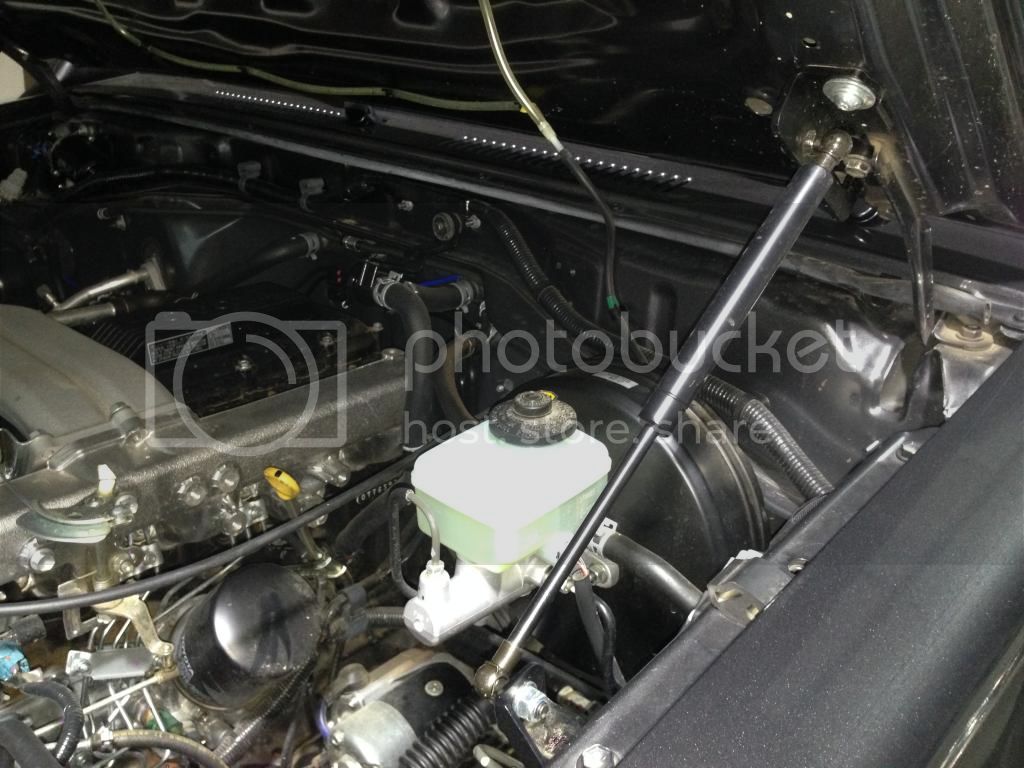

And last but not least, I ordered a set of bonnets struts as the 70 series do not come with any. The bolts all line up in original factory bolt holes that are unused in the engine bay, except one bolt hole that needs to be drilled on the underside of the bonnet.
The top bolt is in a newly drilled location, while the bottom one can be seen as part of a two bolt bracket that normally holds the bonnet hinge.

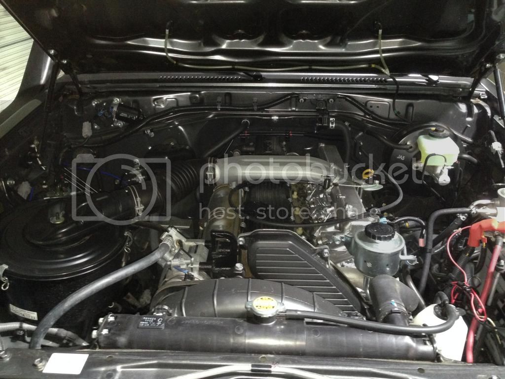

A shot of the N/A 1HZ motor

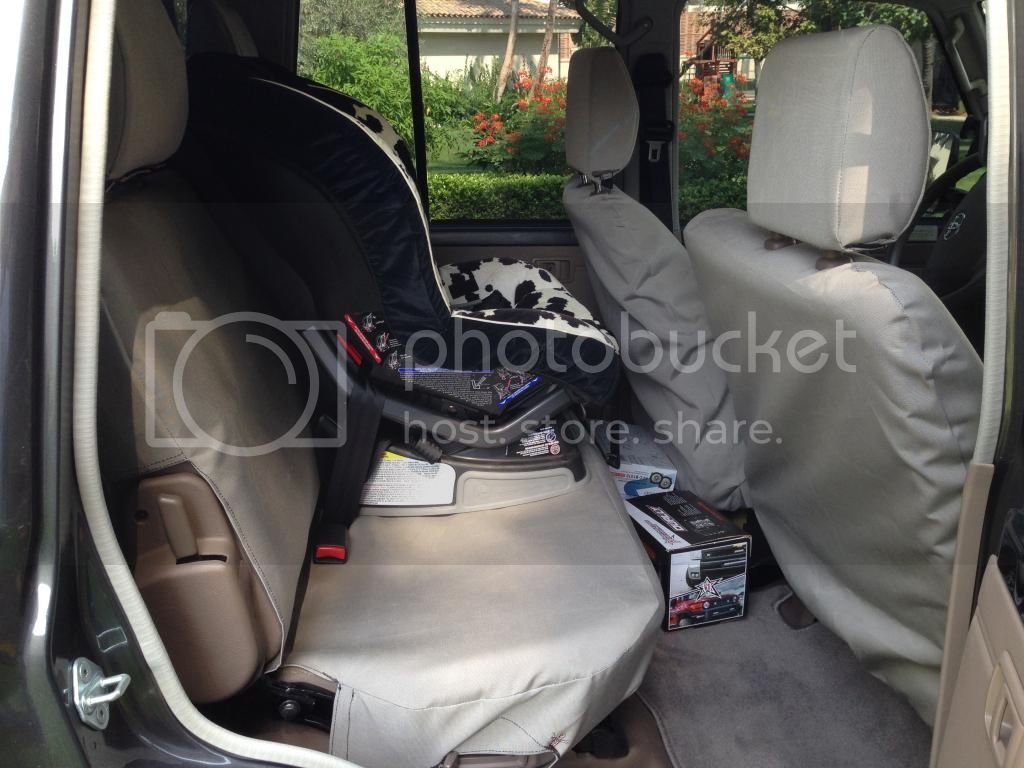

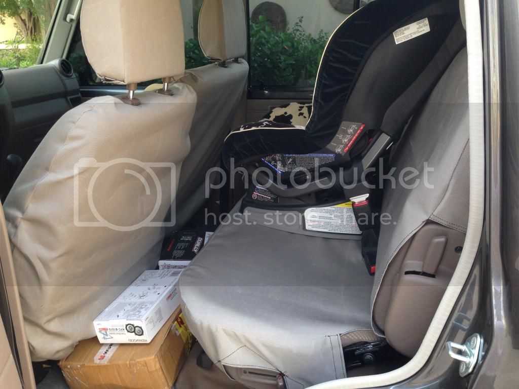

Thank you. These were locally made by a shop that makes sails, tarps, and covers with fabric available in their store. The guy comes and measures the seats, brings a bunch of colour samples, and tailors them to fit. Super quality work and very durable.
