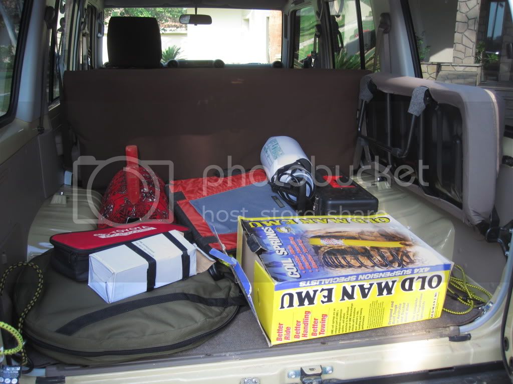

I picked up a 2” OME lift kit, without the shocks as I already had the EFS shocks

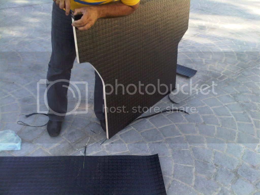

Went down to Ikea and picked up a couple of door mats. I cut out a template of the factory OEM carpet and then cut down the mats to fit. They’re perfect for holding down the sand.

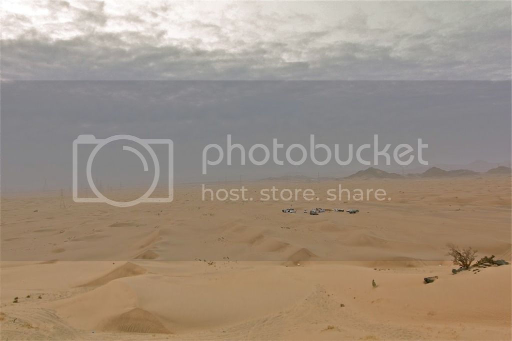

Took the wagon out wheeling several times, with one day being particularly memorable when on a rare occasion for us desert dwellers it had rained, poured actually. Made for a great afternoon out with the lads.

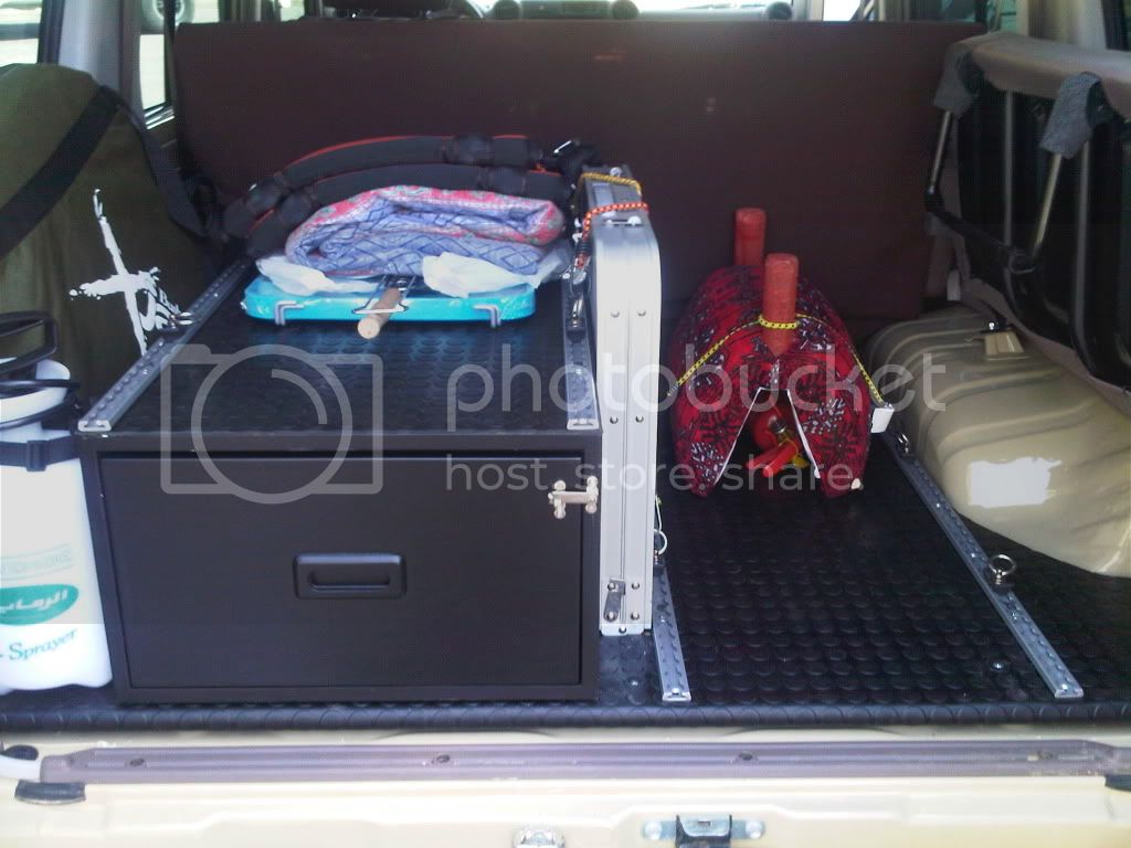

We then had a storage platform, along with one drawer made, and a drop down table drilled into the rear barn door.

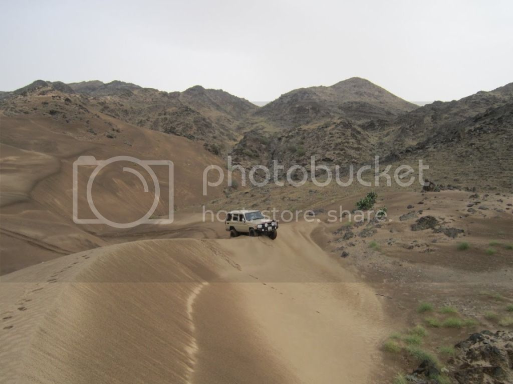

Slapped on the new rubber, and off we were to test them. That year we’d had another douse of rain (climate change at its best), so we were off to the desert again straight after work.

Awesome truck and good story; thanks! One of your pictures is my new desktop background.
It is strange to see water in the desert like that! I don't think I've ever seen pictures with water between dunes!

Then on a trip down some washboard tracks I hit a large bump, and the bottom of the storage drawer exploded, and all the contents came out. Turns out it was never built sturdy enough. Threw all the contents into a plastic container box for now, and tied it down with bungee cords. My latest goody, and probably my favorite is the ARB fridge. Here its packed and ready for a nice large family style trip we did earlier this year.

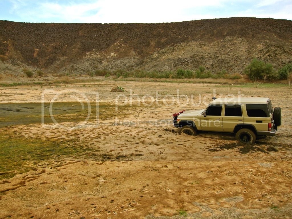

And another trip to Wadi Rabigh, near a newly built dam. Lots of water and mud here.
