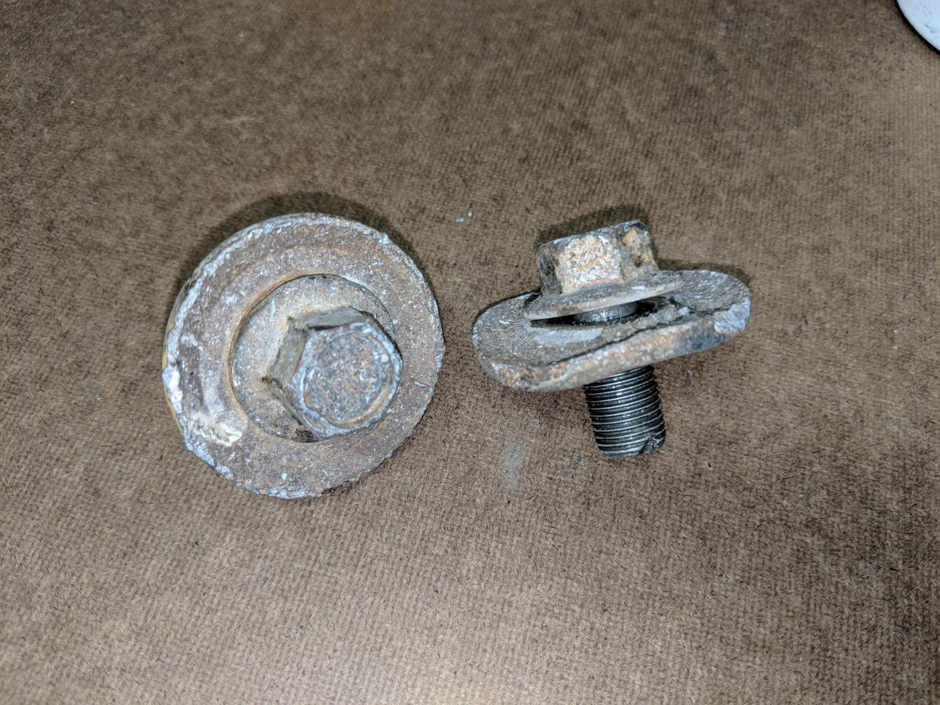

I noticed a squeaking sound coming from the OME stone guards rubbing on the lower shock bolts. I've seen this on a few occasions by now. I think the guards offer some added protection for the shocks, but I don't think they serve much purpose covering the bolts. The covers get bent around the bolts after various contact with rocks, and then they rub and squeak. It seems like they might protect the bolt head from some damage, but after enough time the guard might be more trouble accessing the bolts than the alternative. The guards didn't seem to save the washers from much damage either. So rather than bending the guards back from the lower bolts again, this time I just cut them off.

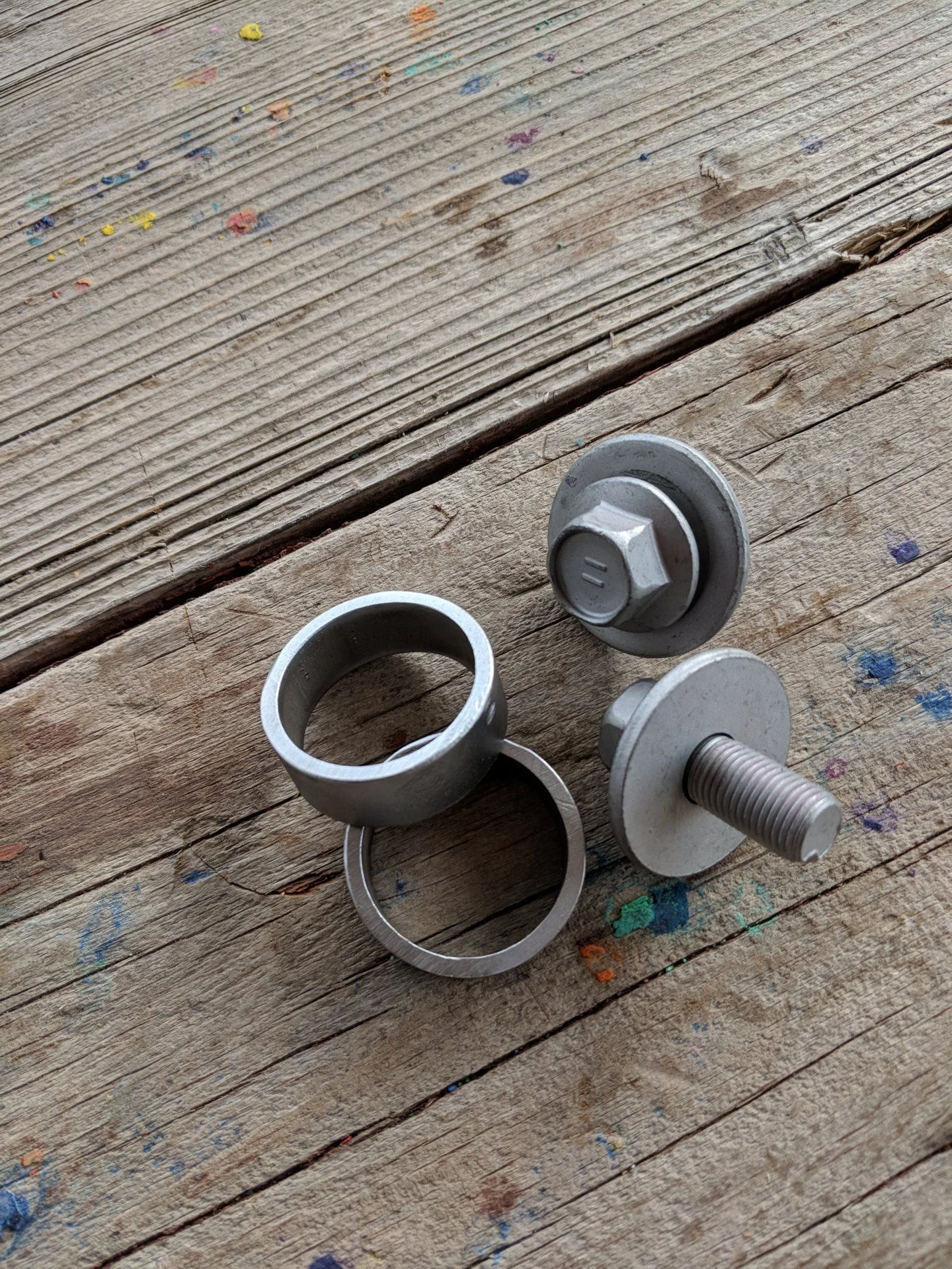

Here are the old bolts with bent washers.

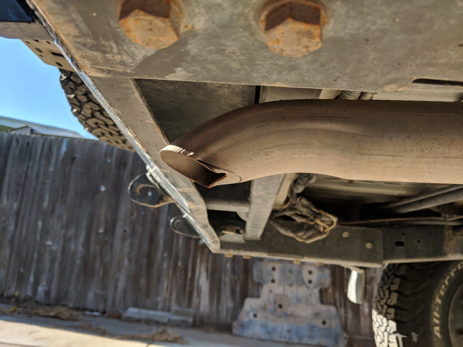

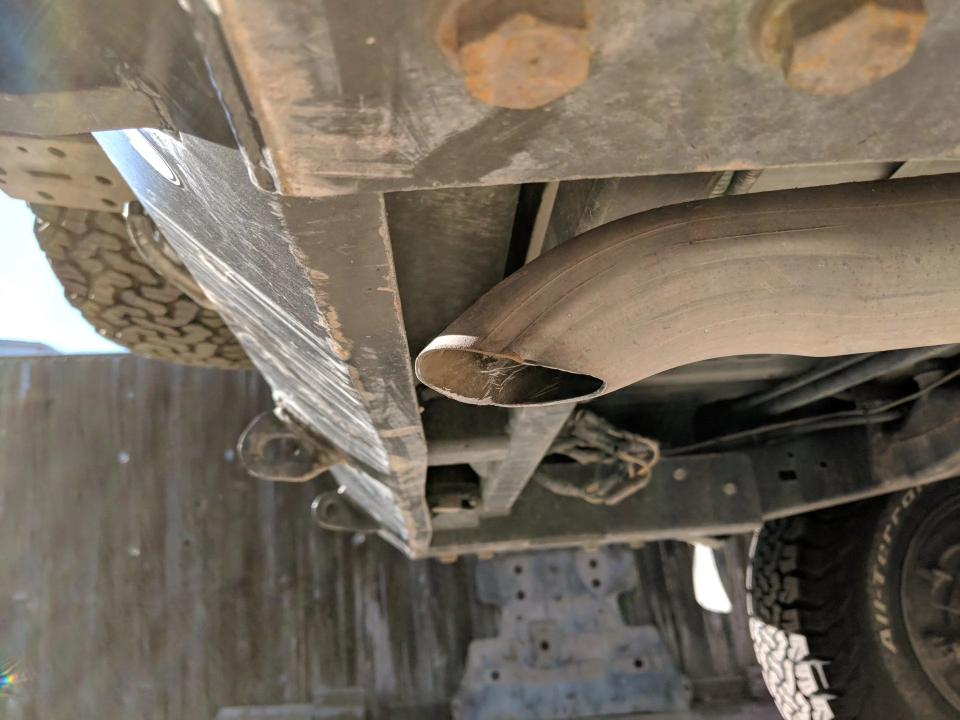

The tail pipe was a bit bent as well so I trimmed it while I was at it. It may even be a bit louder now, but I've come to embrace the roar.
As you can see, the rear bumper has touched down a bit.

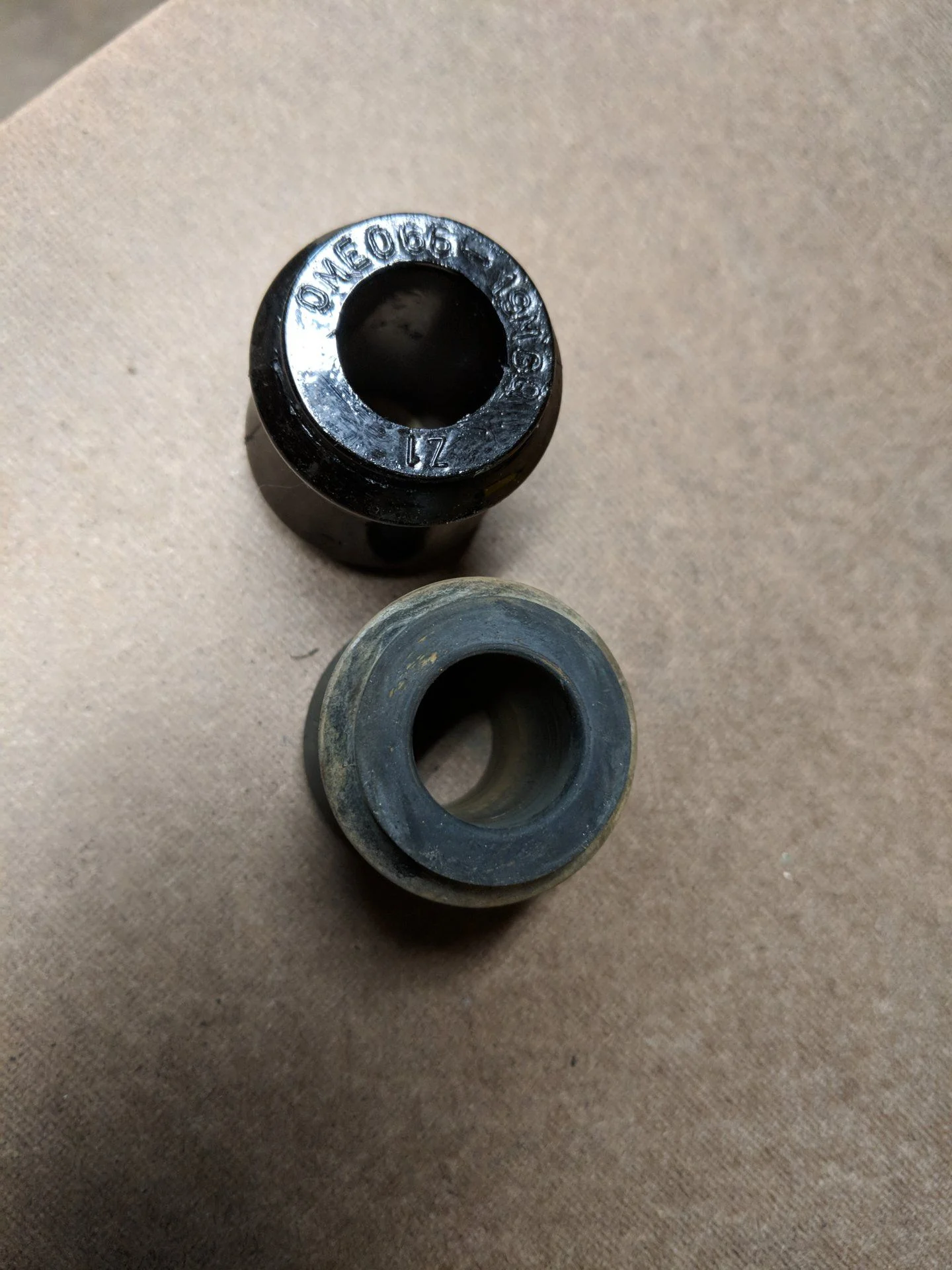

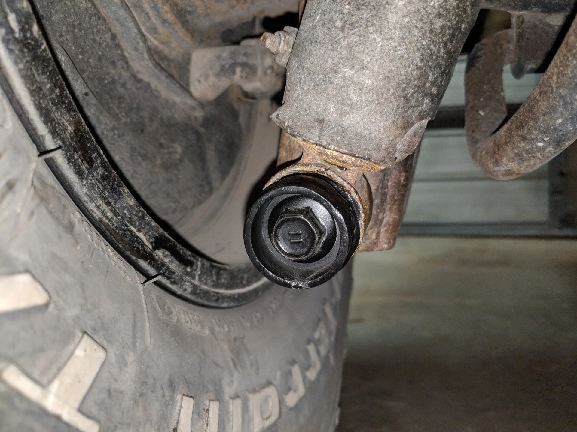

There was a bit of movement at the rear shock lower bushing. I thought this might have been due to a worn bushing so I replaced it and realized no noticeable improvement. I also didn't see any significant wear on the bushing, so I'm going to consider it normal operation.

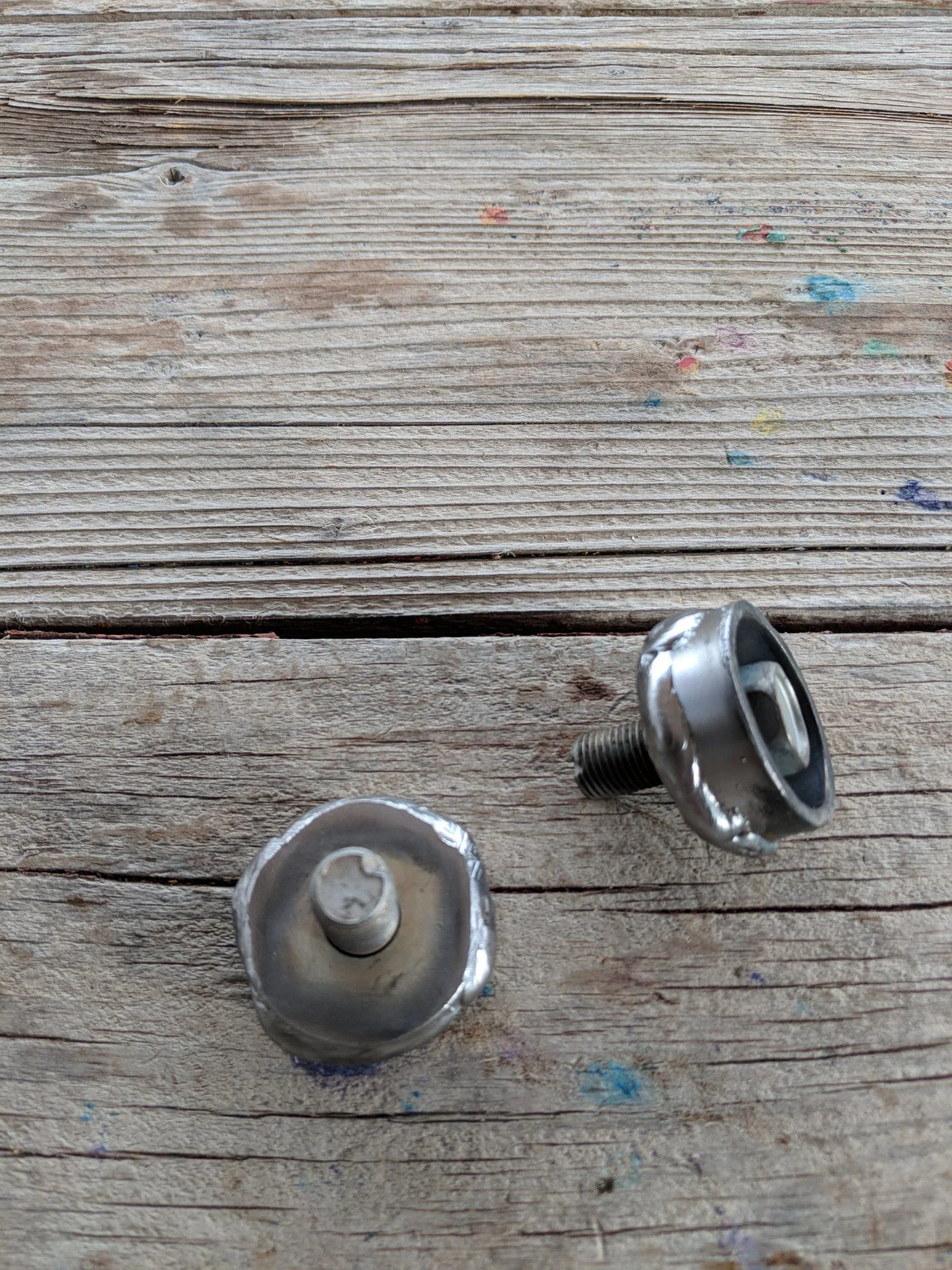

While I replaced the bushing, I also replaced the old bolt. I welded some 1.75 tubing to the washers to help them stand up to a bit more abuse.

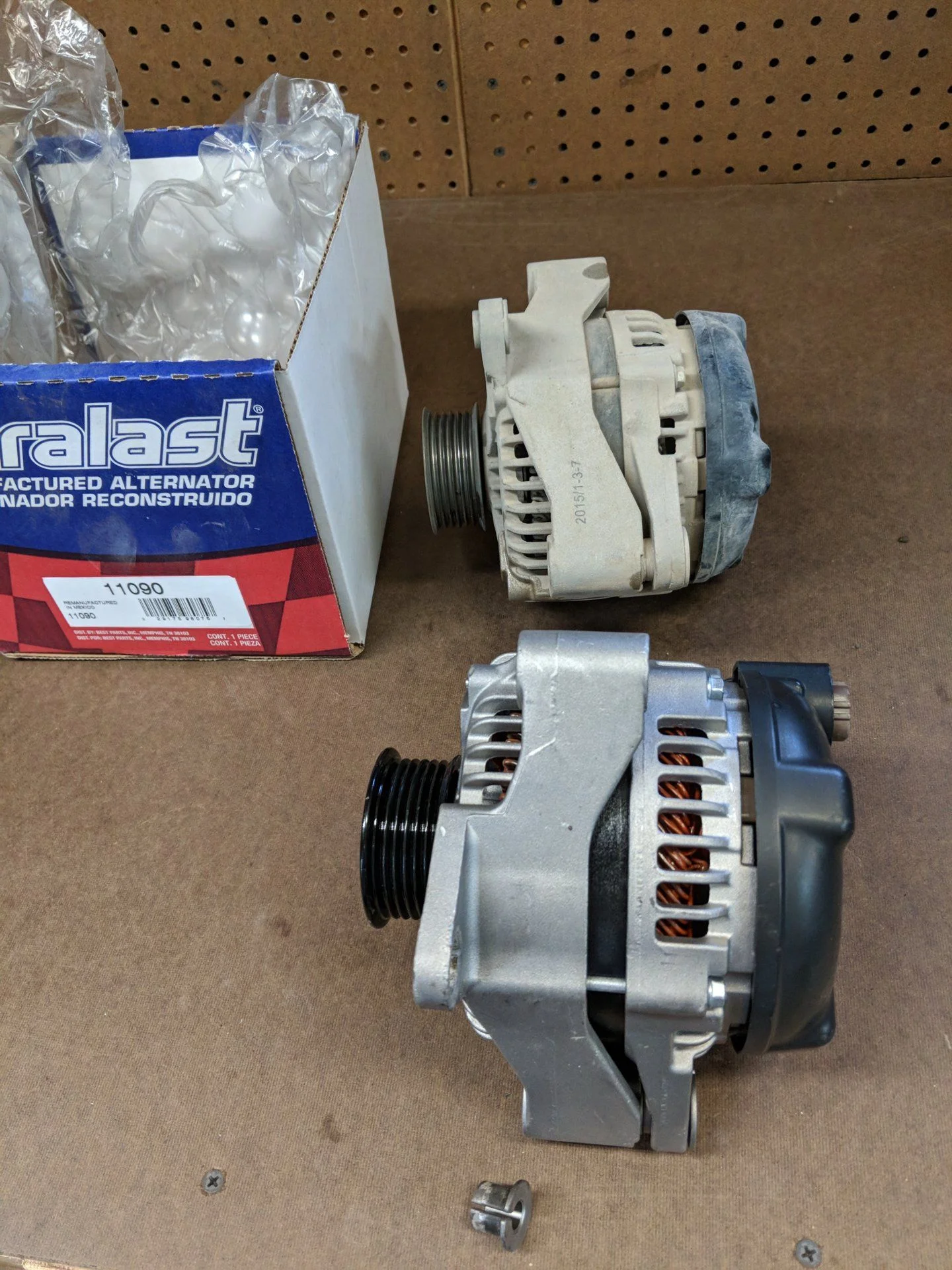

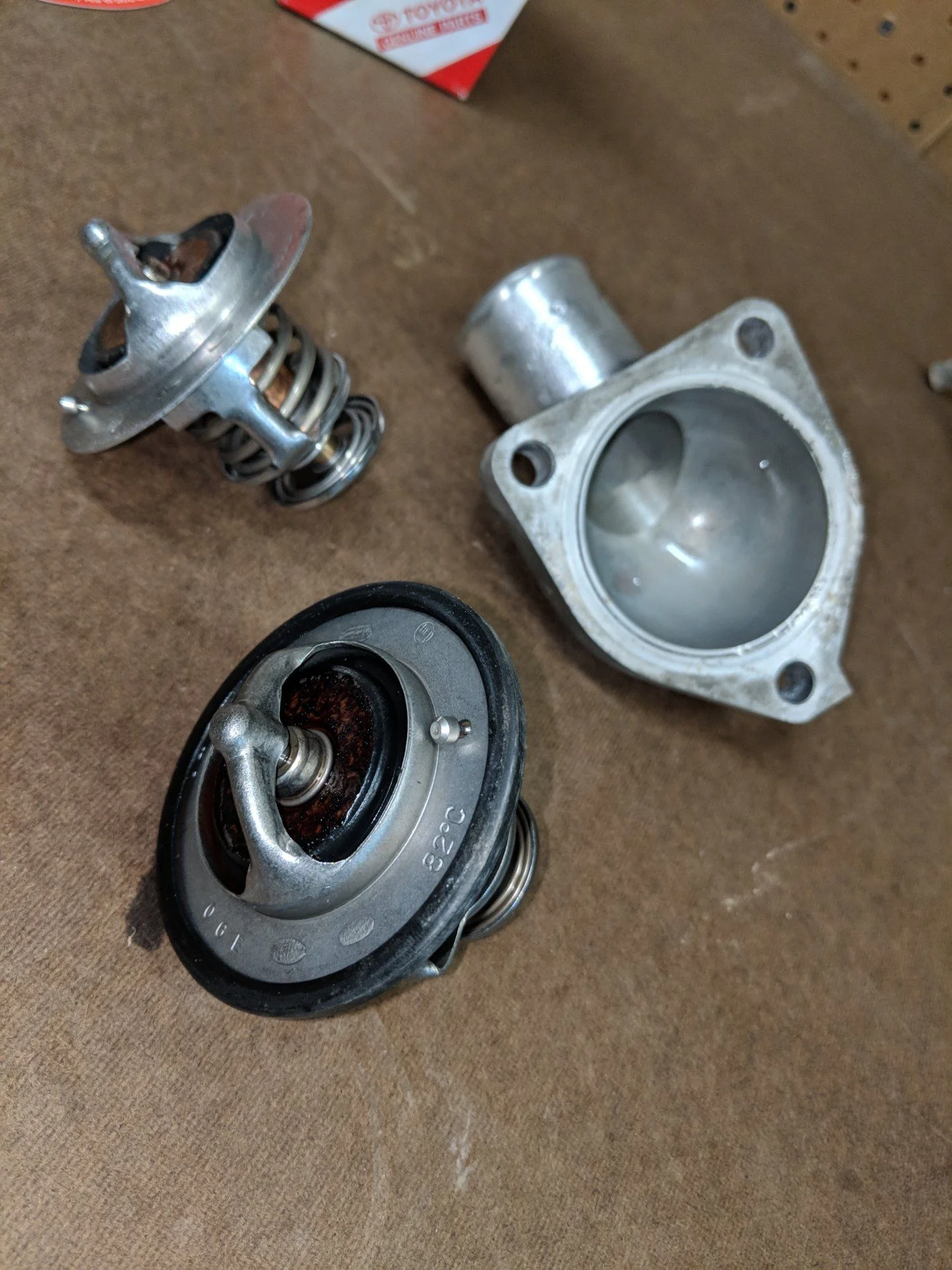

I diagnosed a noise coming from the alternator, which I had upgraded to a 150A Sequoia unit about 2 1/2 years ago. So I made use of the lifetime warranty and swapped it out with another unit. While I was in there, I noticed a bit of coolant buildup around the thermostat housing inside the lower radiator hose. The hose didn't look too bad, but since I carried a new spare, I decided to change it out. I figure the used one was working fine for use as a spare and I'd rather have the new unit in service. So I replaced the T-stat as well and saved the old one for a spare too. That job took care of the noise, but got me reevaluating some of the other hoses, parts and spares I carry.

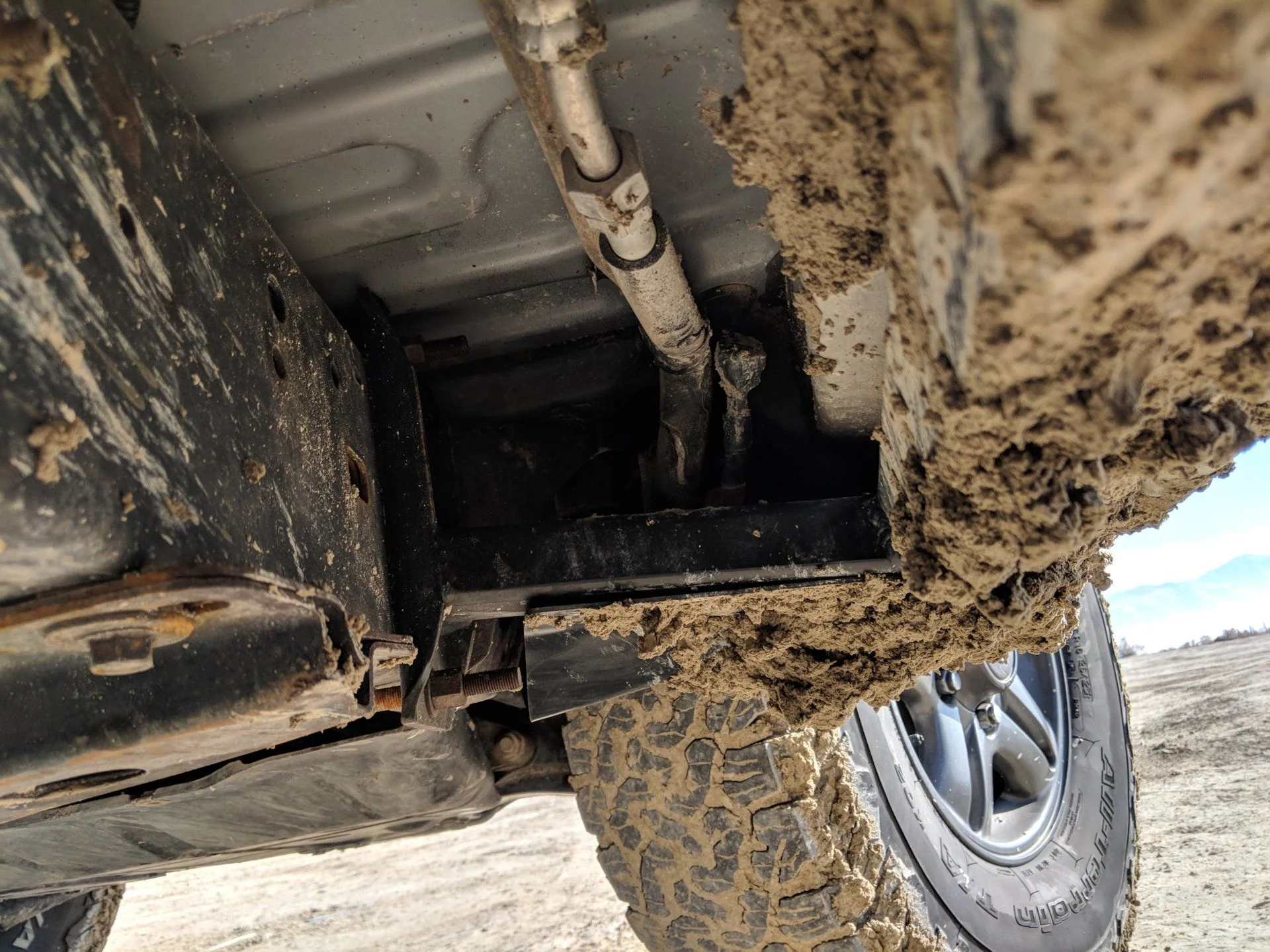

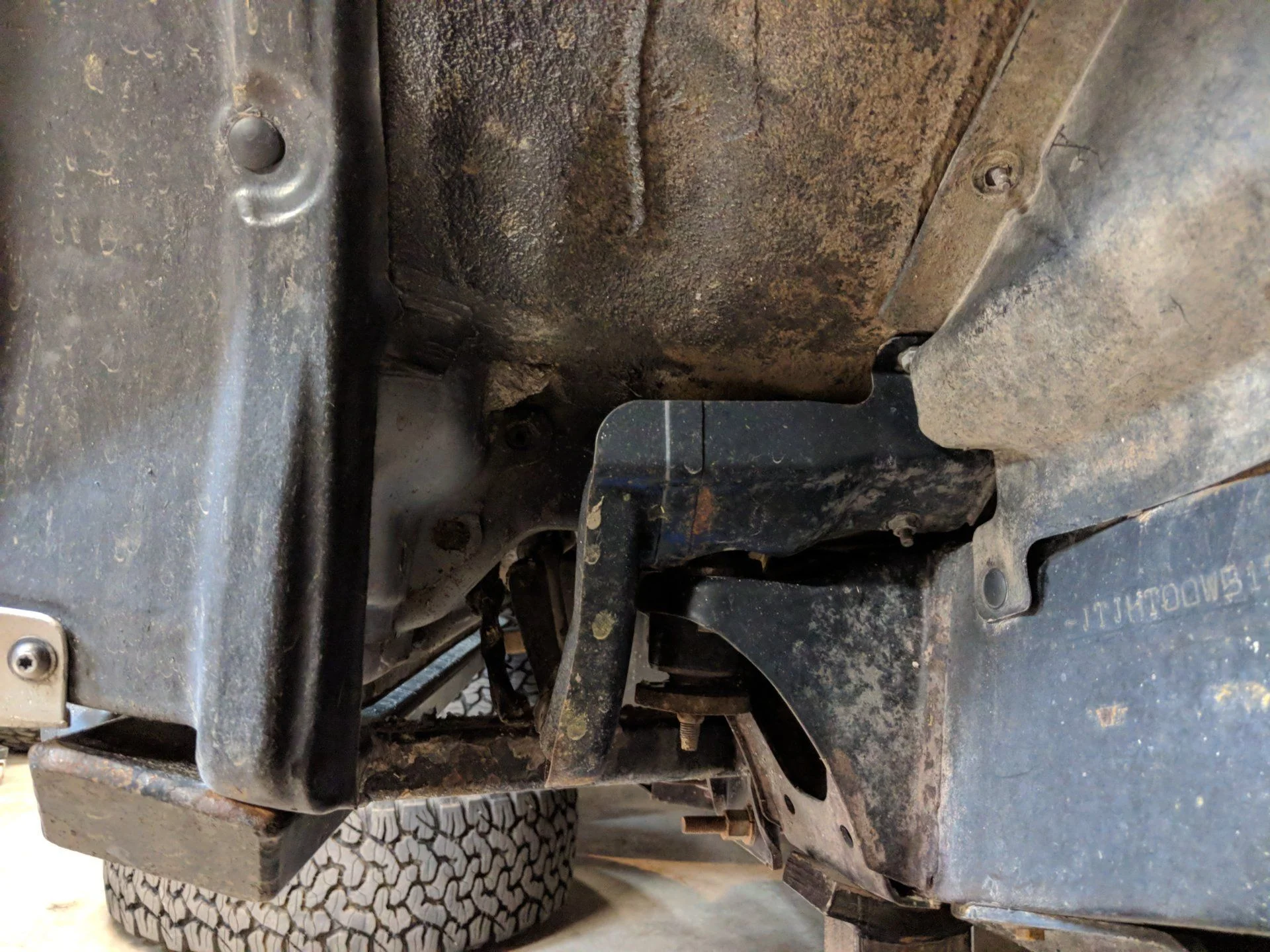

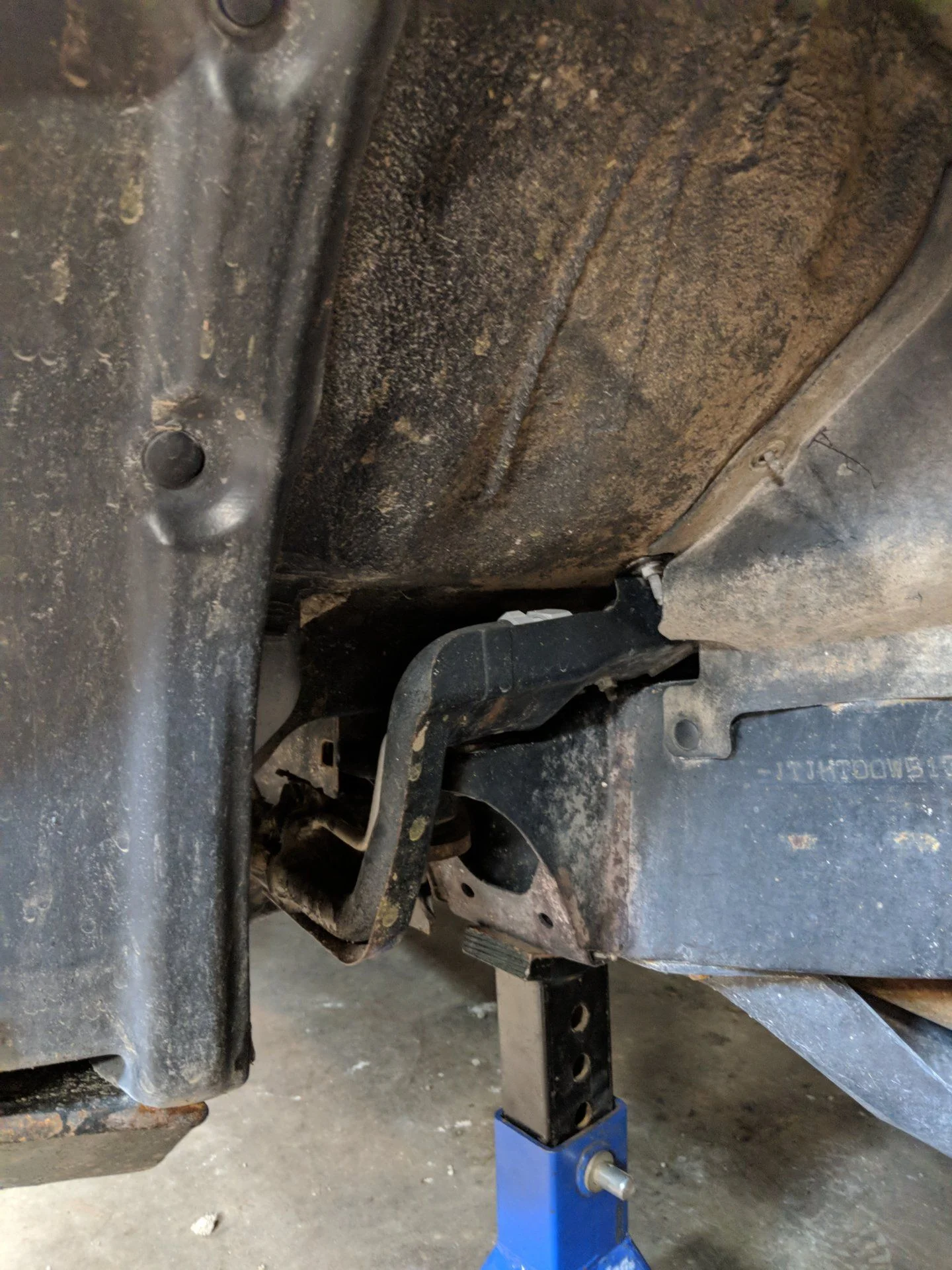

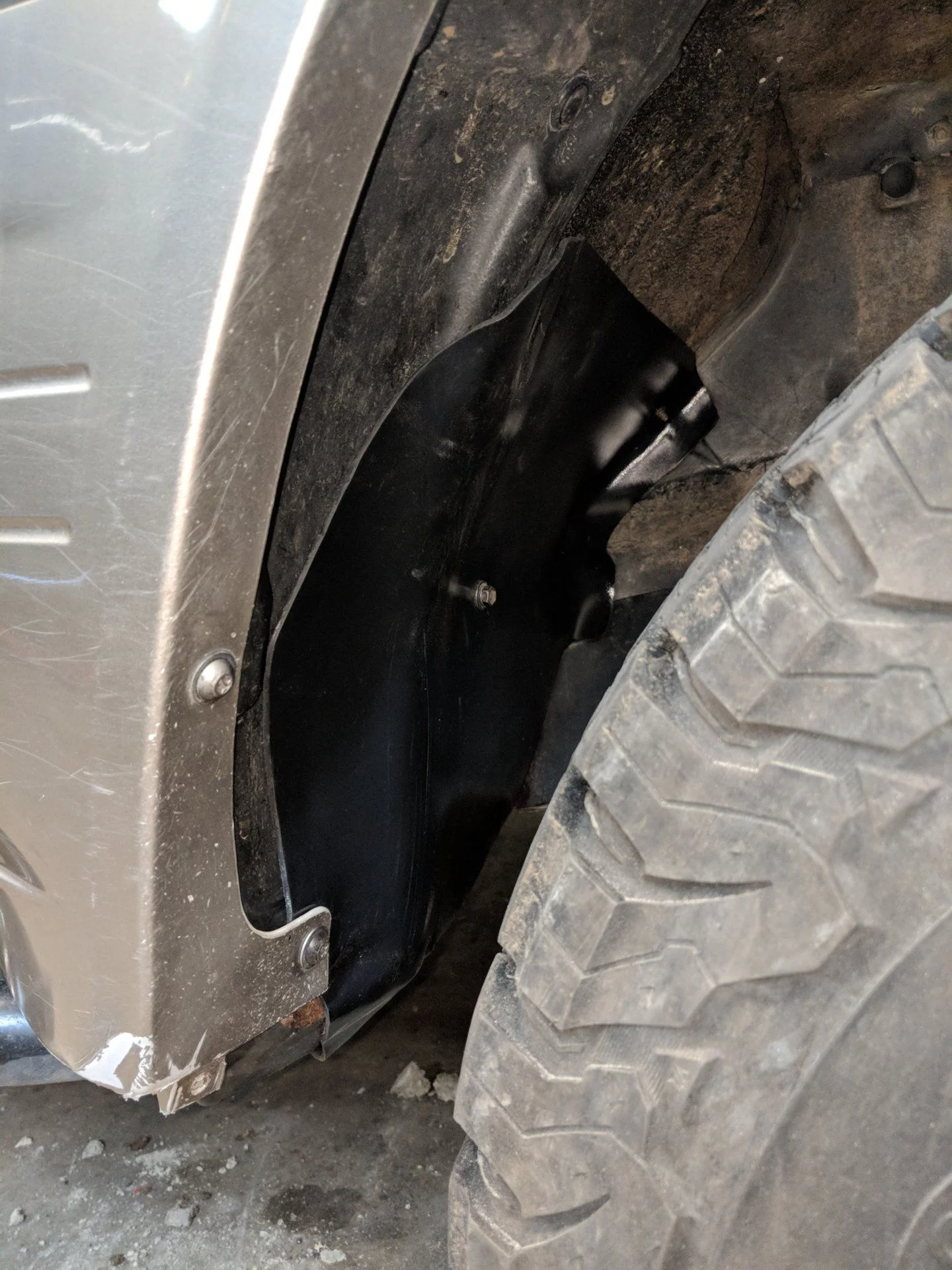

There might not be a real need for this, but the idea kept kicking around for long enough, that things moved to the next level, who knows how far it will go, but here I am for now. In this case, the issue starts with the right front wheel well. There is an A/C line that is somewhat exposed. Lots of mud and rocks gets kicked up off the tire and packed in around the lines, into the frame body mount, the underside of the body and the outriggers to the sliders. I like to get my truck clean after it gets dirty, so I've been pretty thorough about spraying all that debris out when I wash the truck. As you probably know, its not the easiest place to get clean and its easy for mud and rocks to hang out there and all along the underside of the body outside of the frame(even worse with all the AHC stuff in there). I had a friend mention that the rock trapped around his A/c lines caused a leak and he had to replace the line(not sure how common that is, but I can see it being an issue). After seeing how the rocks from my tires can really beat on the undercarriage parts, I decided that it would be nice to have some added protection for the A/c lines and to help keep some of the mud and debris out of that area.

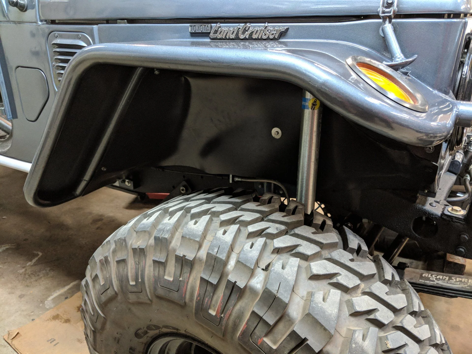

I have some previous experience from my FJ40 making some fender liners out of Kydex to accommodate the tube fenders that I built. Here is a quick example of that.

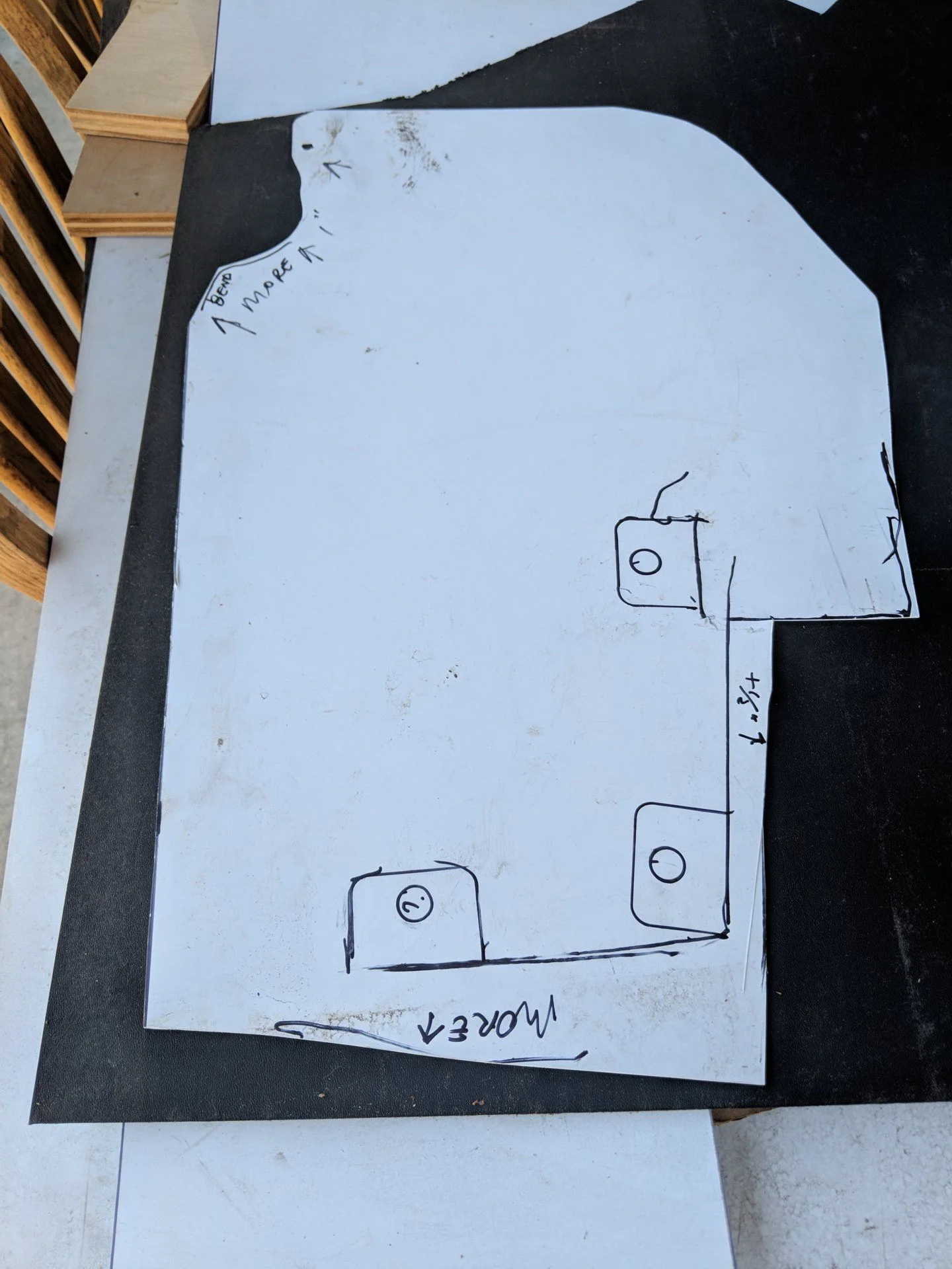

I had some remaining .090 Kydex sheet so I used that for this project. I made a rough template and transferred it to the material and got started with a few priorities in mind.

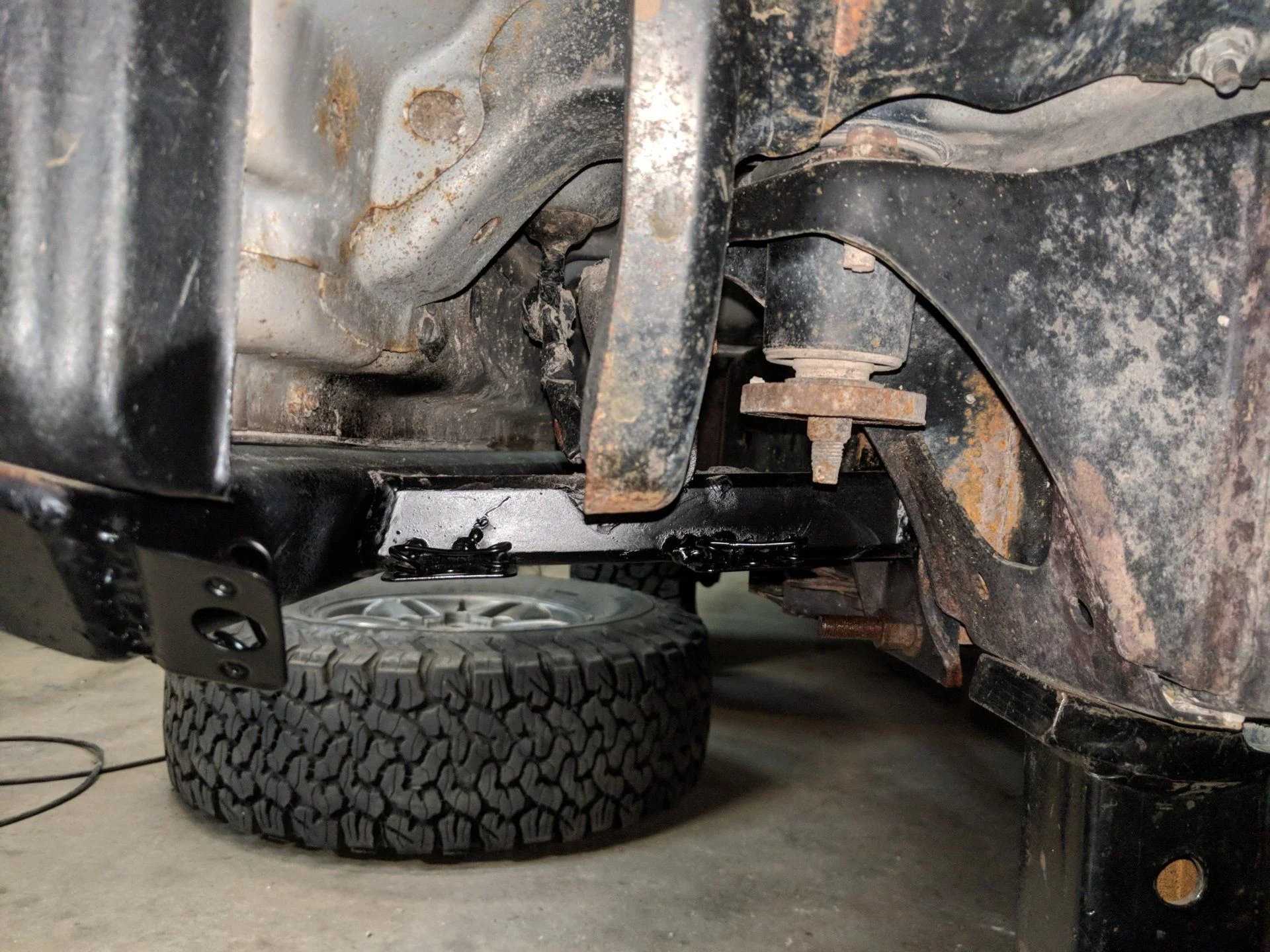

I realized that I'd need some additional mounts, so I'd make them with Dzus fasteners at the sliders with some room for the material to flex between the body and the sliders(ie frame). These mounts would be out of the way and allow easy removal.

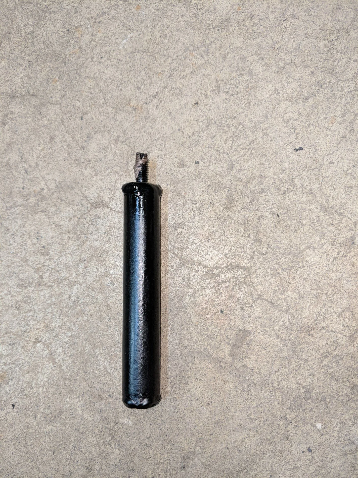

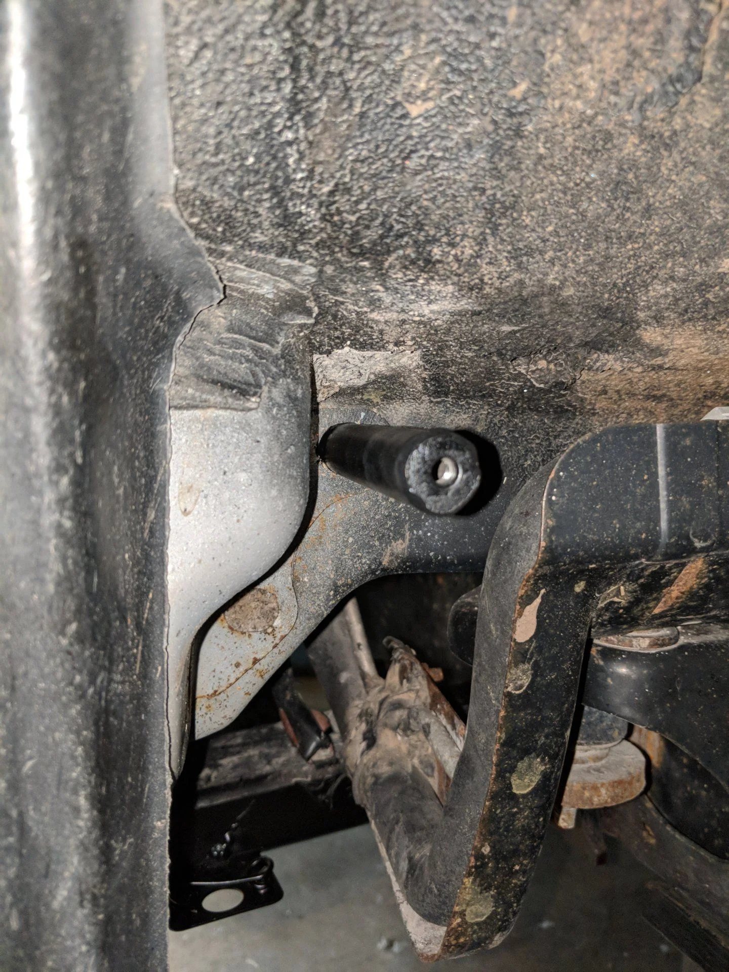

Then I made an extension stud to help mount the liner using existing bolt hole in the body.
Extension stud installed. I had cleaned out the mounting bracket for the lines in the past, and I put some silicone in the small nooks to fill and protect those spots.
3 Dzus tabs on the slider.

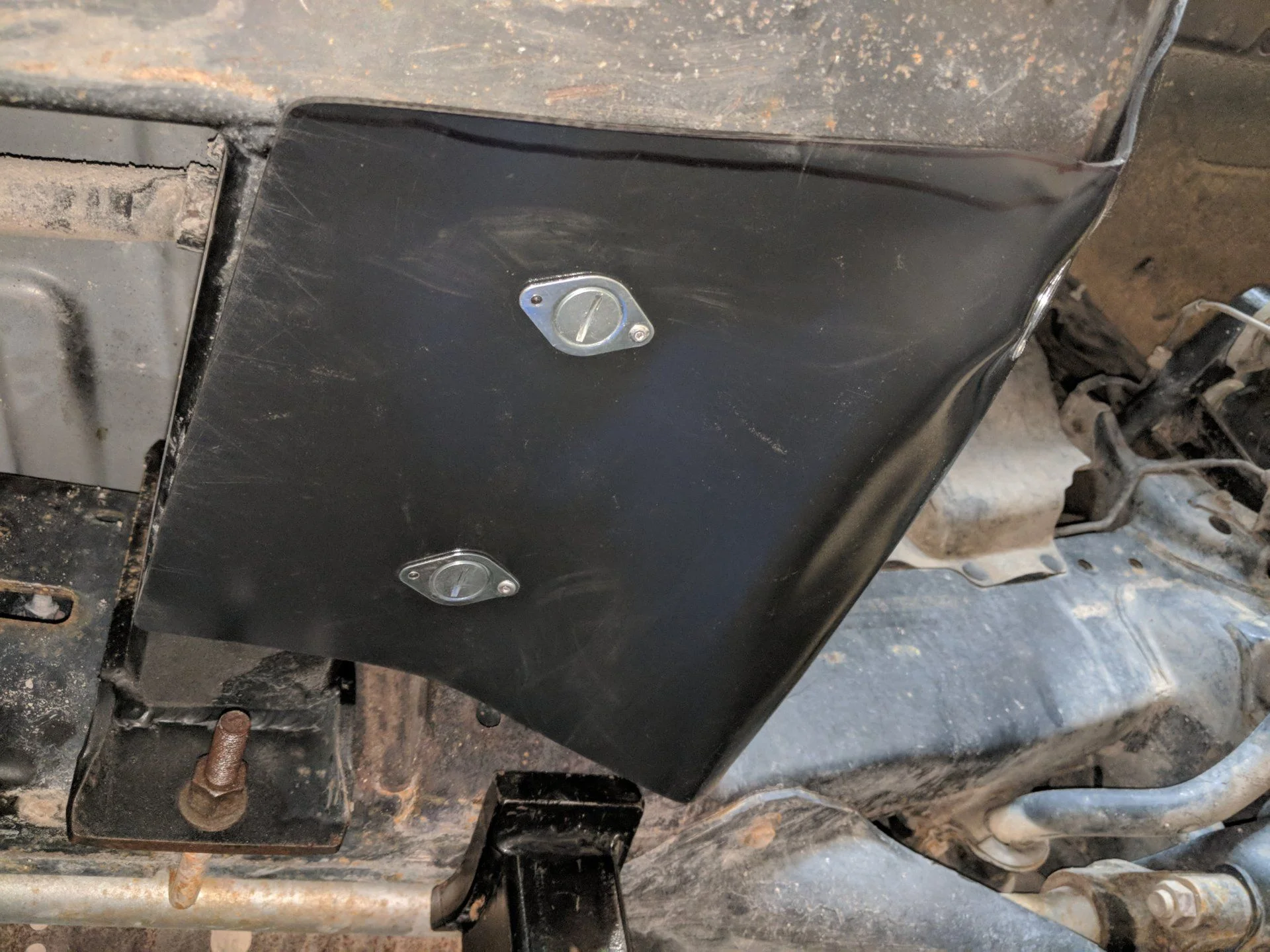

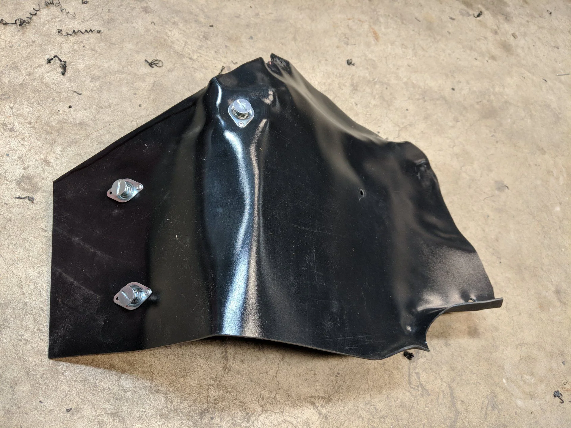

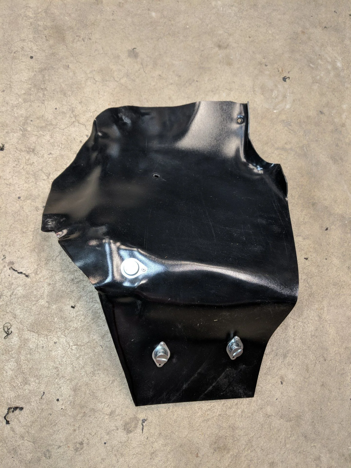

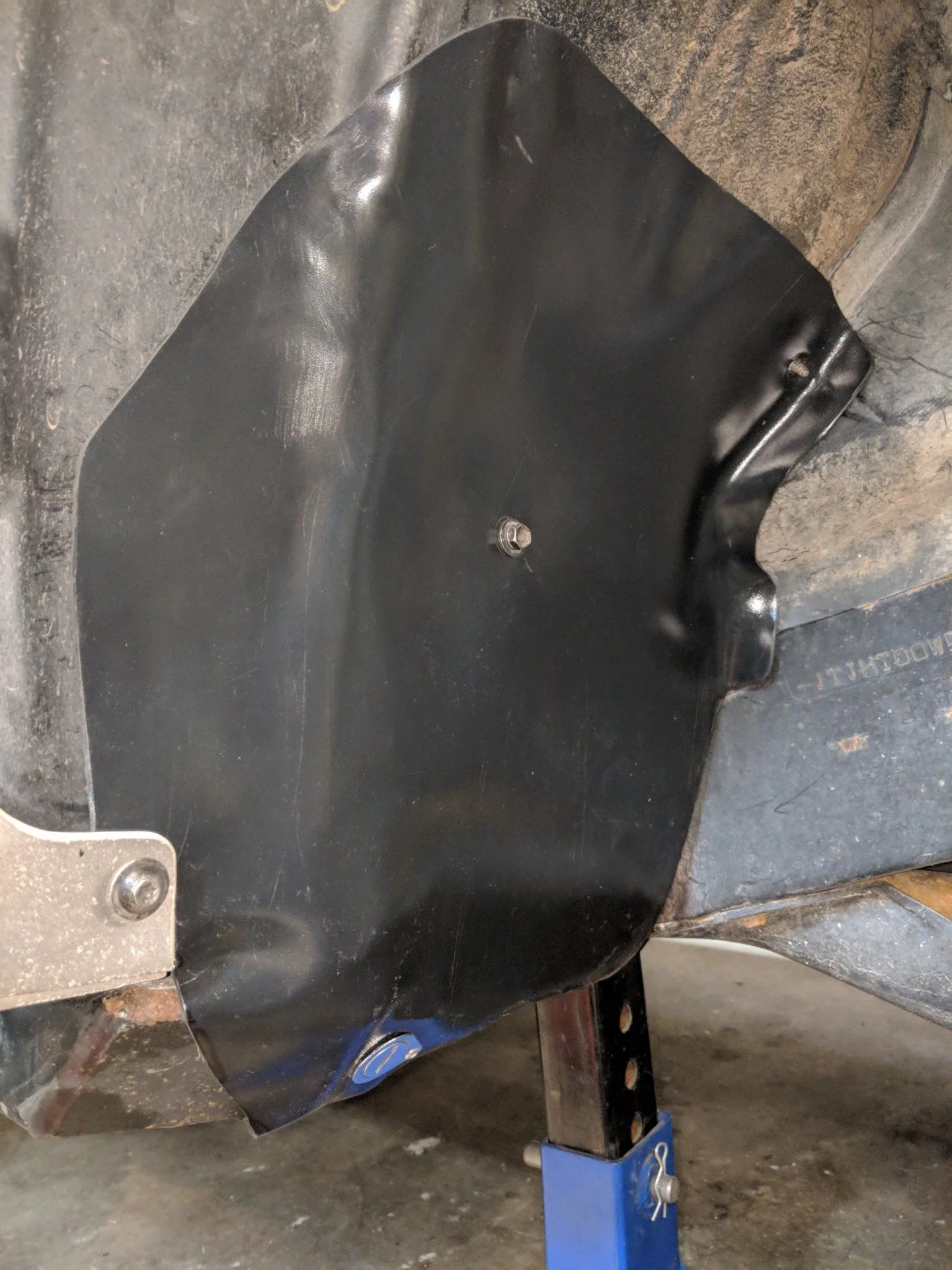

Kydex cover formed with self ejecting dzus buttons.
Here is the formed cover installed.
Here are a few more pictures of the fit. I have the clip in the top corner installed now.
It wasn't long before it was put to the test and mud wasn't hard to find.
It looks like this cover is serving its purpose. It actually seems to be keeping out more debris than I expected. I didn't notice any adverse effects like noise, looseness, or fit issues.
