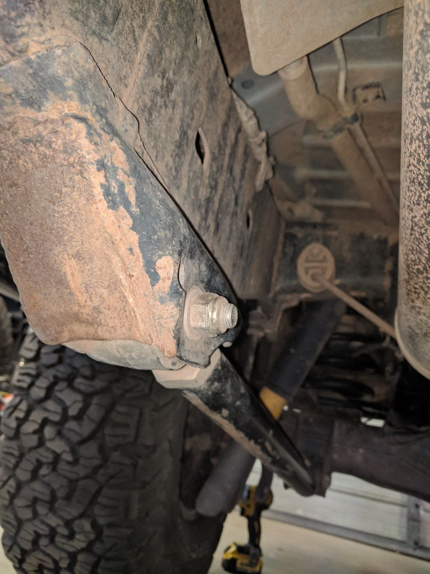

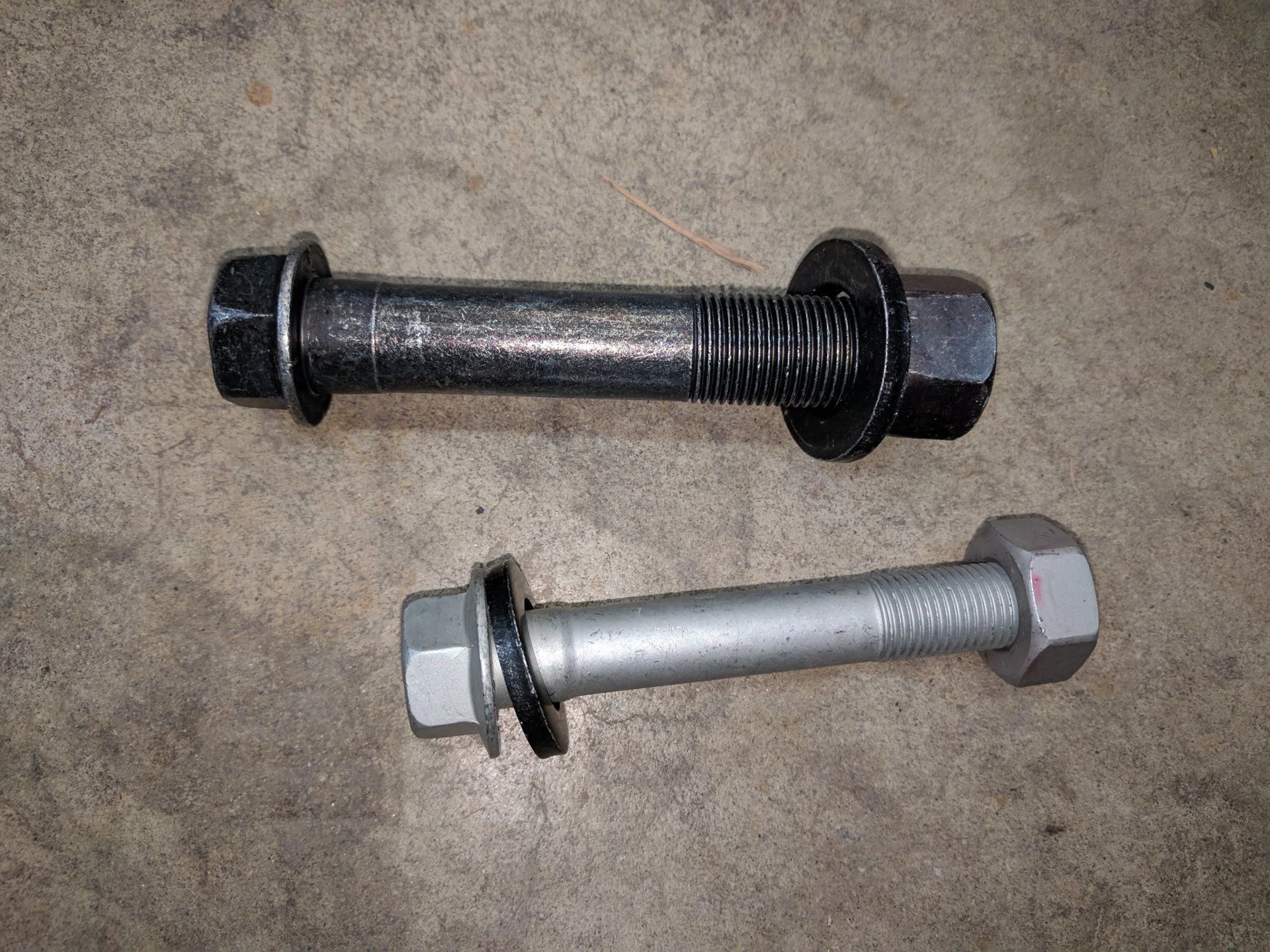

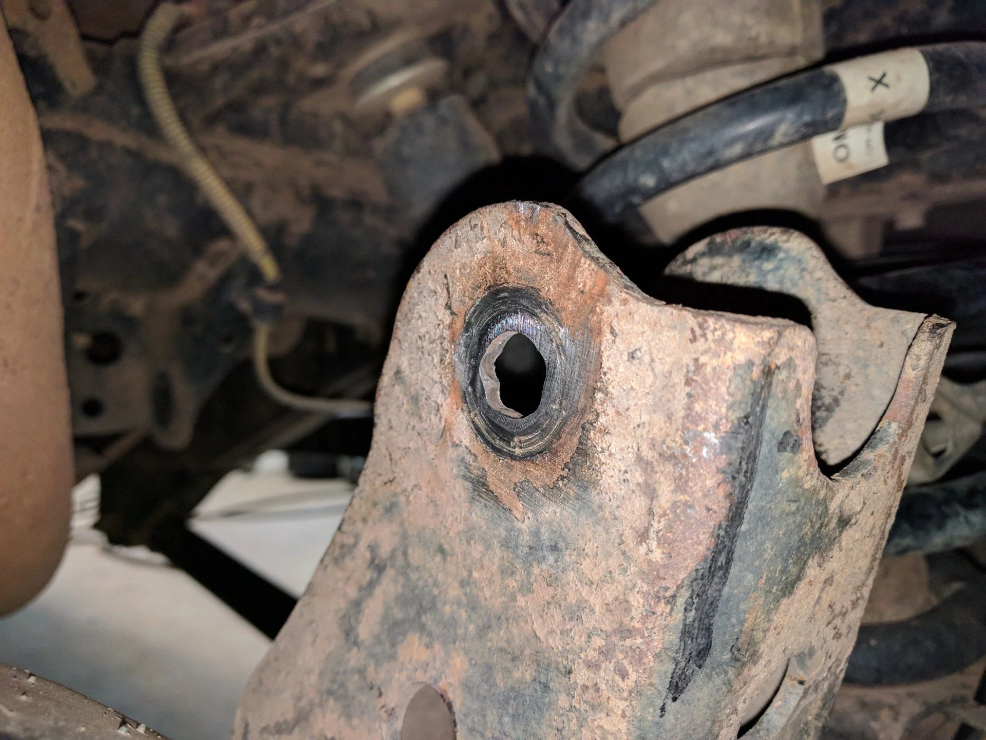

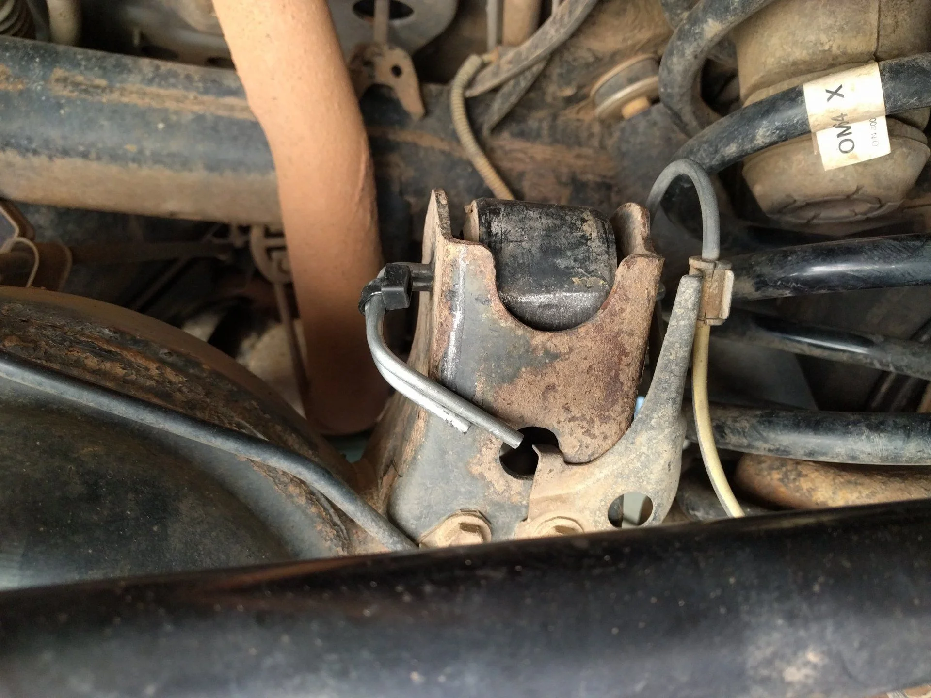

After another memorable night on the trail, we were at it again. I was a bit disappointed and surprised that I dropped the bolt, and pleased that nothing was damaged. I do a lot of maintenance and work on this rig to keep in working well and prevent issues on the trail. Regardless, this truck sees a lot of rough use and things are bound to happen. 10 years ago I saw the same thing happen on an 80, so I should have known better, but the same repair wouldn't work here. In the end, I settled on a couple of stout tent stakes bent in place. It was a bit noisy over rough terrain, but it held the rest of the way to the end of the trail and back out to home.

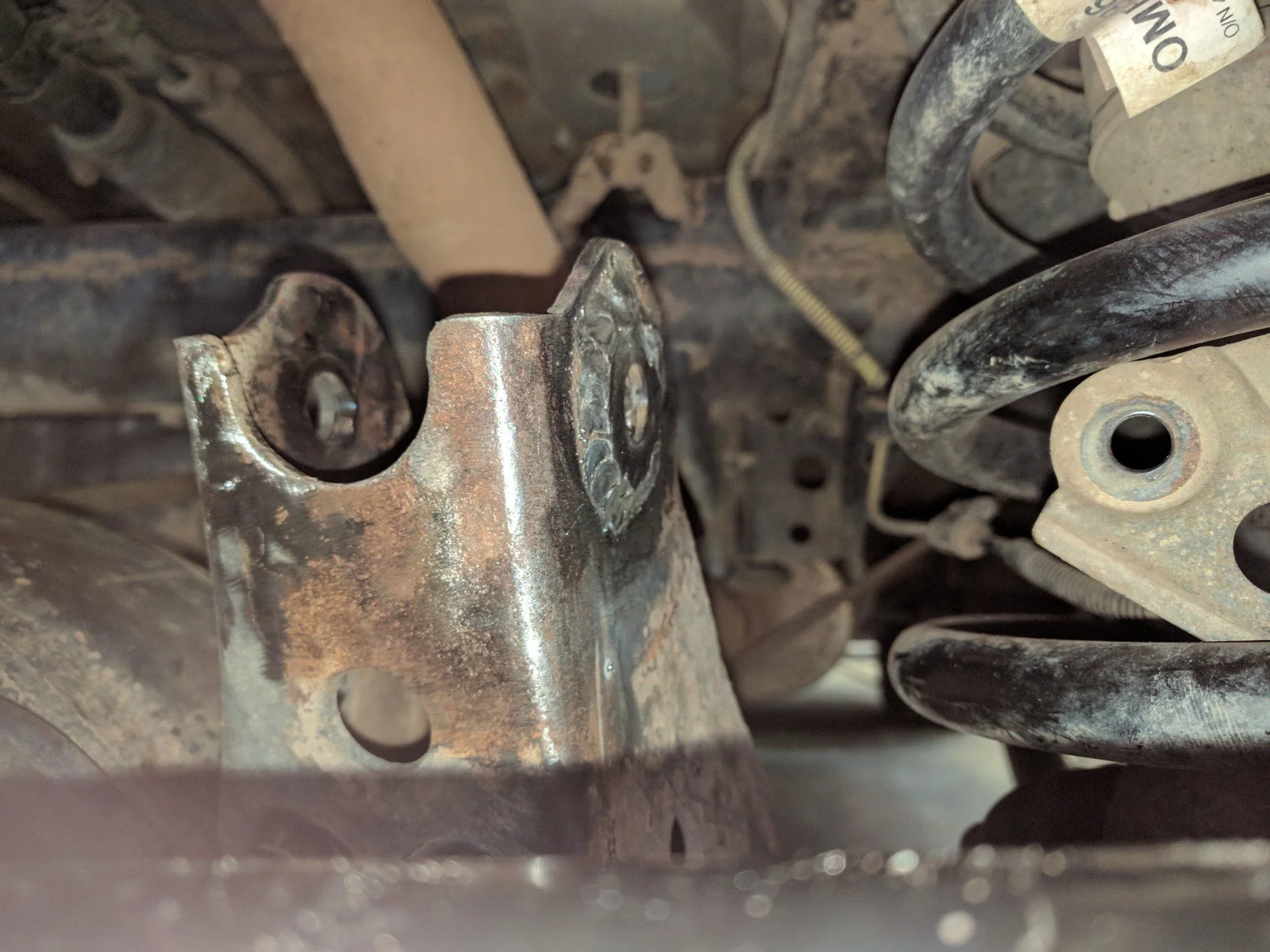

There was a bit of collateral damage as the bolt hole didn't survive as a perfect circle.
So I welded a couple washers on each side of the bracket that gave me the perfect fit that I wanted.
The sleeve on the bushing was still in great shape so I cleaned everything up, put on a coat of fresh paint, and installed a new bolt. I went through and added lock tight torquing all the link bolts to the 111 ft/lbs spec.
I now have a spare too.
For comparison, here is a 100/80 link bolt side by side. I had thought about drilling the hole to 18mm and using the 80 bolt/bushing sleeve, but the washers worked better.

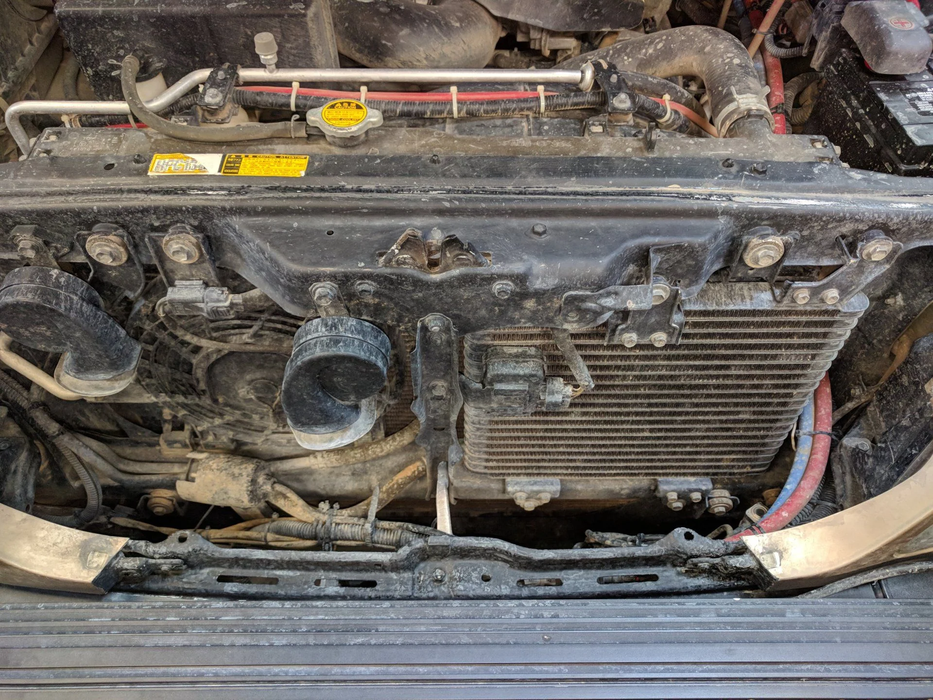

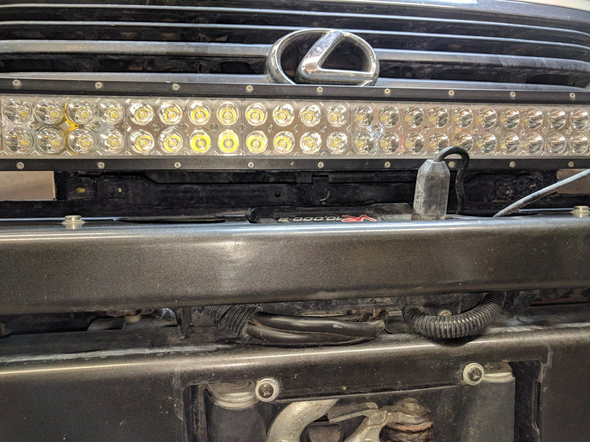

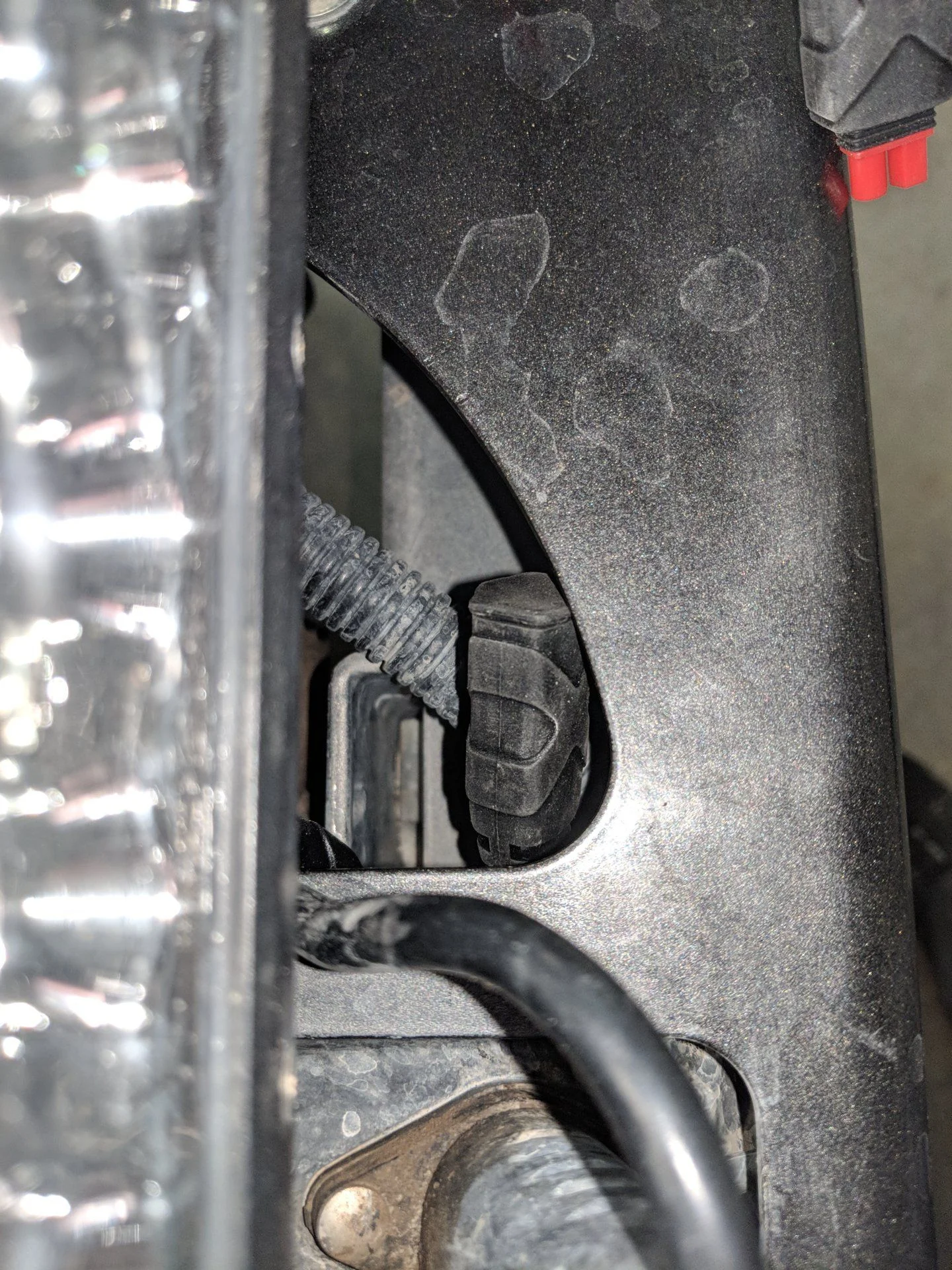

More adjustments with the ARB front bumper.

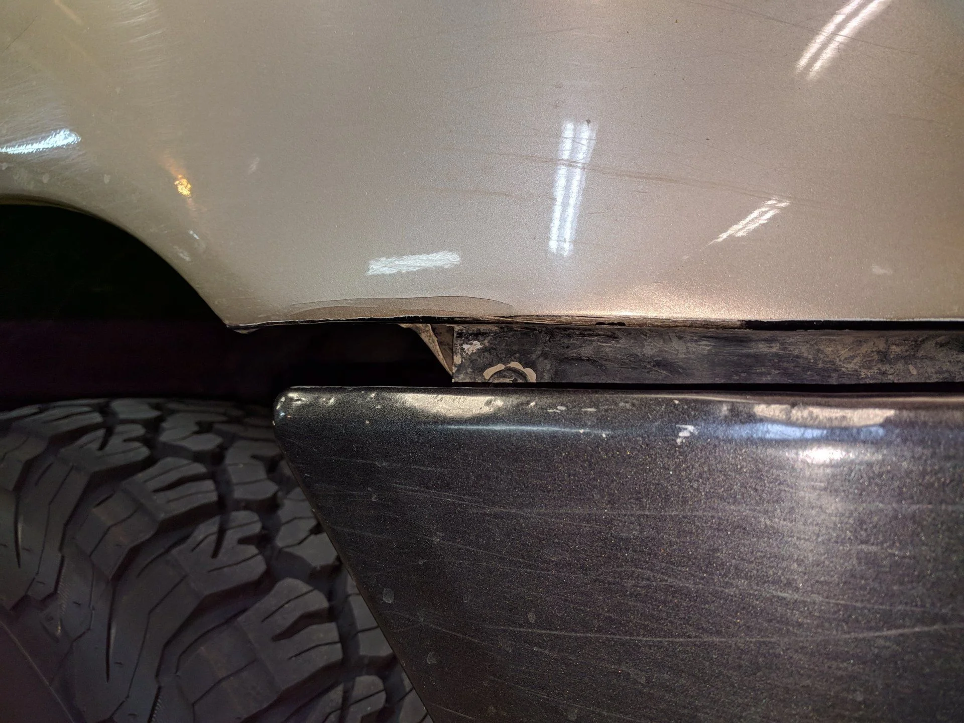

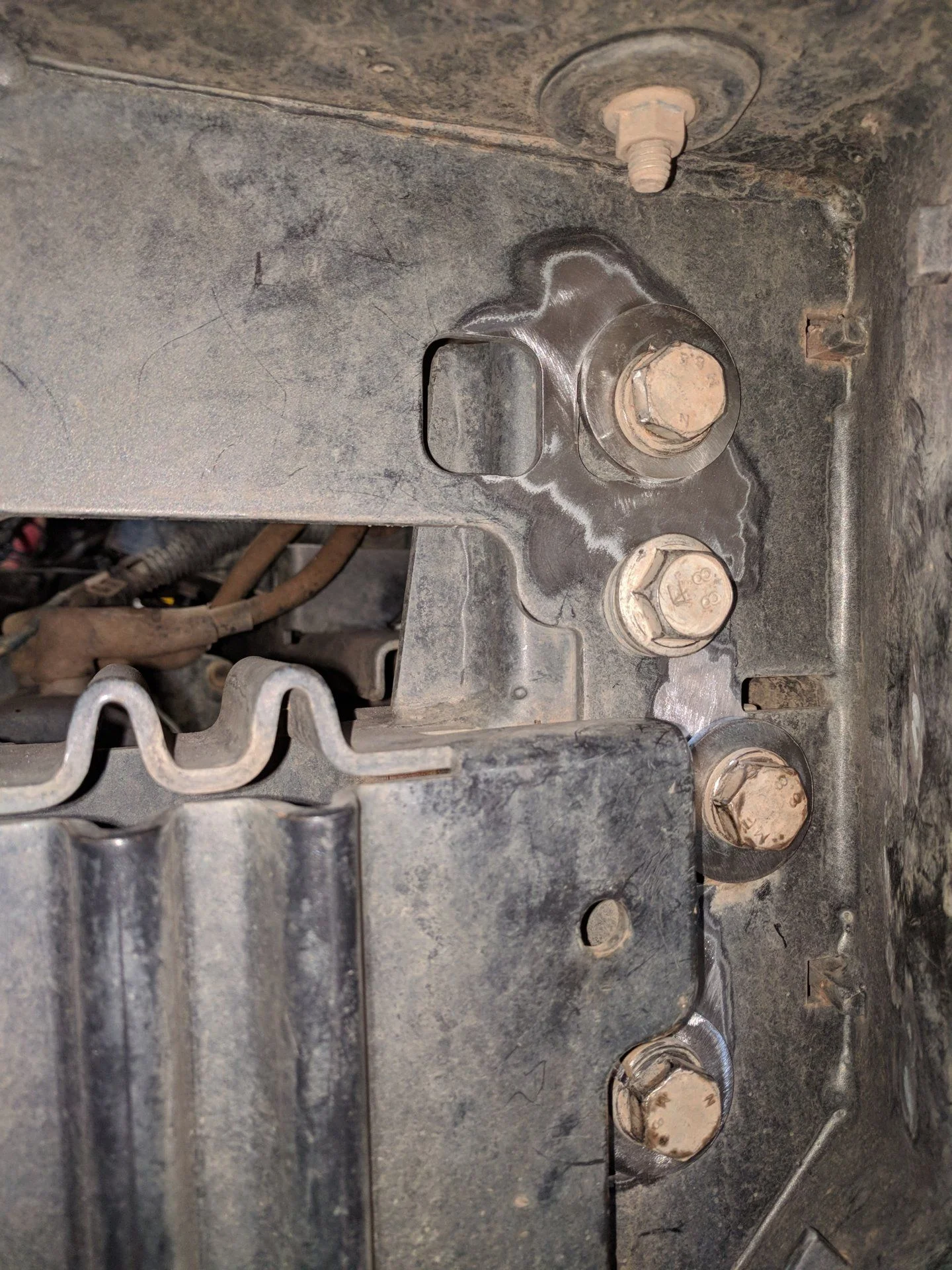

I've had issues with the bumper moving in the mounting bolt locations. There is a lot of room for adjustment and that allows the bumper to move when bumped into rocks/ dunes and such. I realize that I might drive it a bit more rough than most, but I know of others that have issues with this too. So even though this bumper isn't quite stock, its not a complete anomaly either. However, my bumper might flex a bit more than others and that exaggerates the issue. When the bumper moves close to the fenders, then the bumper can flex and hit the fenders more. I tried to remedy this in the past, by adding a bolt that doesn't have a slotted hole and cranking the bolts down tight. This probably helped, but the bumper was still able to pivot on that bolt. after being hit several times on Hole in the Rock, the bumper was up against the fenders again and so was my buddy's 100 LC with the combo bar. We took a quick pit in the morning before leaving camp to straighten them out.

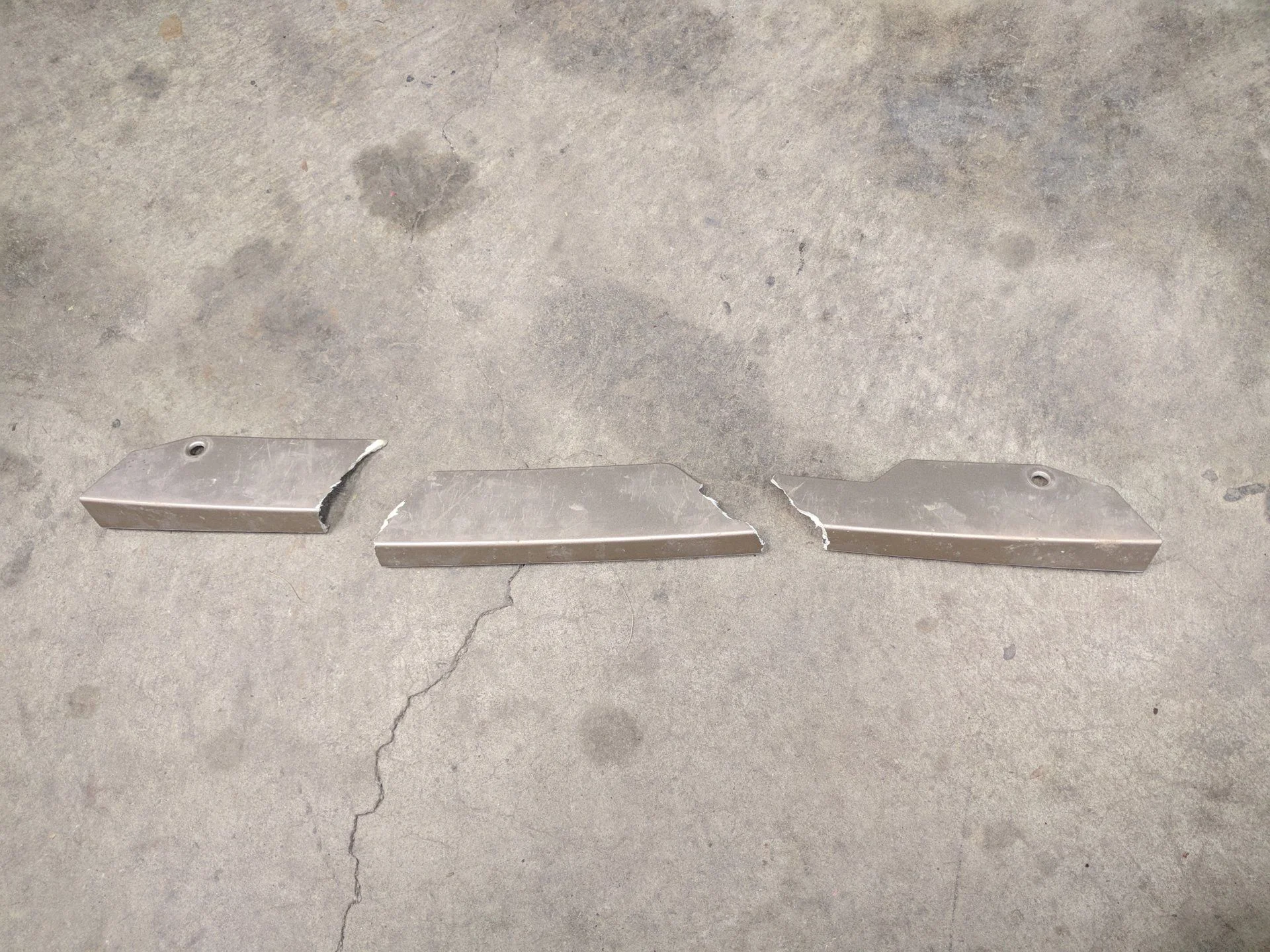

My bumper had done a bit more damage to the front fender and was bound up on the portion under the front grill that I never trimmed. So, I removed the mounting bolts and freed it all up. In the process, the trim piece under the grill transformed into several broken pieces of trash. It was very brittle, but fortunately didn't break the other pieces. I'm fine leaving this piece out. With the way my light bar sits in front you can barely tell that its not there and there is no negative impact to performance that I observe. if anything, it allows a bit better airflow, and is one less thing to deal with.
After re positioning the bumper with plenty of fender clearance, I welded the mounting bolt washers to the bumper to help eliminate alignment issues. then I touched it all up with some paint. Time will tell soon enough if this fix will hold up, but so far after a couple hundred miles of dirt it's still right where I set it. As long as the bumper to fender clearance stays good, the bumper can flex without hitting the fenders.

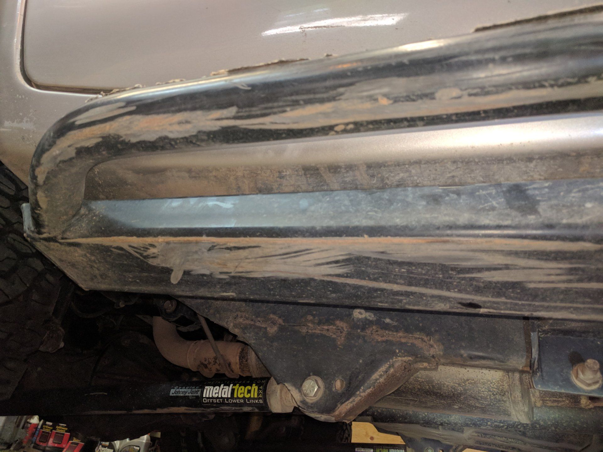

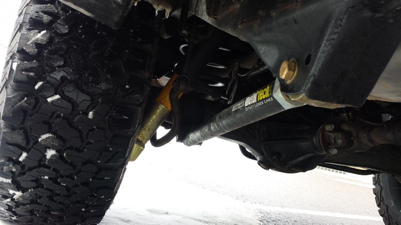

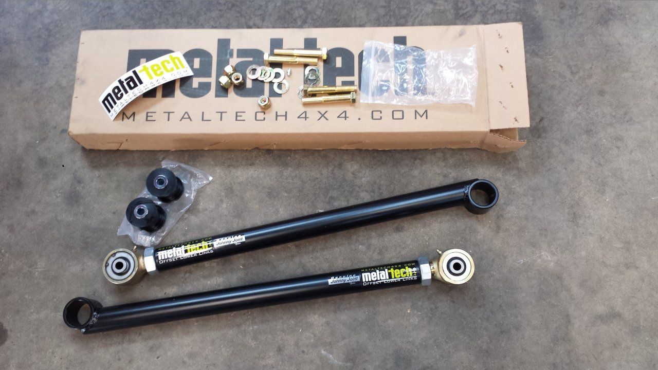

While I had the control arms out to weld in the mount skids, I replaced the stock links with Metal Tech Offset Lower Links. My stock links had been rubbed a couple of times but were not damaged yet. However, I expected that it was only a matter of time before I bent the stock links. These Metal tech links are beef and guaranteed to be replaced IF I ever bend one. In addition, they come with new serviceable joints, bushings, and hardware.

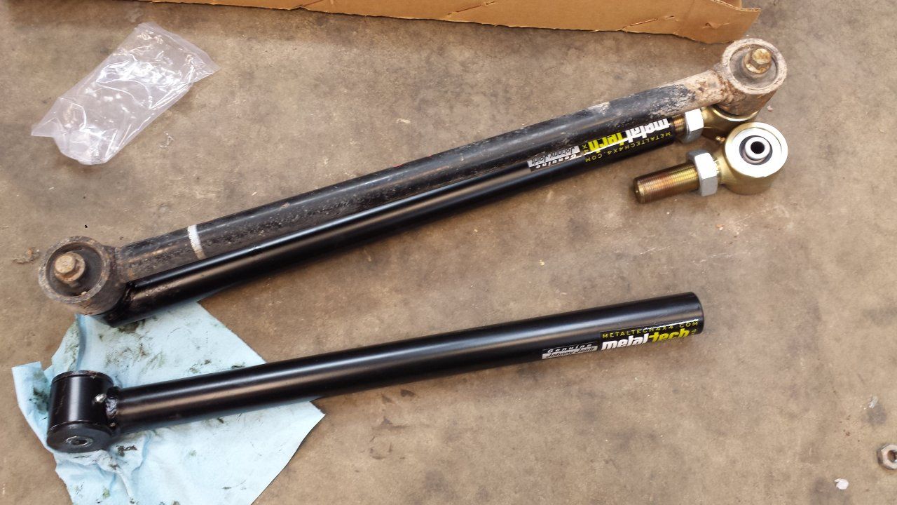

This next photo shows how much thread of the Johnny Joint is in the link, and compares the stock link.

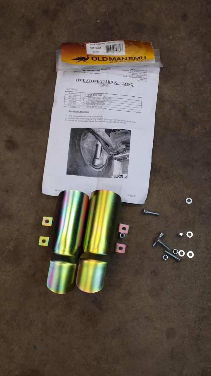

I also installed a set of the long OME stone guards to help protect my rear shocks.
Do you like these control arms? They still holding up/did they make your ride quality better? Im at 207k on original
Been looking into these as well since they have their cyber Monday sales. I would appreciate any feedback on these as well
I have been very happy with the Metal Tech offset lower links. They have take a ton of abuse with no more than scratches in the powder coat to show for it. The link mounts that I reinforced with steel plates have since been hit and significantly bent though they still aren't touching the links and I don't think that the link position has changed.
I recently inspected them with a straight edge and could not find any dents or bends. I maintained the joints and bushings greasing them at least annually. The joints still do not have any free play, though the bushings did start to reveal some movement and show some wear. The movement in the rear bushings was minimal and seemed to go away the last time I greased them. I expect that it will return and plan to replace the poly bushings at some point sooner than later. It might be a good idea to order a set of replacement bushings with the links to save $ on shipping them in the future.
I can't say that I really noticed a ride quality difference, but they do seem to flex well. I don't really have room for more flex.

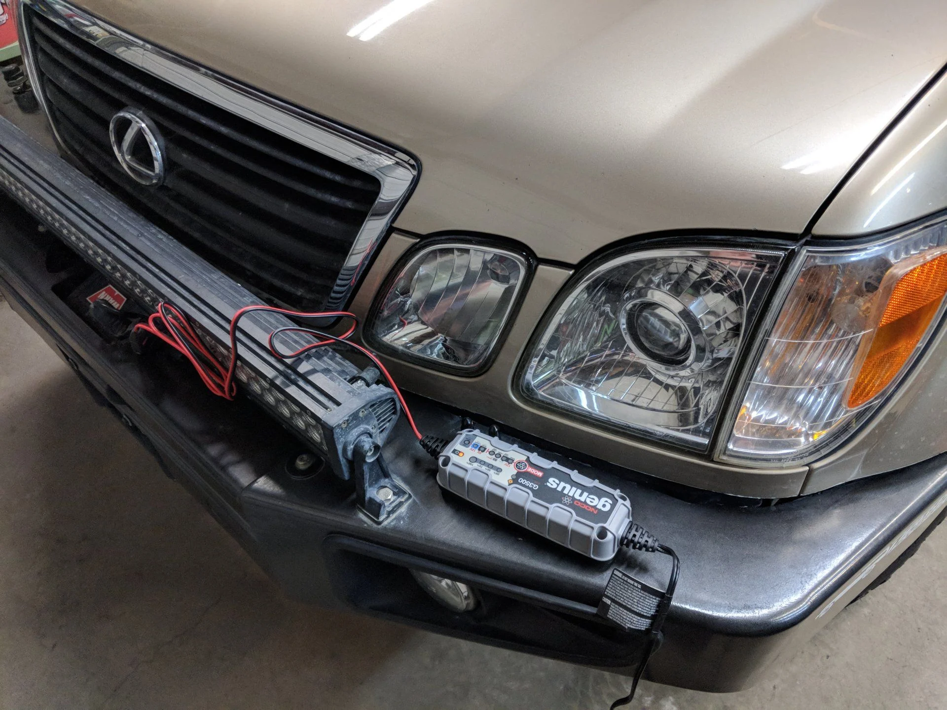

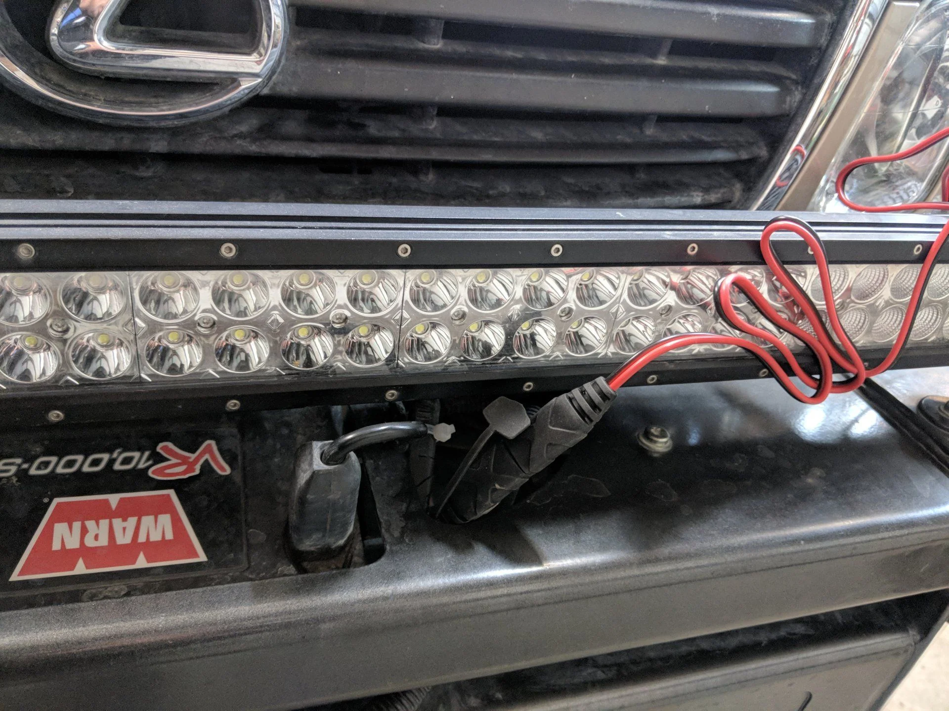

I installed a direct connector for a Noco G3500 3.5A battery charger. It's wired up to the main battery, but will charge both and power the fridge when connected. Its automatic and convenient to connect to the water resistant connector at the front bumper.
This truck isn't really a daily driver these days, though I run the fridge constantly. It commonly sits for 48 hours when driven regularly and often longer. If its parked outside, the solar panel provides adequate charging for several days- weeks. When it gets parked inside, I like to keep the batteries charged. I have run a couple different chargers, and found a few issues that I improved upon with this setup. First I ran a 1.5v trickle charger and maintainer, but it wasn't enough power to keep up with the fridge running. I also ran a conventional charger, but It was less convenient to pop the hood and connect to the battery. I would always use a strut clamp, cause I don't trust the hood struts to keep the hood up while a charger is connected unsupervised. So now I have a setup that seems more ideal with a convenient connection that doesn't require the hood to be opened.
