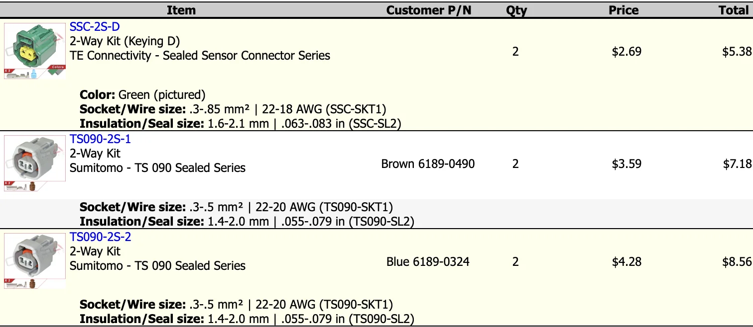

Found another great site that enables to order Toyota connector cheap
Taking no chance got the connector for the solenoid 4x4 and I was chassing the TEMP one and found it..
