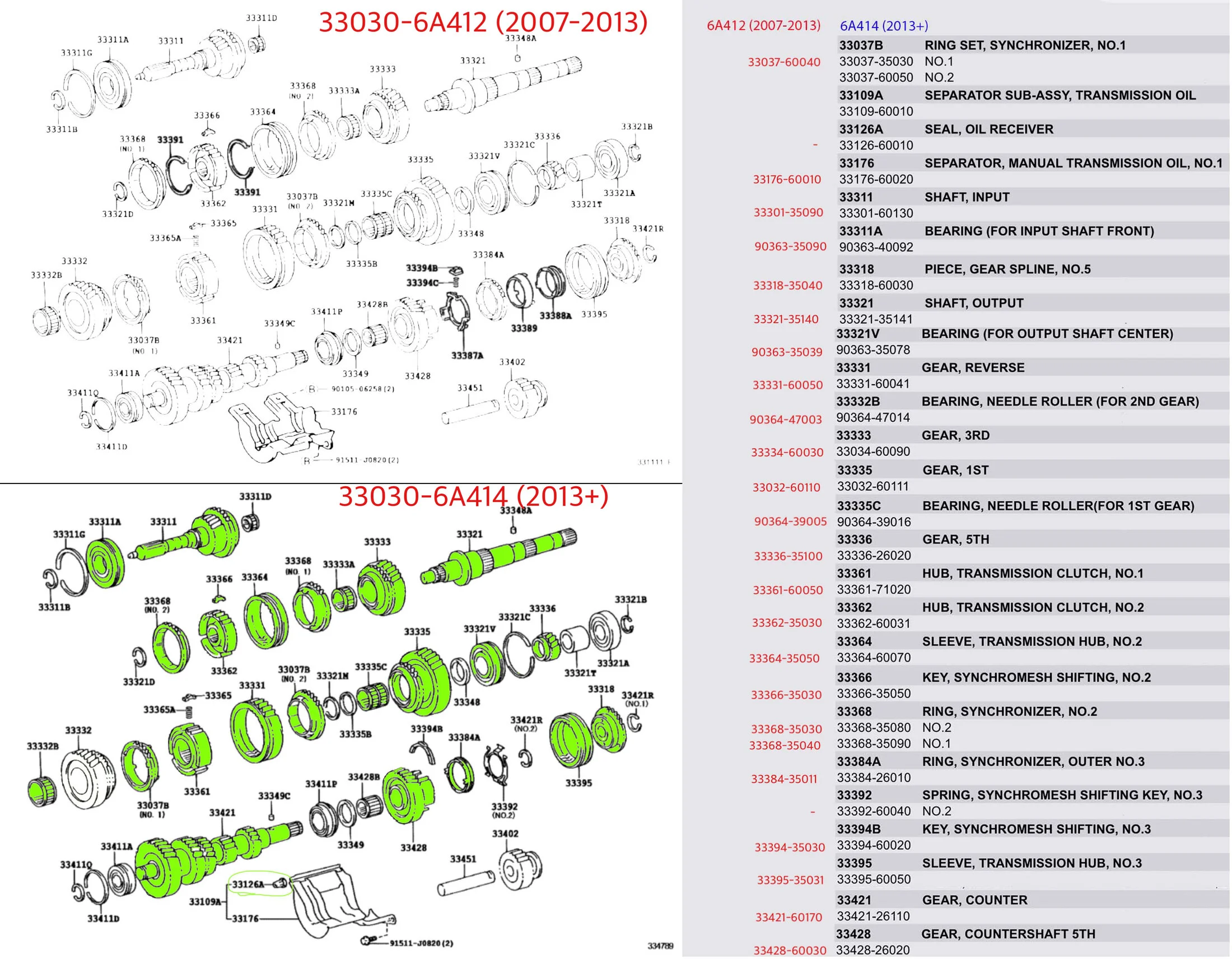

I’ve tried to check what was changed in R151F from 2007 for the LHD HZJ71.
The catalog shows that it was several R151F versions during this period. 33030-6A412 (2007-2013), 6A413 (2010-2013) and finally 33030-6A414 (2013+).
I’ve checked a difference between 2007 (6A412) and latest 2013+ (6A414). Major parts were updated (green color). I don’t know how big was a real upgrade vs just the number change, but I assume that the gearbox was heavily upgraded.
I am thinking to save some money and buy the latest R151F for my 1HZ.

Wow yeah this is great. Thanks for sending!
