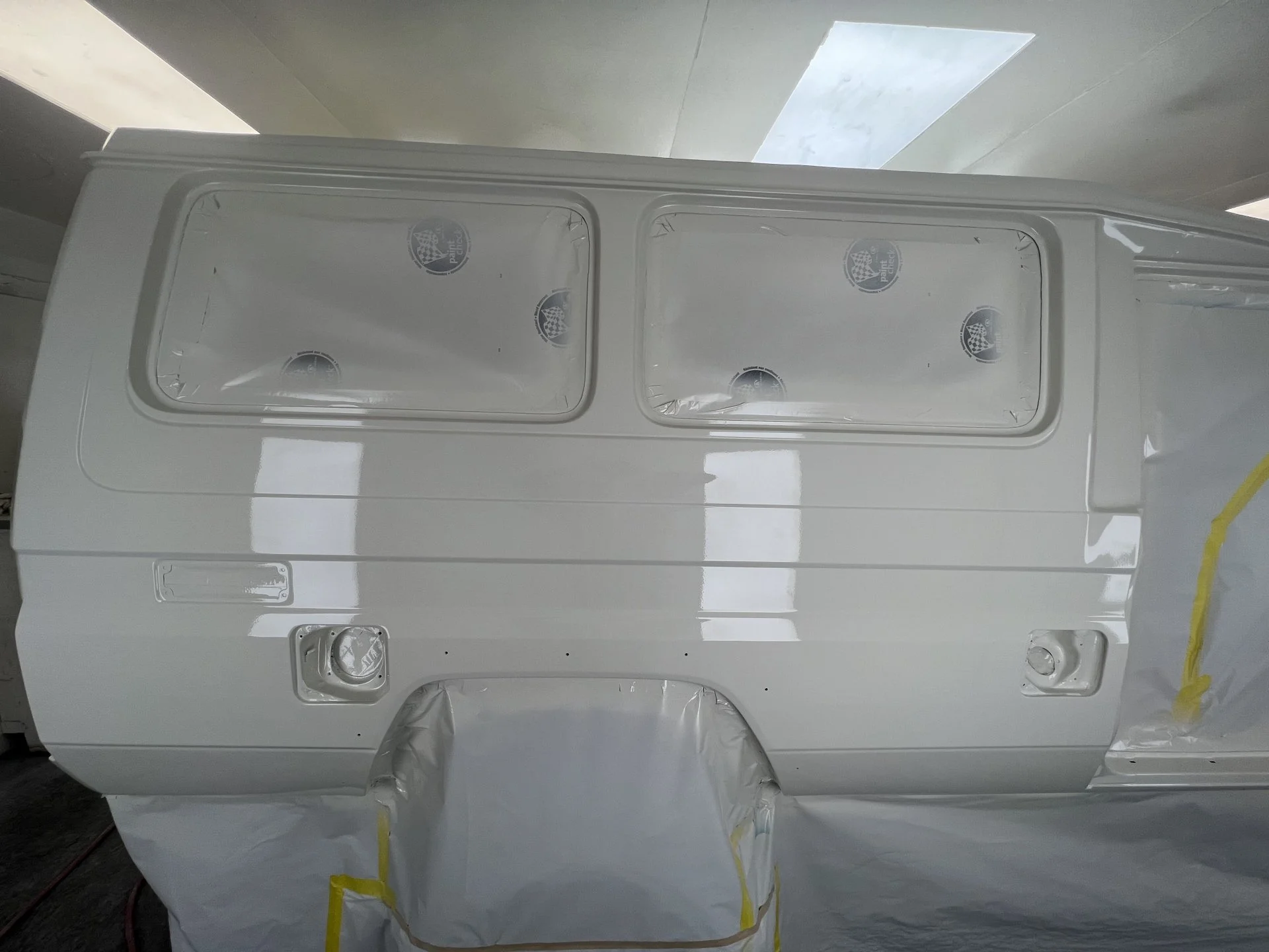

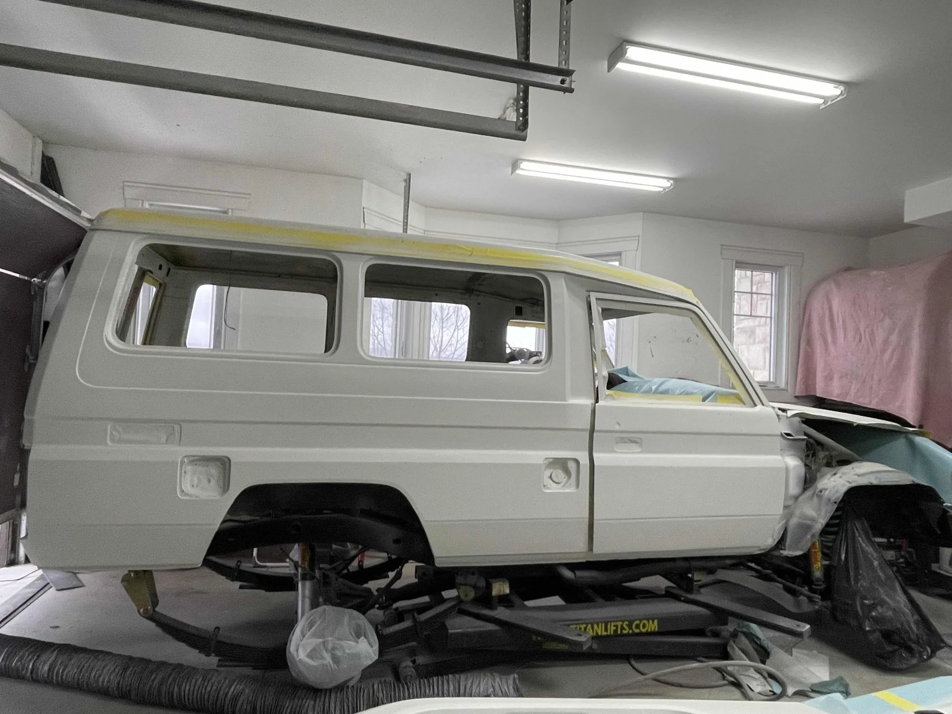

This is the 2-second coat of primer
BBQ TIME + SANDBLAST + RAPTOR FLOORS
IMRON PAINT

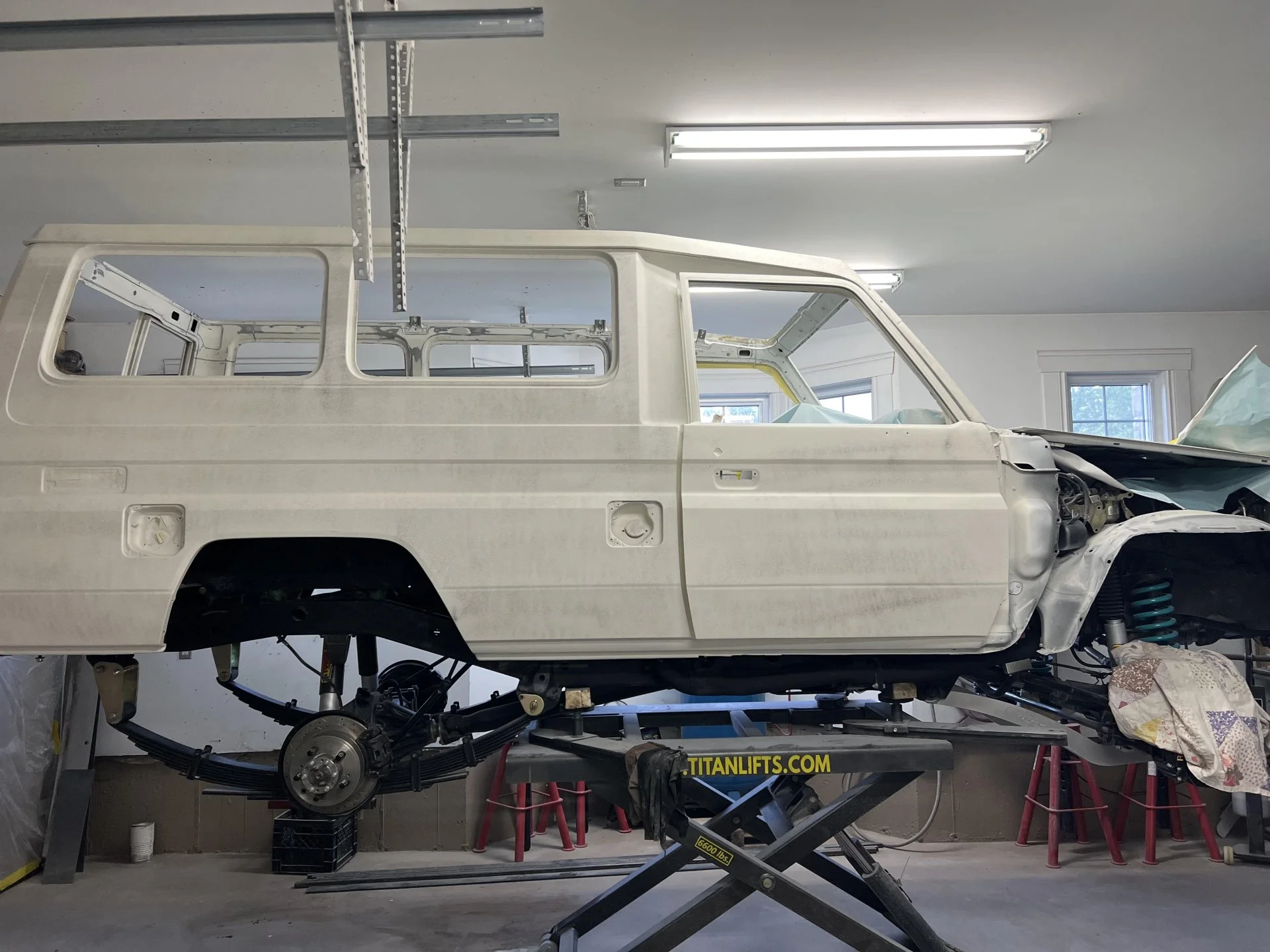

Here are a few pictures of my work this week and a short video too! Weekly update troops Lovers! Removing the diff
Rear Hub Rebuild waiting on the bearings and wheel studs

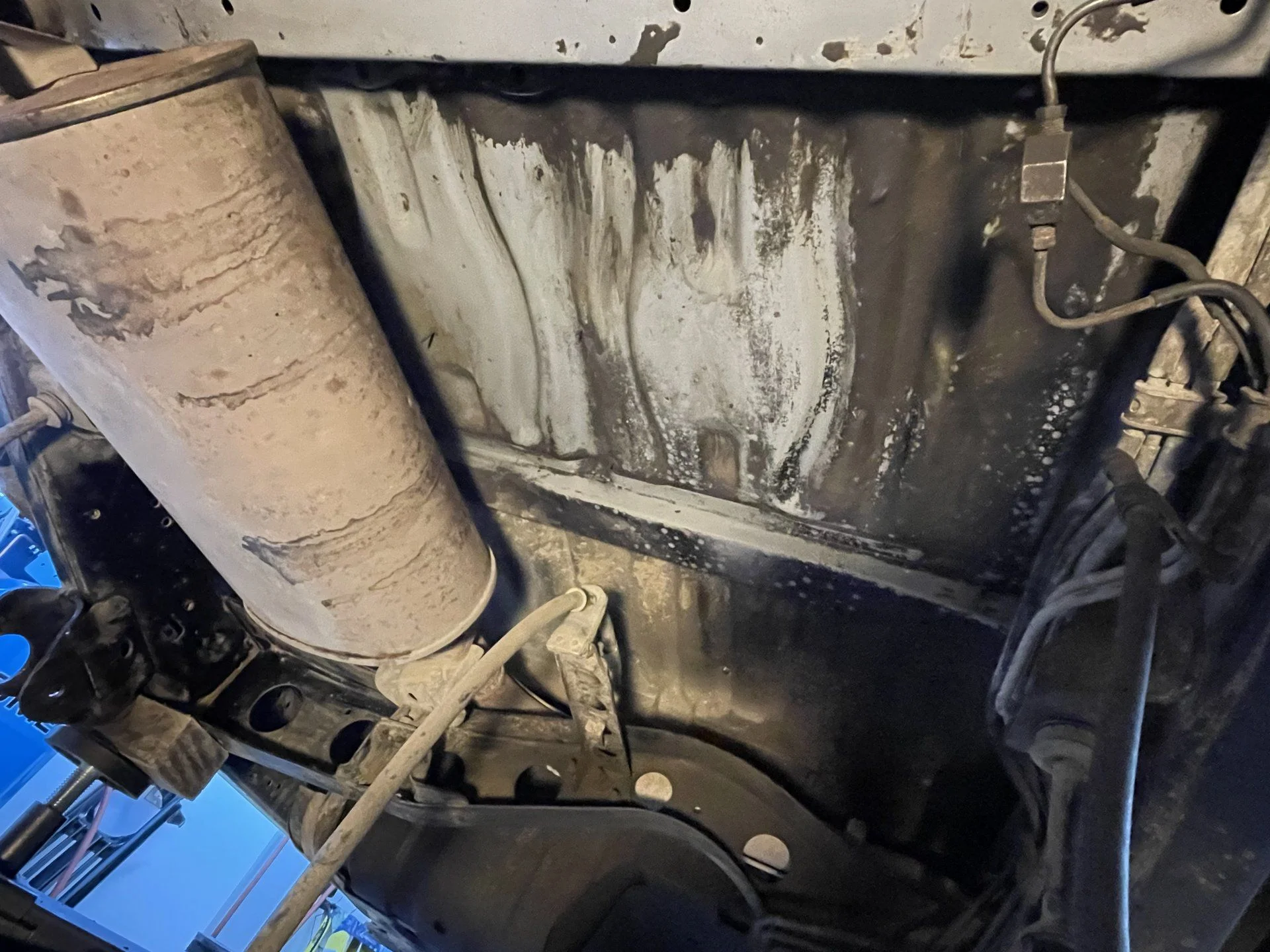

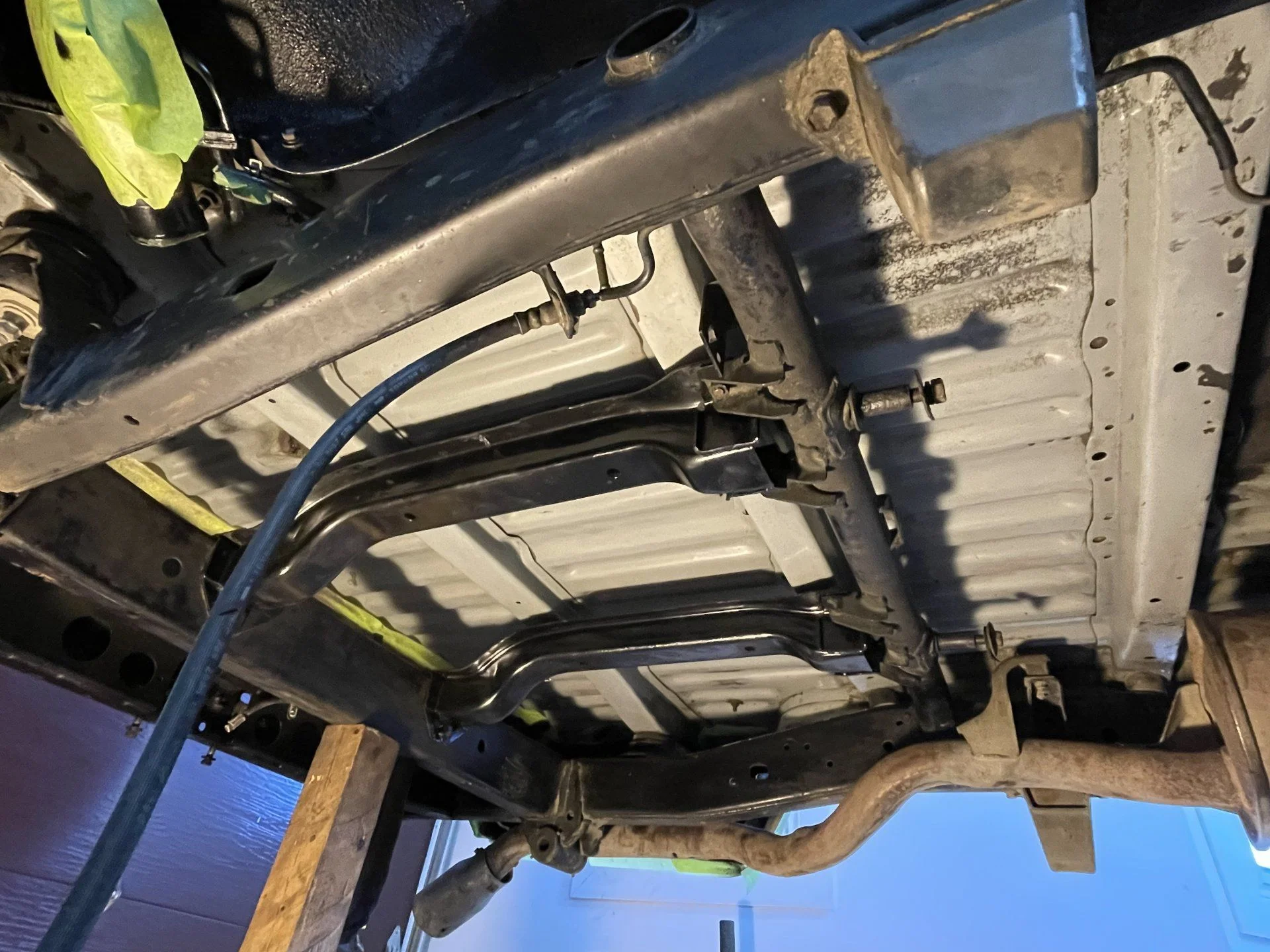

I am pretty done with the rear section undercarriage as been prep for the long ranger tank and now attacking the midsection of the undercarriage.
After cleaning rear section

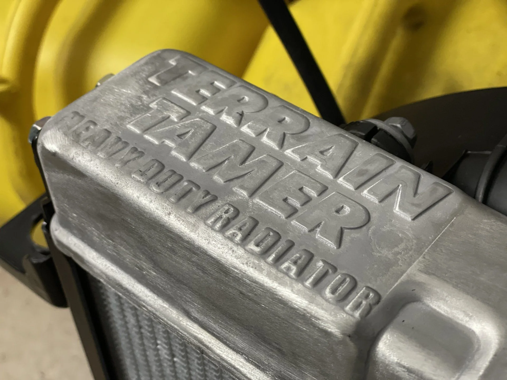

Got to install my new radiator too

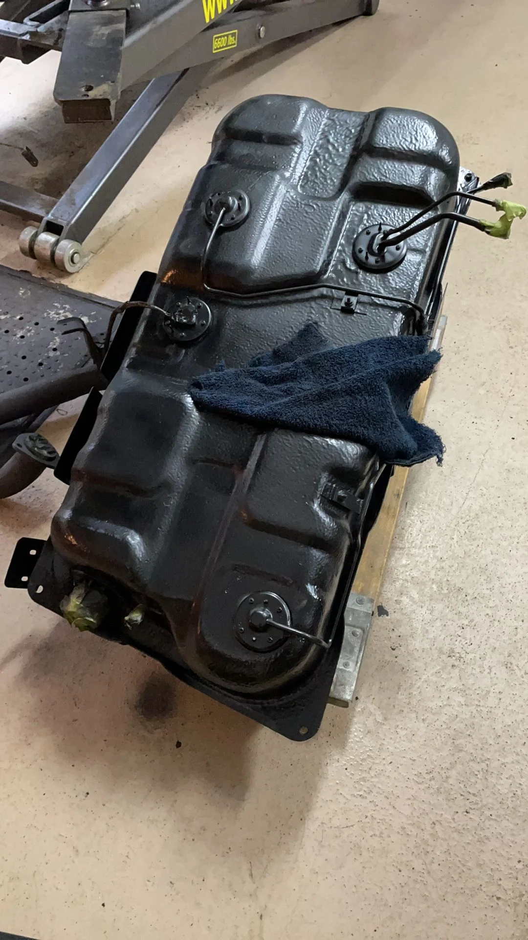

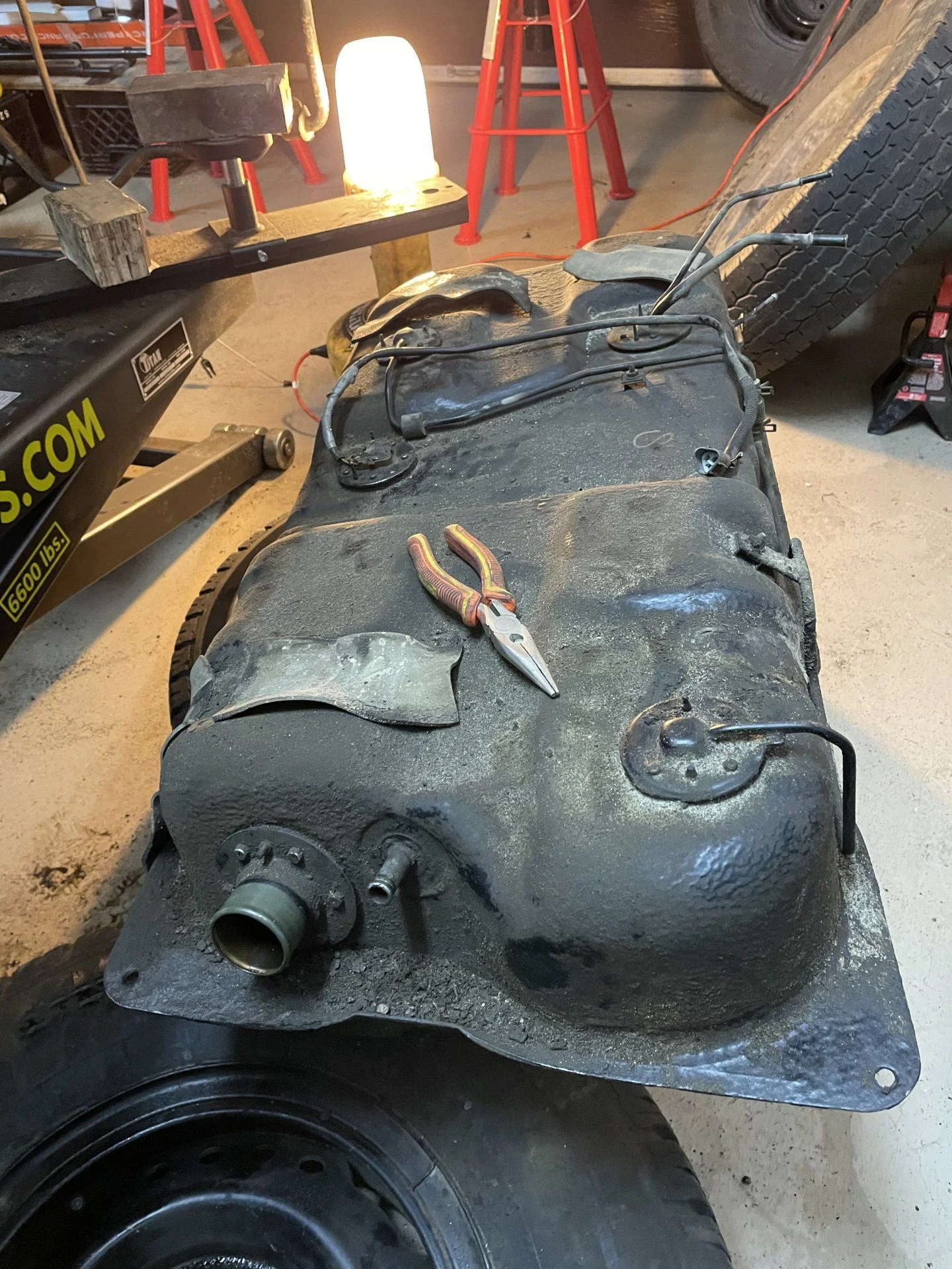

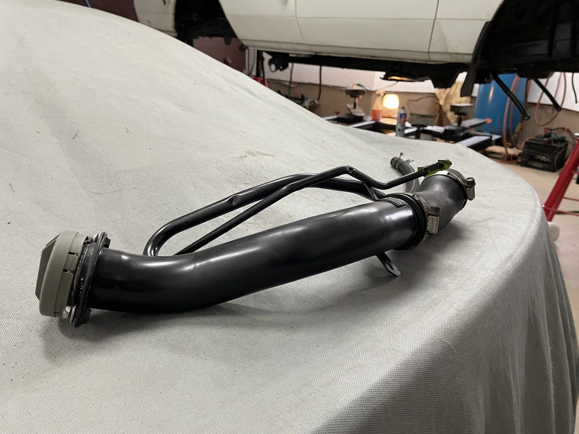

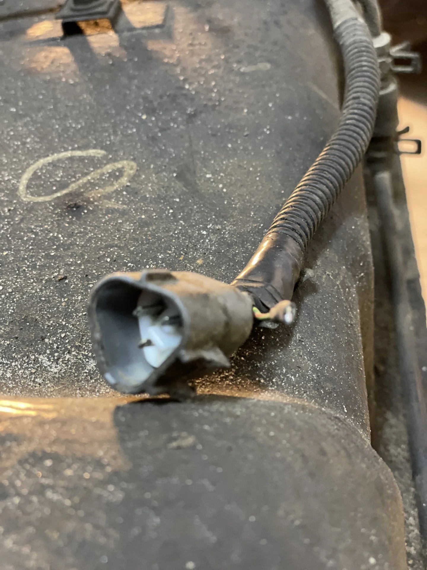

The Main Tank is out she was hard to pull. Would someone have the wiring harness diagram by any chance. The connector on the tank was redneck wired with an extra wire lol out of the 3 pin connector
Already,
I decided to keep the 90L main tank and restore it with a new sending unit, subfilter, and a general clean-up with muriatic acid...

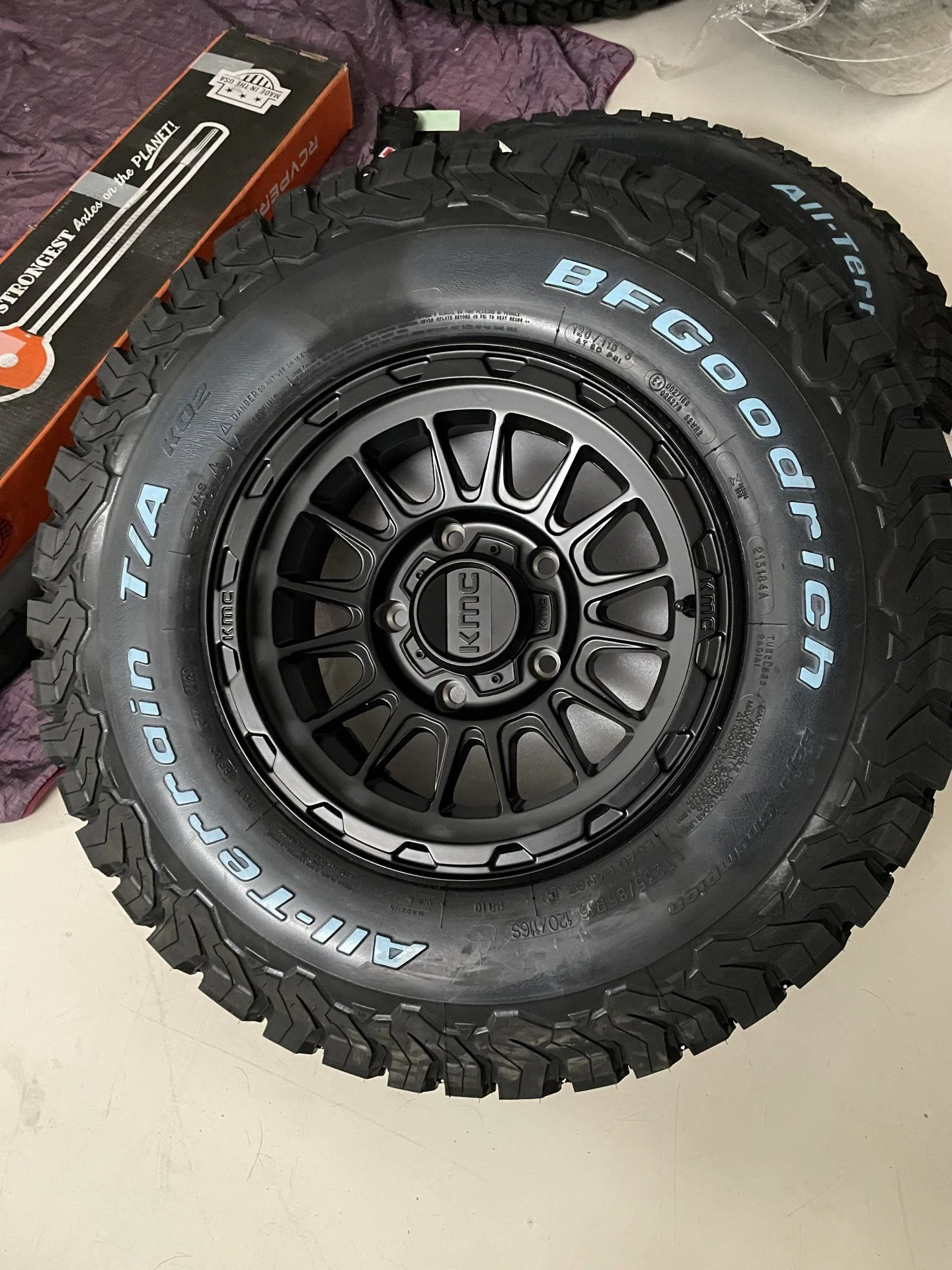

Got my 6 KMC 16" inch and tires to fit the rugged brake 6 pistons on the way
