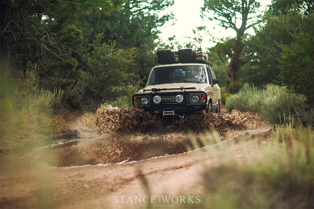

The trail to camp was relatively uneventful: a half hour, give or take, from the nearest paved road. Surprisingly, parts of the trail held standing water, but overall, it was a simple climb. Camp itself sat around 7,500ft.

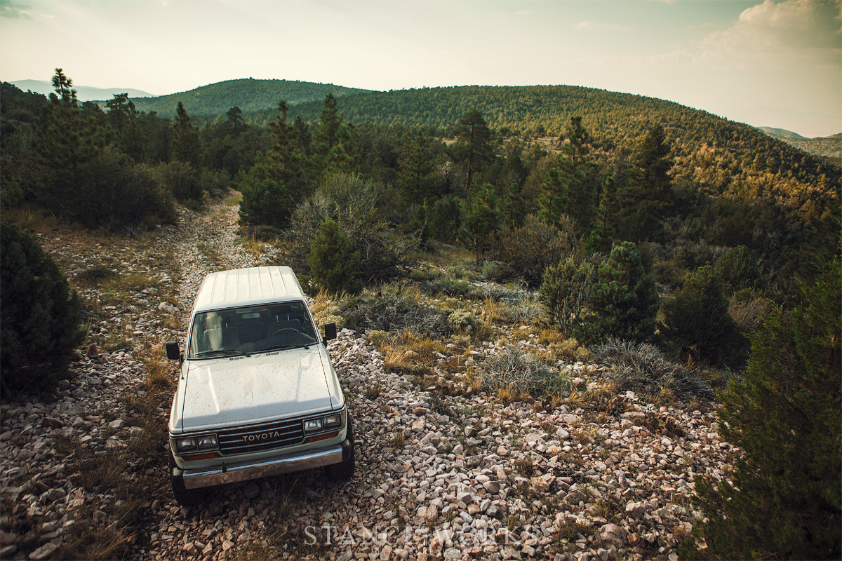

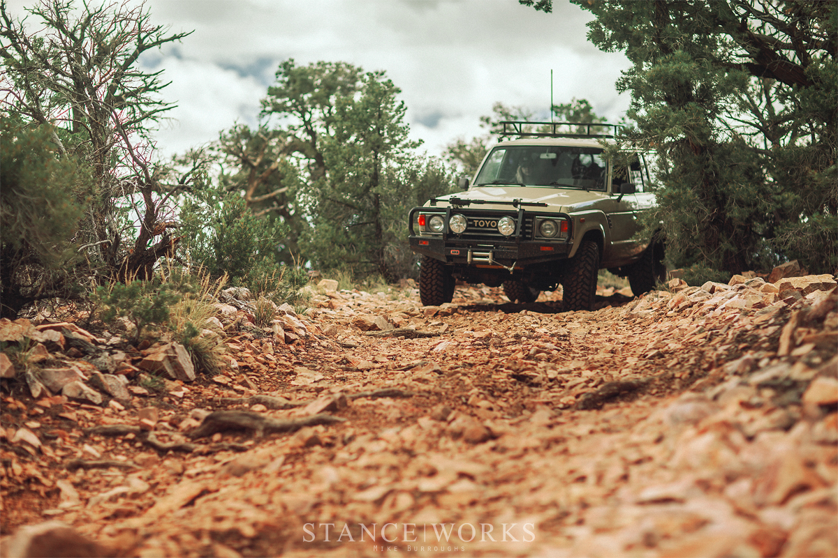

With a few hours of light left, and the trucks emptied, we decided to hit the trail - in our case, an unmarked one that we eventually established links to other trails nearby. It was a step up in challenge from our trail into camp; a loose bed of rocks established a path up the hillside, thin in spots but entirely navigable. We worked our way up, eager to see the view that potentially awaited us.
In a clearing, we took some time to admire the scene, unsure of what was still ahead on the trail. We wondered how often the trail was used - not another truck was in sight as we continued away from Big Bear. Eventually though, the path yielded exciting fruits for our labor.

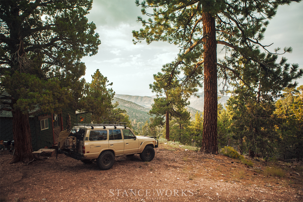

We eventually stumbled upon a cabin that had clearly seen better days. We're unsure of when it was built, with scribblings on the wall dating back as far as 32 years ago, but we assume it had been around a while before people began their scrawlings. We also wondered how it had been built; hauling the materials up the mountainside to build it was, no question, a serious endeavor.
Inside, it was largely dilapidated. A few supplies, like condiments, old water, and a partial first-aid kit gave some semblance of use, but the most recent expiration dates were years old. Writings on the wall ranged from lovely notes of family trips and efforts to care for the cabin, while others delved into depravity and profanity. It's not a place I'd be quick to stay, but it was a wonderful find nevertheless. A few guest books sat on the table. We left our mark on the only empty page we could find, and enjoyed the setting and view. We were now somewhere around 8,000 ft.

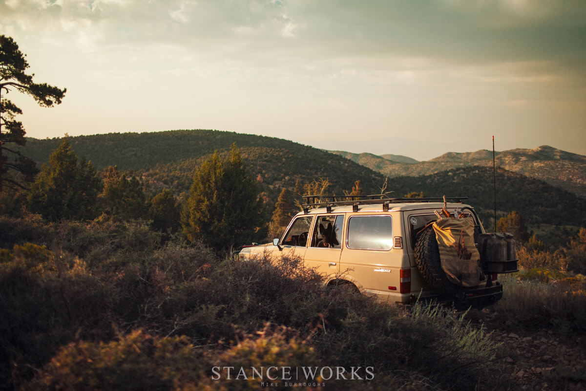

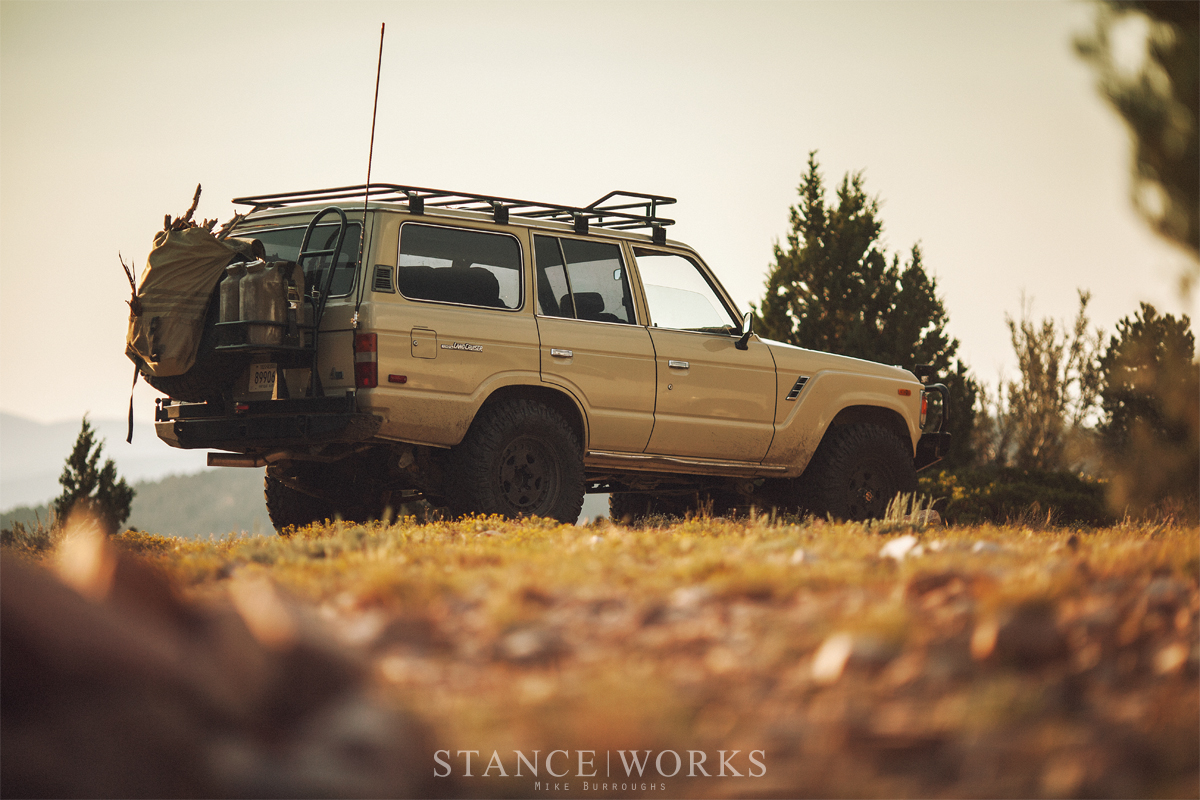

We continued up the trial a bit more, eventually settling in a clearing atop a mountain peak. 8,200ft on the altimeter put us a good bit above the town of big bear, and the view was a welcome reward for the drive. In one direction was Big Bear Lake. In the other, the Mojave desert, and we could see for what seemed like a million miles.

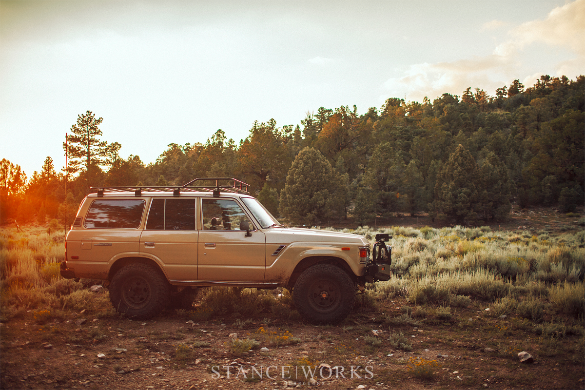

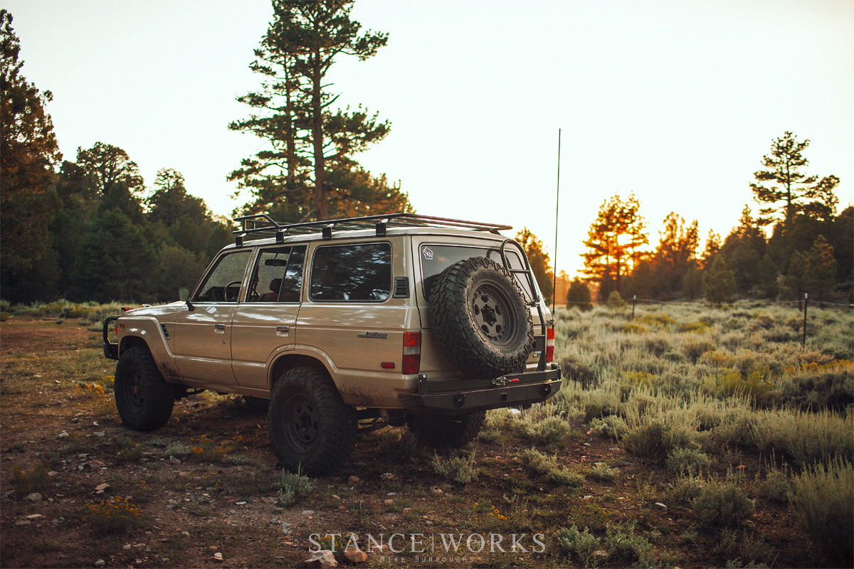

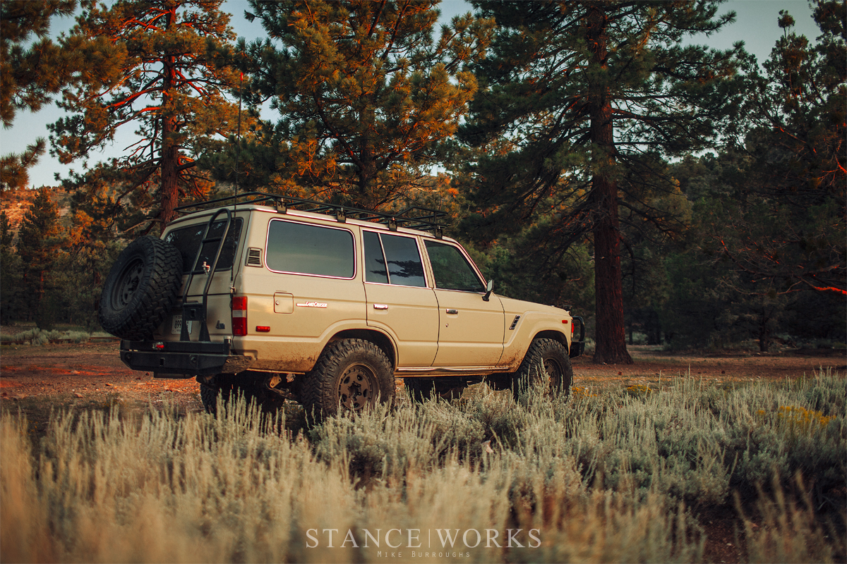

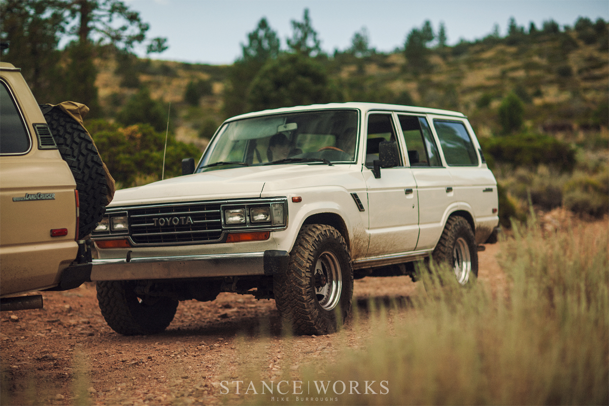

We enjoyed the setting sun, and of course, I couldn't help but snap some photos of the Land Cruisers at the peak. Both trucks made the climb with little effort - the V8 gave me more than enough torque to make the climb in 2WD, and despite a short bout in 4-LO, the FJ62 hung right on my bumper. Both trucks are equipped with Nitto's Trail Grappler: 33" tires on Jeremy's white 62, and 34s on mine. Having had so much luck with them on my own FJ62, and having sold the wheel and tire setup to Jeremy last year, I was quick to opt for them once more. Their traction is incredible, with tread blocks rolling over the sidewalls of the tire, moving limits of the truck to drivelines and differential setups instead of grip, where it counts. Needless to say, they make the trucks look great too.

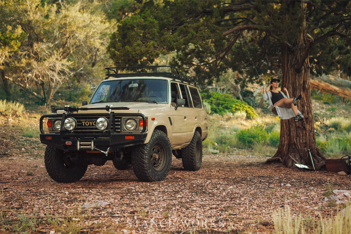

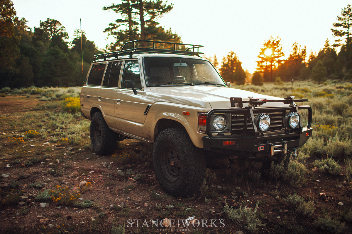

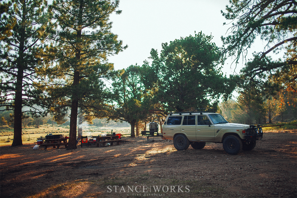

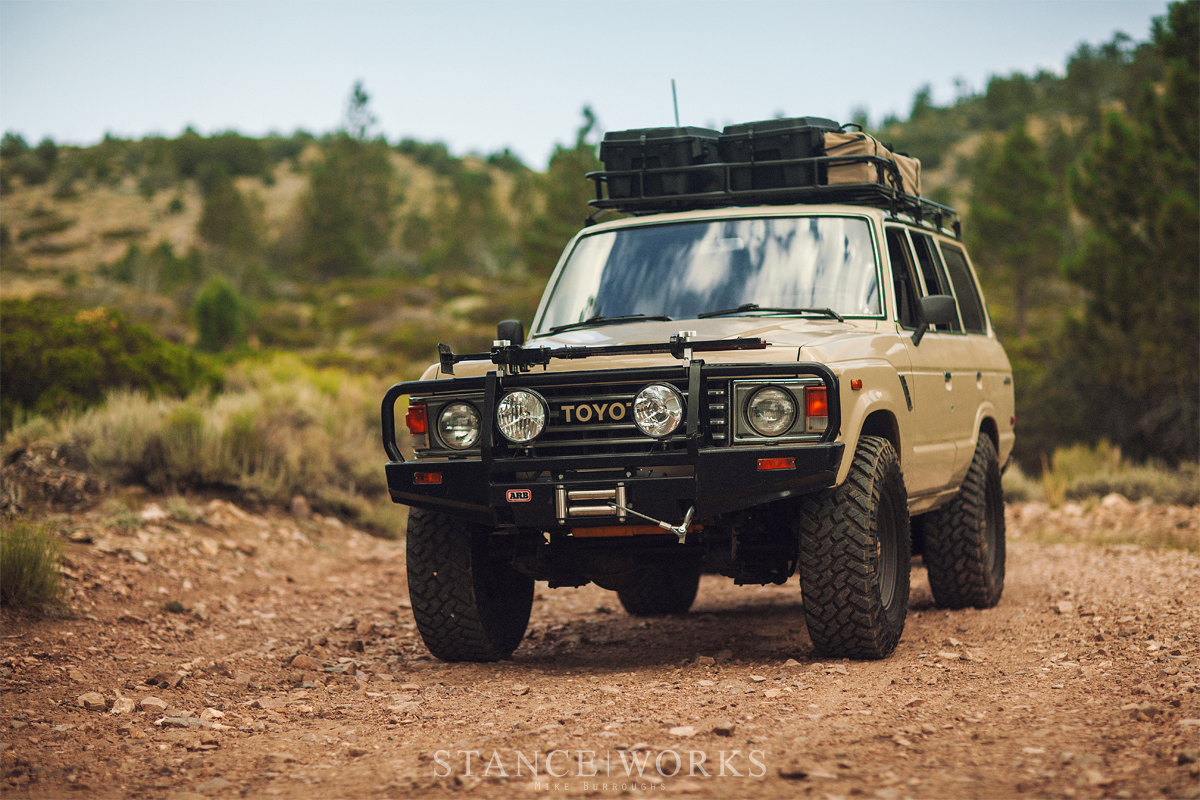

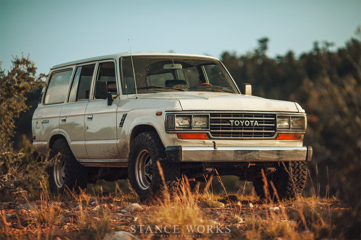

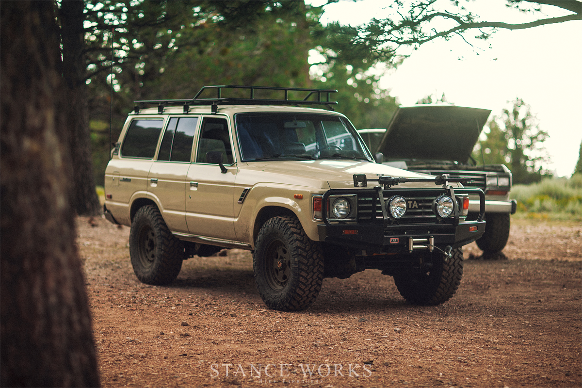

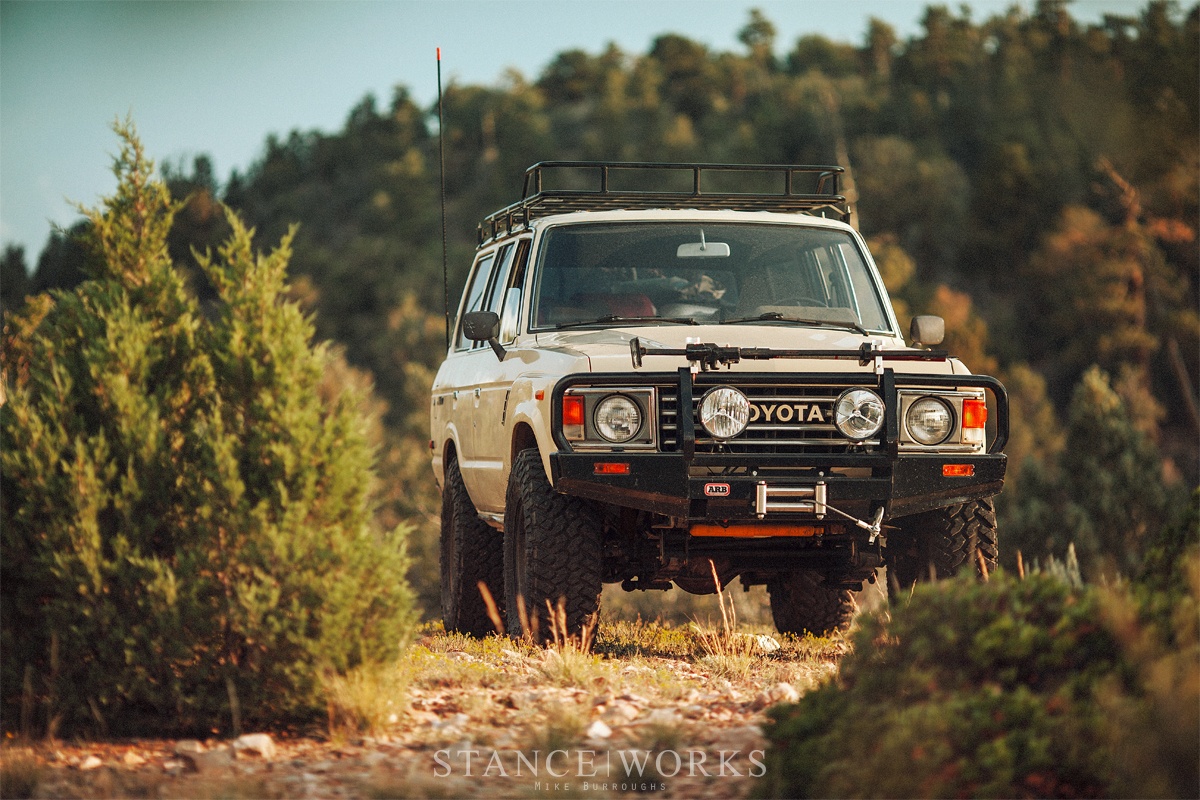

Once back at camp, I selfishly took the chance to snap some photos of my truck with the setting sun. Having been so hard at work to finish it, it was my first chance to admire it. The ARB front bumper, pulled from my old FJ62, looked right at home, finishing off the "face" of the truck. The IPF lights play well with the round headlamps, and throw an enormous amount of light when fired up.

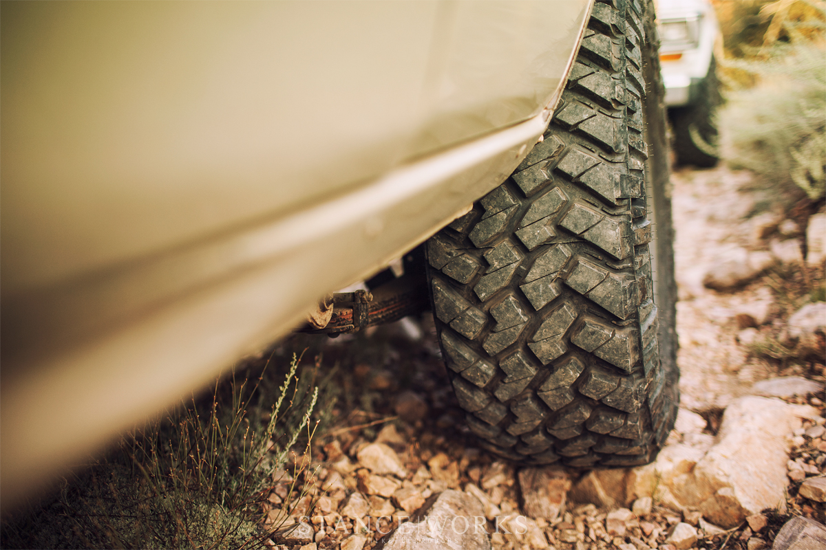

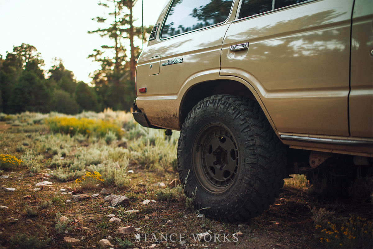

One of the parts I'm most excited about on the truck is the wheels. The Trail Grapplers wrap a set of forged Fifteen52 Turbomac HDs finished in a textured bronze. After dreaming for what seemed like an eon, the wheels were finally delivered, and suit the truck perfectly for what I had in mind. Measuring out to 17x8 et+10, they fit perfectly too. The stepped lip and small center keep the 17s from feeling too large, aesthetically, making for a wheel-and-tire package I've been anticipating for years.

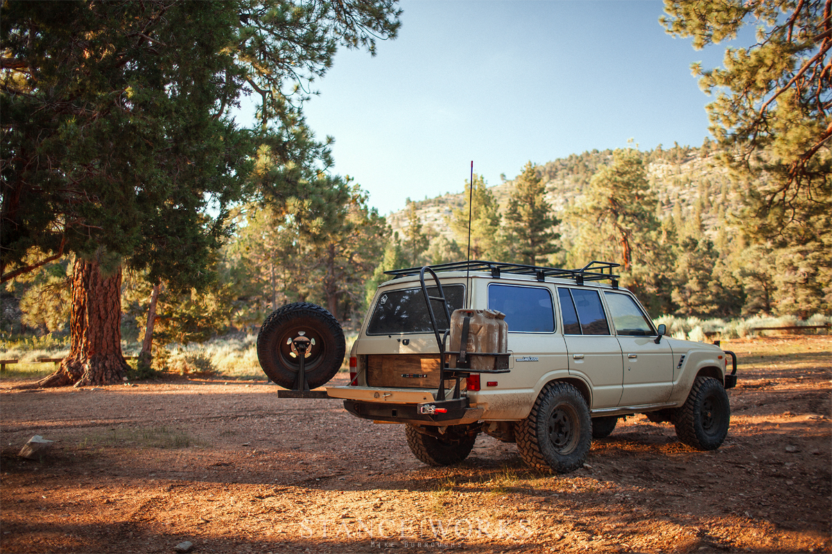

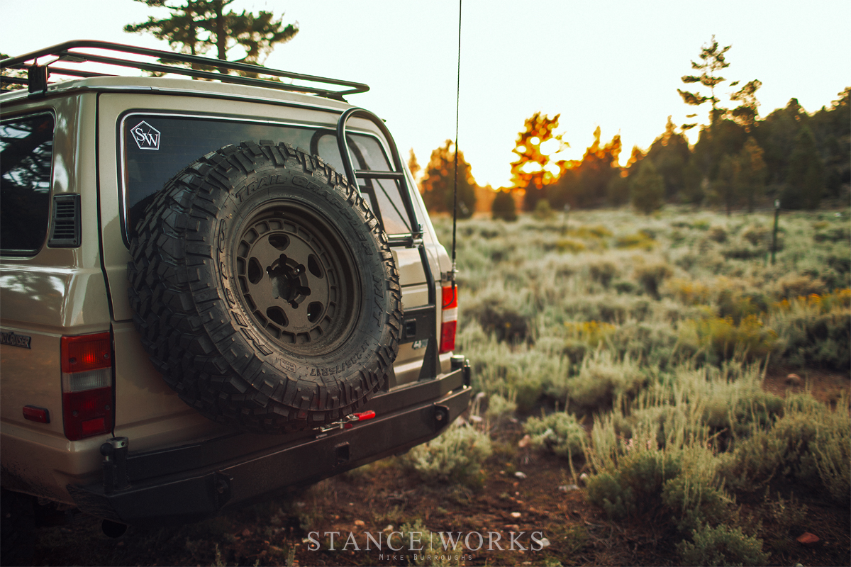

At the back of the truck, I mounted the rear bumper from my FJ62 as well, sporting a matching spare Fifteen52. With as happy as I was with the Old Man Emu lift on my FJ62, it was an obvious choice for the FJ60 as well. The OME lift gives the truck the height needed to fit the wheel and tire package, and gives it the clearance to tackle the types of trails I'm after, too. It also rides well, needless to say. There's still more on the to-do list, of course, but the truck is really coming along - it's everything I had wanted from my FJ62, and then some.

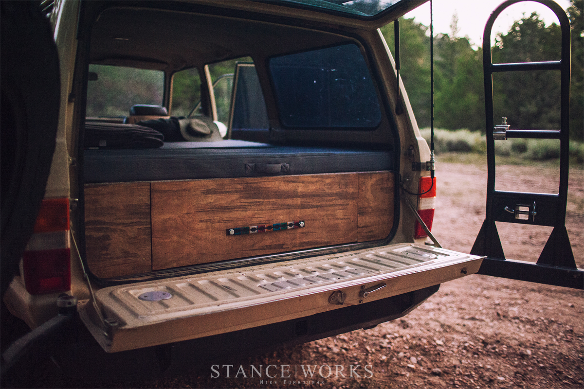

While Josh set up his tent, I set up camp for Emily, Chloe, and I in the truck. Over the past couple of weeks, I worked with a friend to build a foldable sleeping platform/storage system. Topped with a 3" memory foam mattress, it made for the best night of sleep I've ever had while camping. Underneath, in the drawer and storage compartments, I keep a slew of recovery and camping gear, which made access and setting up camp a breeze.
