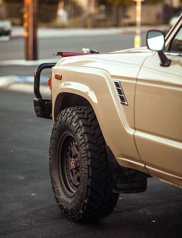

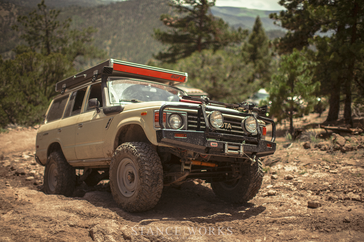

What OME lift do you have? Do the 34's rub when flexed? Love the look and stance!
I have the OME HD lift and CCOT lift shackles. I had to cut the fronts of my front fenders for clearance but otherwise, no. Thanks!

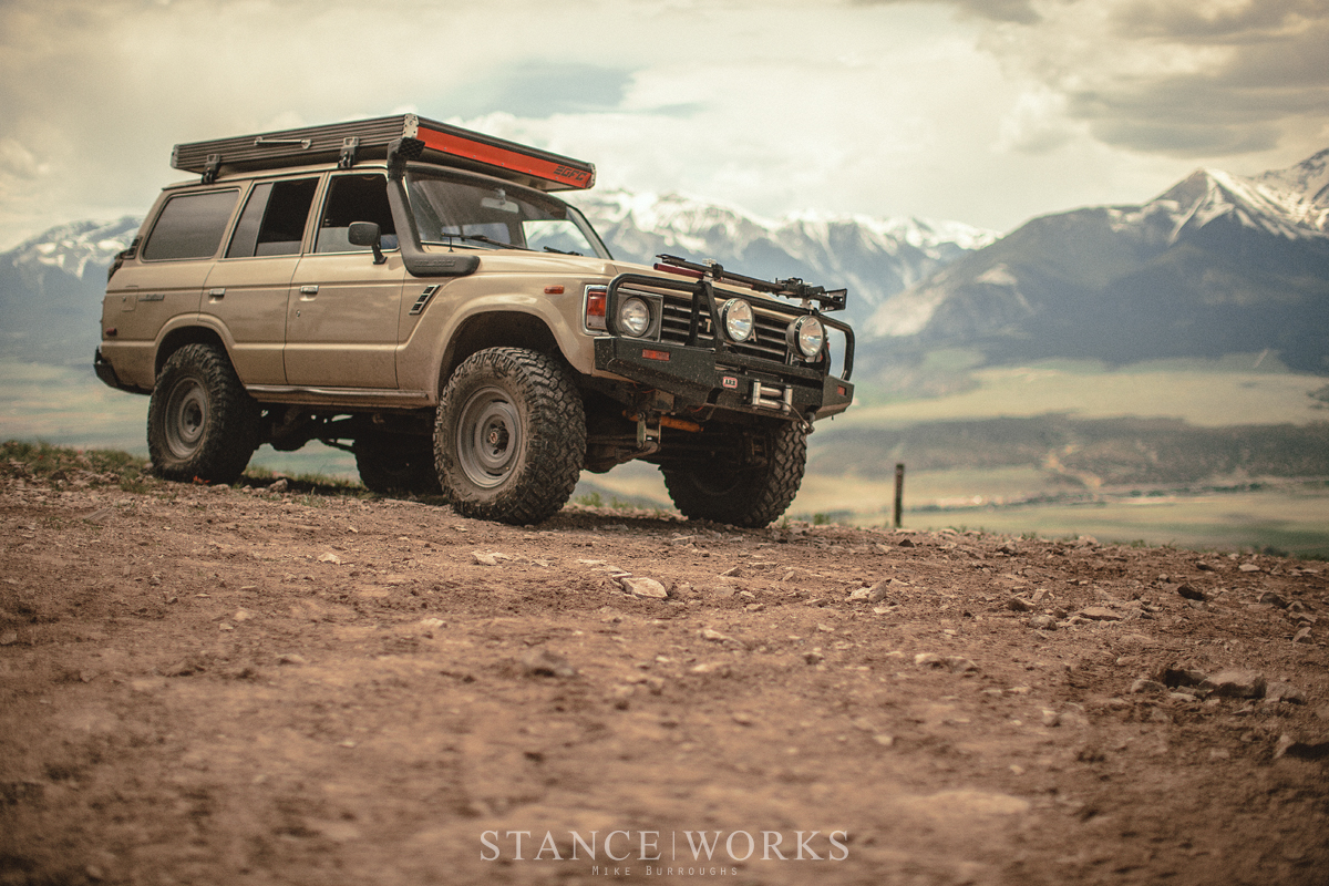

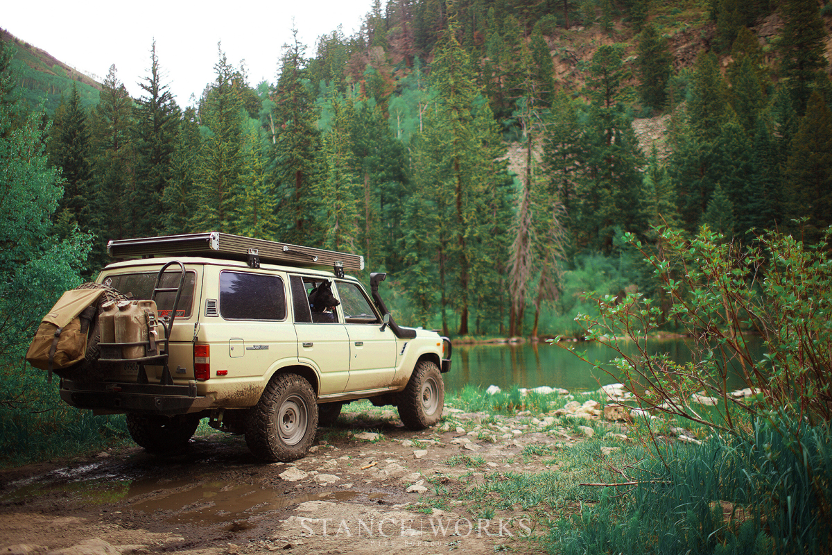

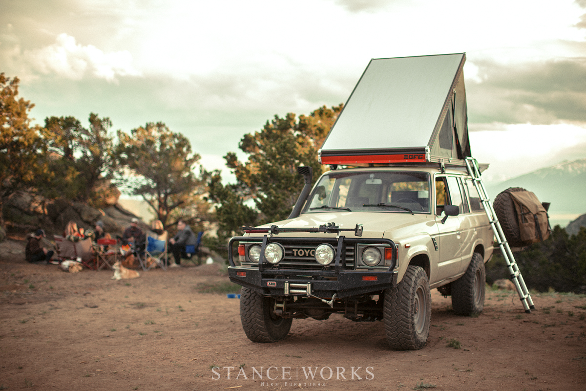

I haven't done a good job of updating this thread, but I've been enjoying the truck, of course! Still drive her every day. I've made some changes lately, most notably with lift shackles, new wheels, and a GFC tent/Dometic fridge out back. Here are some pics (and some links to my recent trip report, which I need to finish up!)
Gorgeous 60 series. I'm strongly considering moving to the GFC with my 80 series. As the 80 is also gutter mount, can you fill us in a bit re. the gutter mount system? Did the mounts come from GFC or was it a custom job? I would also like to go gutter/tent only with no separate bars or roof rack.
Answered my own question. Wicked simple solutions are the best. I'm all over reducing roof loads.

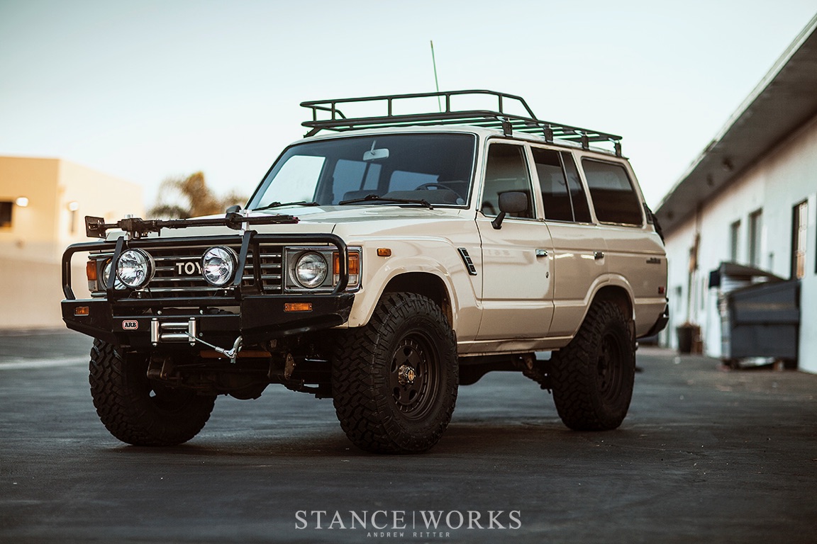

I'm sad I don't have a lot of progress pics to share, but the truck is finally together and running/driving well.

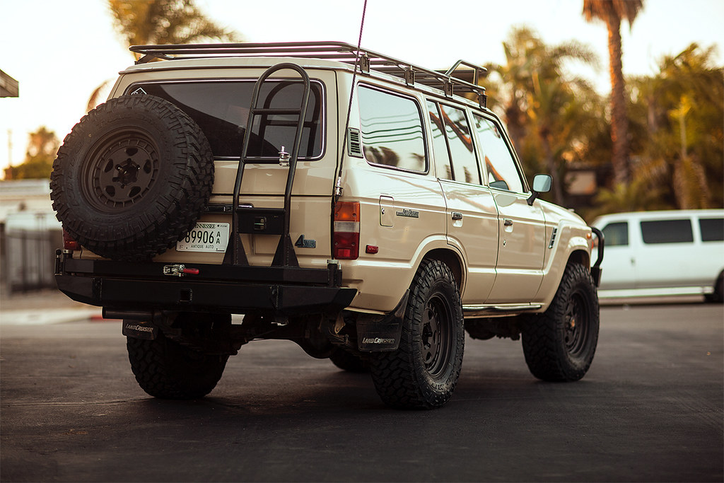

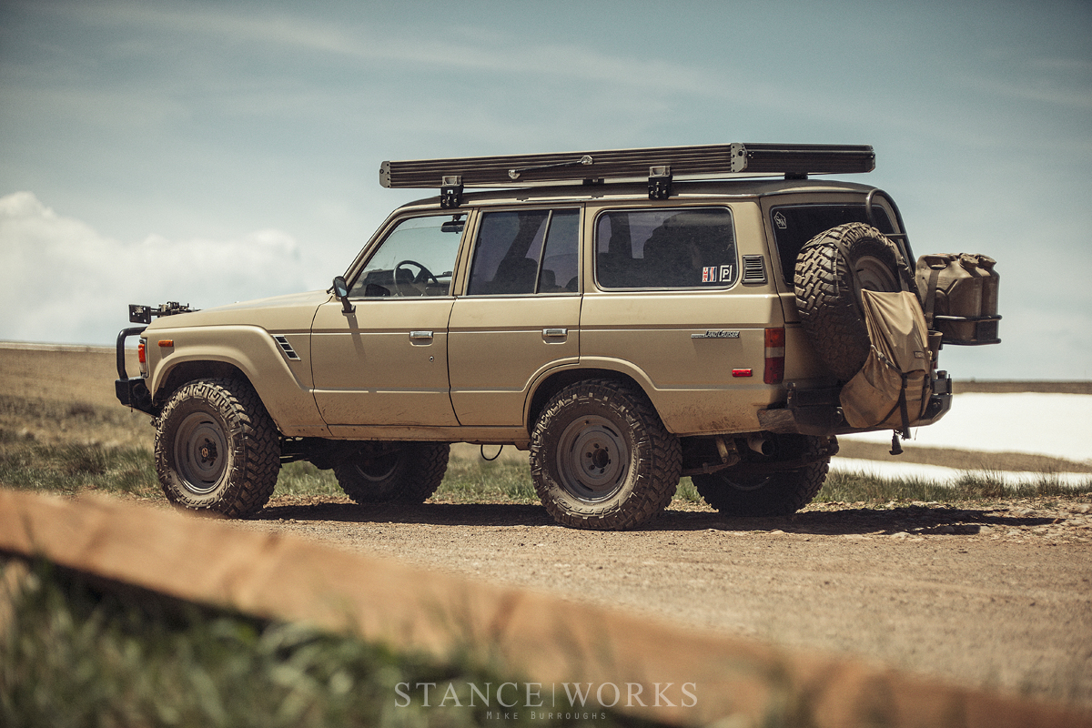

I pulled my front and rear bumper off my old FJ62, and built a roof rack. The wheels are forged Fifteen52 Turbomac HDs wrapped in 34" Nitto Trail Grapplers.
The truck is running perfect, the AC is blowing ice cold, and I'm really happy with how its coming together, save for a bit of noise coming from my transfer case, but nothing bad.

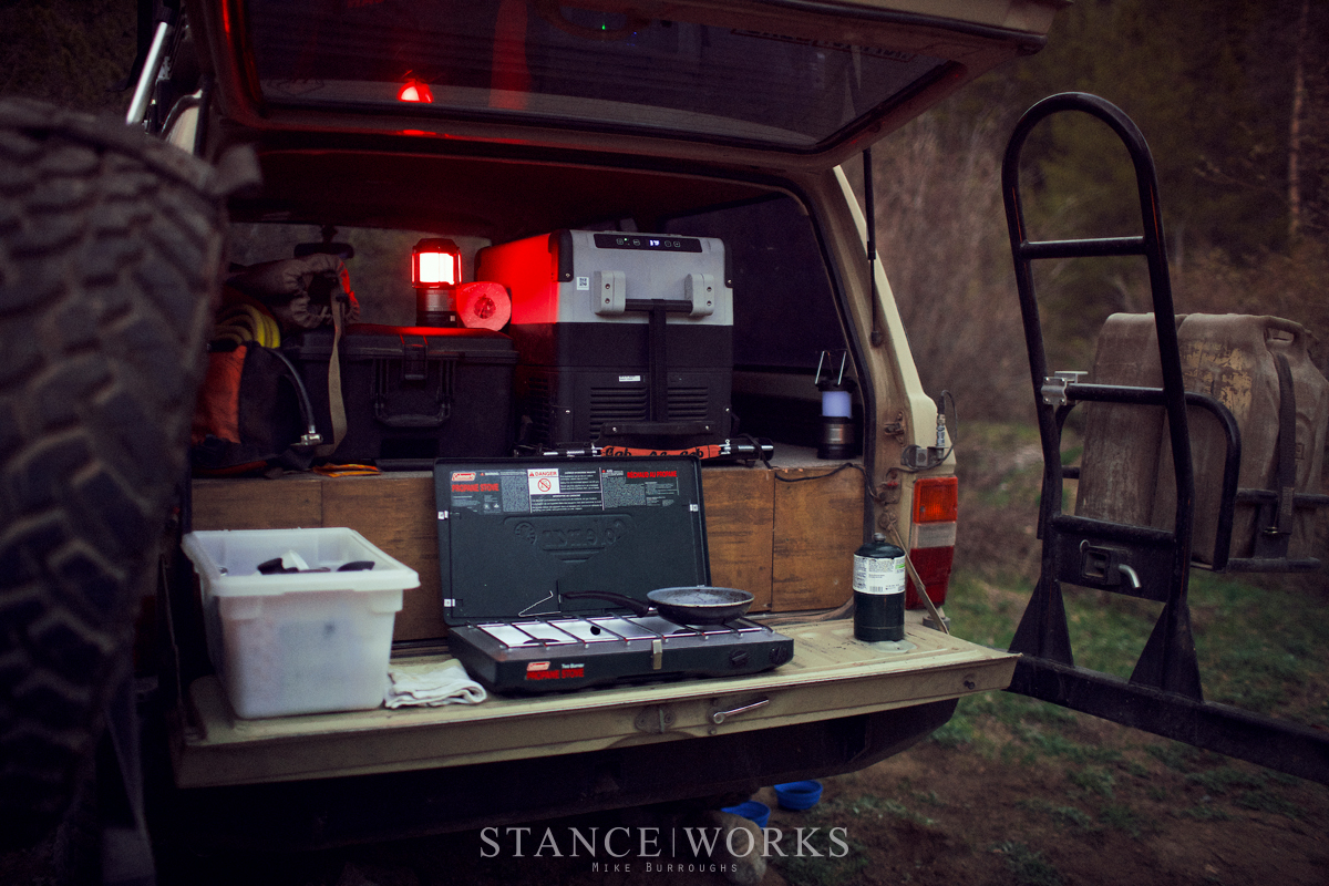

I'll be taking it out on my first trip this weekend, so I'll report back with more photos and updates. I build a storage/bed system in the back of the truck that I'm excited to share.

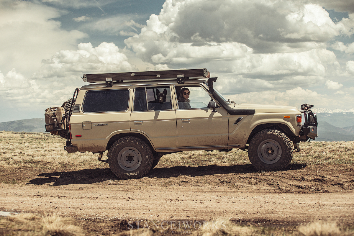

Loved reading your build. I know this is an older thread, but can you tell me the roof rack you had in these photos? Thanks!
I would be shocked if Mike Burroughs replied or is even active on ih8mud anymore. I dont know if hes even got this car anymore. You can catch up wit his stuff here:
Yeah looks like he hasnt been active here for about a year. Figured it was worth a shot. Thanks for the link.
