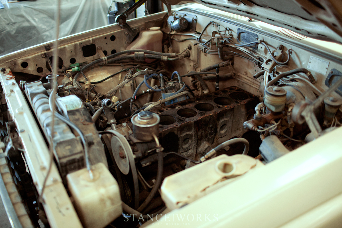

With affinity for these trucks at an all time high, their prices are through the roof. For me, luck came in the form of a dead engine. While the truck's bones were solid, the cylinder head had cracked three years ago, and it had sat motionless ever since. I bought the truck not running at a price that was more than agreeable, dead set on transforming it into something daily-driver friendly, powerful, economic, and badass, to be frank. I wanted a truck that could tow my cars to the track, get itself out of its own way on the freeway, and that could manage more than 12MPG downhill. The 2F and 3FE engines of the 60 series here in America are phenomenal motors - some of the most reliable, indestructible motors ever built - but they produce about 140 horsepower, and can struggle to make it up the slightest of hills when not in 4-Low.

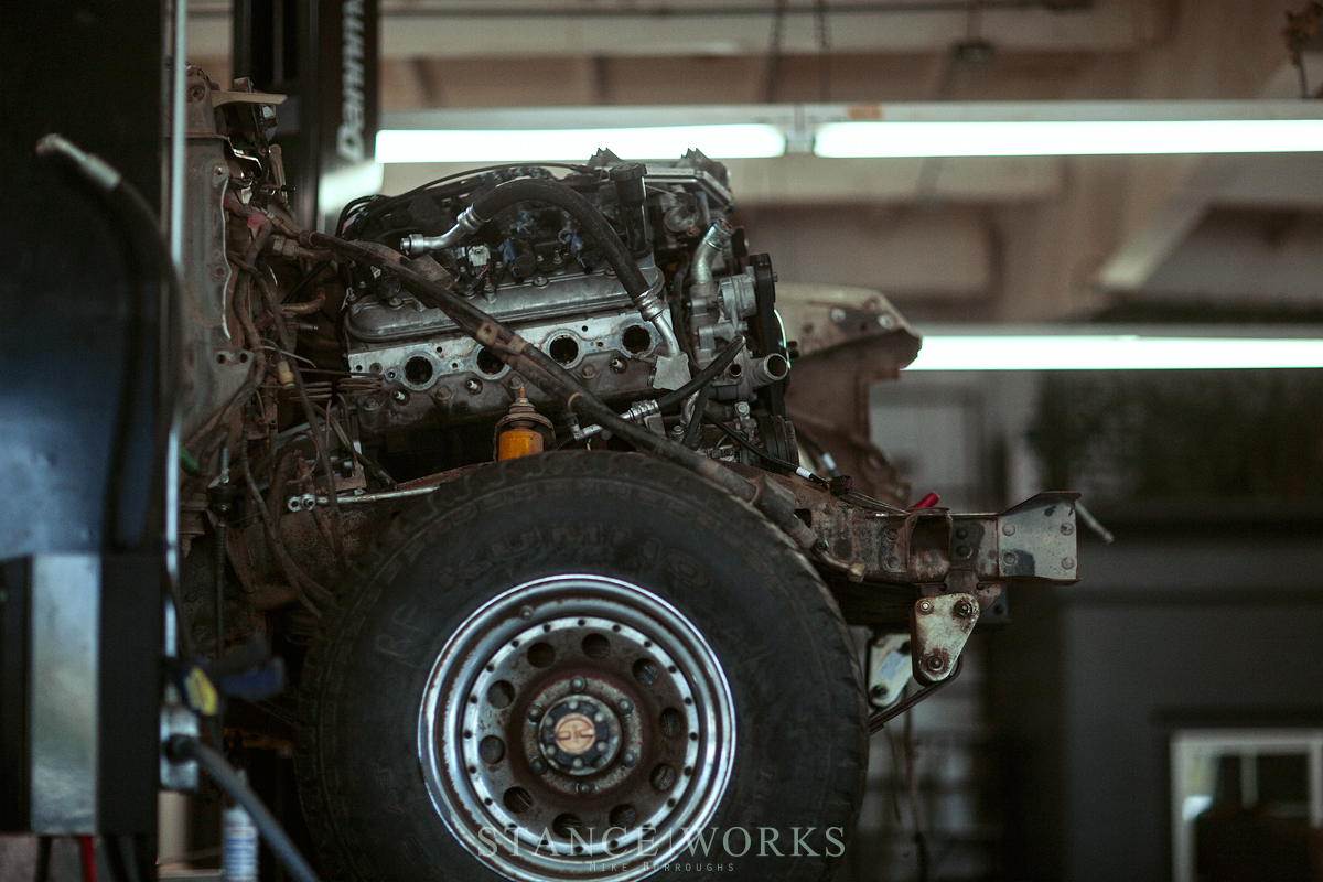

My solution is with the tried and true: I'm partway through swapping in a 6-liter Chevy LS. The motor is an LQ4, pulled from a Chevy 2500 Express van with just 70,000 miles. She'll make more than enough to tow the BMW to the track, or to make for a comfortable cross-country drive.

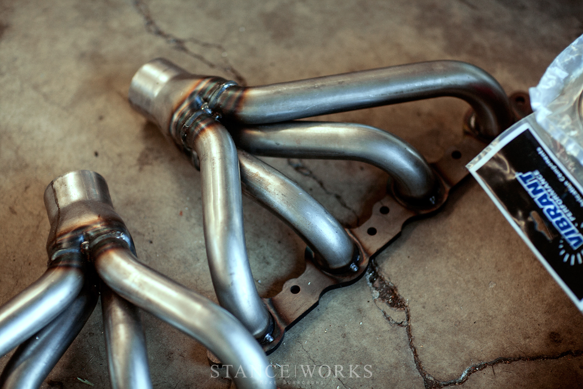

Making the engine work in the chassis isn't all too difficult on paper, with a few important components needed to mate things together. The biggest on the list is a transmission-to-transfer case adapter, which will mate my brand new built-up 4L65E automatic up to the FJ60's stock transfer case. Although the FJ60 was originally a manual, I opted to swap to automatic, as when finished, this truck will be a daily driver, and an off road rig.

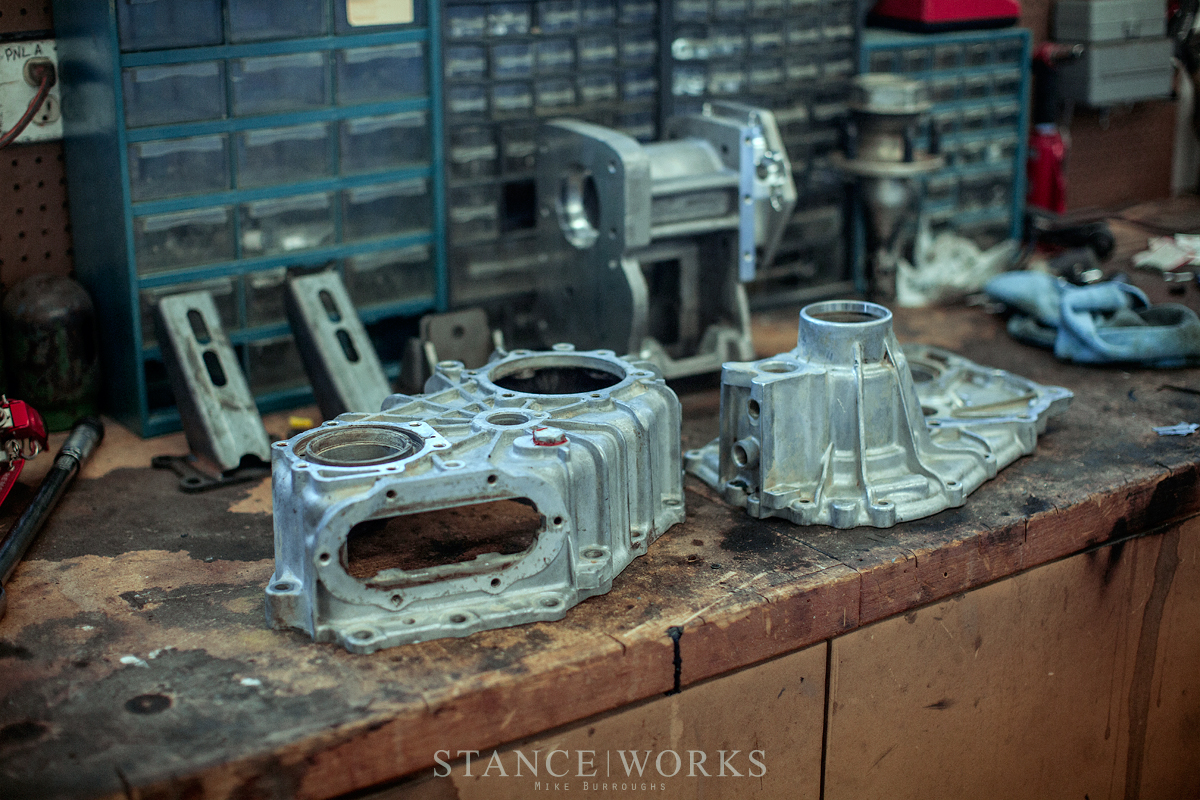

I've gone through and have been replacing and rebuilding all of the components as the swap has progressed. A complete transfer case tear down and rebuild was first on the list, followed by assembling the adapter housing, mating it to the new transmission, and then to the 6-liter itself. A good bit of fabrication has been needed to actually mount the engine into the truck, but thankfully, I've knocked that out already. To be completely honest, it's more work than I anticipated. I've done plenty of swaps before, but no one seems to really talk about clearance for the front driveshaft to the transmission, exhaust, and to the oil pan itself. It's taken a lot of work to get everything to fit - I know I've got my engine sitting a bit further forward than is traditional, but it still seems surprising what it has taken to make sure everything will work correctly, as if it were factory.
Things like mating the FJ60 fuel system to the V8, or hooking up the power steering, are most of what remains. A small bit of wiring lies ahead of me, but all in all, the swap is nearing completion, and once finished, I excitedly get to move on to fitting the truck with new forged and 34" Nitto tires.

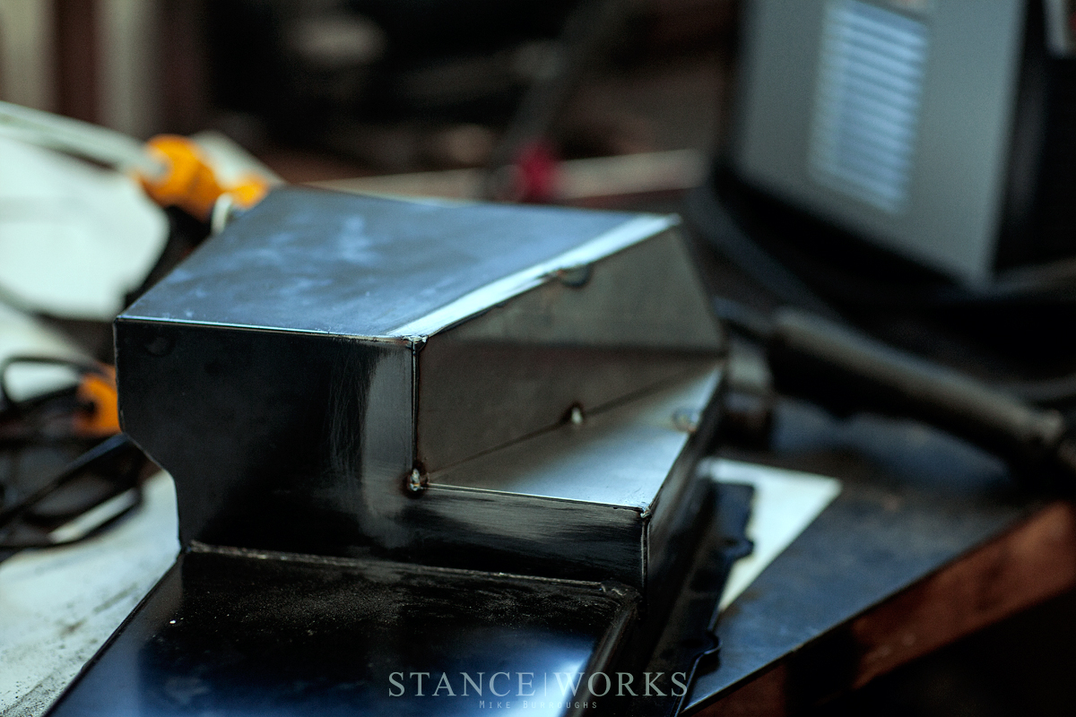

Since this is a build thread and aesthetics aren't the most important thing in the world, I'll post some cell phone pics as I finish up the swap. I'm hoping to fire it up and test drive it this weekend.

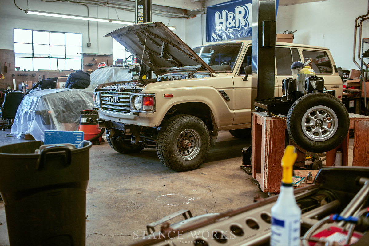

Thanks everyone! I got it fired up yesterday, and am hoping to have everything wrapped up by this weekend. The main hurdle left is I have to drop the exhaust and get it ceramic coated, and that has a week turnaround between the application and the dry time.
I'm sad I don't have a lot of progress pics to share, but the truck is finally together and running/driving well.

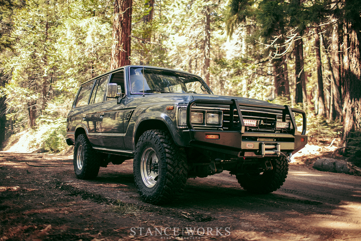

I pulled my front and rear bumper off my old FJ62, and built a roof rack. The wheels are forged Fifteen52 Turbomac HDs wrapped in 34" Nitto Trail Grapplers.
The truck is running perfect, the AC is blowing ice cold, and I'm really happy with how its coming together, save for a bit of noise coming from my transfer case, but nothing bad.

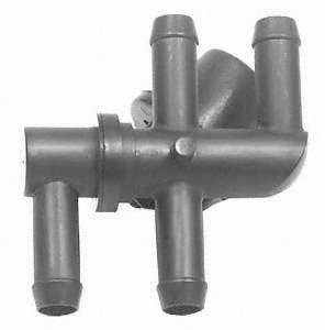

I used a heater bypass valve, and you can get them in vacuum or cable-operated.
https://www.amazon.com/Old-Air-Products-25-1018-Operated/dp/B00LEUVB30/?tag=ihco-20
This valve allows coolant to continuously flow through the heater ports of the water pump, and allows flow into the heater core when you decide to use it. If you're crafty, you can hook up the cable powered one to your factory AC unit so that functionality is the same. I was in a bit of a rush, so I used the vacuum unit and powered it with a vacuum solenoid hooked to a switch in my dash.
This fix didn't solve my temp problems, but it helped to get air out of the system, and it may be valuable for someone else, as research showed that this can be a flaw in systems, and can introduce air pocked as one side of the heater system will get sucked dry if you have it plumbed like a stock 60 series and the valve is closed.
