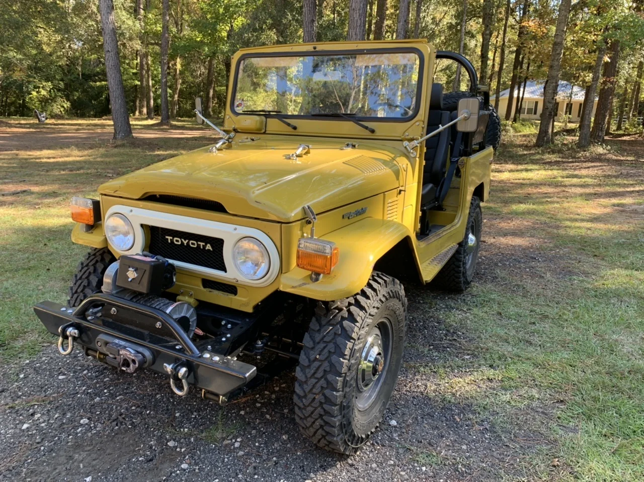

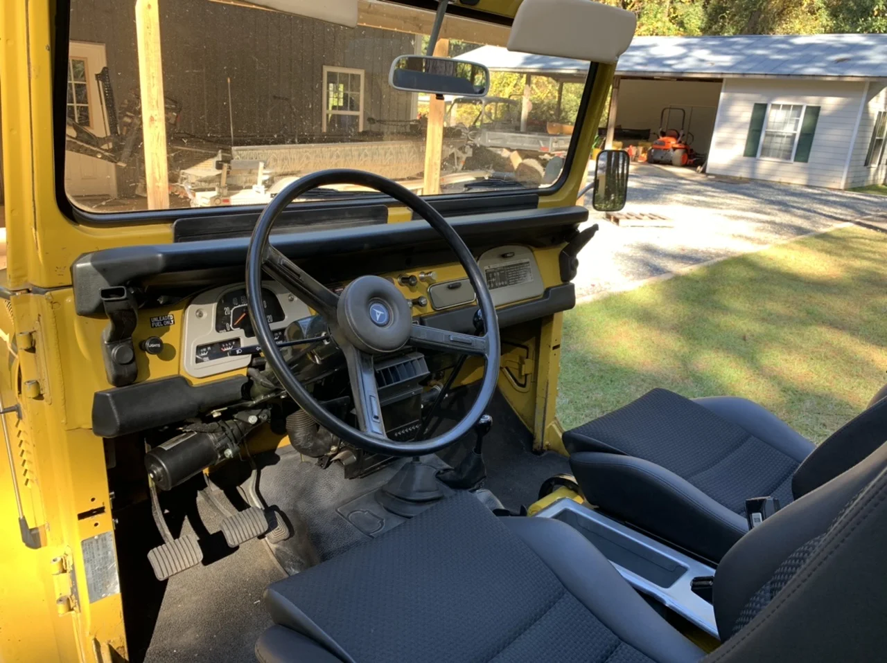

@spazzyfry123 got behind the wheel today for his first 40 series experience.
I told John today that we need to change the name from Mustard to Bananas. This thing is crazy.

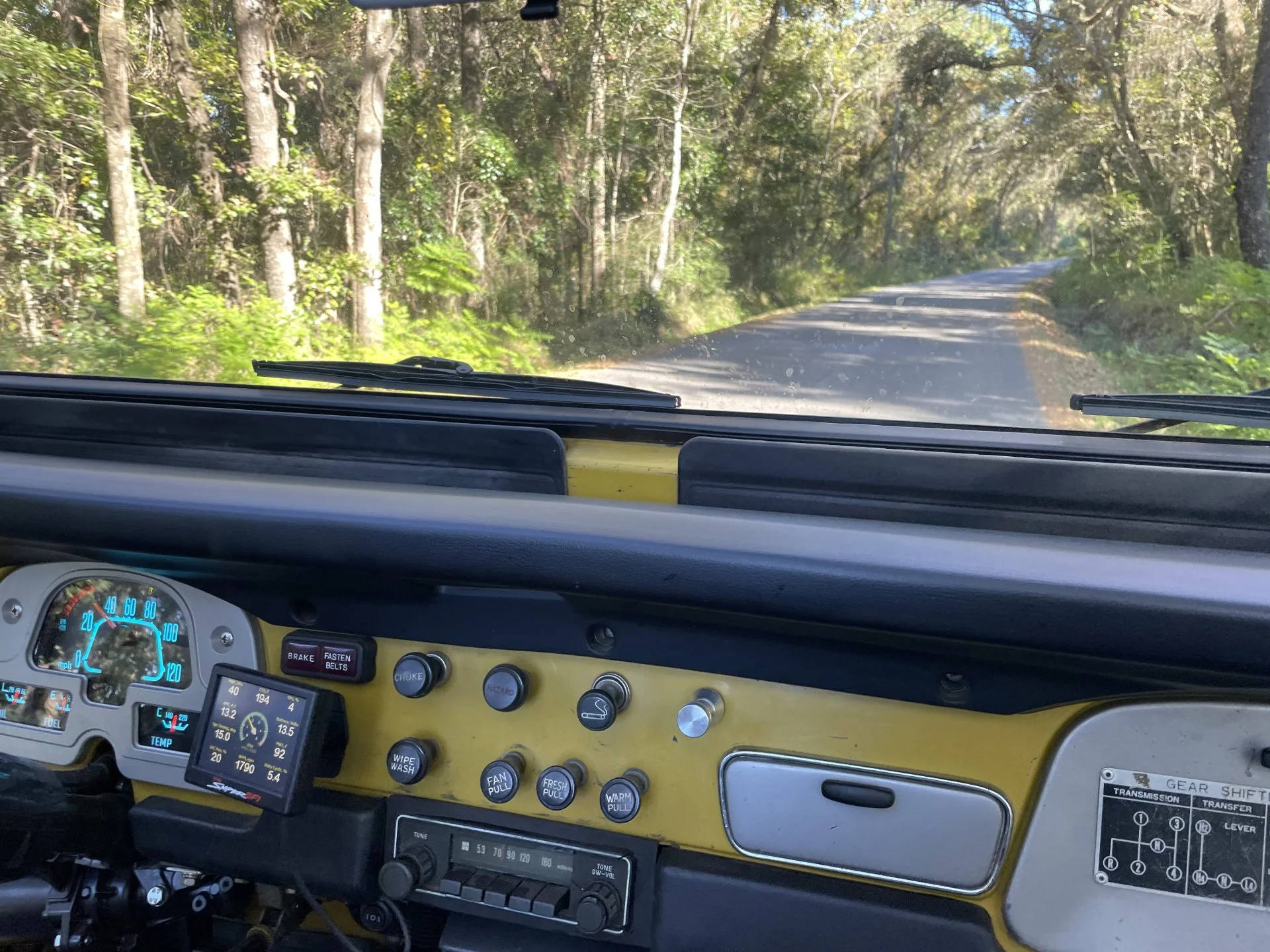

It takes less effort to drive 60mph in this than it does in my 80. Single handed driving is not an event and really makes the drive enjoyable for something I fully expected to be a tractor. My favorite part is how 2nd gear just perfectly hands off to 3rd - there’s a fun gap between the ratios and fall of the RPMs that allows such a casual up shift.
Back to the single hand. The steering. Y’all. The steering. As John said, I have never driven a 40. Sure, plenty of old CJ J%$ps, but never a 40. I was floored. We could take sharp turns in the canopy roads at speed without worry that we’d float into a 250 year old oak. The pinky-effort turn with confidence makes it such a joy to drive.
You rip it and it just keeps going and going. Torque when you need it in second gear at ultra low speed and a healthy cam that surprisingly loves high revs.

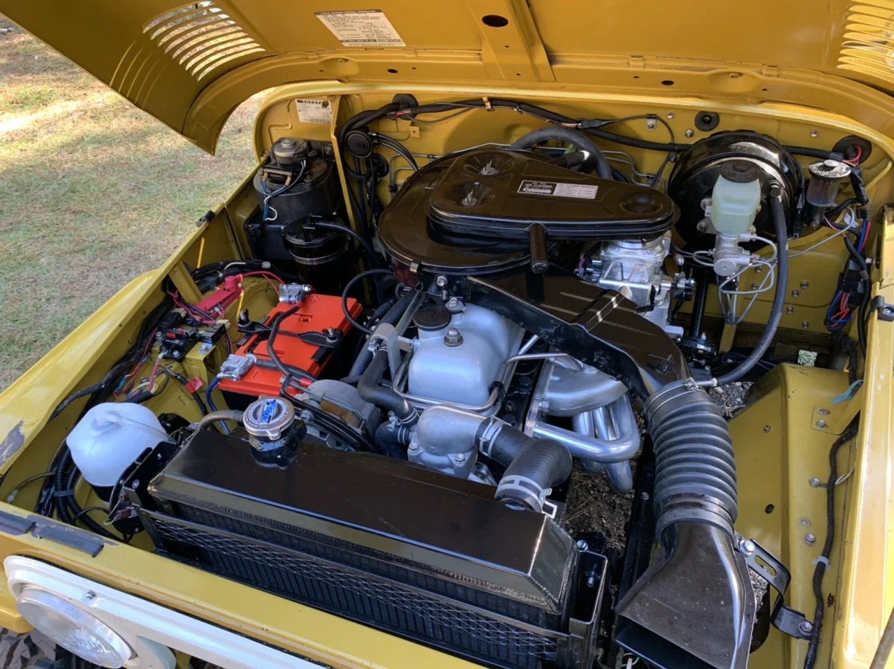

Such a sweet harmony between old and new. New that disguises itself in such an understated way (it took me a hard minute to realize the gauge cluster was quite a bit more trick than first glance). Patina that I just could not get enough of. Exhaust wizardry that had both John and I rolling on the ground for MINUTES (hey it’s cold in Florida) to drool over - we were especially interested in the work near the crossmember and the might-as-well-be-OEM hangers.
Do you adopt 80s @wngrog ? I think I’m spoiled for this to be a first experience. It’s like hitting the bunny slopes in the Alps.
Man. I’m so glad to hear other peoples thoughts on this truck. It’s really such an awesome experience for sure. People think I’m nuts when I drive my relics at speed because they don’t understand what one with the proper geometry will do.
I’ll pass the compliment on to the Wizard on the exhaust.
