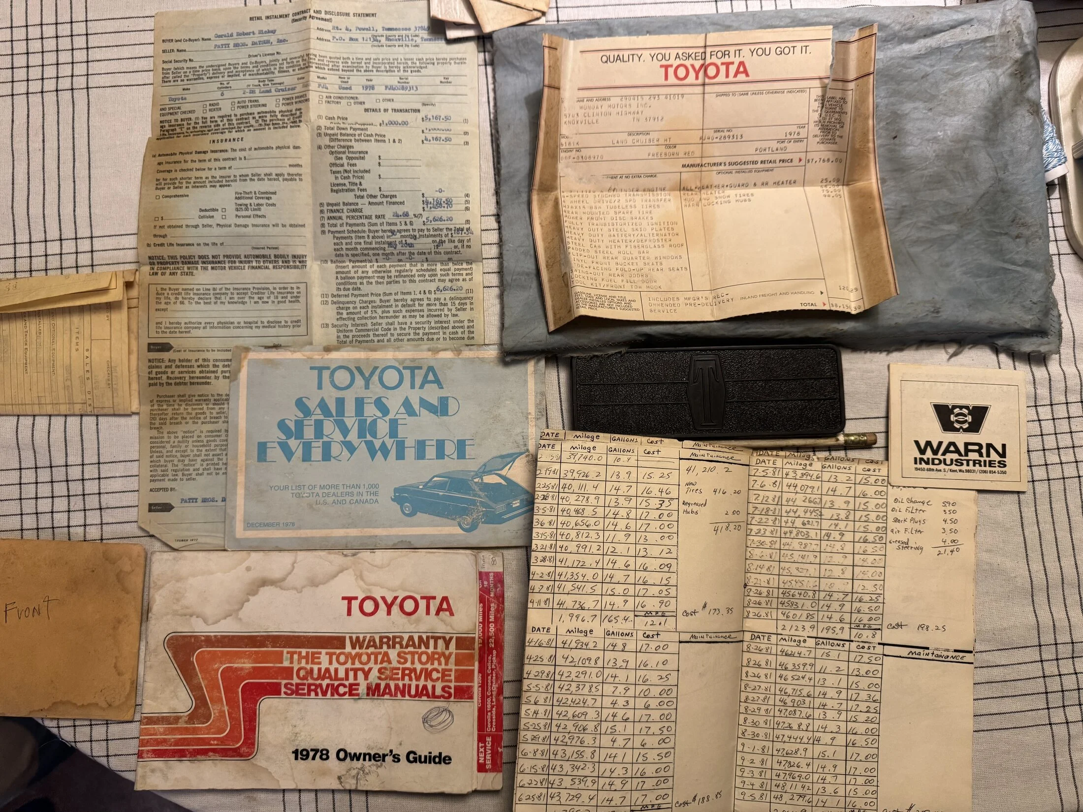

Later that evening, I went through the pouch under the seat. Years of registrations, some Toyota booklets. A Warn warranty paper and installation manual. Maintenance logs! A sales invoice for owner number 2. And finally, folded in an envelop, the original window sticker.

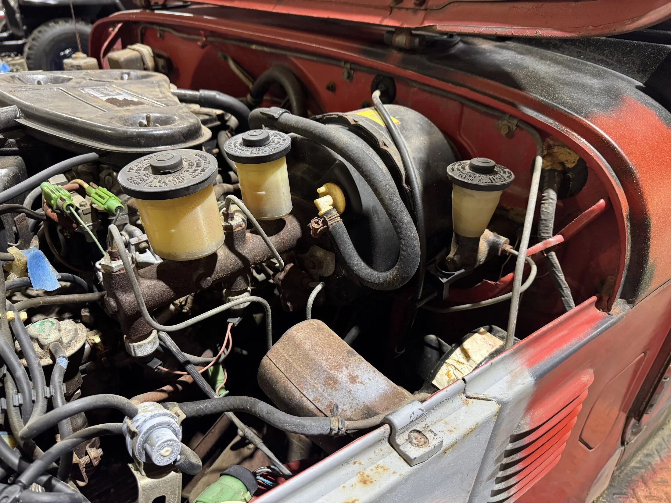

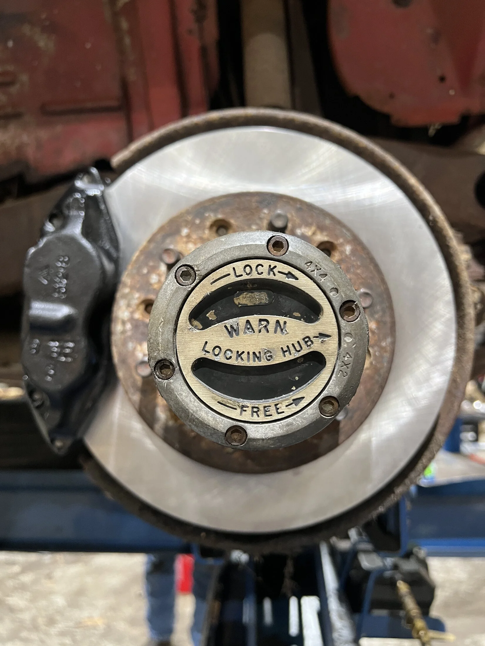

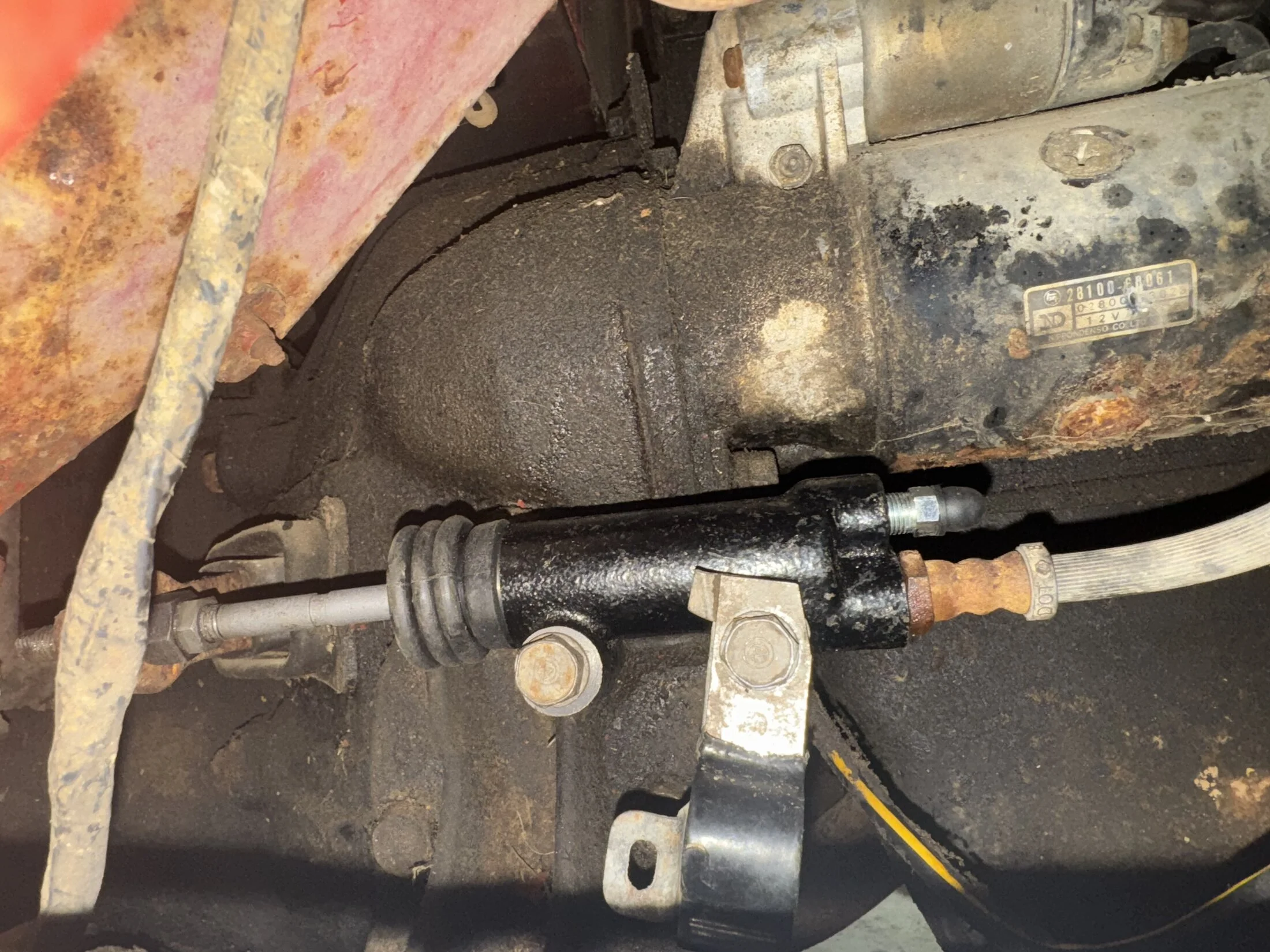

Having been through a bit of this with the ‘67, I set out to buy a bunch of parts to get Linda on the road safely. Neither the clutch nor the brake pedal had any resistance.
There was a slave cylinder inside, so I swapped it out, bled it, adjusted it - and that’s all it took for a working clutch. With that we could move Linda to the lift while waiting for brake parts.
After a few days, a booster, master cylinder, all new hoses, a few tubes, calipers, rotors and pads arrived. When the first tube snapped, I decided to run new lines for everything after the brake tees. Nickel copper makes bending easy. I also don’t know why I bother bending them, when I’m going to bend the hell out of them trying to install them.
CityRacer booster went on nicely. Just followed his instructions. Got the lines installed, hoses, rotors, calipers, and pads, but still didn’t have the parts for the drums. I’ll be back in here at some point for a knuckle rebuild and to clean up, but everything feels great.
Eager to get the thing on the road, I used a little heat and penetrating oil to the bleeder on the rear wheel cylinders and bled the system. She’s got brakes!

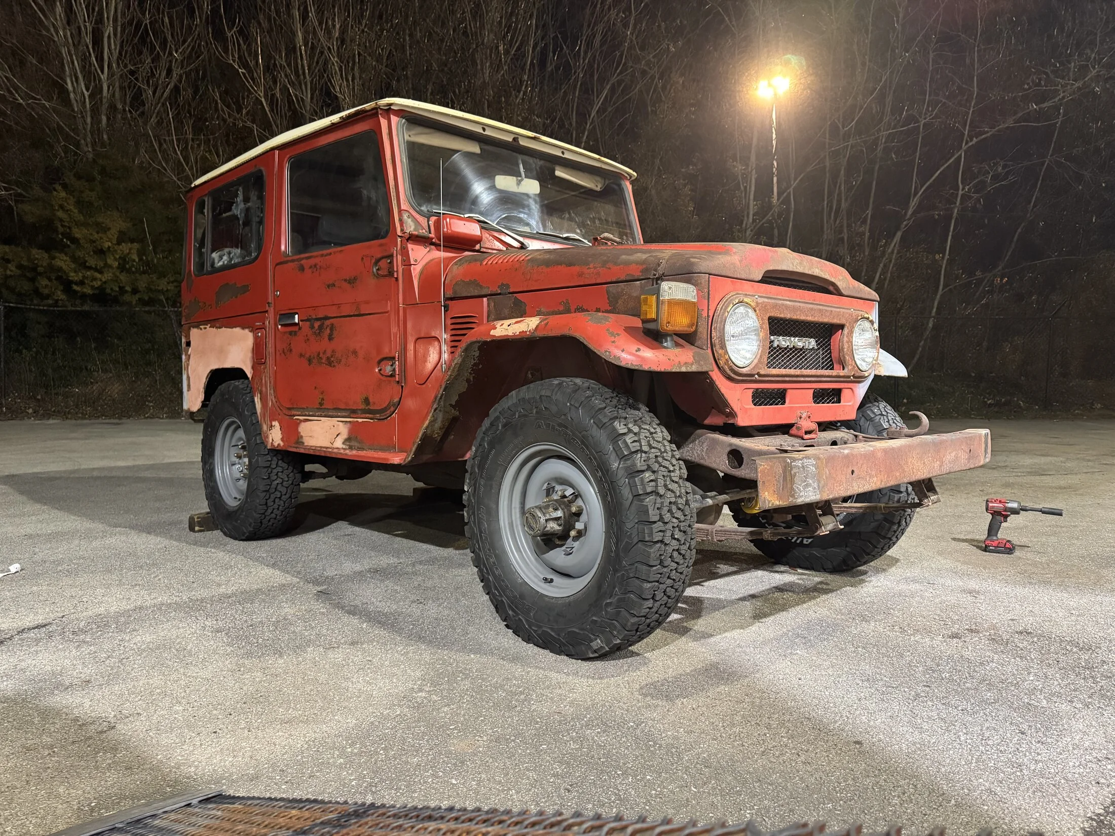

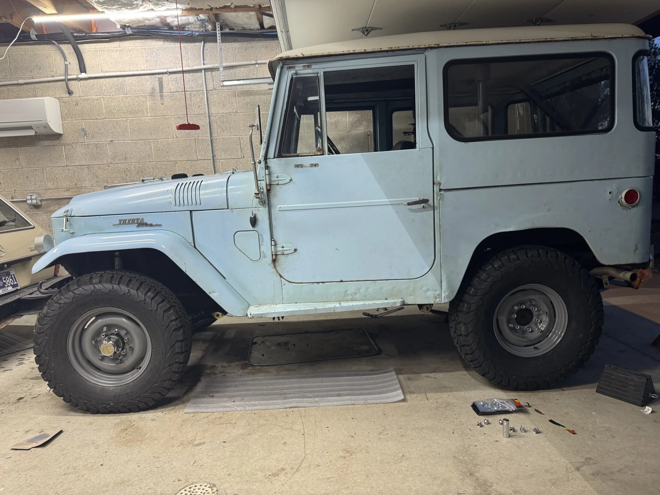

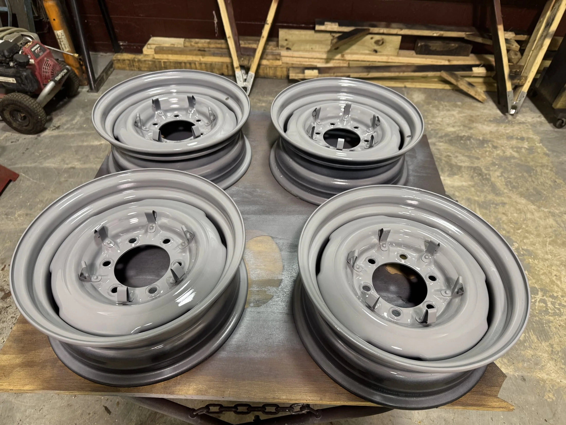

I agonized over which wheel/ tire combo to go with on my 1967. Tall & skinny or 33x10.5’s. Not knowing if the stock steelies would clear my disc brakes and unknown lift, I opted for the 16” city racer wheels and 235/85R16 KO2’s. I know they aren’t as loved as they used to be, but I’ve put a lot of miles on KOs, KO2s (among a handful of others) and they’re still my favorite for my needs.
I got a great deal on a set of brand new KO2s in 33x10.5 last week…so I bought the Toyota steelies, a few cans of rustoleum dark machine grey, spent some time scuffing and cleaning them, then hit them with 4 coats of paint.
I let them dry for a few days, and when the tires came in, took them down to a local tire shop (Fisher Tire), and gave them $100 to mount and balance them. I figured they could go on my ‘67, and it could donate its wheels and tires to Linda.
This is my ‘67 with the city racer 16” in grey up front, and the painted 15” Toyota wheel on the 33” tire in the rear. Not a great picture, but this might help others deciding between the two options.

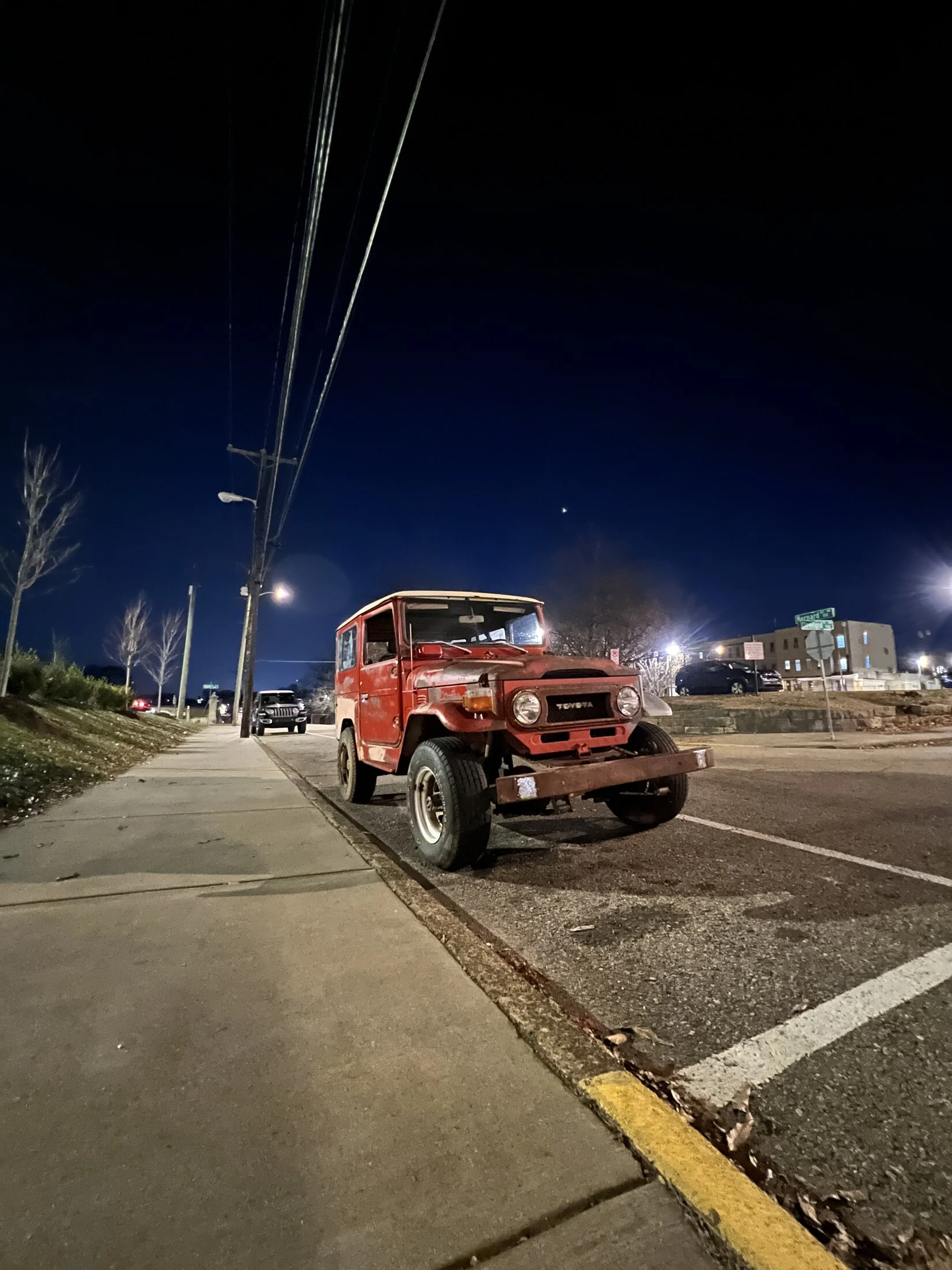

And here’s Linda with her new shoes.
Watching it work out is satisfying whether it’s’ mine or not… enjoying your progress
With about a mile of driving, this thing is QUIET. And smooth.

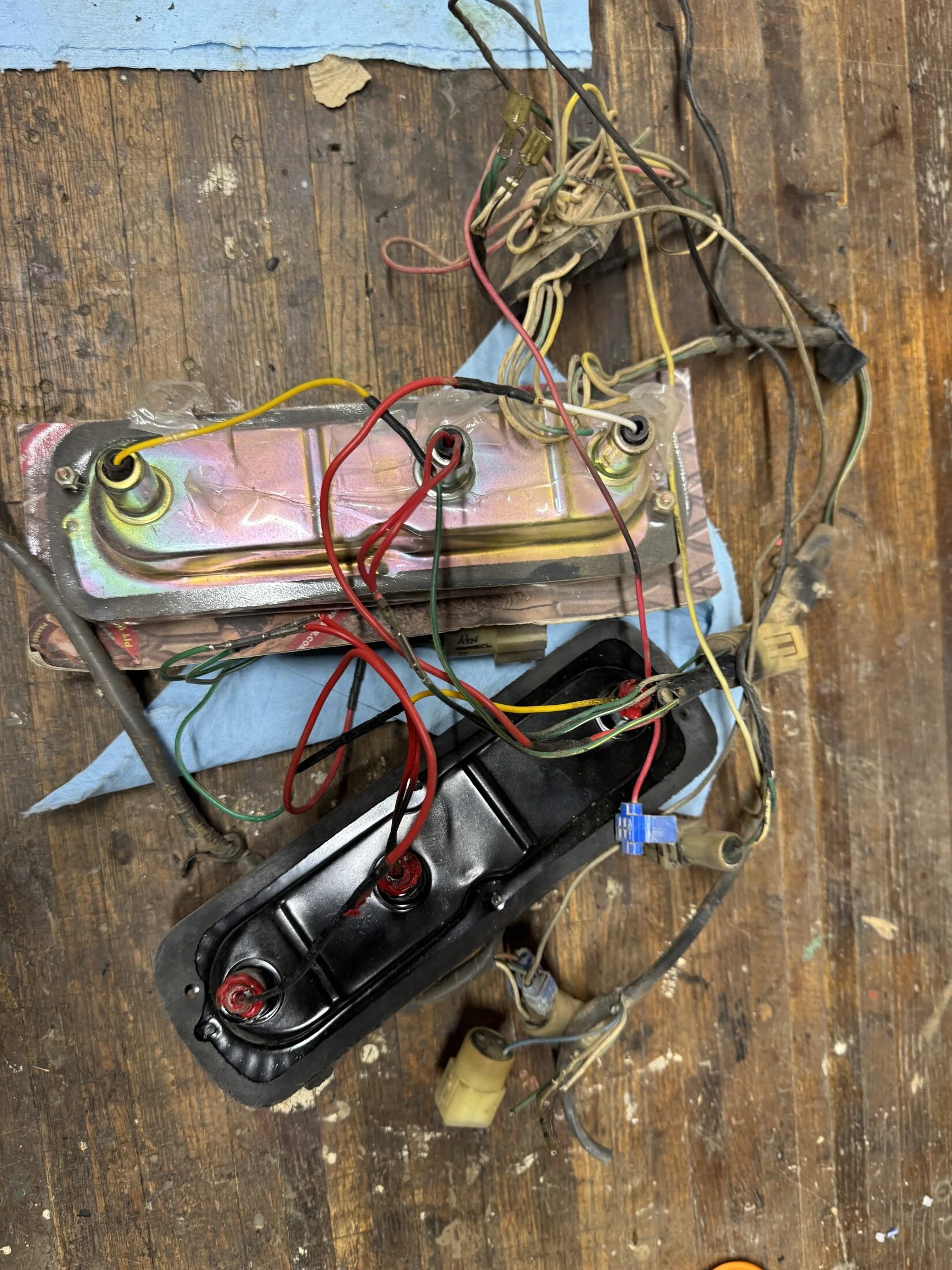

Next up is lights. The headlights work (high and low beam), but there were no taillights, rear side marker lights, license plate lights, or front left turn signal/ marker light. Also, no interior/ dash lights.
Luckily, the PO had purchased some aftermarket taillights from SOR and the front turn signal housing was there as well (and properly unplugged, not cut!). Looking in the back underneath, all wiring was there, just unplugged. There were some old wire taps for a harness connector, but it didn’t look too hacked.
Having fully rewired my ‘67 (huge thanks to this place, and coolerman for all of his help - go buy your wiring needs from him), I’ve gotten way further into wiring and electronics than I ever had with a better understanding than I ever thought I’d have. Being a nerd (by profession, and just in general), I’ve studied the heck out of most of the wiring diagrams for the early rigs up until about 1972, and have a pretty good idea of the colors for the lighting circuits.
Because I’d the trailer harness wiring, I decided to find a good spot to cut the harness close to that connection.
That’s when I noticed that the wiring is a different color combination than I had ever seen. As I unwrapped more…it seems to be original. It says “Yazaki 1978.”
Blue - Reverse
White - Brake
Red - Turn
Green - Tail
Black - Ground
I was expecting green, green/ white, green/ yellow, green/ black, white black. What’s interesting is that the subharnesses for the side markers are the correct colors.
If this isn’t original, then I’m pretty confused. If it is original, I’m also confused.
I’m waiting on some heat shrink and I’m going to get the rear harness put back together.
