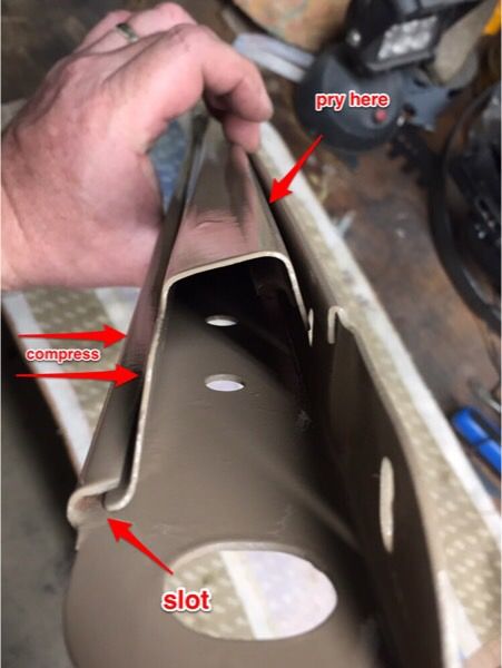

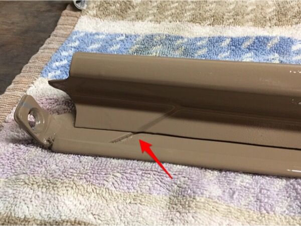

Pictured is passenger side header, I think:hillbilly:
arrowed are the holes used to secure header to roof drip rail/frame.
To separate, squeeze or compress the lower half. It is thinner metal and has some give. You may need to tap to break free the lower halfs lip from the slot. Then pry and squeeze. I would add some light oil to both seams.
Contour where lower half fits upper half.

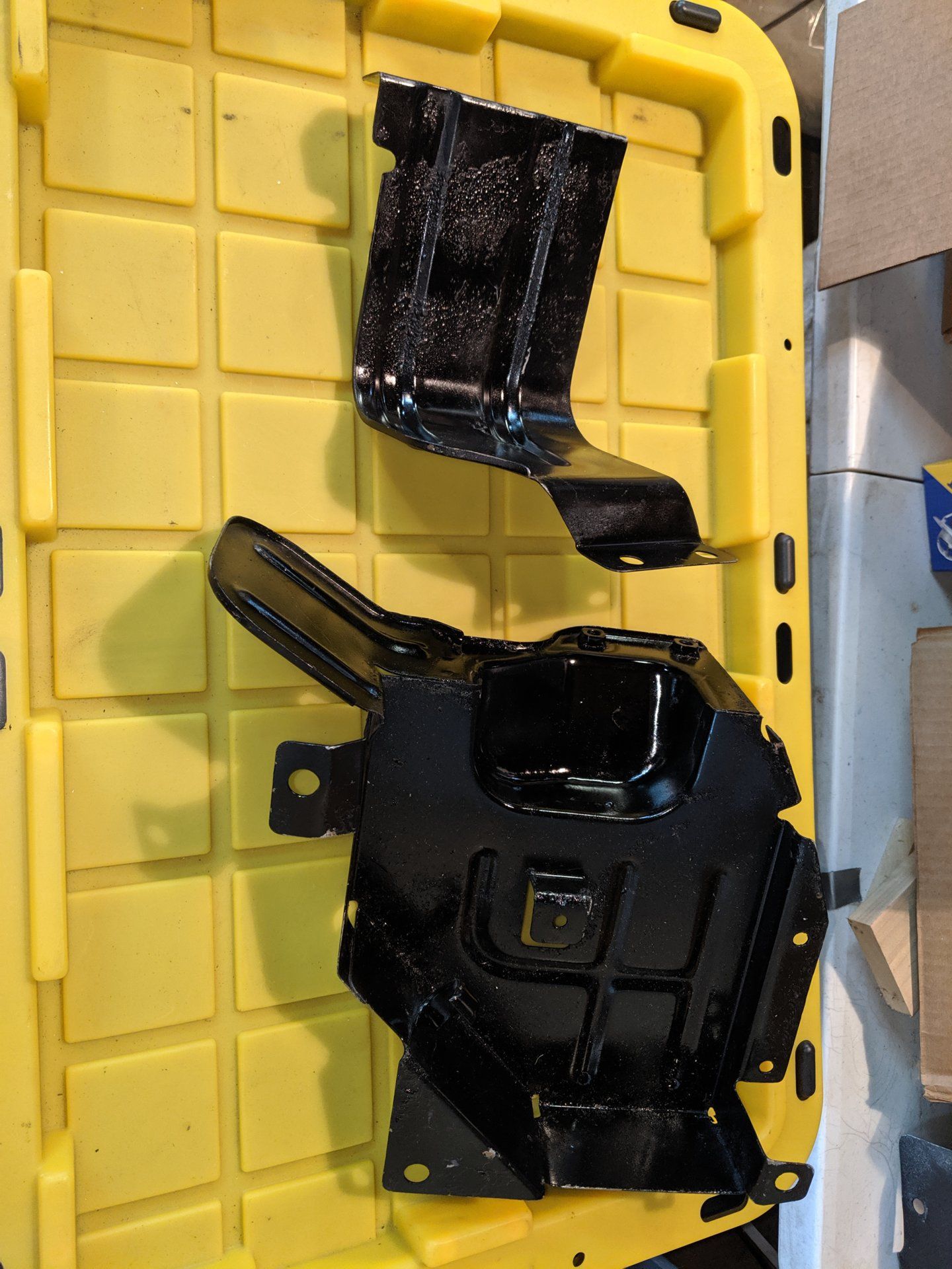

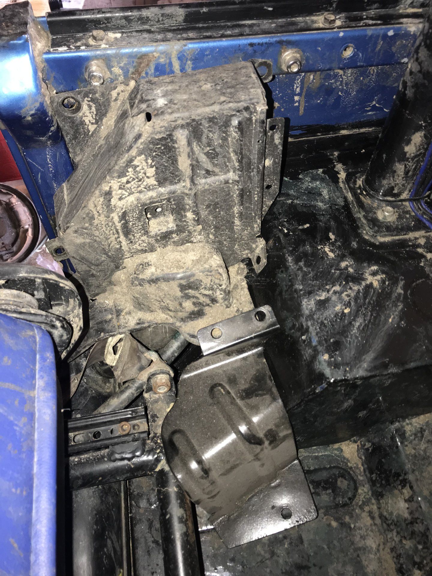

I'm making progress, but found a few more brackets in my box of parts. I have no idea what these are. Can anyone help?
Shroud that covers fuel seperator as previously mentioned. Should be factory Pewter color like ashtray and glove box door FWIW. Nice work!
