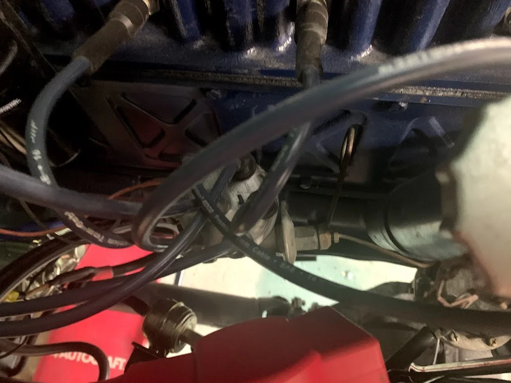

I tried adjusting my distributor to advance the timing except it couldn't turn anymore due to interference with the oil dip stick.
I then asked the great mud members if it could be off a tooth and the consensus was, "it could be". So I pulled the distributor out a couple inches, rotated then inserted it again. Being careful to ensure that the distributor was fully seated. I cranked a few more times and nothing... So I rotated the distributor back to how it was, and.... nothing.
I eventually decided it was best to start from square one. Follow the timing instructions for installing a new distributor. I found TDC, via the fly wheel and a screwdriver in cylinder one. Lined up the oil pump slot. Then reinserted the dizzy pointing at the number 1 timing mark. Again making sure that the distributor seated all the way. I cranked some more, and nothing.
Frustrated and mad, I took a break and drank a beer. Coming back with a clearish head, I went into diagnosing mode. What does an engine need? Air, fuel, and a spark. I had air. I had fuel, but I wasn't sure of the spark. So I pulled the number one spark plug out, tested it the old fashioned way of placing it up against a grounded metal piece. And boom, That beautiful blue spark was alive! So I had everything. Now why wasn't it starting? I cranked it over a few more times then heard a faint put put put. The engine was trying. I adjusted the distributor a little more, and that did the trick! The engine was alive!

I had issues with my dizzy in my 65 FJ40 and it was my “octane selector” dial on the dizzy that was all messed up. Once I screwed it back to factory setting I could get the dizzy rotated correctly (without hitting the oil filler) . Mine was also 180 degrees off :p
