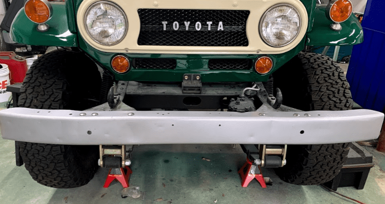

Up next, some painting:
I used rustoleum silver hammered metal paint. Turned out pretty nice. I know I can buy a new bumper but the slight dents are character to me.
