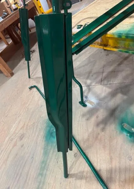

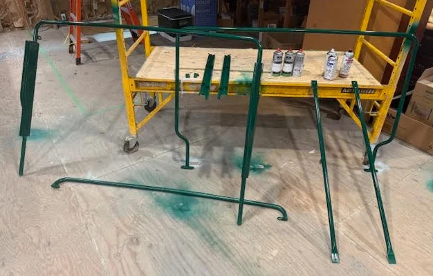

In other news, while i'm waiting for the weekend for engine work, I painted the soft top bows. I didn't feel like breaking out the full spray gun set up and wanted to test out the rattle can paint match situation to see if it would be feasible for future small painting operations.
I used Everest automotive Axalta cromax chromabase 12oz Aerosol cans and needed 4 full cans to paint the bows with 2-3 coats. I then used two cans of Spraymax 2k clear coat with an additional 3 coats of clear.
The bows ended up taking more paint than I expected but there is a fair amount of surface area there. Going forward, at $50 a can for the base coat, I'll probably break out the full spray gun set up next time. The finish from the cans was acceptable and the paint match is excellent.

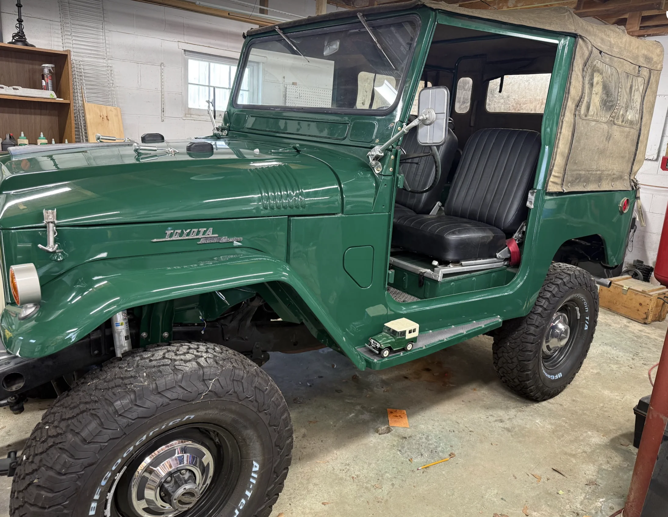

I had some time today to work on Flora Jean. Figured I would tackle the soft top and work on fitting the half doors.
The bows went together just as easy as they did.... checks notes... 6 years ago... But this time painted.
The color match was perfect from the rattle cans.

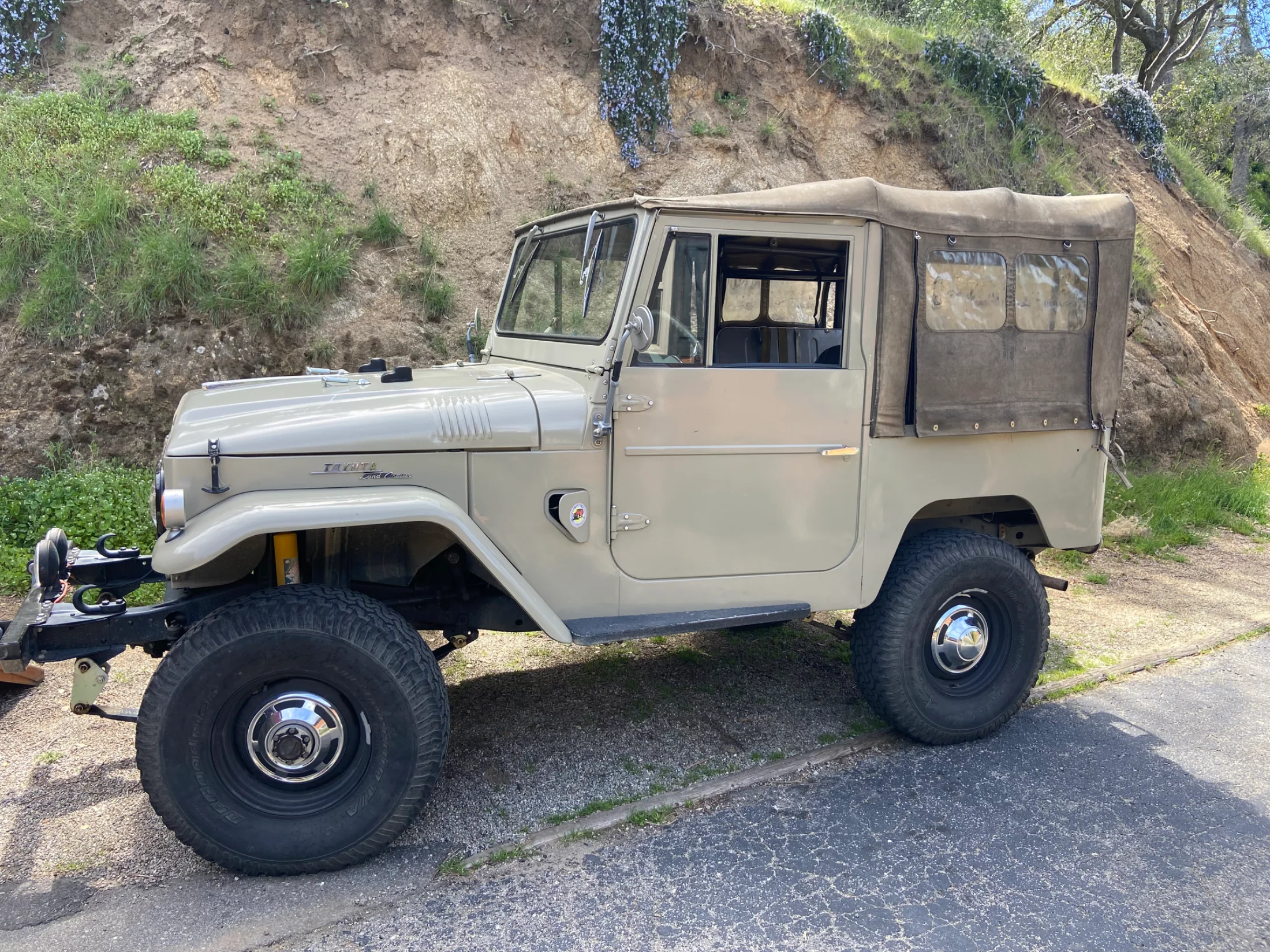

I also managed to score an old Eshan soft top from @fireflyr to use as a template for a new one. If soft tops could talk... This one would tell some great stories. Of course I had to make sure it fit and took some measurements on if it needed to be adjusted in any which way.

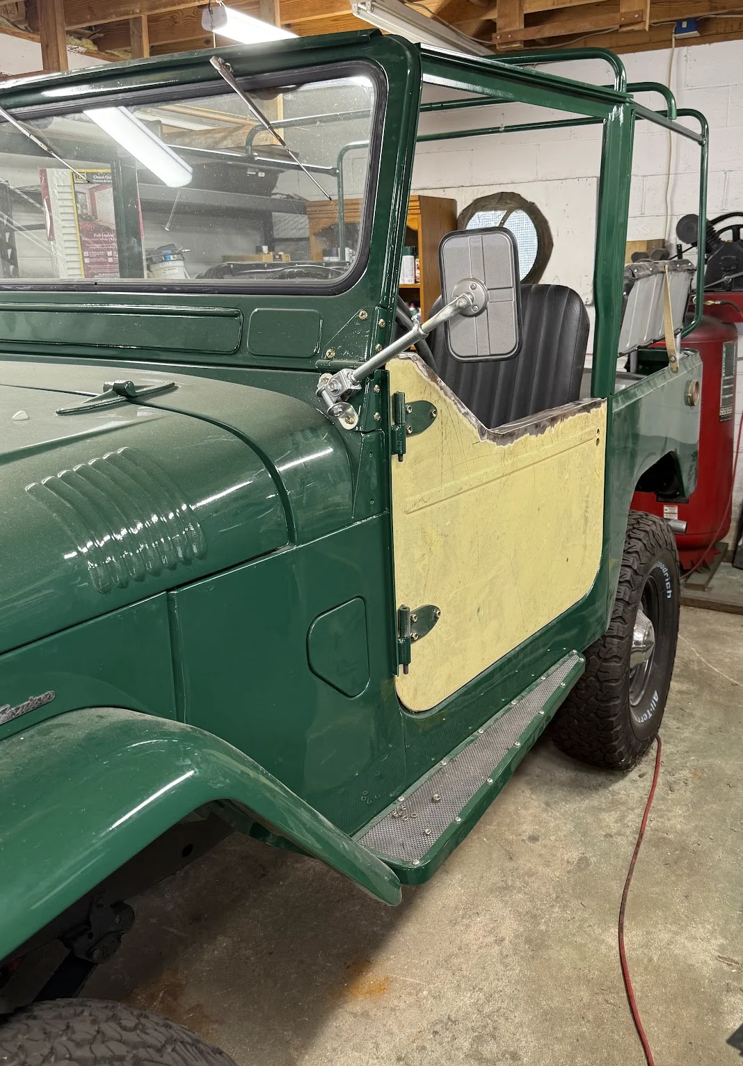

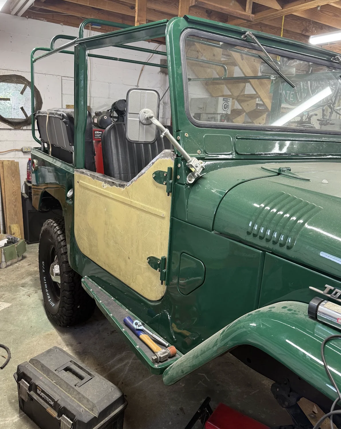

But before that. I made sure that the half doors fit correctly. The drivers side door fit like a glove. The passenger will need a little hinge adjustment and a little persuasion with a hammer to sit correctly.
Those with a keen eye will notice that Flora Jean is still in the garage. The sniper addition is proving to be a little tricky getting it tuned in. Hopefully I can get that settled soon.
The other issue is that the garage is a 7' garage door and with the opening slightly less from the opener we're looking at 81" of clearance Clarence. Flora Jean wont fit with the soft top 84" tall at the tallest point. I plan on cutting the opening to make it 8'. So that is another challenge which needs to be worked on.

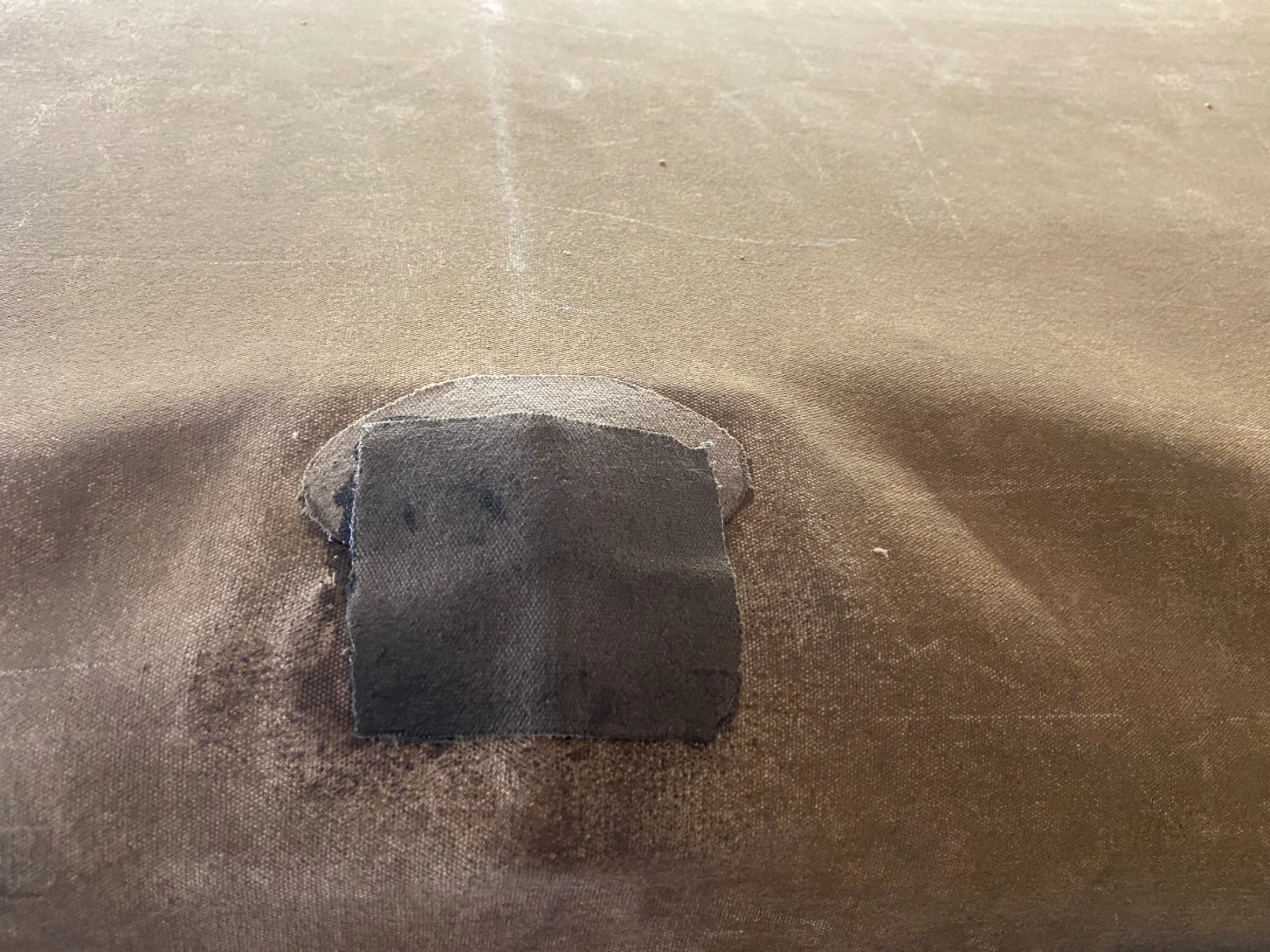

Top looks great Alex! Too bad it won’t see another generation of little ones under it but hopefully it will work as a template. If you start having them produced I want to buy #2.
When it started getting thin and ripping I started sewing patches on it. When those started ripping I took to glueing patches on top of patches. My son called it the Frankentop.

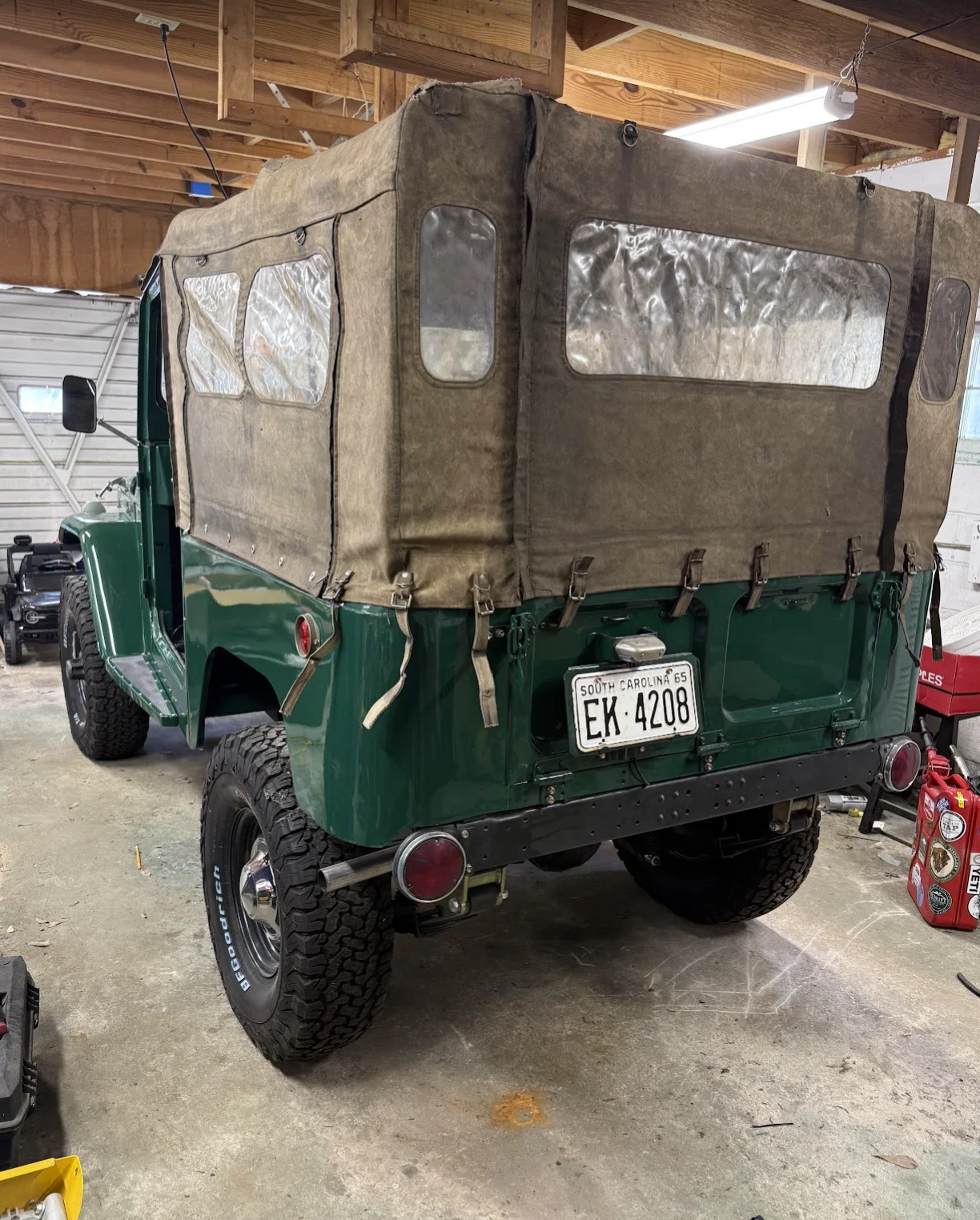

While picking around in the shop. I noticed some footman loops sitting on my shelf. Some I bought back 4 or 5 years ago. And I had no excuse not to put them on today.... So....
I positioned them a little lower than I've seen pictures to be able to really sinch the top down.
I also installed one of @Unimogguy 's latest reproduction TOYOTA stickers for early cruisers. Yes, I know it's on the wrong side. But I don't have a tire carrier and it would be more difficult to see on the left side under the license plate. When I do make a tire carrier, It'll be bumper mounted. I also bought 2 stickers so I can readjust in the future if I see fit.

Looks good. I would mix up some seam lock treatment and paint all that stitching (inside and out) especially areas that are fraying now - a stitch in time saves 9. The old seam lock had organic solvents and was really good (can't buy that anymore) and the new water base stuff is hardly worth buying IMHO.
That's how to make a good pattern ( I wouldn't lock the threads if you are going to rip it apart) but after the new one is pulled tight for a week or two I would seam lock the heck out of it. Besides adding strength it will help keep the water out. Big work table, good lighting plus a hot glue gun with and lots of binder clips. A worm drive sewing machine is very handy.
