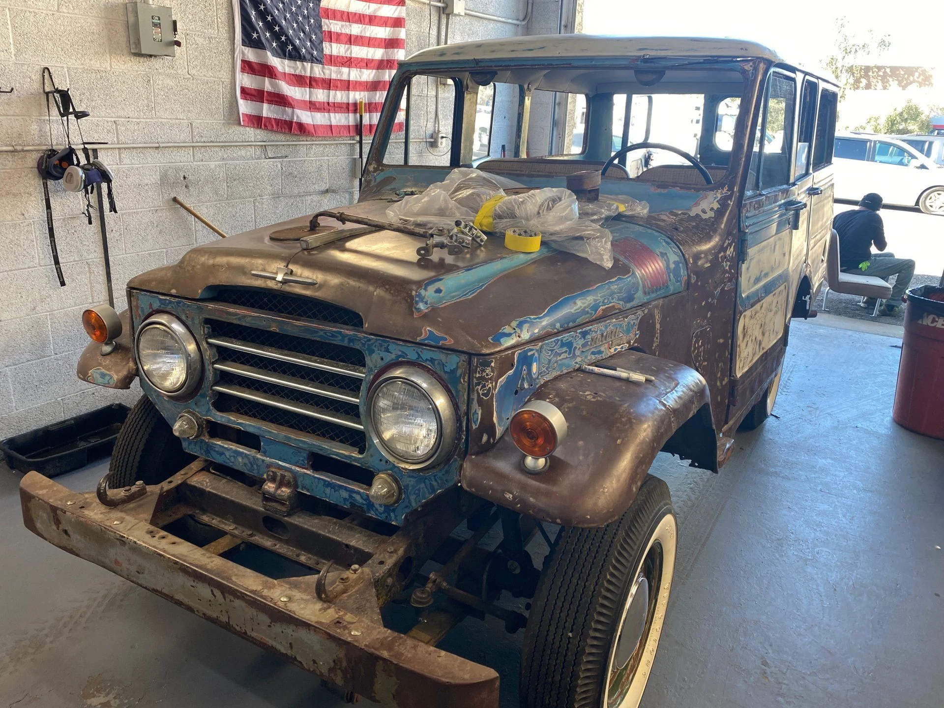

I can't stop looking at this thing. What an awesome vehicle. Some good news, that dash ashtray you're missing is sitting in my garage. As I messaged you today, check to see if the door regulators and openers are the same as the LV and I might be able to help. I wonder if the turn signals on the fenders originally had the red lense in the back of the housing? If you find that they did, I can help you there as well.
I would not want to be you. With an LV to work on and now a 28, I'd never get out of the garage. 😁 Good thing your wife likes the Land Cruiser.

great news on the ashtray! I'll PM you on it.

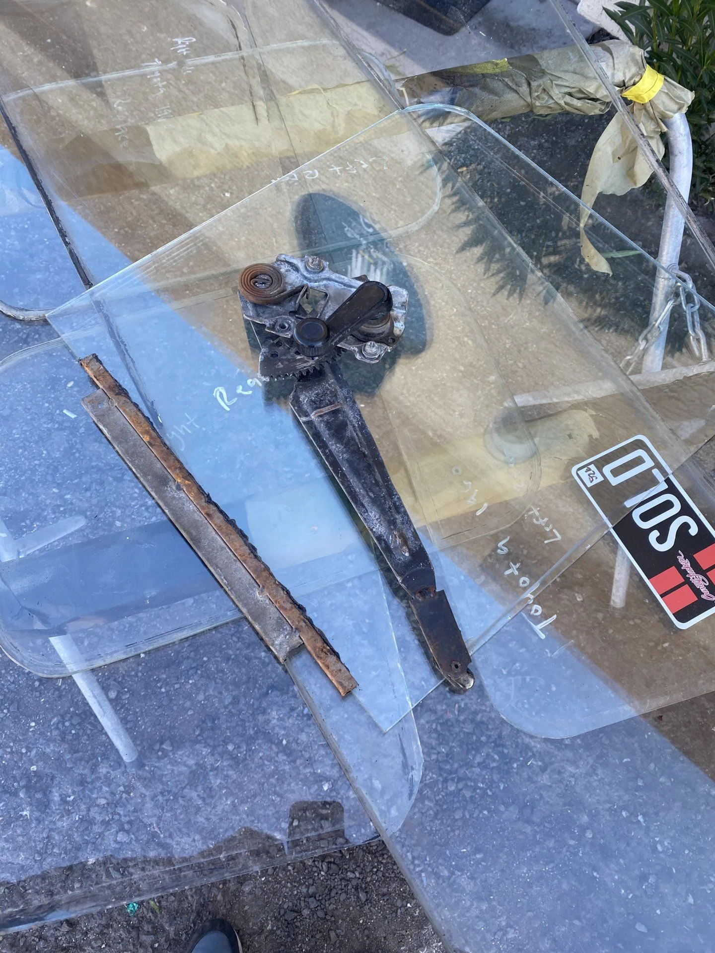

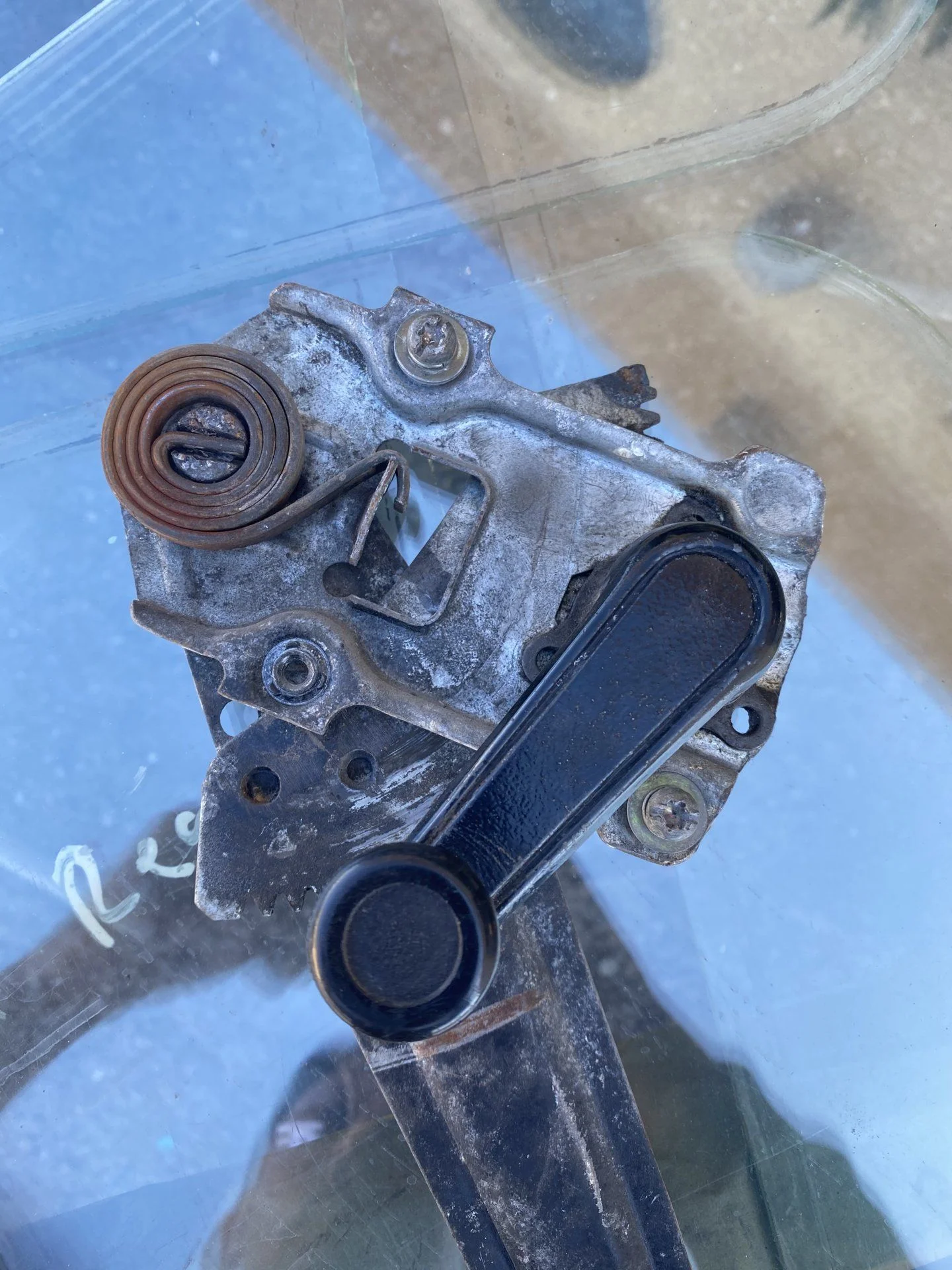

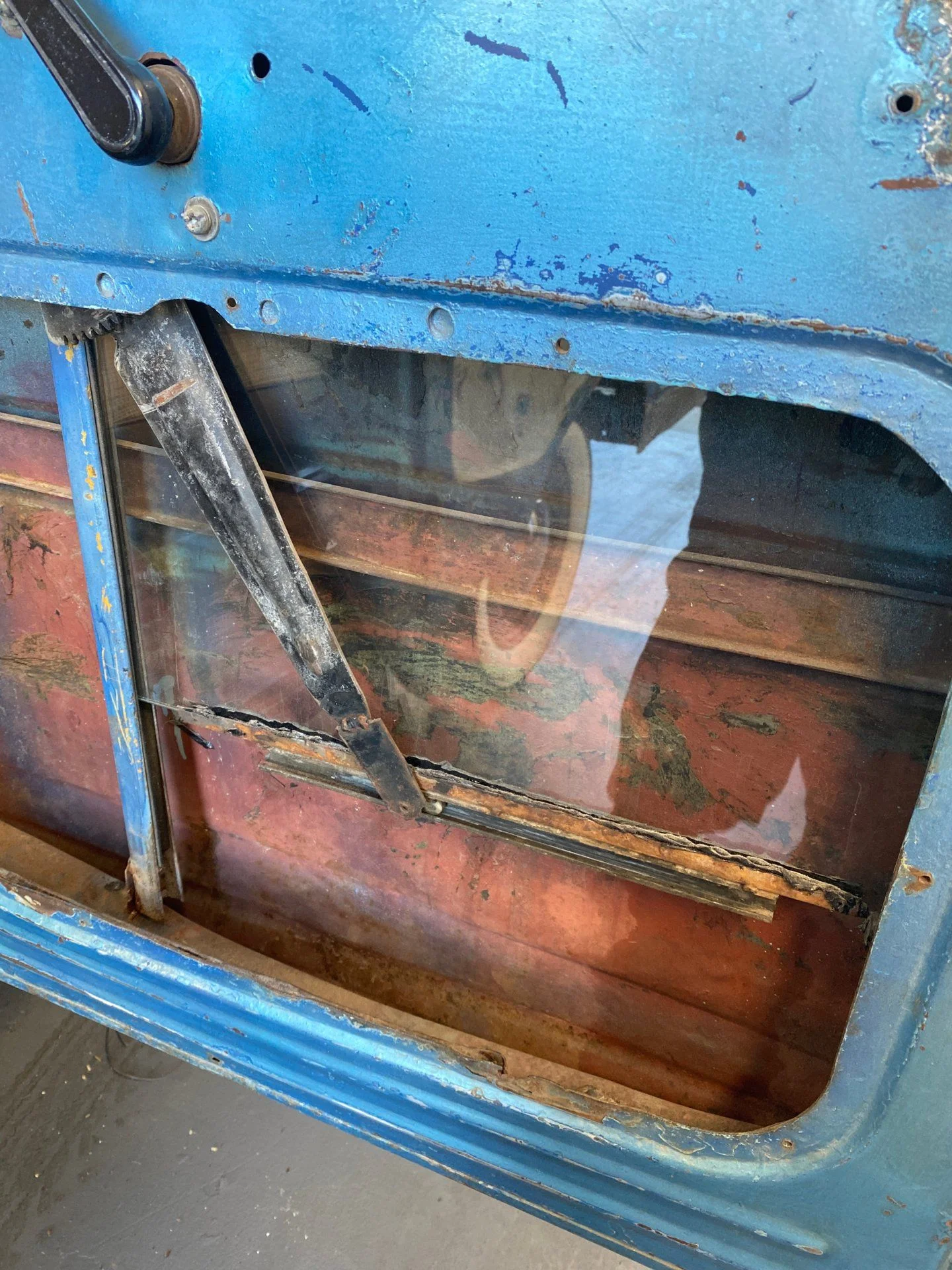

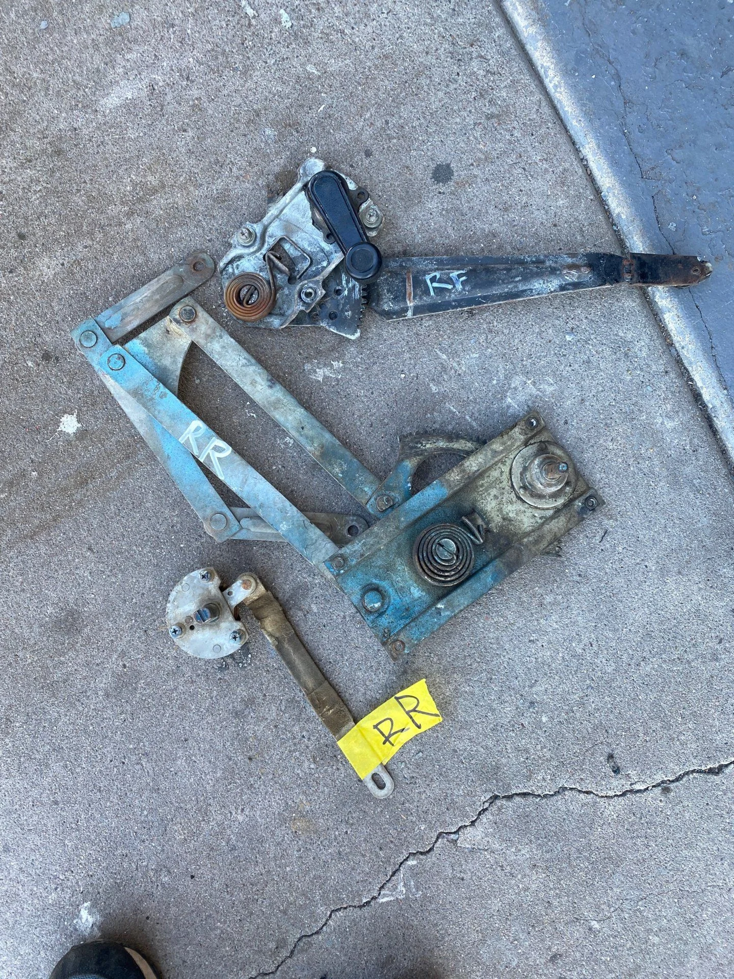

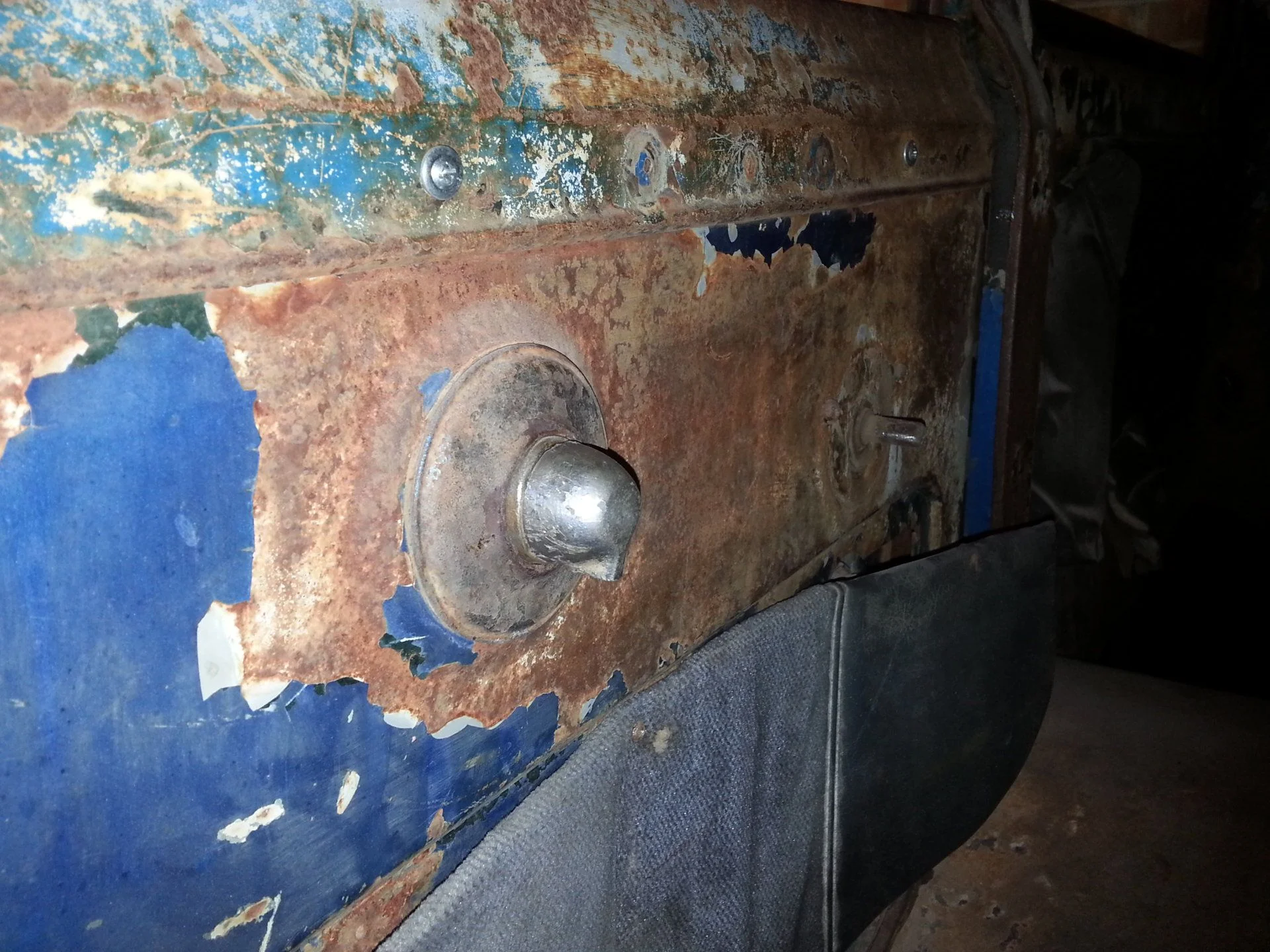

We started some disassembly today, so I'm looking at the door regulators... looks to me like they've been modified over the years with some "Venezuelan ingenuity", and they're in pretty rough shape. So if you've got some LV parts that would certainly help. It's nice having the LV and 28 right next to each other to compare. Last picture is the LV mechanism, need to pull it apart a little better to get a closer look but you can see on the 28 mechanism that at some point they welded a piece on the end already.

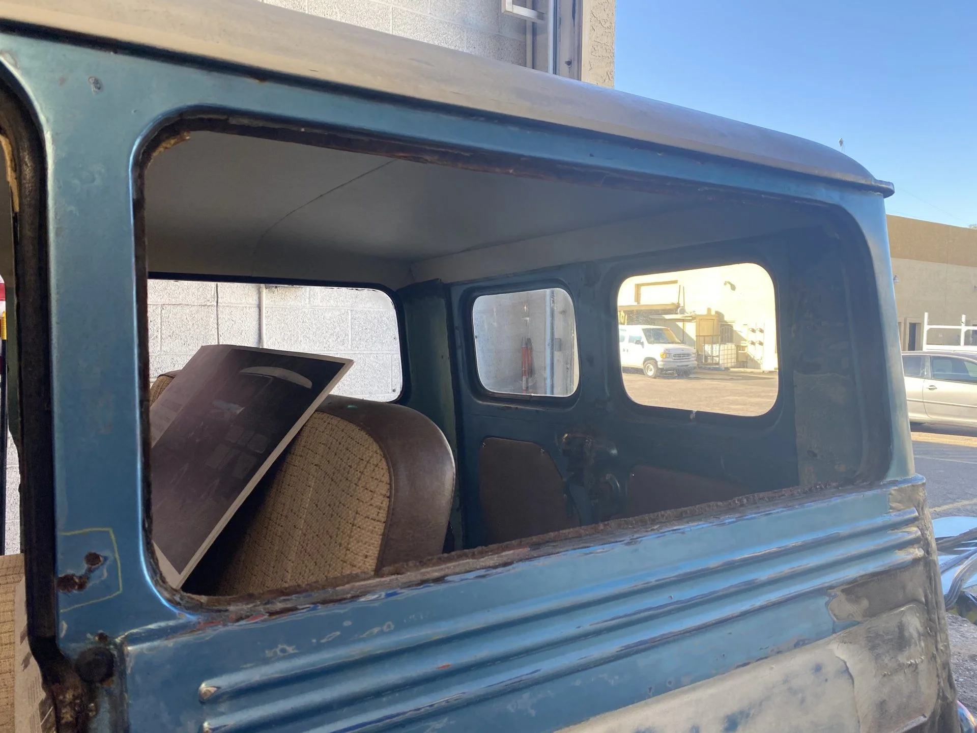

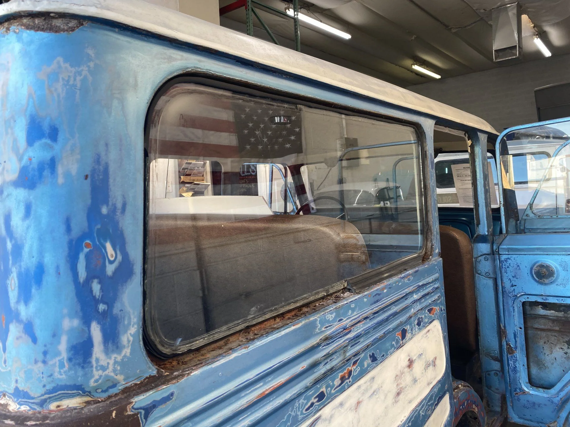

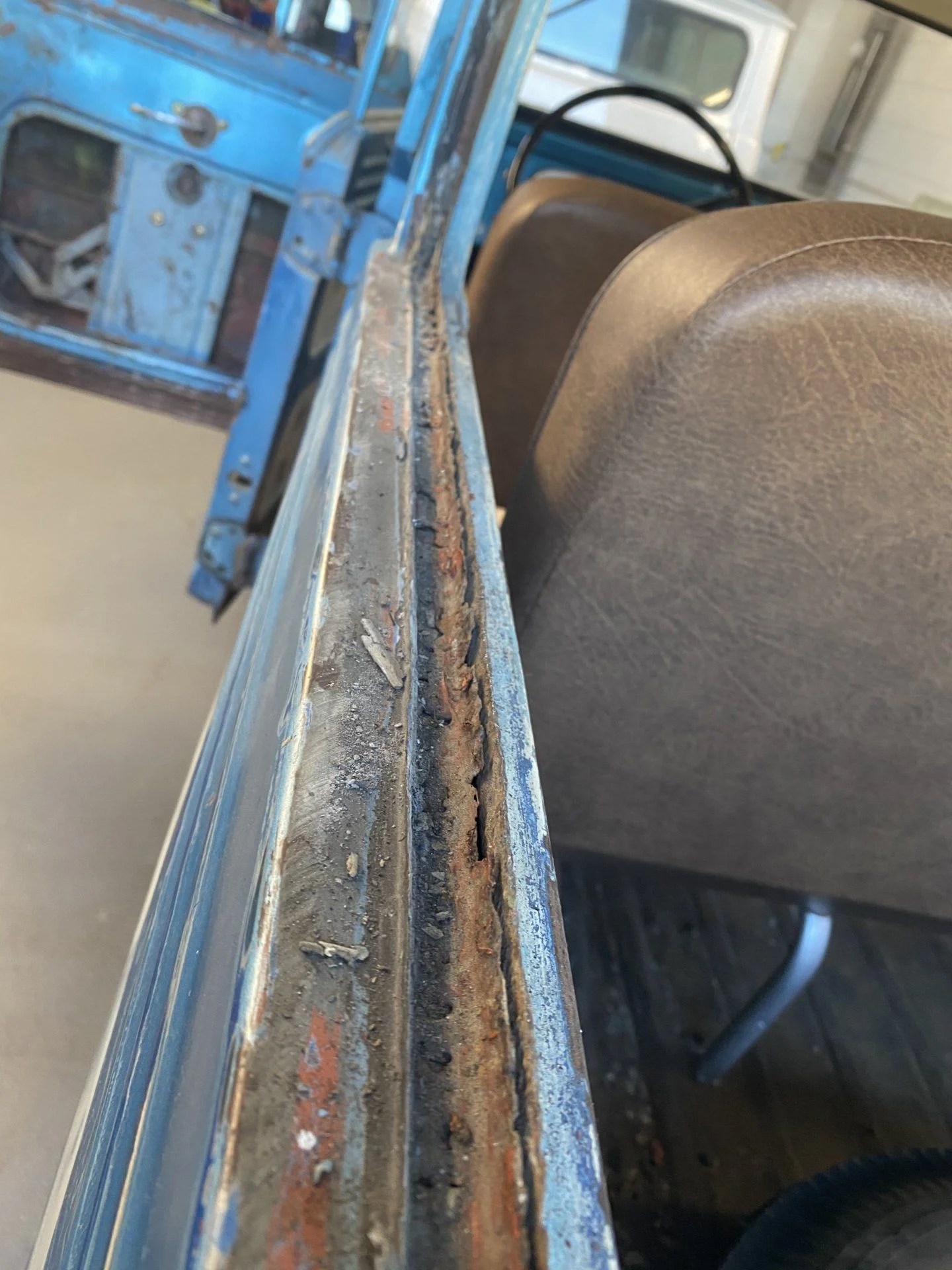

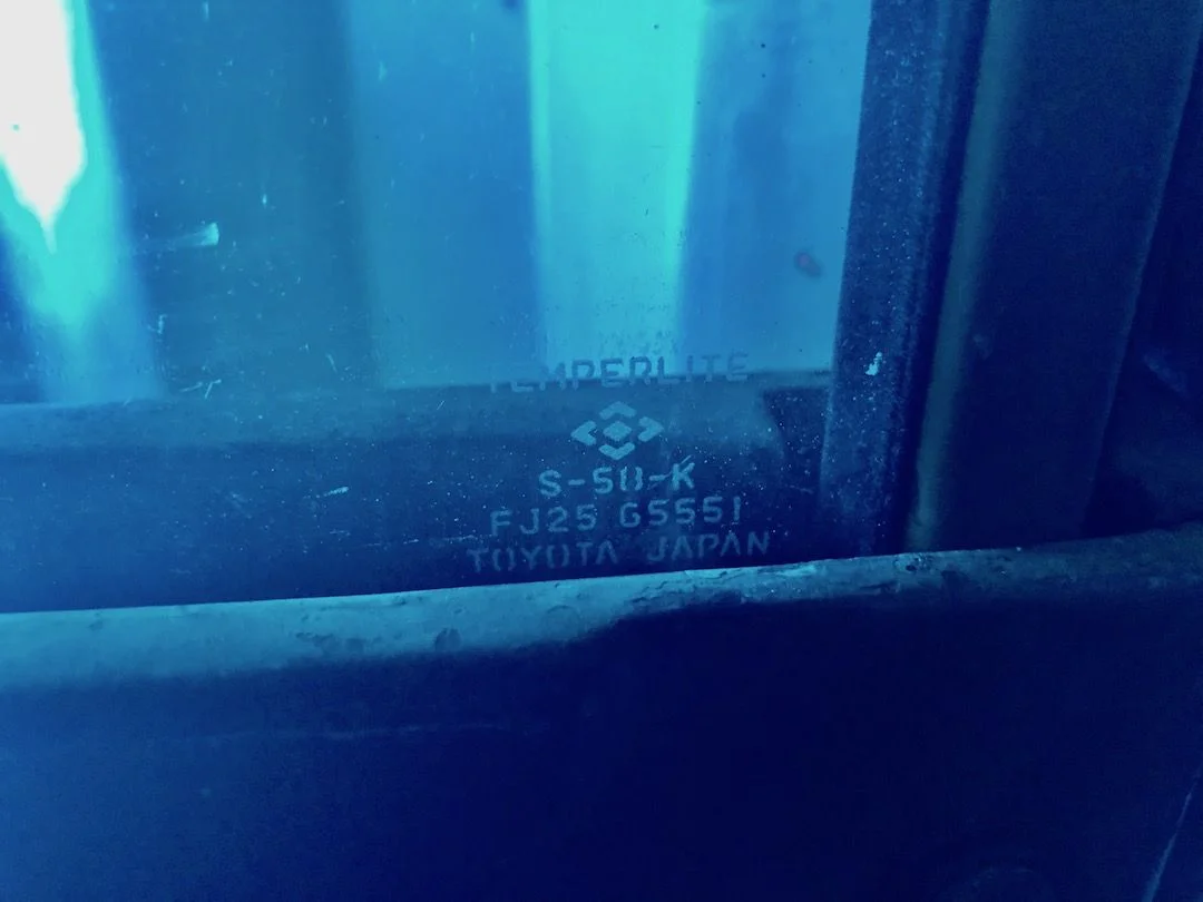

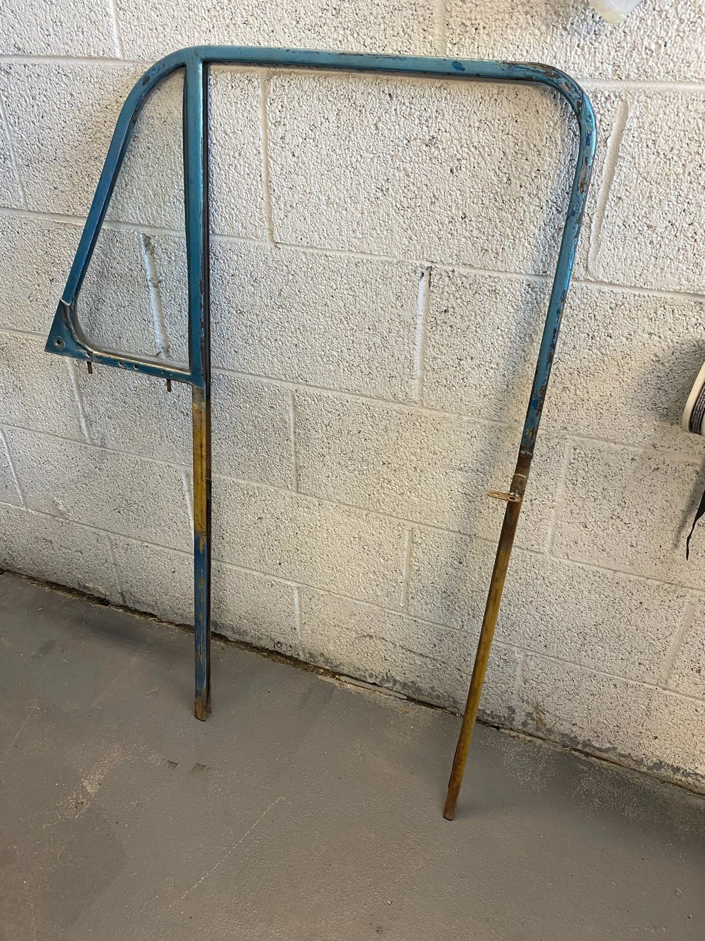

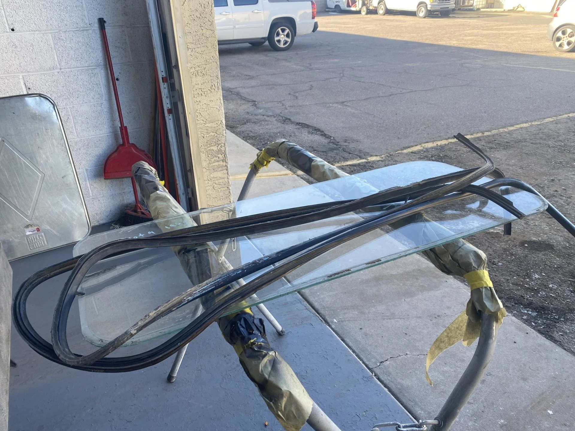

Time to start stressing out and getting scared. Taking it apart a little bit - windows are out, as expected lots of crustiness in all the window frames. Amazingly all of the window glass looks good, not sure yet how much is original though. Would I be looking for any particular markings to know for sure?

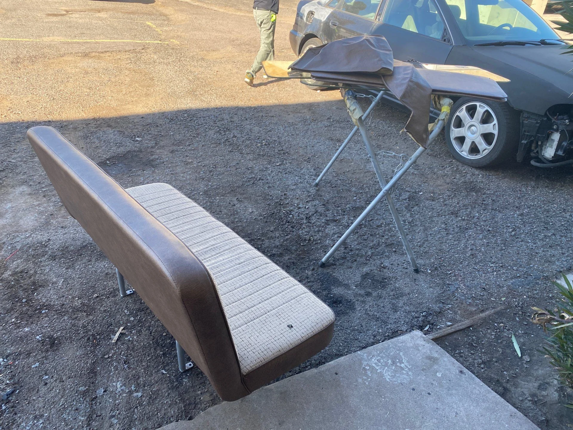

Some pieces are better than others, the seats in there are definitely some new pieces the seller probably just whipped up in a hurry to call it a "driver" at the auction. I'll hold onto them for a little bit but will probably see if I can use them for a bartering piece at some point for some work locally. Never know what can be used as currency!

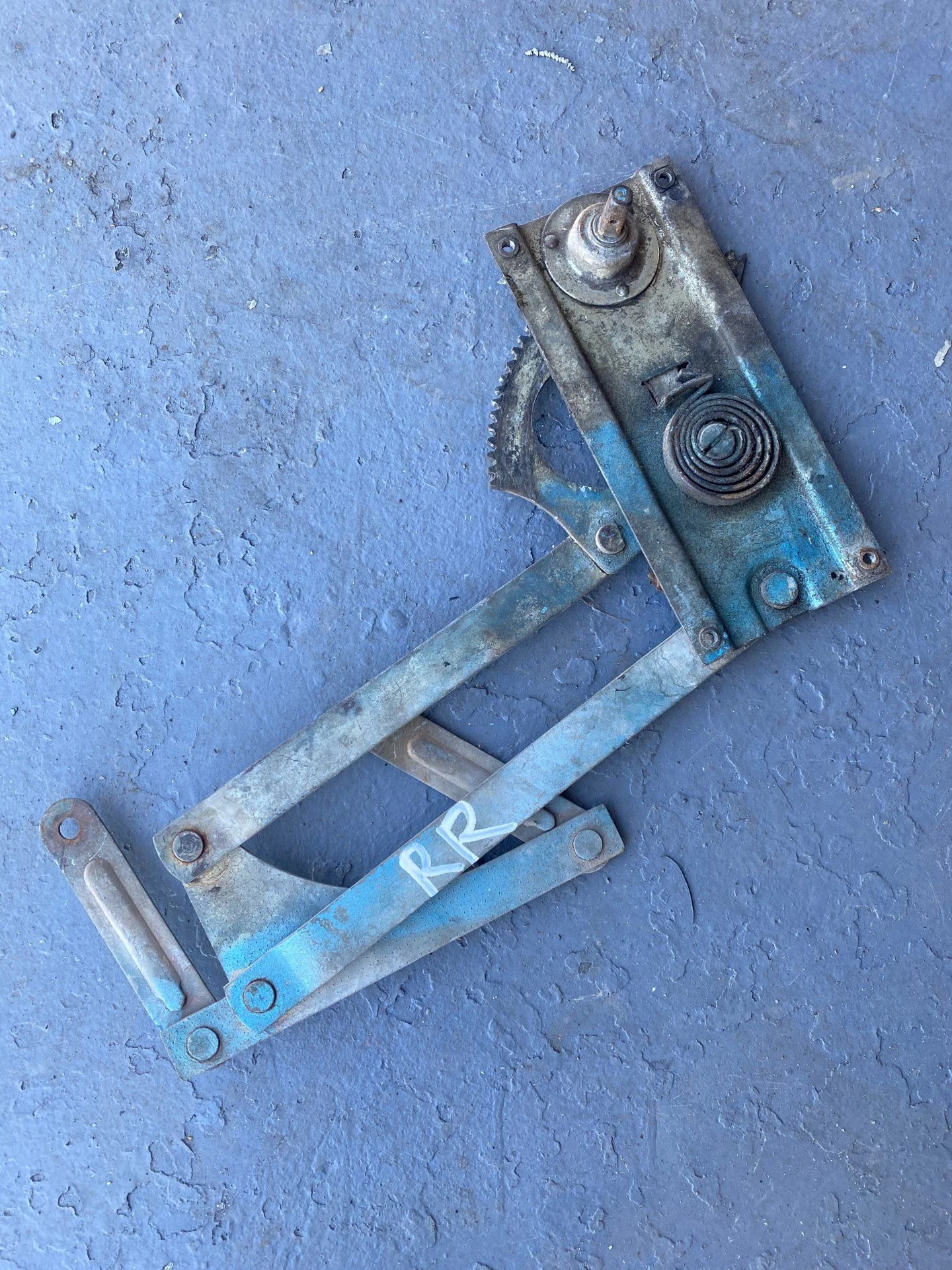

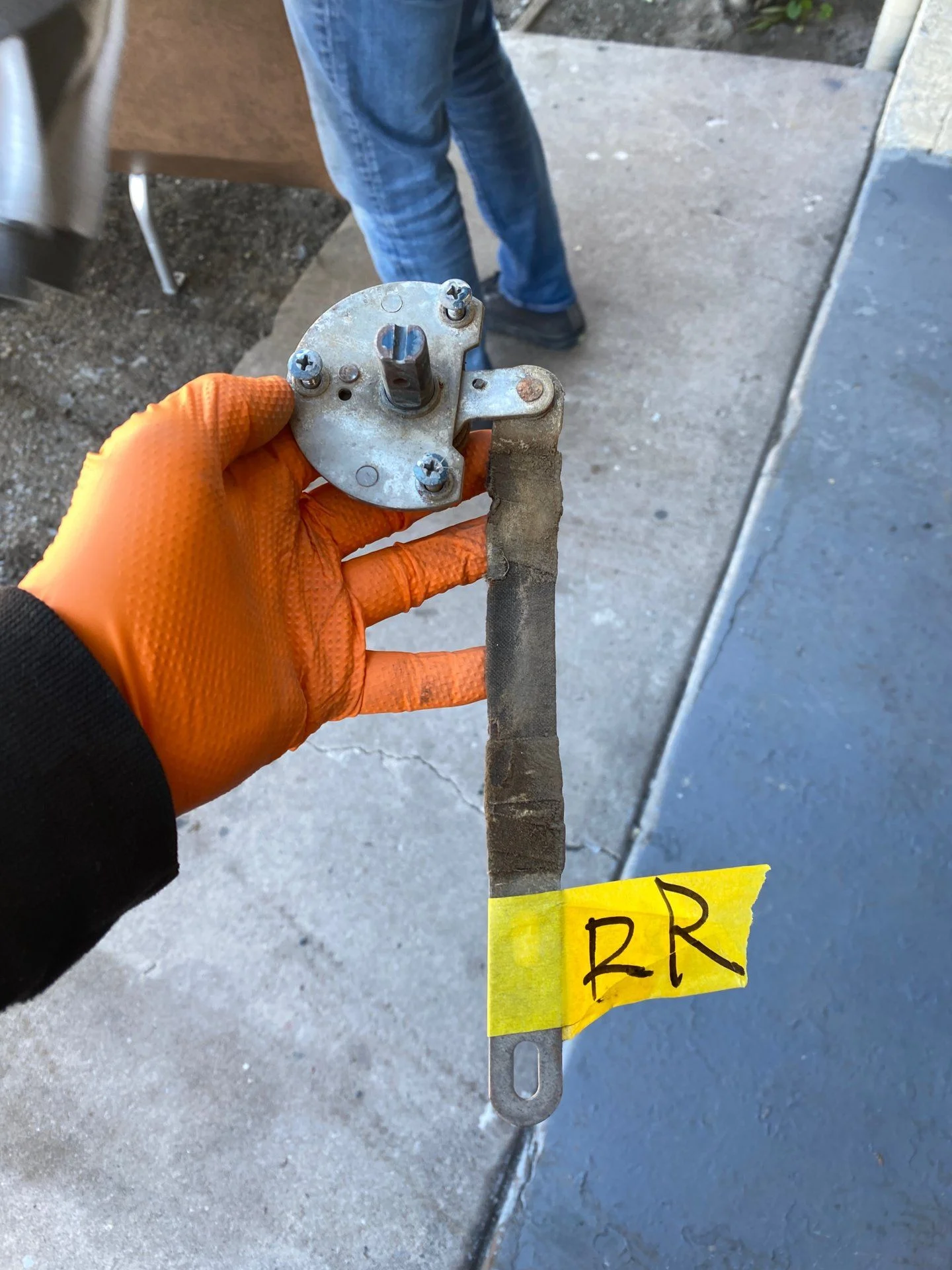

Rear passenger side regulator looks a little different (one posted above was front passenger).

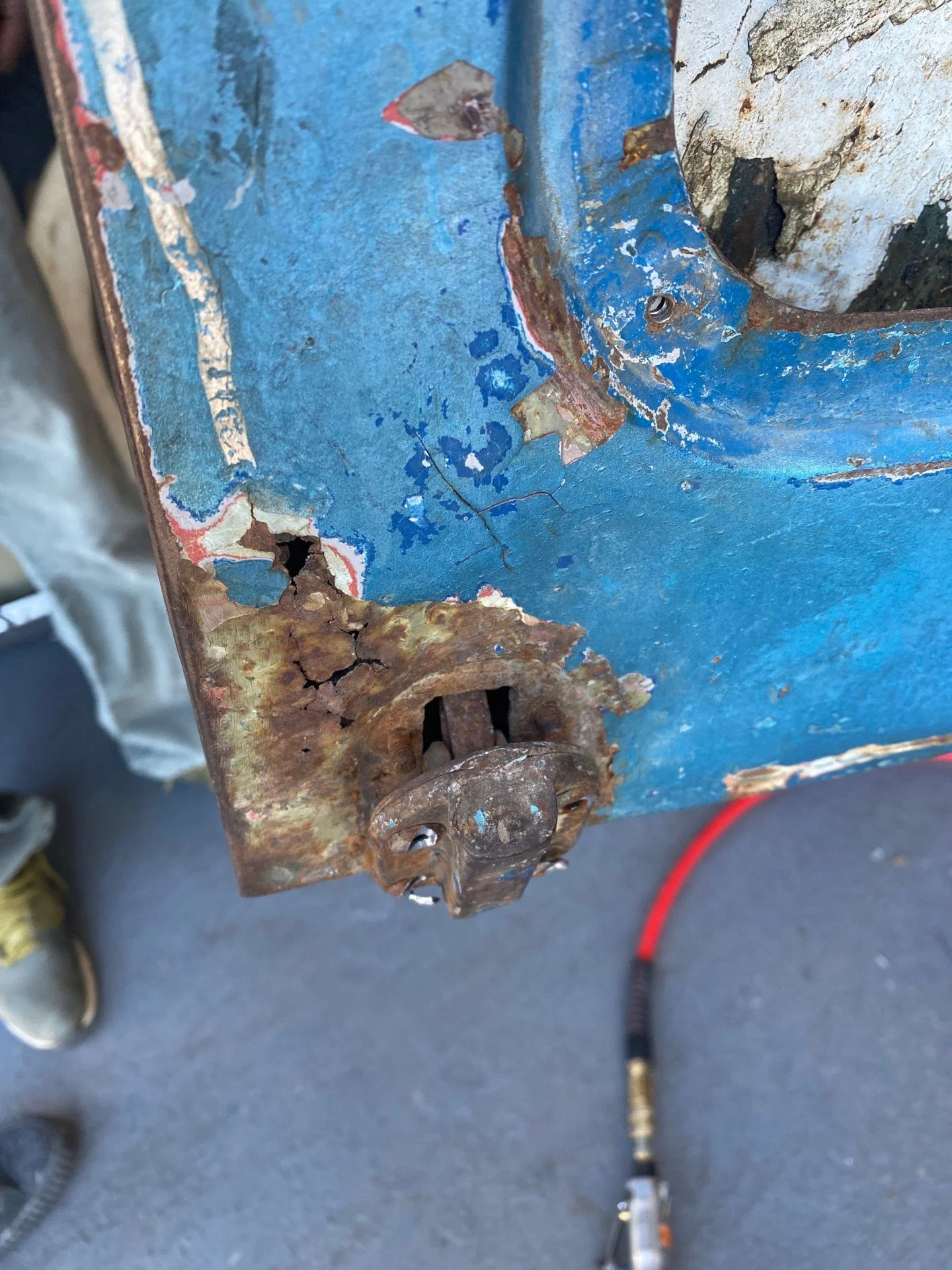

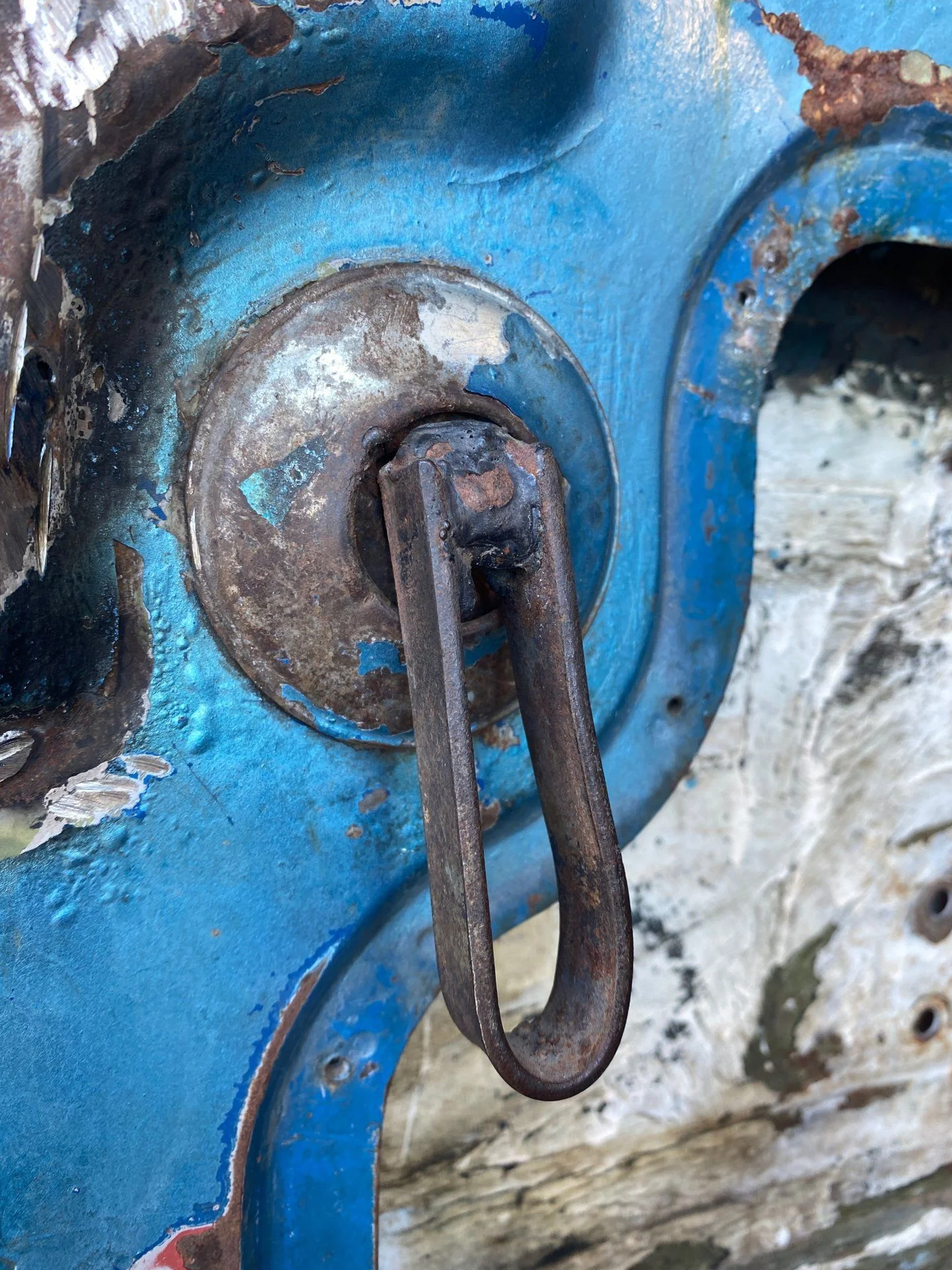

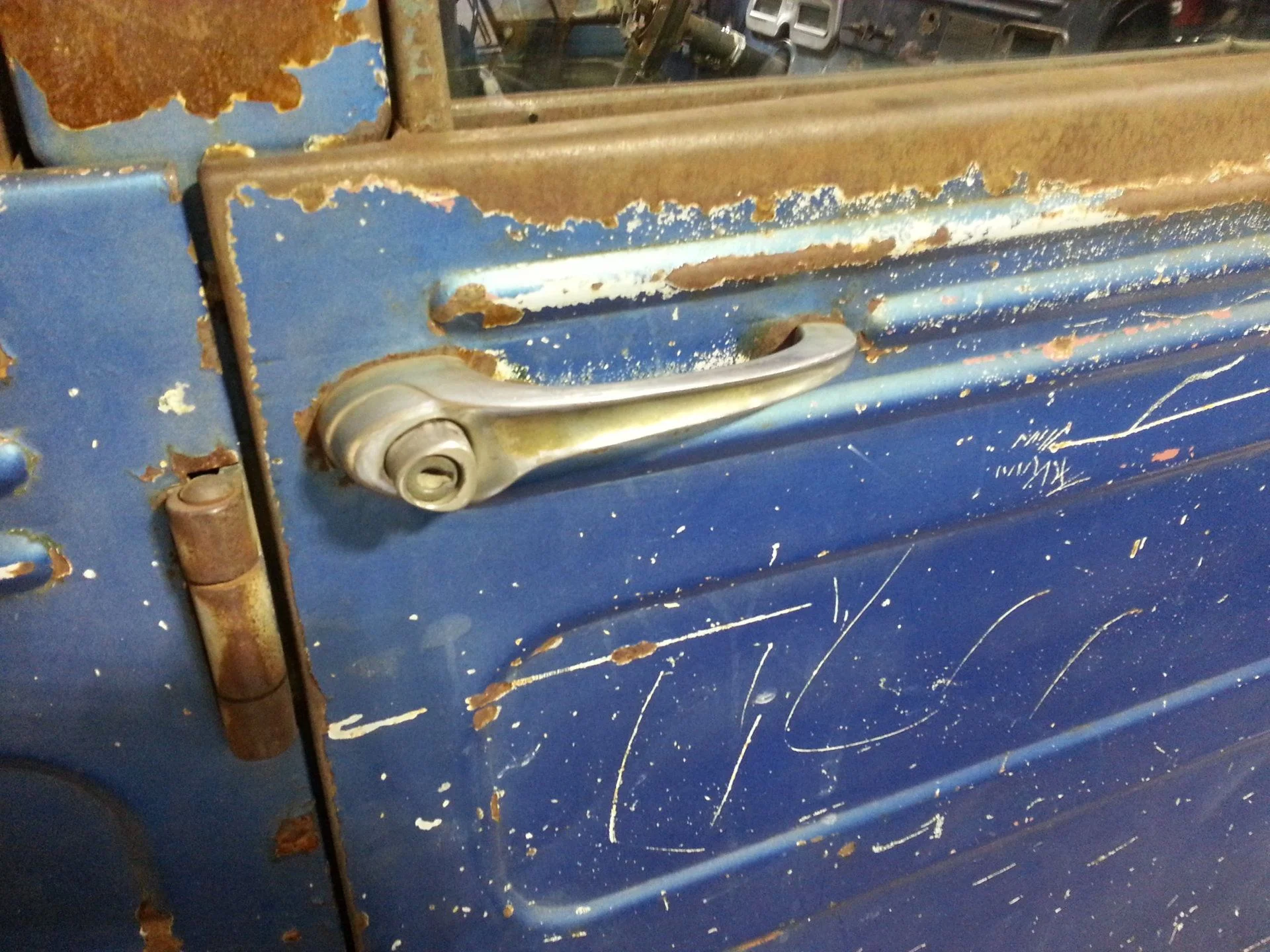

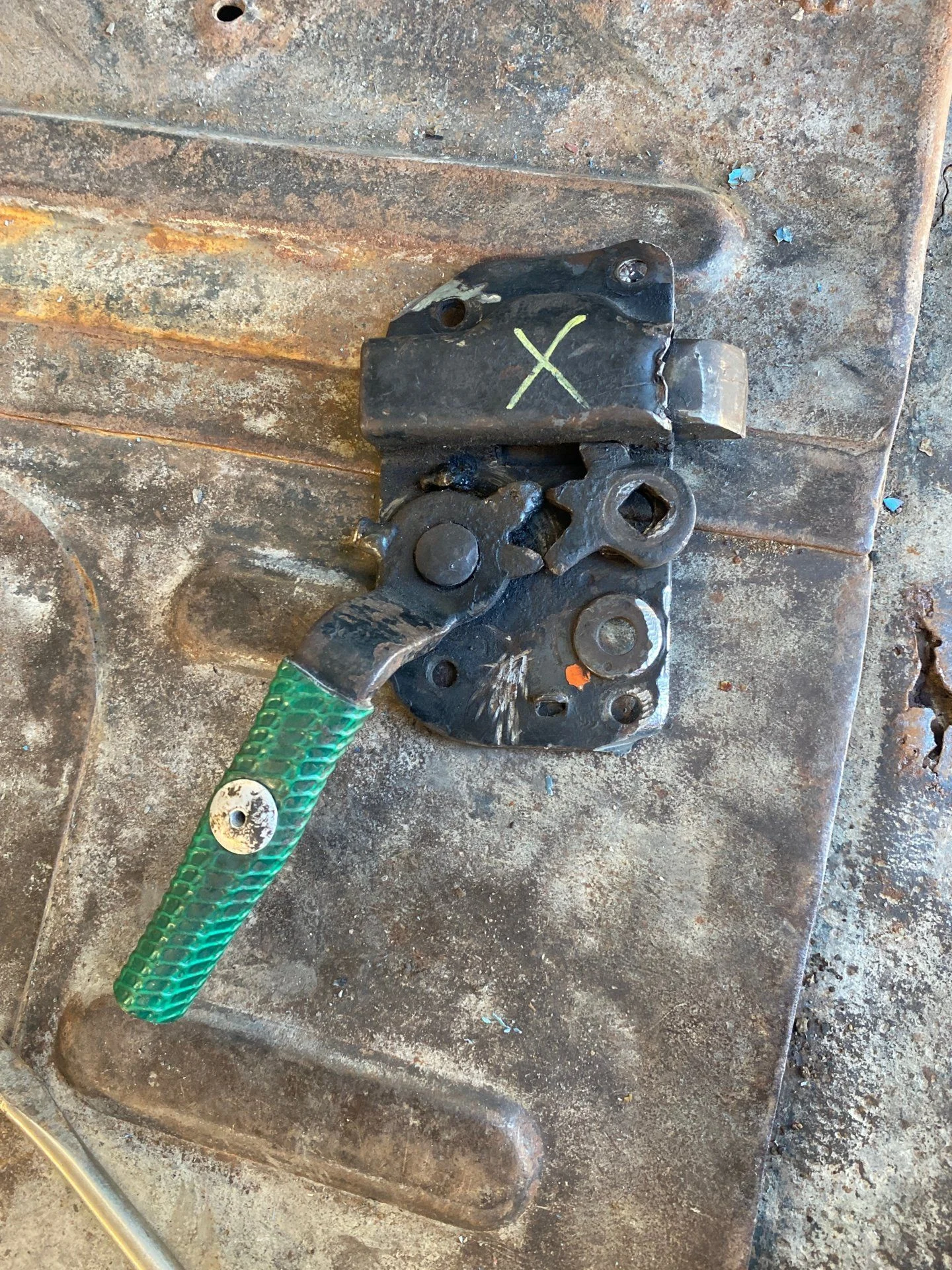

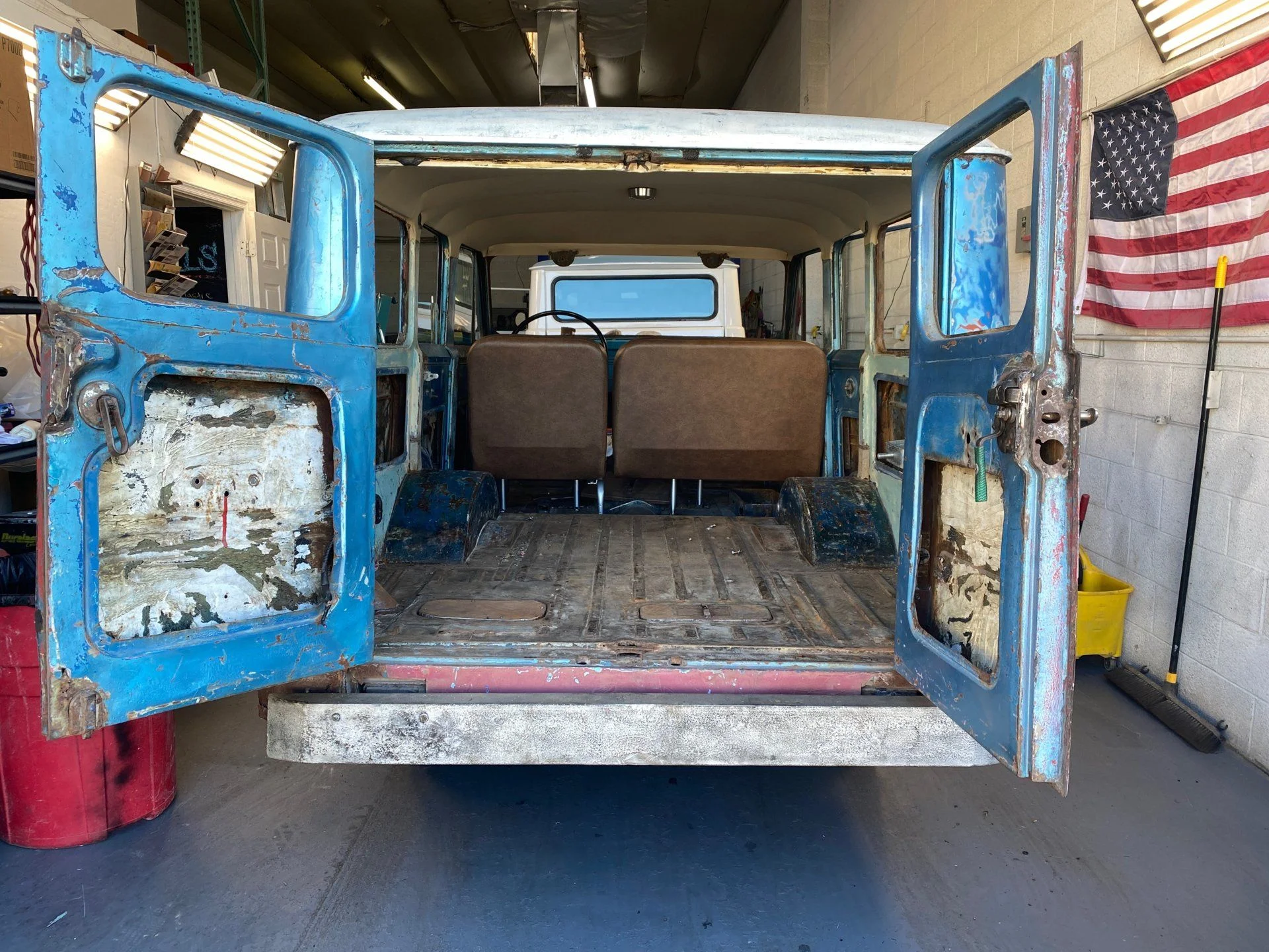

Rear cargo door mechanism - is this green hose piece original? :) kidding. I don't think the mechanism itself is, I'm wondering if I should try to use some of the FJ40 ambulance door hardware when we start putting it back together. One thing I actually have "spares" of are the exterior door handles from the LV (that this 28 shares) so I'll probably use one of those on the rear

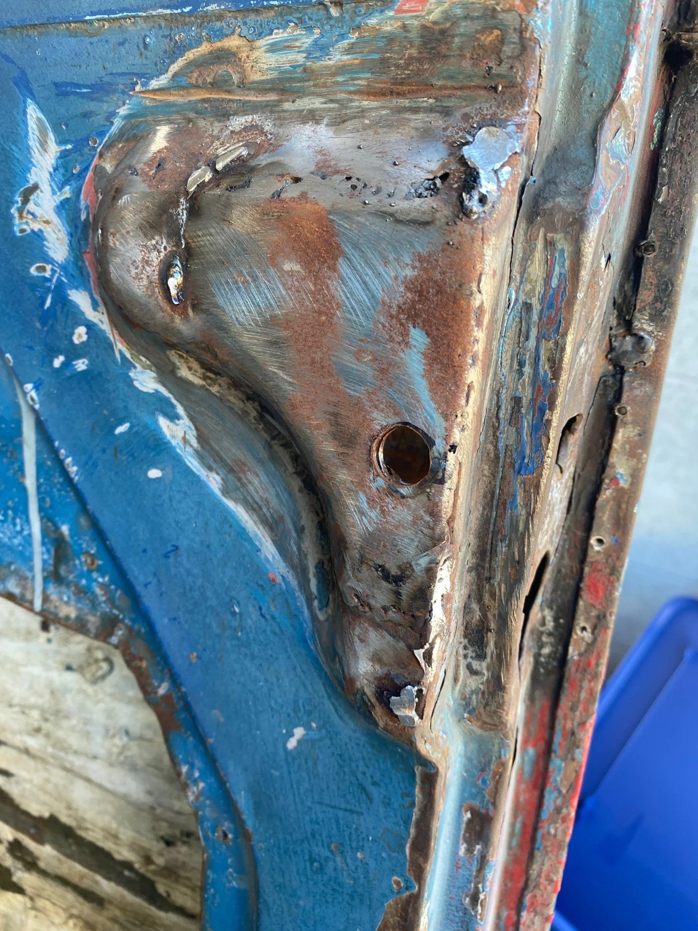

These other pictures below are of the ambulance doors themselves. Going to be some surgery in a lot of these areas for sure. Worst door is the driver side rear.

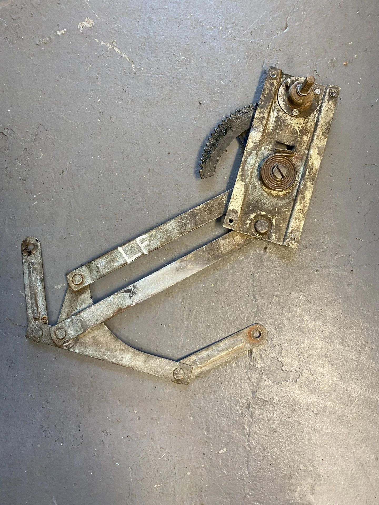

Which door openers and regulators do you need? Driver/Pass -front/rear

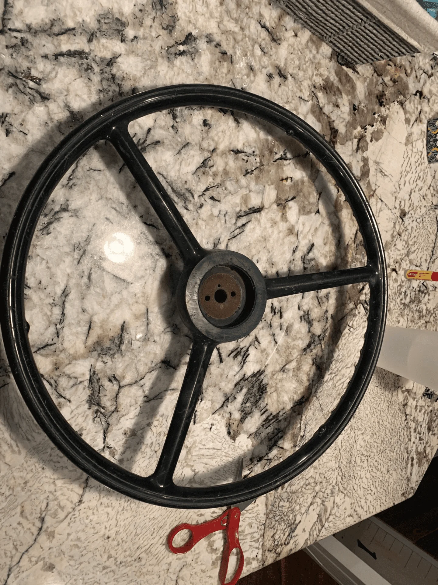

I believe I've sourced the correct steering wheel for this 28, thanks to @Indygbd - I didn't know these existed, learning a lot! See how rounded the base is? I'm hoping the horn button is interchangeable at least.

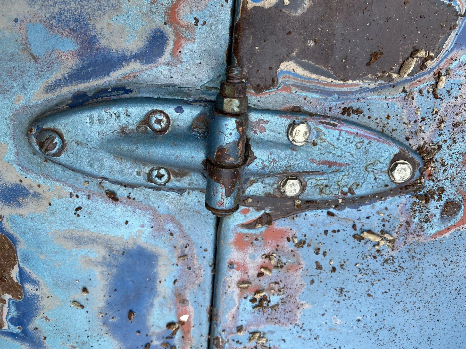

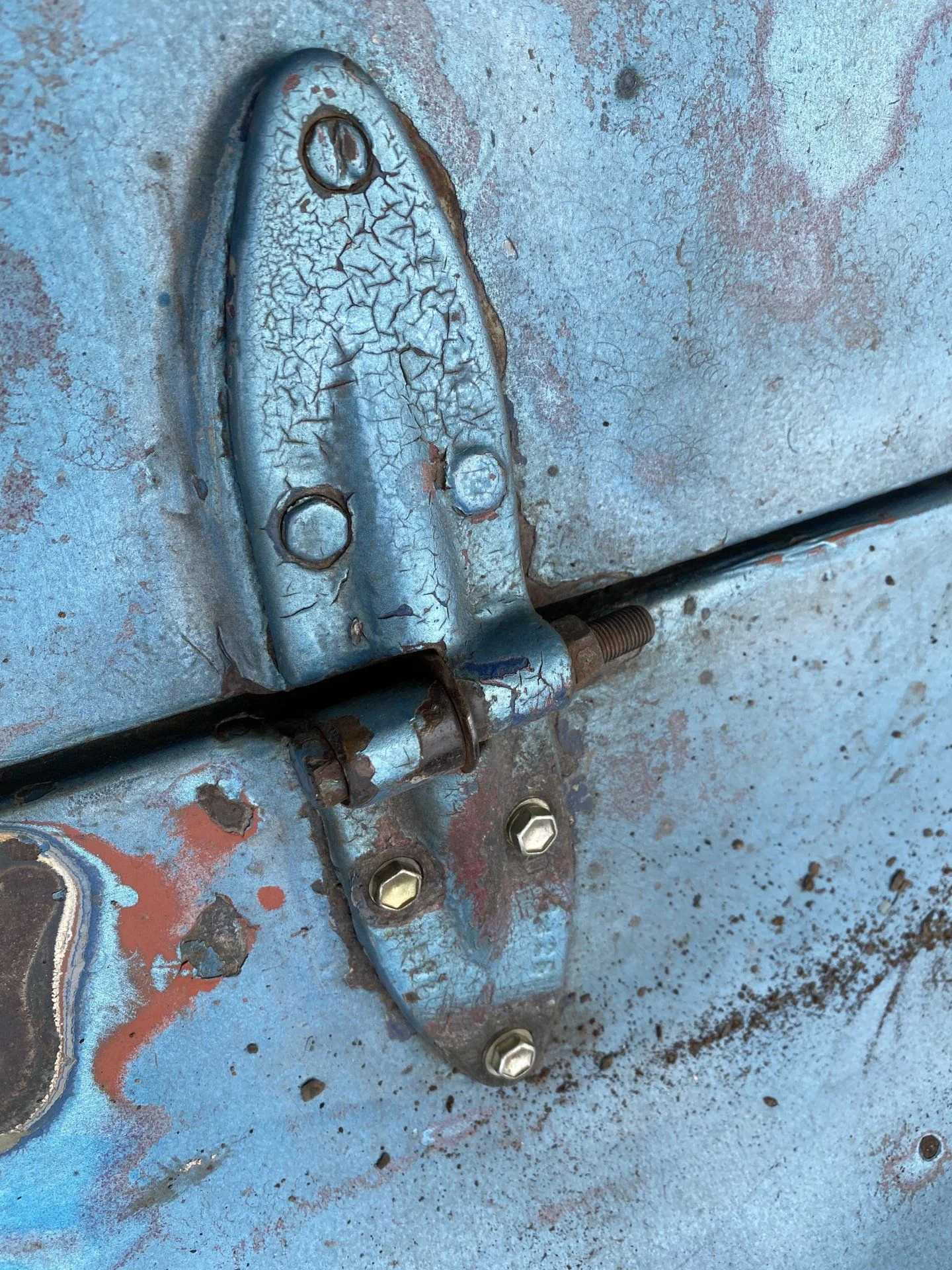

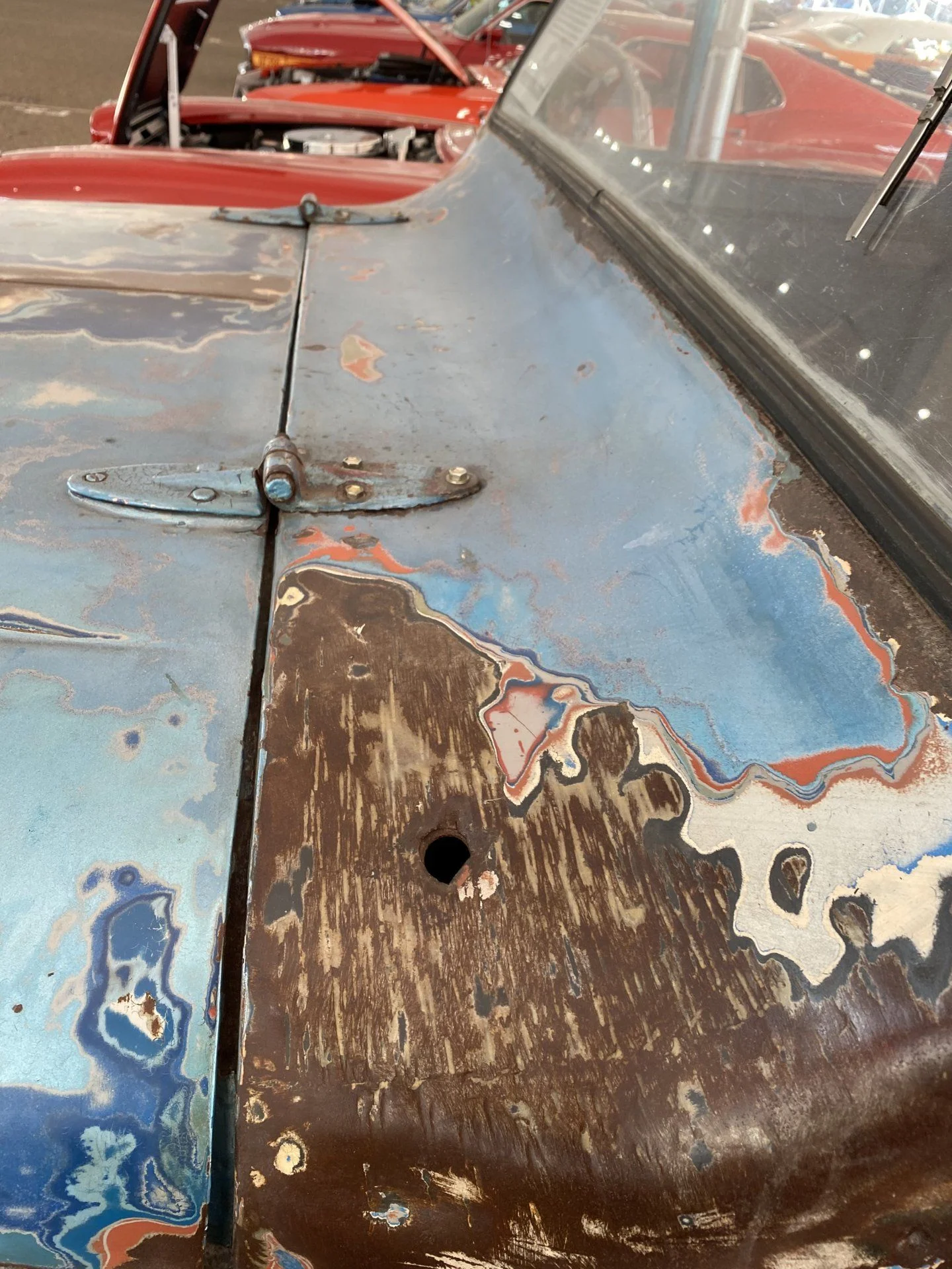

Can someone help me understand if these are the correct hood hinges or not? And what they should look like if no? They’ve got just some long hex bolts pushed through them right now. I hope we can get them out ok without damaging them too much but if not, I hope it’s something I can get a replacement for without too much trouble. Picture could be better sorry. EDIT adding a couple more pictures
