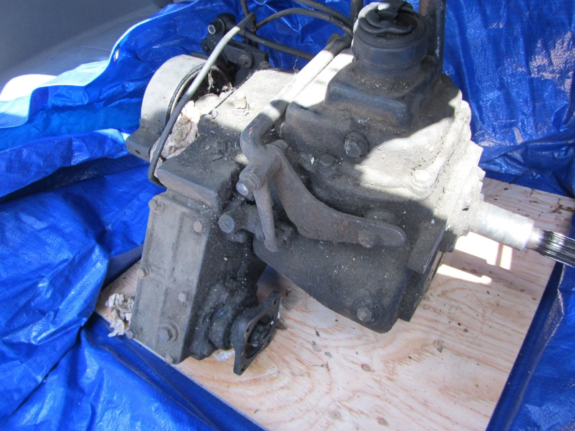

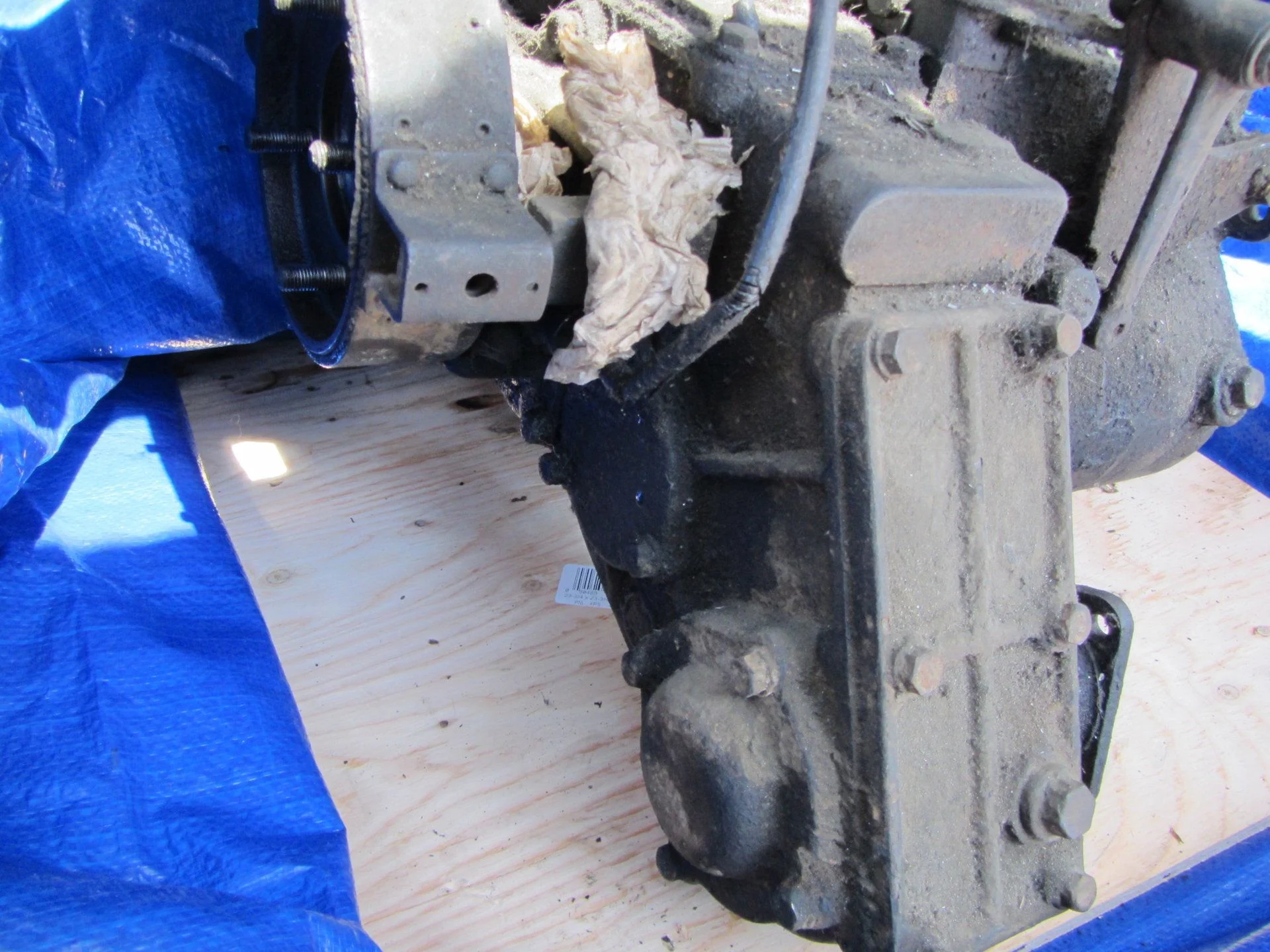

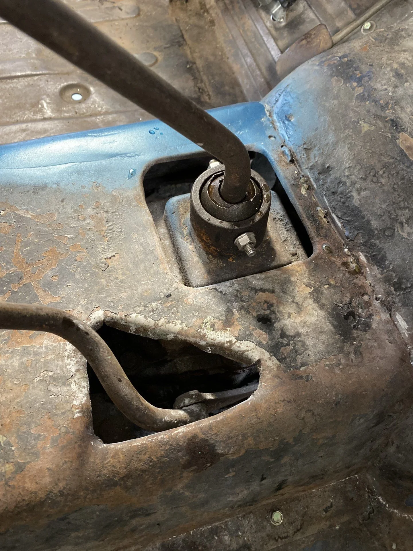

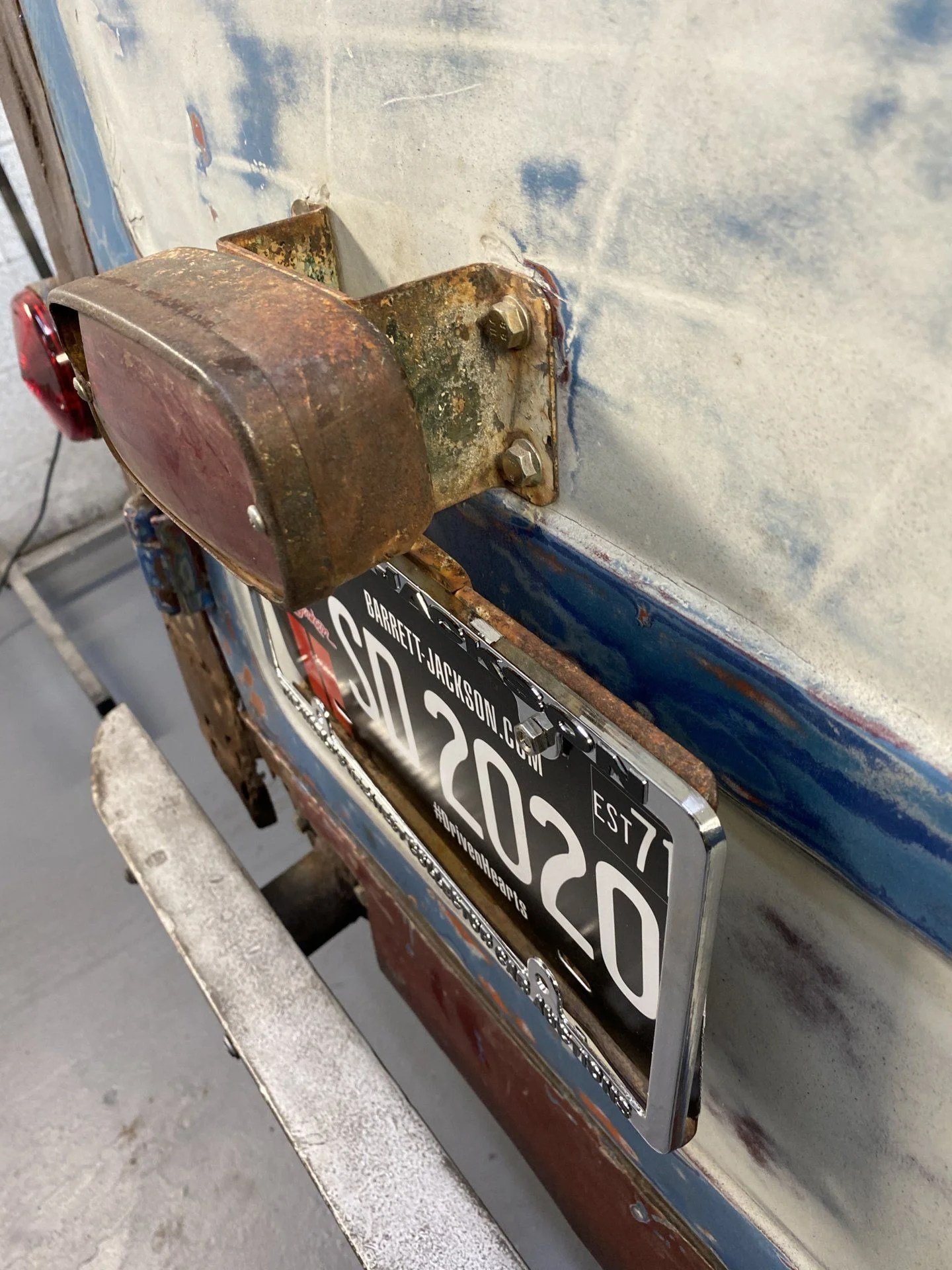

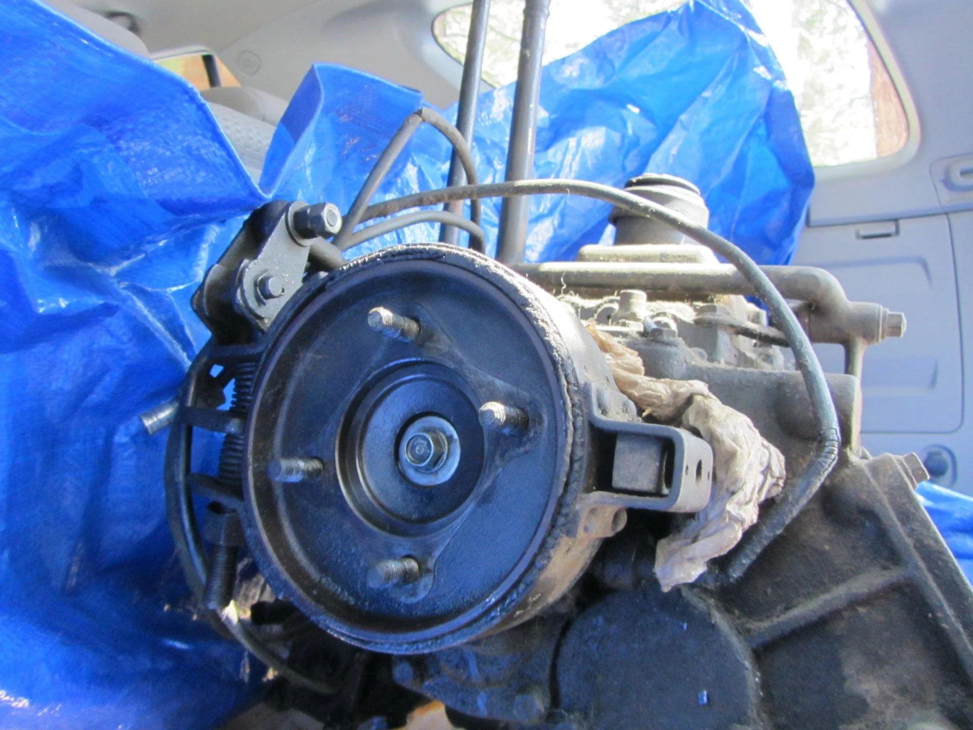

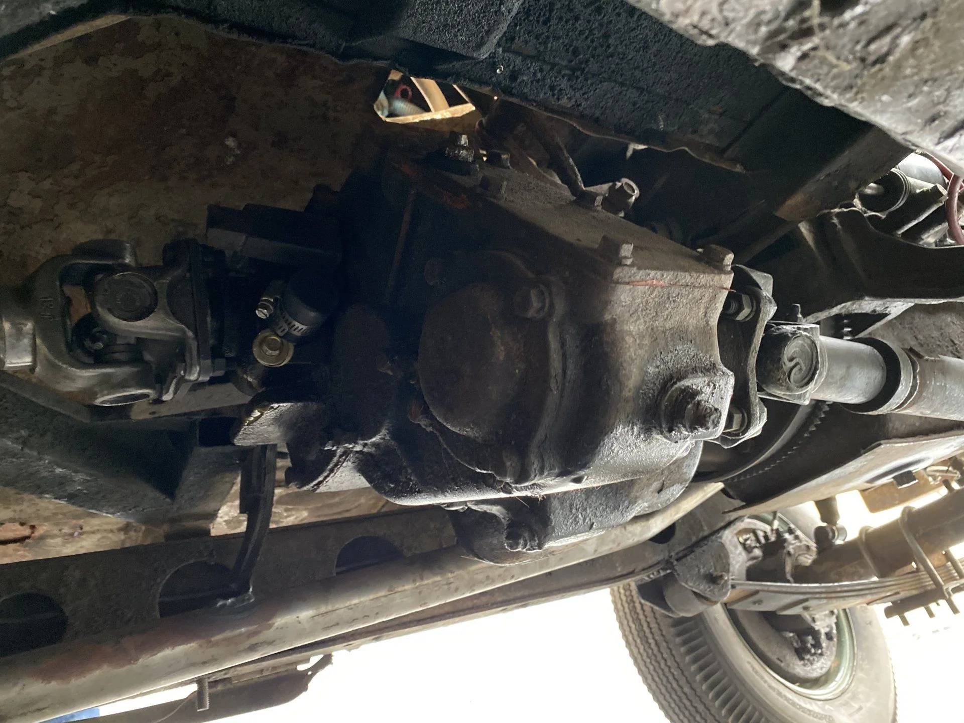

biggest question I have right now is the transmission - is this one original? The hump I don't believe is and I'm missing the e-brake. License plate bracket does look original I think but not the light

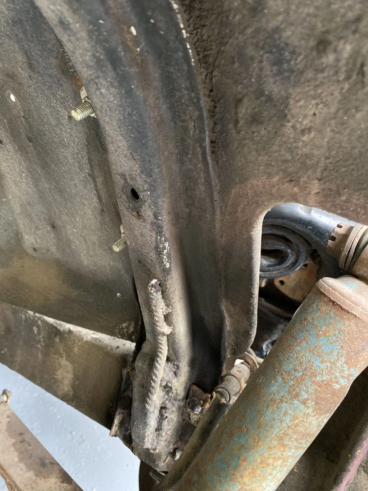

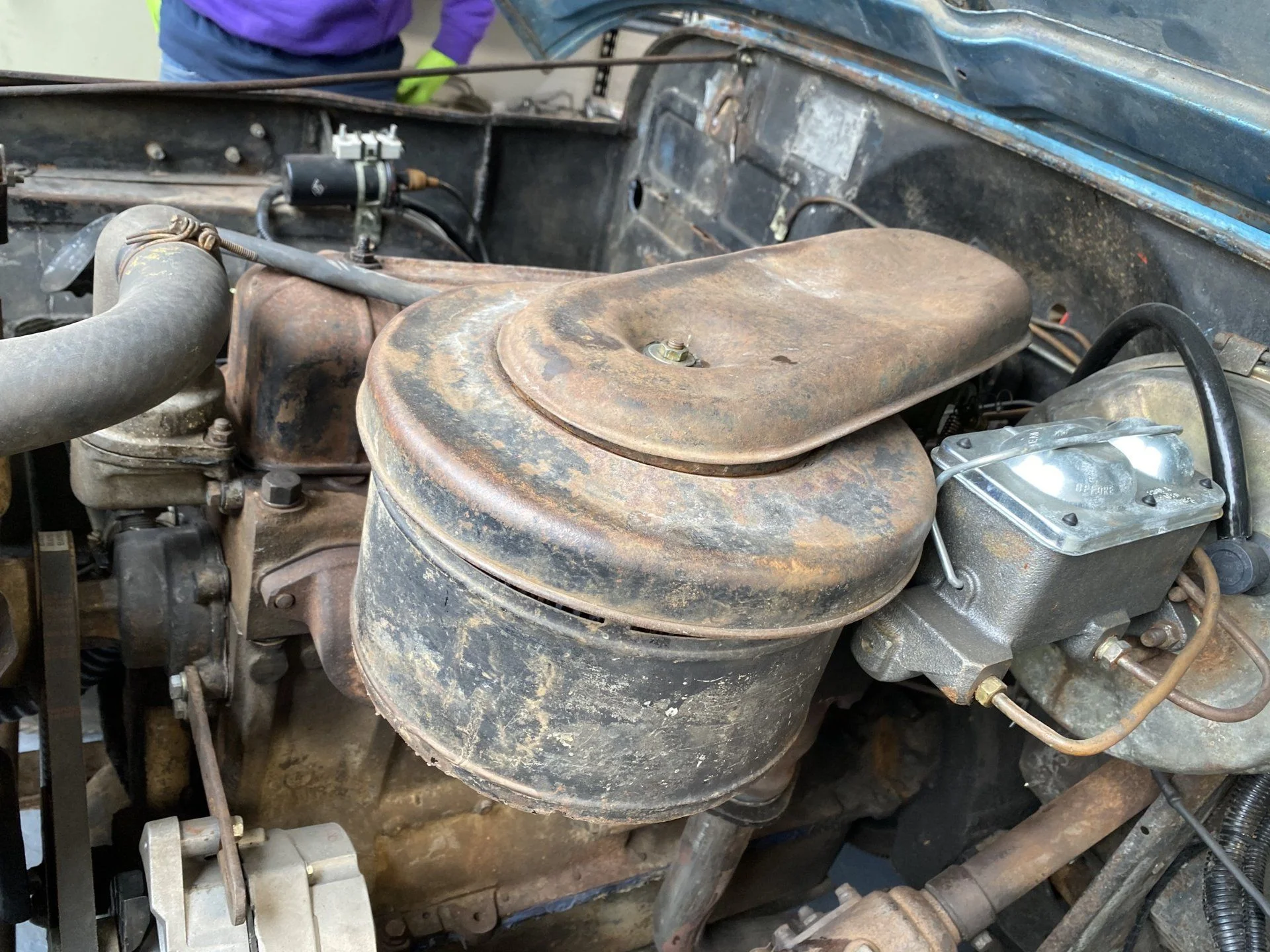

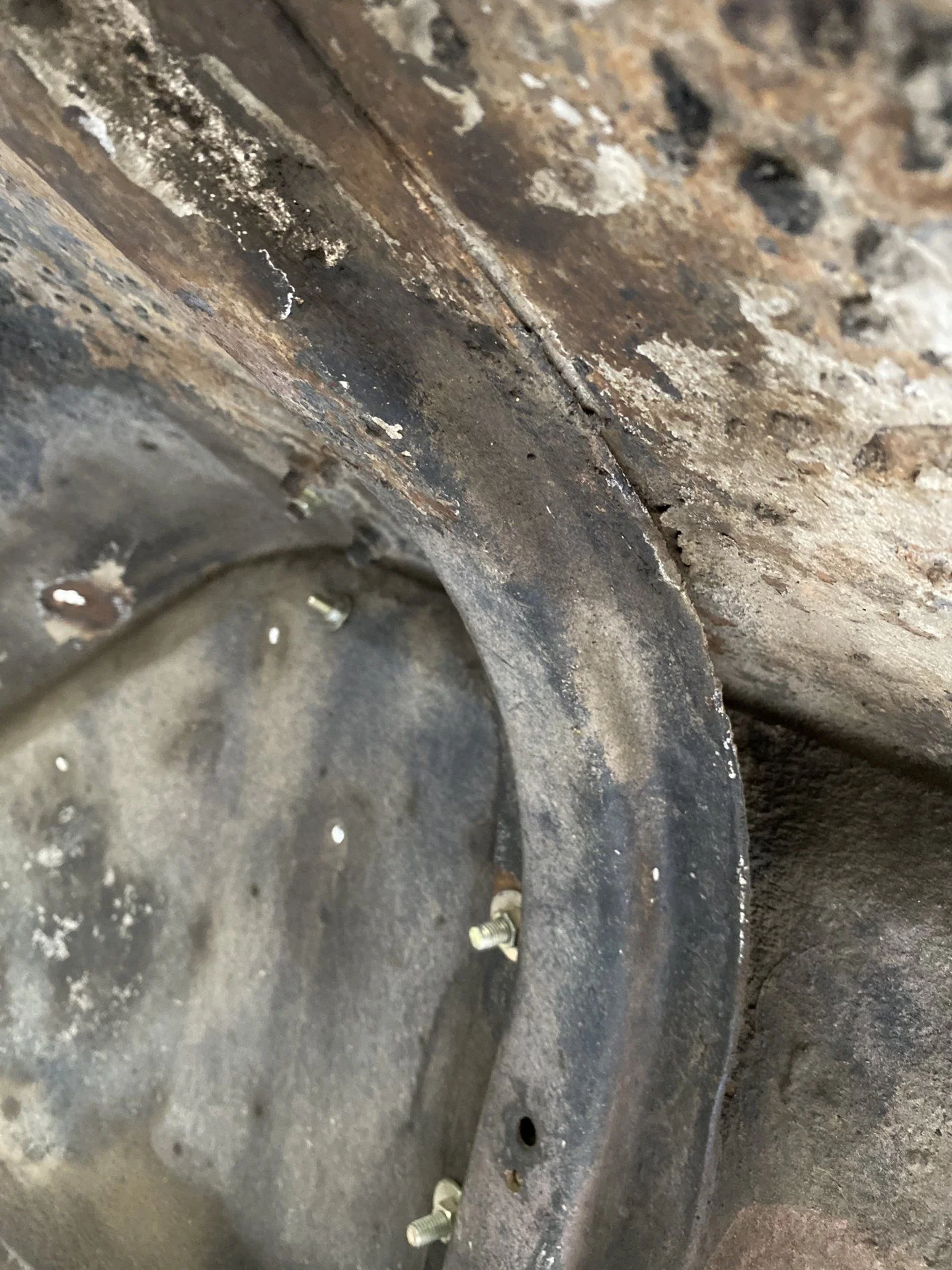

Last few, photos under the fenders. They're really a mess on the brackets. I guess this is an original oil bath cleaner but it's in really rough shape, bottom is basically missing so I need to source one of them. Picture underside of the transmission.
Nice, I'm jealous! Yes horns are FJ20 series and in the correct place. Air filter is a dry type, takes a paper filter. I have a oil one if you want to trade. :) Looks like correct tranny, missing E brake parts, E brake is located just like a FJ40 on the output of transfer to rear Axel.
Is there a oil filter on it?
Good question! Now that you mention it I don’t think I saw one. I dropped it off in a bit of a rush to go pick up my kids from preschool but should have more time to go through it tomorrow. Should the air cleaner have an intake over the driver side fender like my 40s/45 have had?
Not sure about 40/45s having a intake over the fender?? This wagon probably had a oil type air cleaner or dry type like the one thats in there. FJ25s with the oil type air cleaner had a intake on the drivers side apron, and I think maybe that stretched into early FJ40s as well.

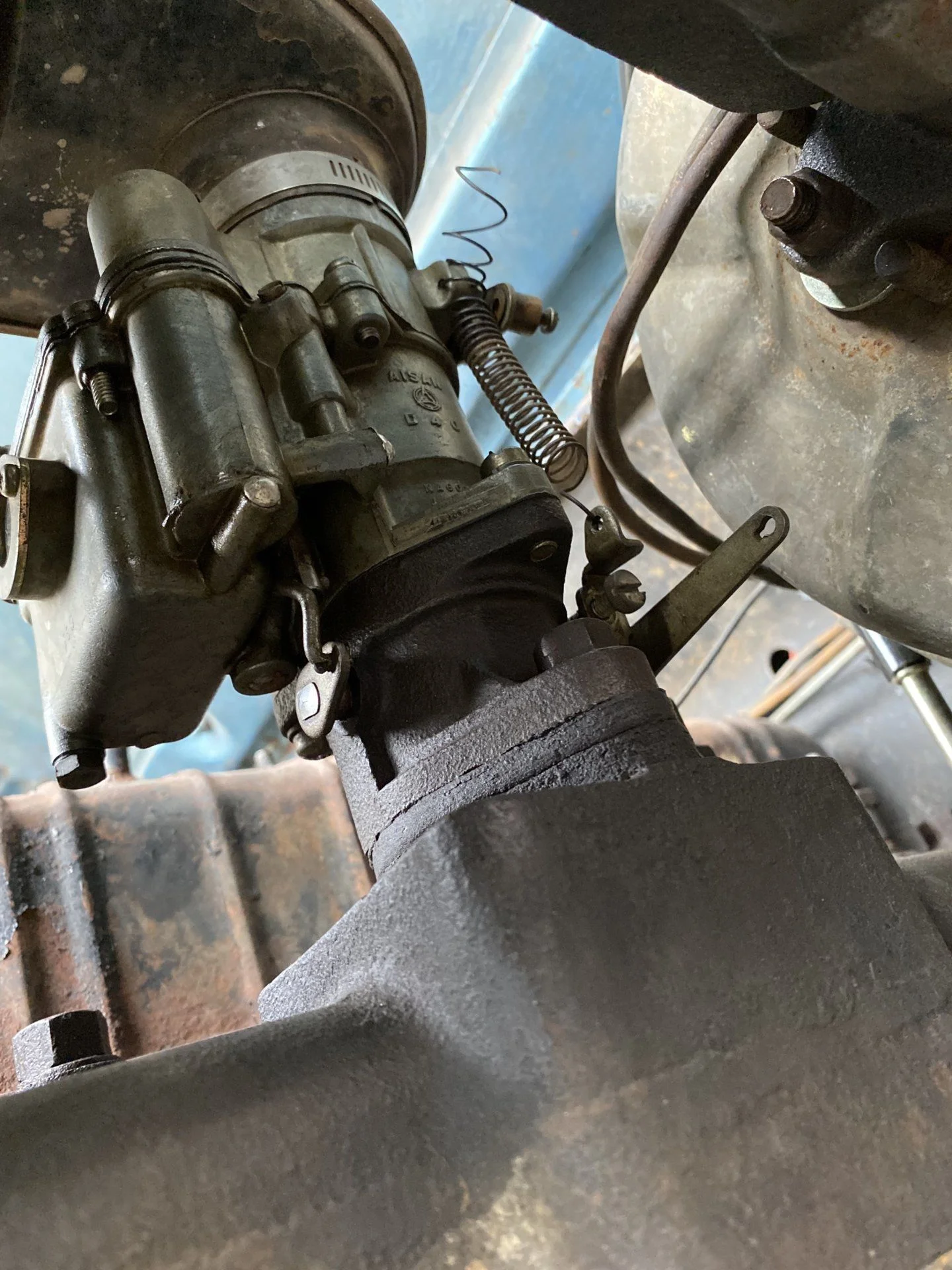

master cylinder is a chevy. booster could be early cruiser. you should not have boosted brakes and clutch and brake should be the cast cylinder stye, but if you can find those, i dont think anyone would fault you for using the tin master style. as mentioned, you should have a generator instead of an alternator. the wiring stands out hideously....maybe one of coolermans harnesses could be adapted, but if not, at least strip off that plastic loom and use wrap with the cloth or electrical tape. overall, looks like it's going to be an awesome project. fwiw, i love the maroon/cream paint in the brochure pics

annie has an oil bath but no fender intake. one elephant horn was mounted on the fender where the intake would be

If your planning on going back to a single line brake master ... there was an optional external brake servo ... one of the other 28’s have one as well... seen them in a few other early cruisers
They still make close to stock looking ones for other vehicles ... we used them on some British leyland stuff ... they are not vehicle specific

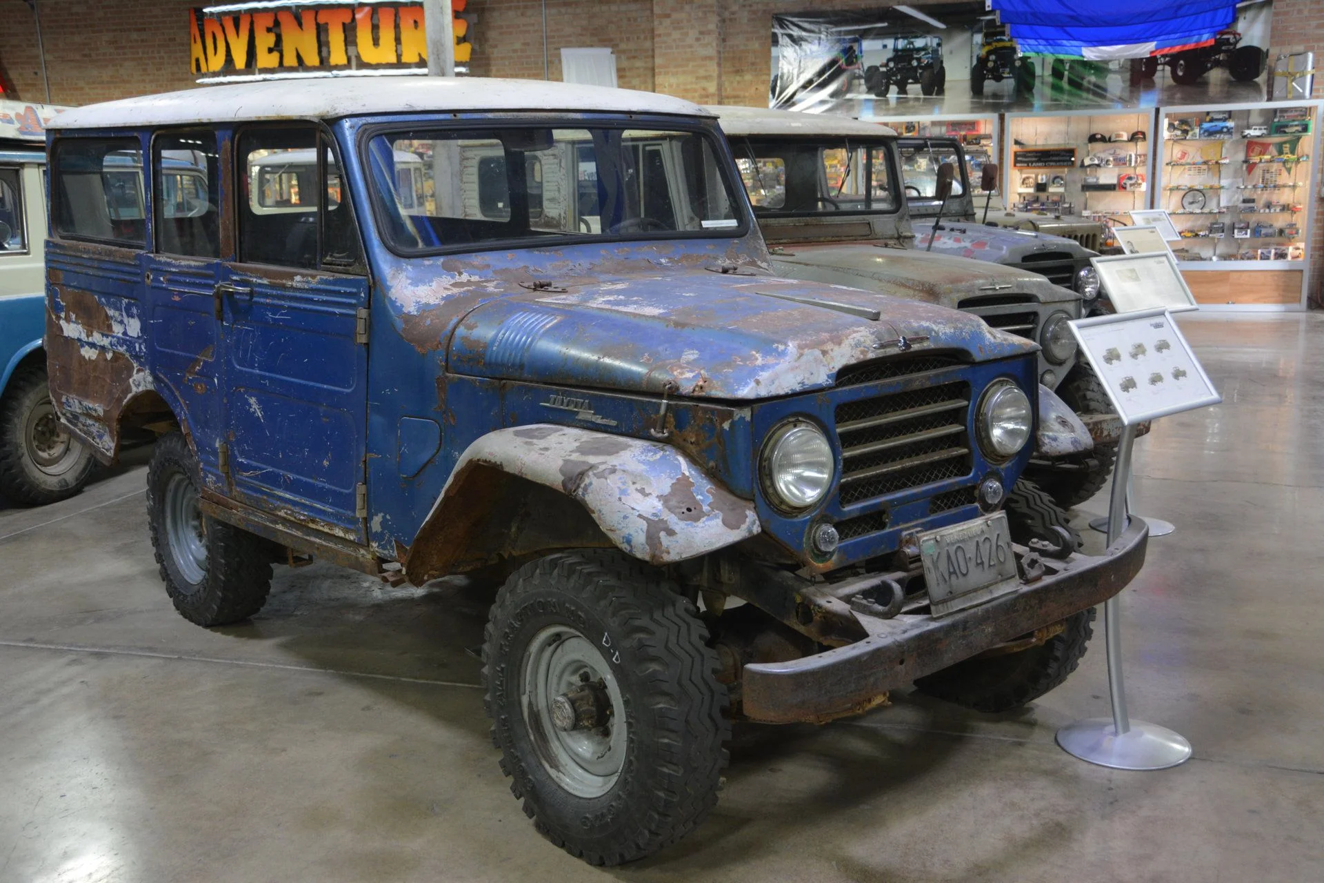

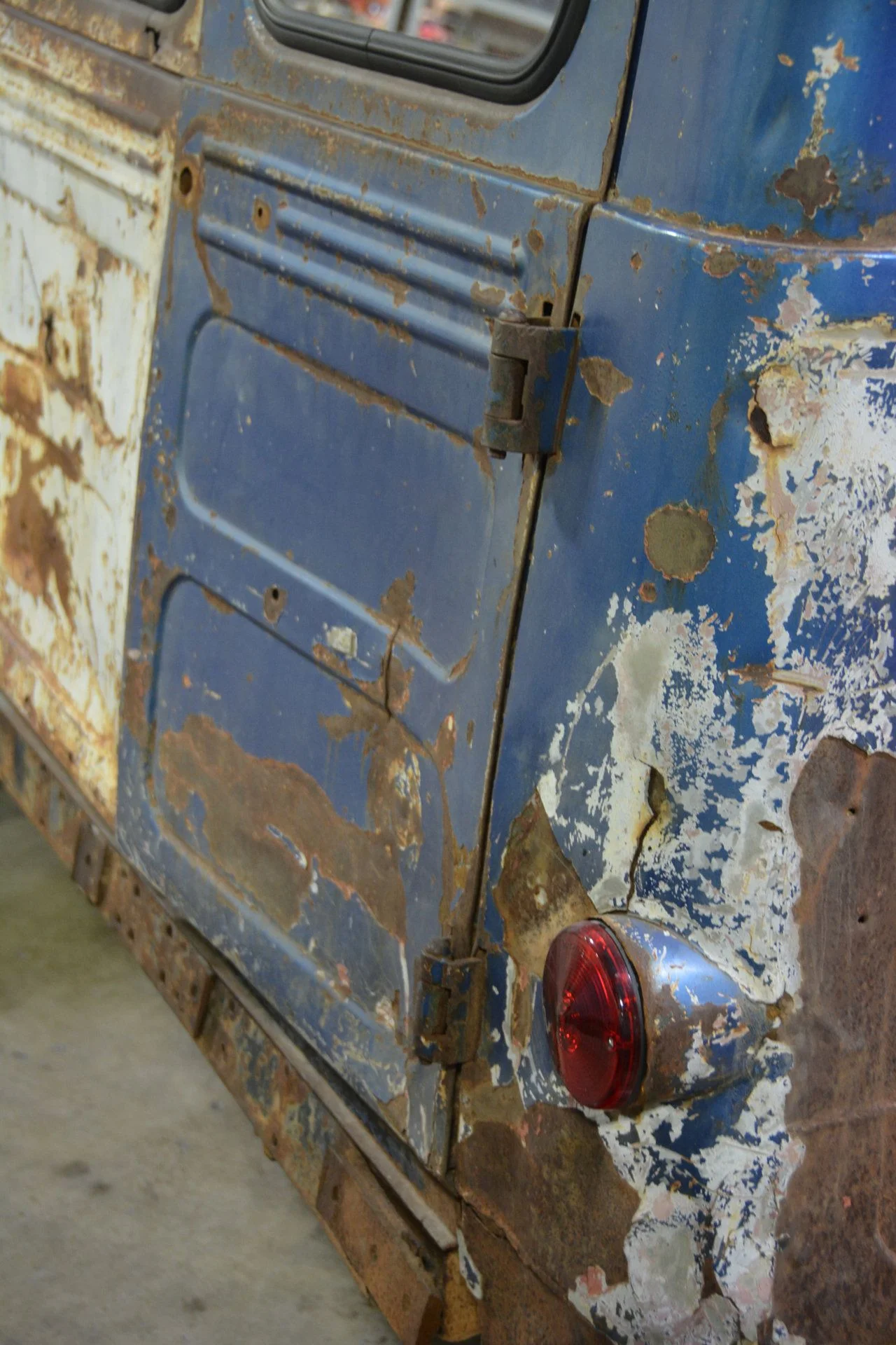

Tail lights definitely match the other and you can see where the rear plate was mounted on the heritage 28
I got to go to the LCH Museum a couple weeks ago, but having not yet seen Lara it was hard to know what to look for. I snapped a few pictures but I certainly need to look for more. It does appear those tail lights are original huh? I didn’t see that until now, thanks!
