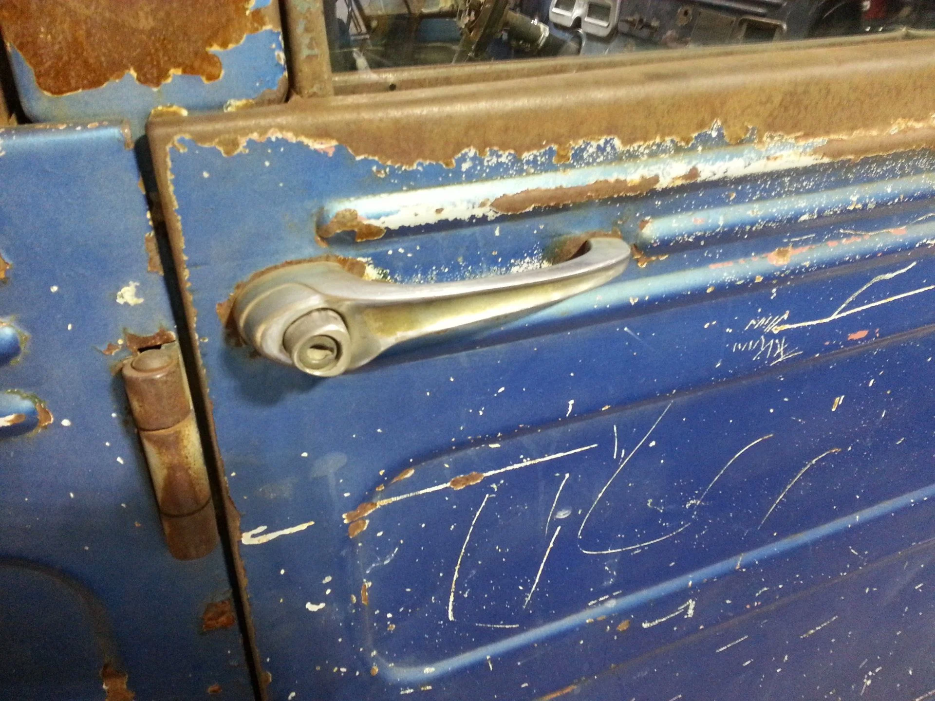

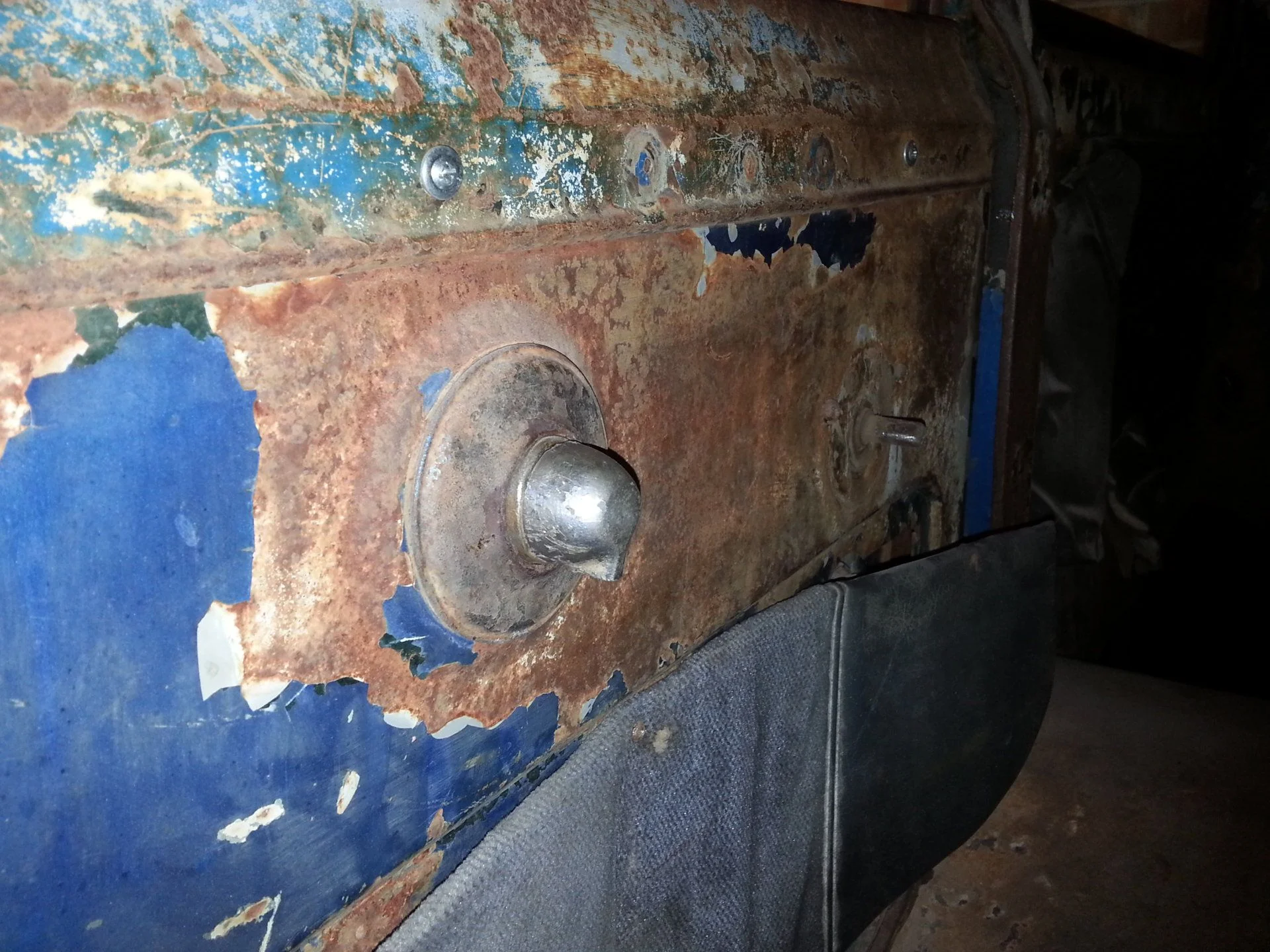

i tried to see your door latches and window cranks and mechanisms... had yours been changed out or original?
Im wondering on how close they are to an old mitsubish j30 or even say a vw... the mitsu wagons started around that time as well and parts could have been sourced from the same supplier as Mitsubishi jeeps that were built in gifu area too
the mitsubishi jeeps also used the clamshell heaters and they come up for sale on japanese sites here and there
Sadly there isn't much there to see.
That IS a lot to see - like my old chemistry professor used to say in lab “a picture is worth a kiloword”. looks like the same mechanisms as my LV which I suspected. However I probably won’t ever find those mechanisms. Maybe I can have them made ($$$).
the body work is going to take months. I’m hoping I get lucky and can find some of these parts in the meantime. Probably not realistic but you never know. @JohnnyC keep the suggestions coming maybe I’ll look into those VW and Mitsu handles. Door mechanisms can always be switched later if I come across the LV parts 10 or 20 years from now.

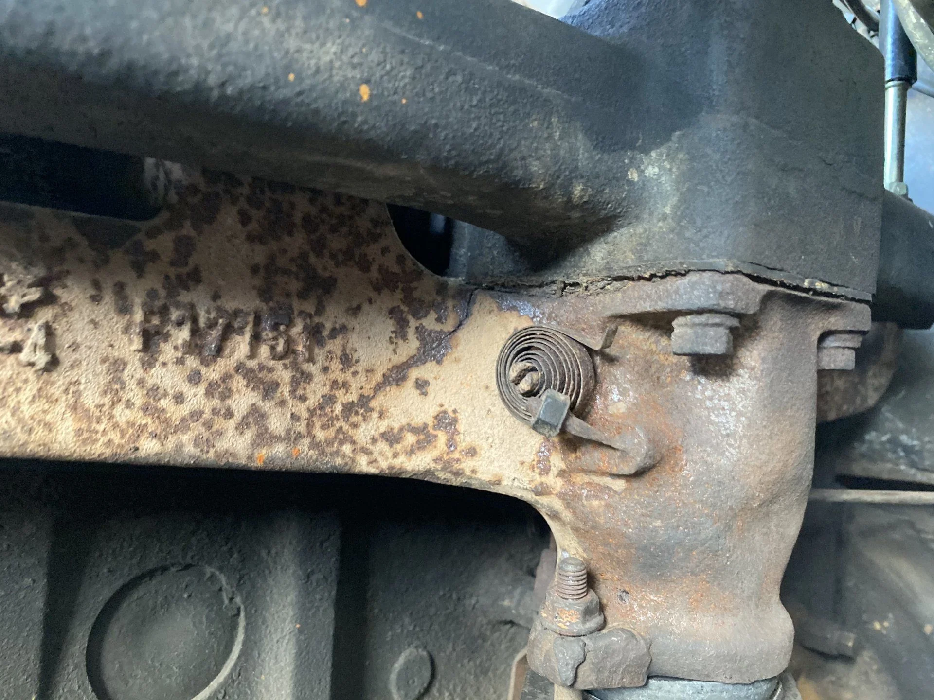

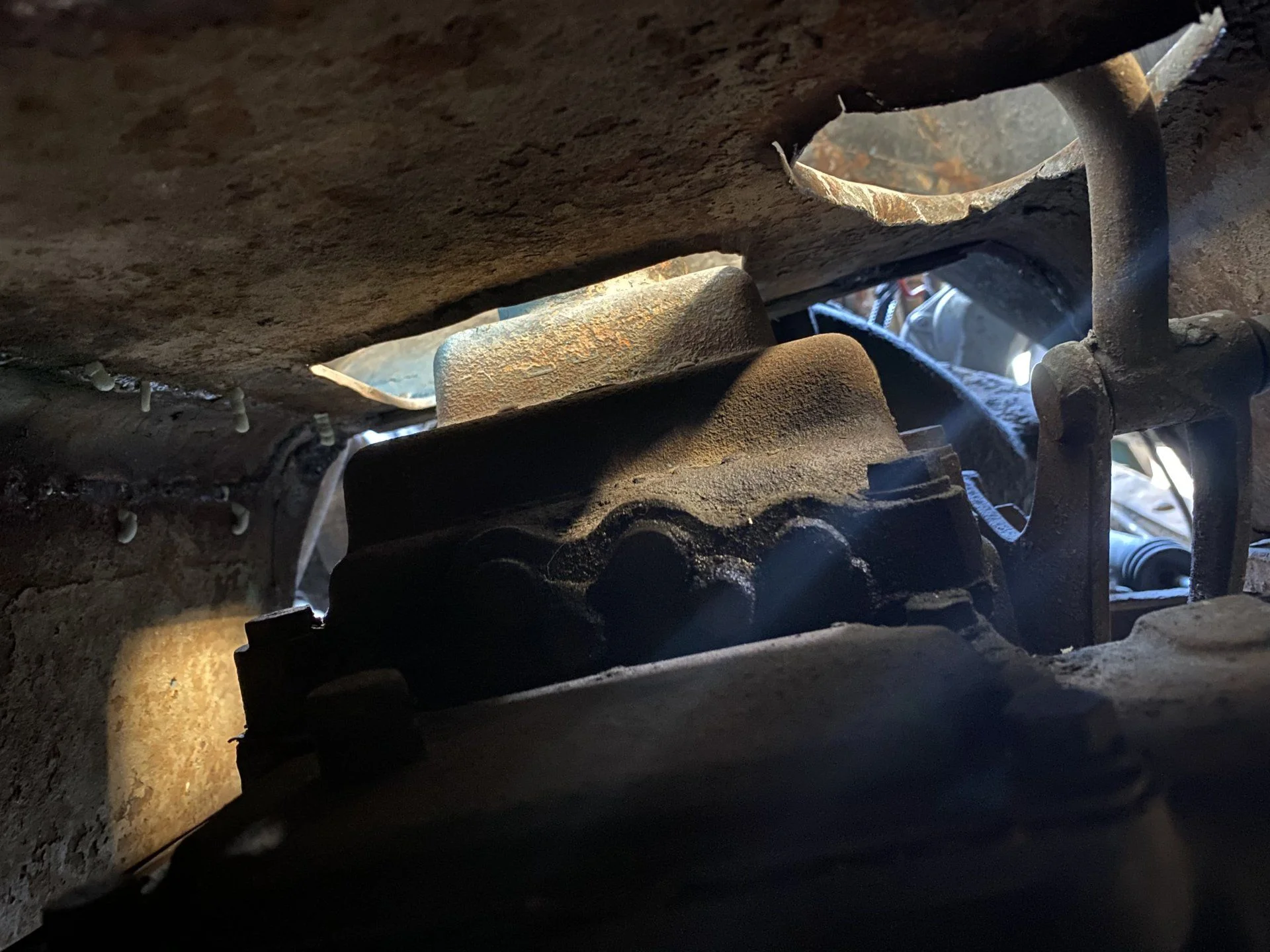

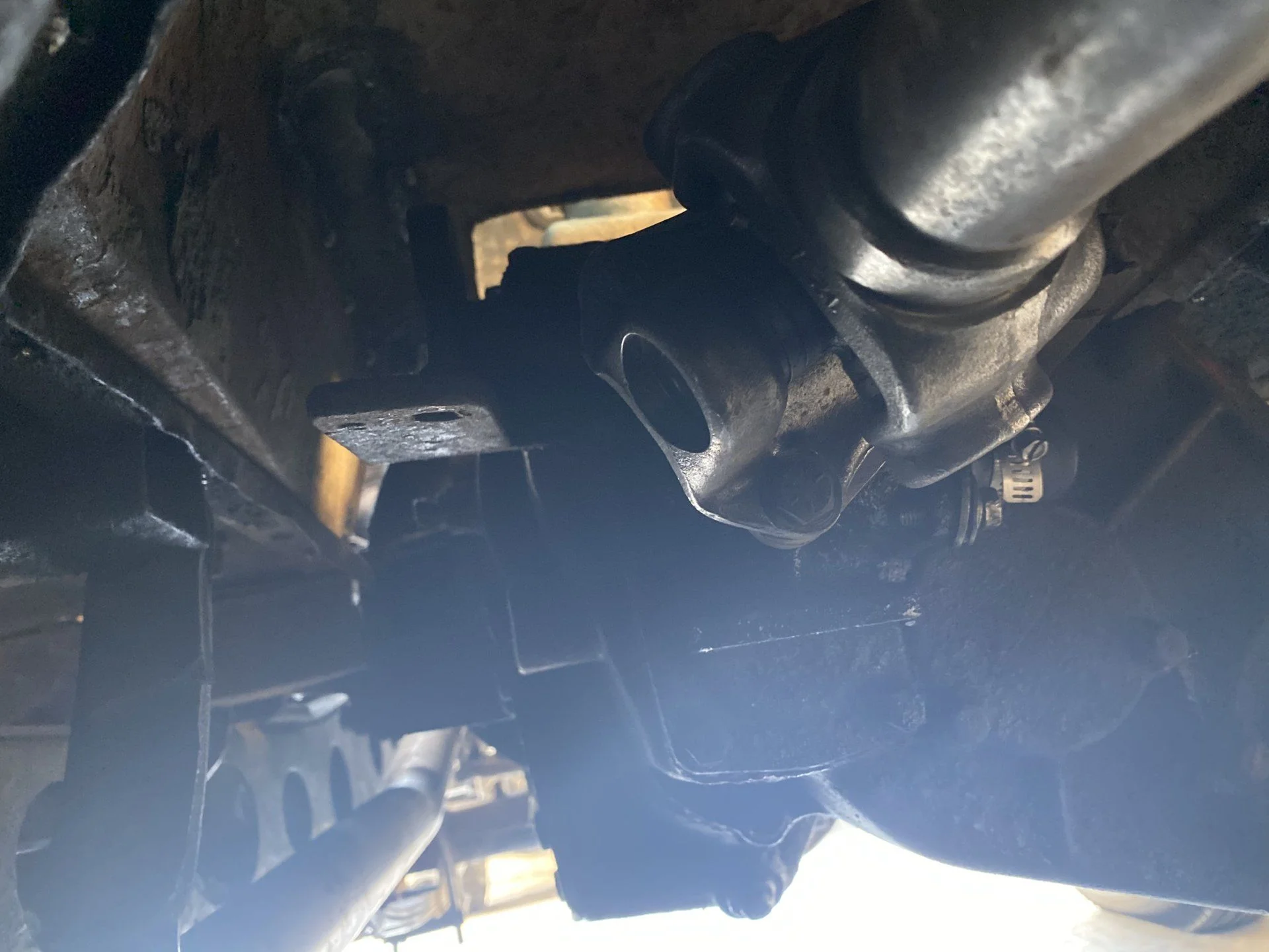

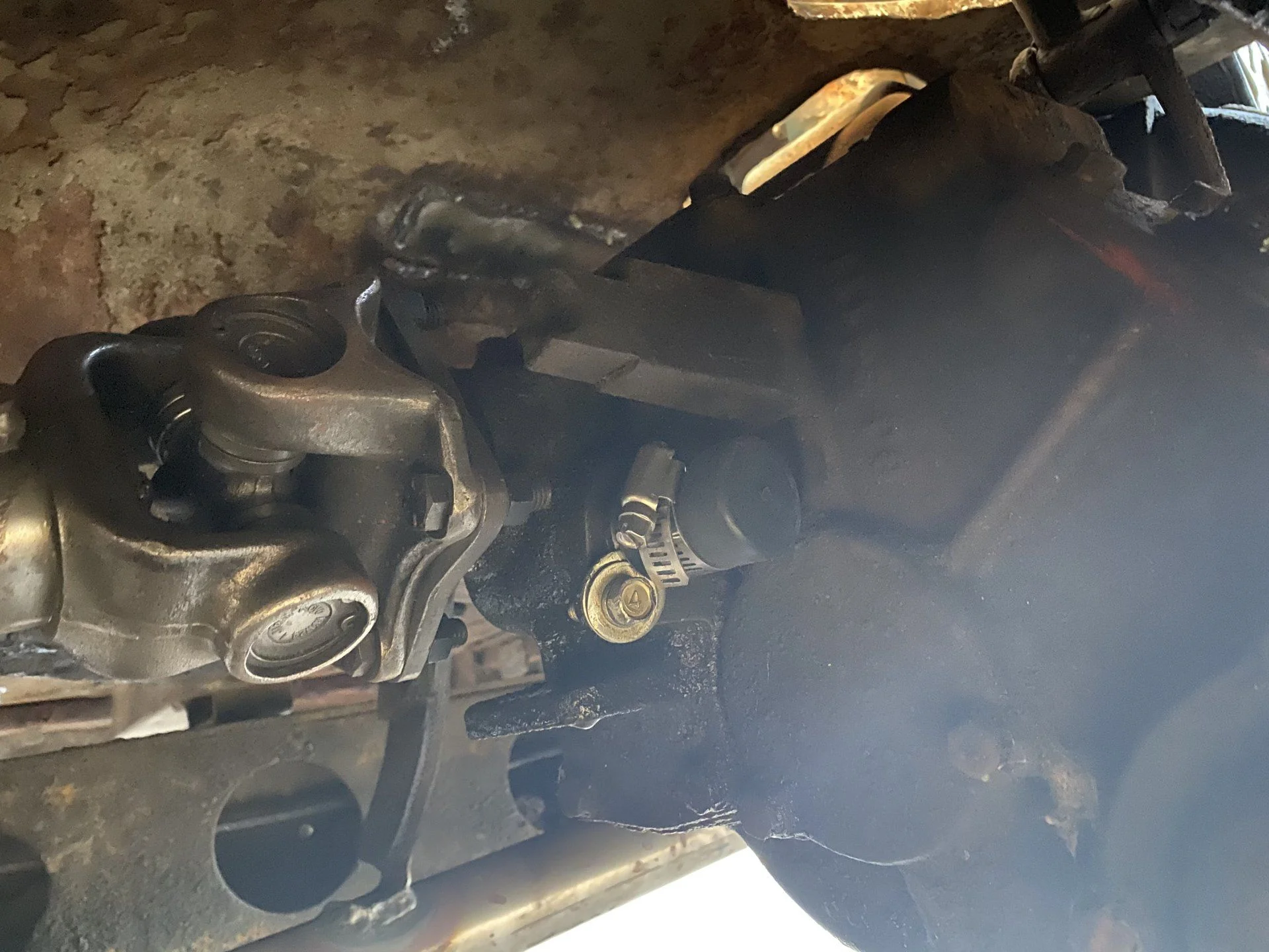

Took some photos today while I had a few moments to run over. Does look like we can get the ebrake figured out, sorry the pictures are terrible my phone doesn’t do well in low light. And we have 4 bolt fenders on one side. 0 bolts on the other - welded on!

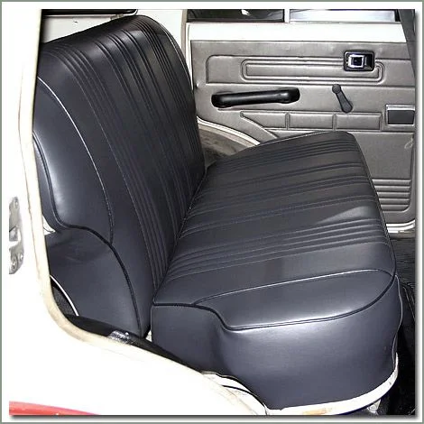

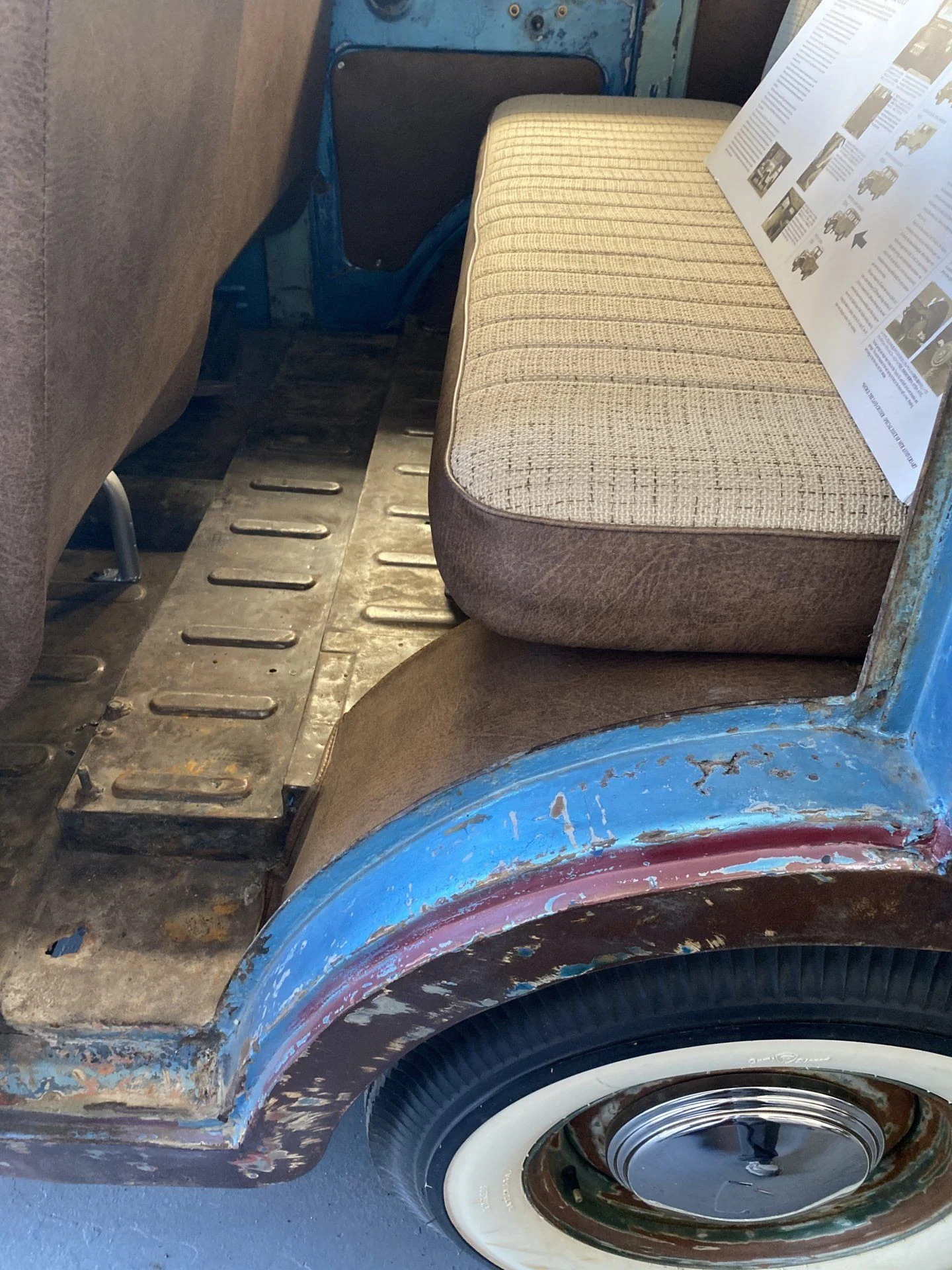

I’m going to take a look at a local mudder’s 55 this weekend to see if a 55 rear bench seat could be modified to match the LV seat - which I think is likely how this 28L rear seat looked originally. The rear wheel well is shifted forward on this truck probably 6” further (vs the LV) into the door opening so it will be tough and a little different but I think this is likely my best bet for the rear seat. Front seat still TBD...
First photo is the 28. Second two are the LV. Last two are some 55 seats.

Would definitely be interested in seeing how @KT40 LV looks with the 55 bench. We measured the spacing in the LV and the 28 today and if we had an LV seat it looks like it would work with very little modification. So if a 55 seat works in an LV we should be able to make it work in the 28. Then i just have to find one!
thanks @treerootCO thats one spec sheet I hadn’t seen yet!
@KT40 has a 55 seat in his lv, maybe he can shoot you a pic?
That would be great! Remaking the one I have wouldn’t be ideal.

I will get some pictures on Sunday.

FYI some good news thanks to @Tancruiser I believe we have some front and rear FJ45LV seats for the build from someone he knows. Best possible scenario for the interior for sure! Fingers crossed.
also got some very nice detailed dimensions of the FJ55 seat from @xtremeVA and saw a set in person thanks to @Hank Tank beautiful 78 nearby and it looks like we could make that work as a fallback if necessary. The LV seats obviously would be best as it’s possible that’s what was in there originally from Gifu.
