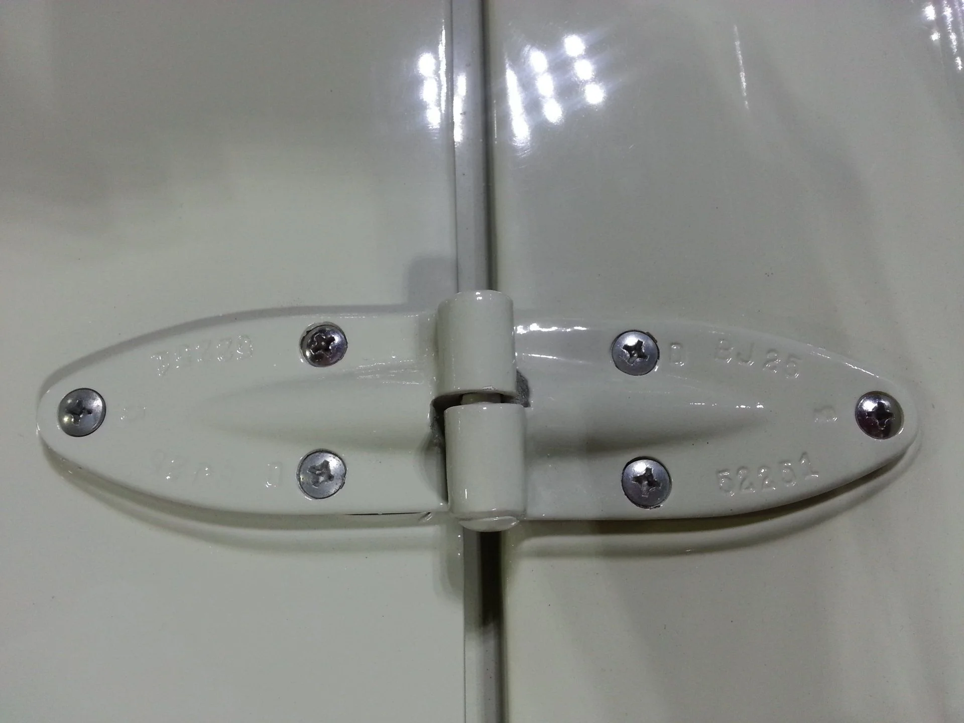

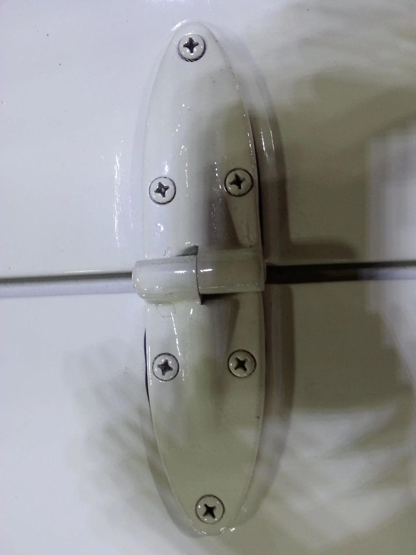

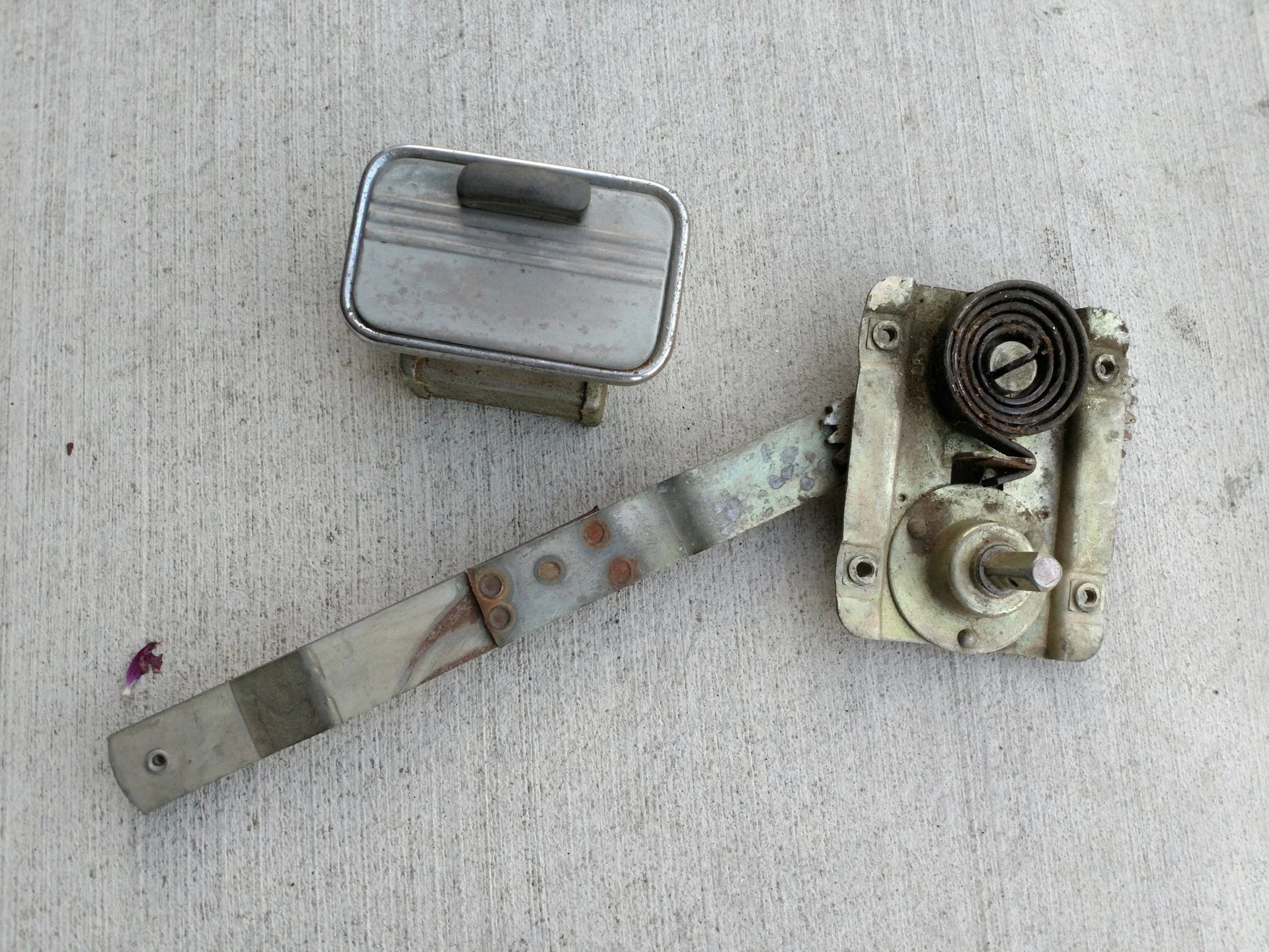

Here you go brother... a LV front passenger side regulator and an FJ28L Ashtray. This ashtray was found on the FJ28L, FJ35V, and the very early 45LVs. The regulator is an extra that Marv Spector gave to me. Just like the ashtray, they were both meant to go to you. Years back when I was turning my 45LV into a 35 I saw the ashtray at SOR and said to Marv, "Hey, that's the ashtray that was on the FJ35 dash." He just said, "Take it." Since then I've decided to leave the LV dash as it is and the ashtray has been sitting on a shelf. I'm really glad to be able to help you check things off the list. I also have the early split hood hinges you're talking about. I believe one has the pin still in and the other has a bolt. Mine both have "BJ25" stamped into the top of the hinge. I'm going to clean them up and have new pins pressed in. When you find out what you need in door opening hardware post it up. I'll see if I can help out there as well.
Those are beautiful! Thank you thank you. I’m heading to the shop in a few hours and will try to get to the bottom of our door and window hardware situation. I think we are in better shape on the window regulators than the door lock hardware.

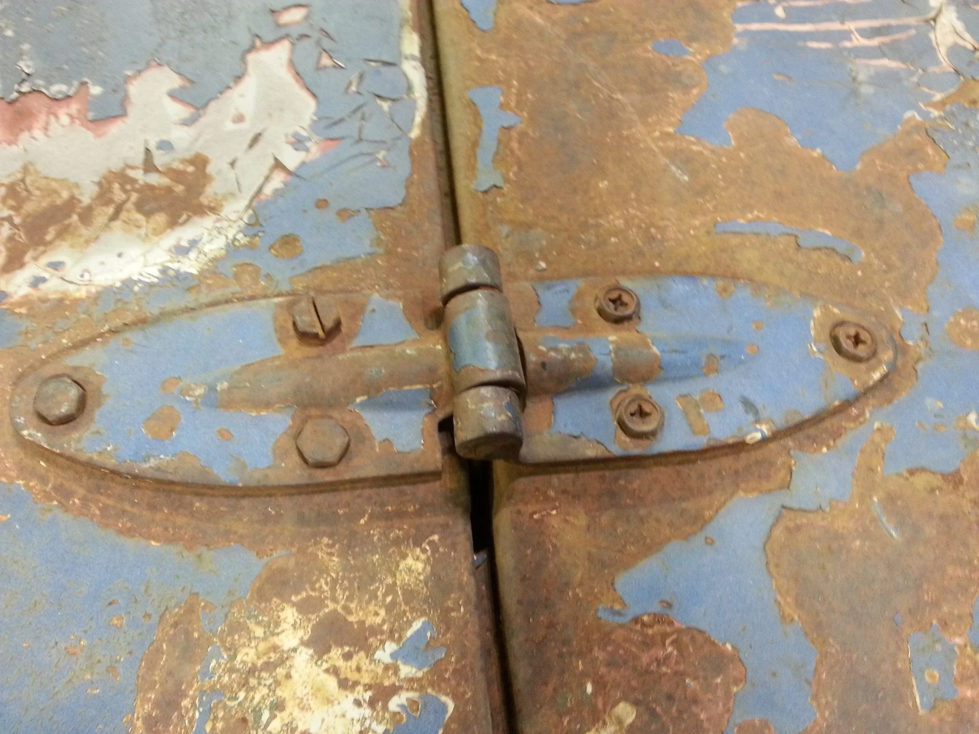

This thread is already turned into an epic source of information on 20 series and early 40 series land cruisers. Gene (@Land Cruiser Junky) I will put my 2nd dibs on two piece hood hinges. (Just in case Dan decides to restore and keep the one that came with “Lara”). I have been looking for them for many years
Hello Archie, I had no idea that you were looking for the early hood hinges. Mine are basically in the same shape as Nathan's so he's not really in need of them. I will probably use them on my LV but will make the decision shortly. If I don't use them they're yours.

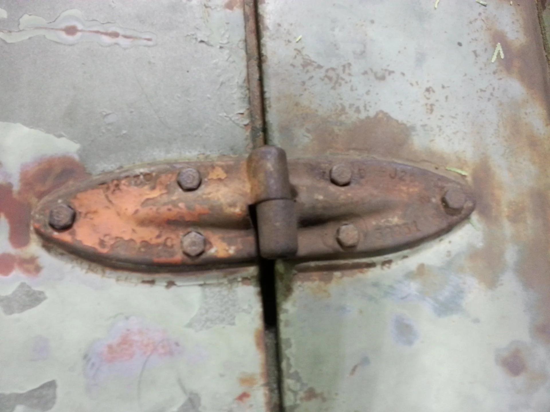

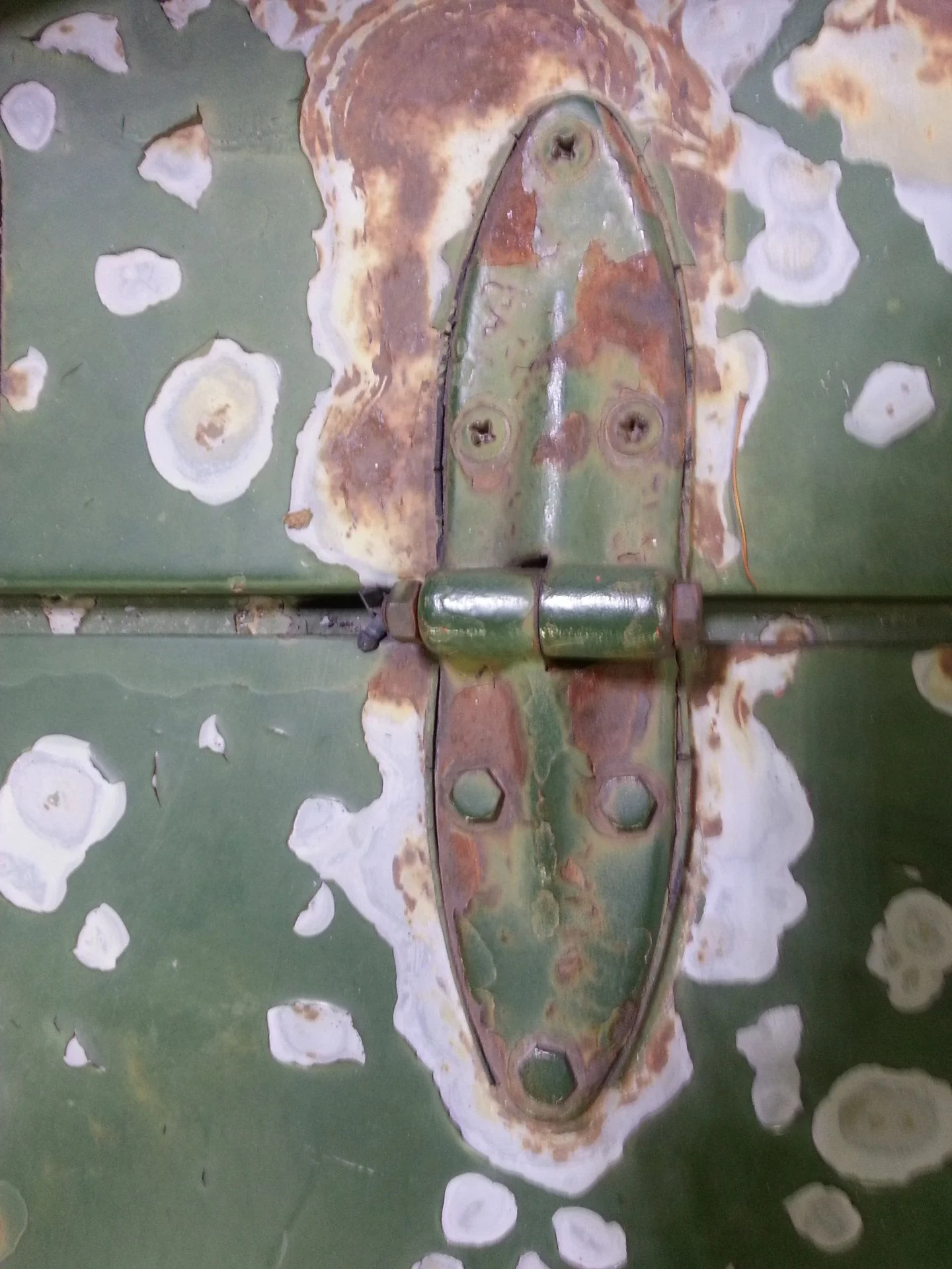

On the hood hinges, I posted a couple of better pictures in the original post above - those pictures from @cruiserdan are super cool I didn't realize there may be stamping on them, will be anxious to see them come back from blasting in a few weeks (and PS - that FJ28 pickup is gorgeous). So it looks like I may have original hinges, some good news? Just need to figure out a pin for it which shouldn't be too difficult. The hinges themselves actually seem to be in decent shape on closer inspection.

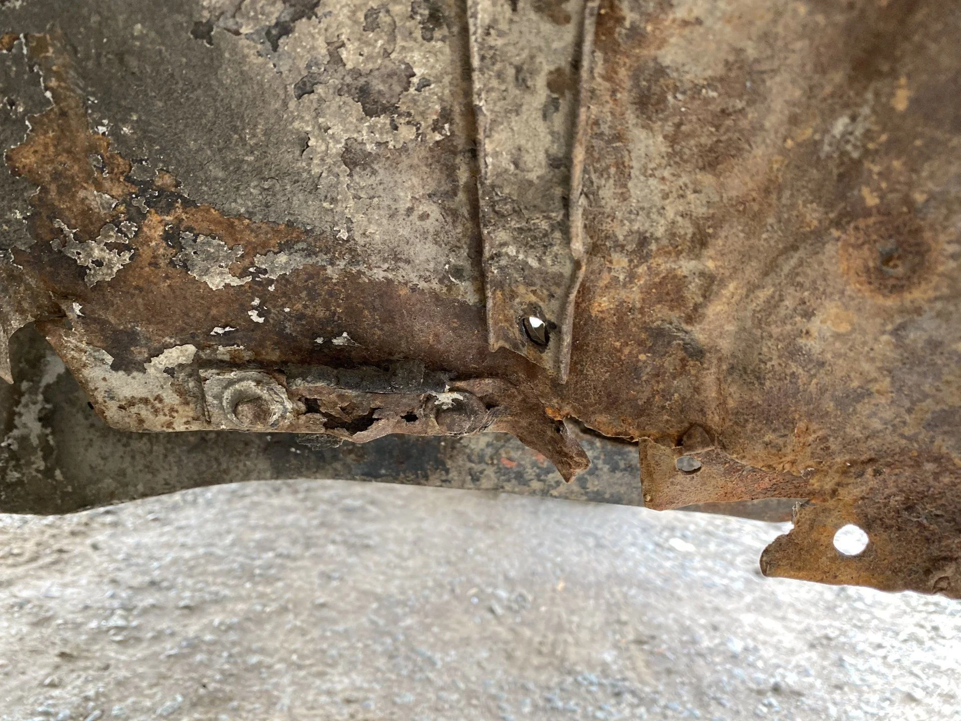

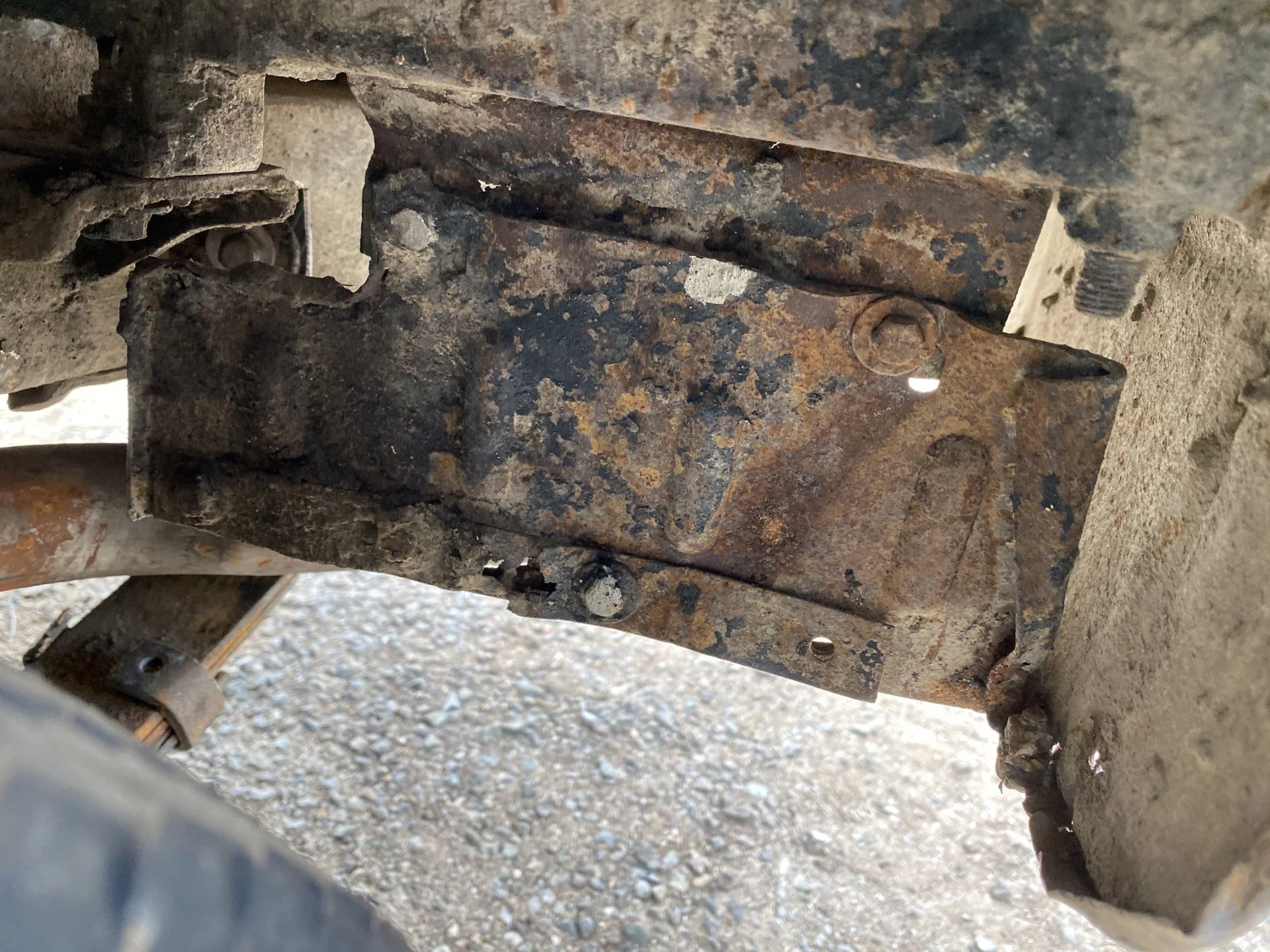

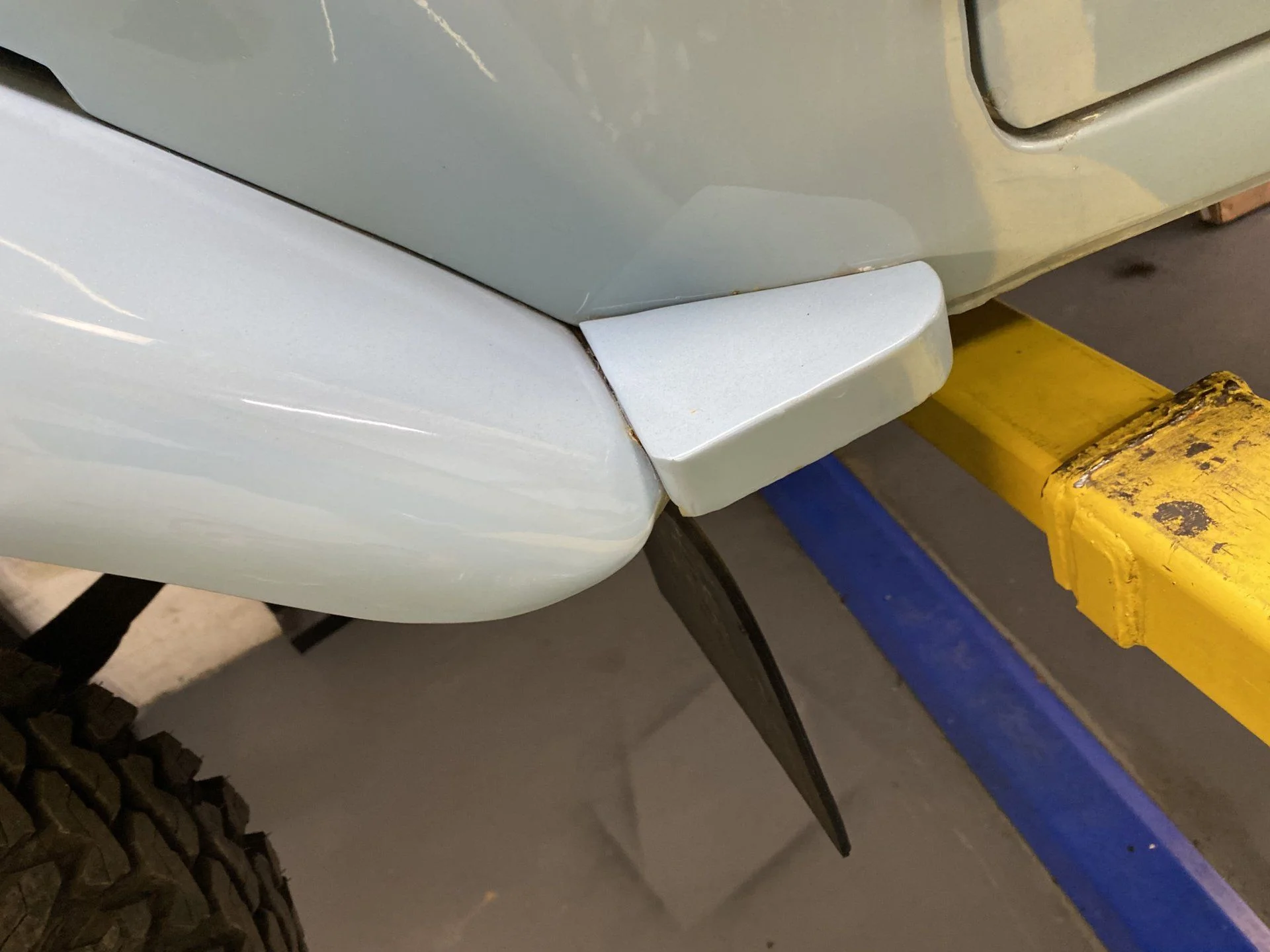

Alright, on to some pictures from today... first, this little step behind the front fenders is in REALLY bad shape. It looks like it's the same as the LV's though, so worst-case I could pull one off the LV and we can make some more if nobody has any. I remember all my 40s had much bigger/longer front steps, but the earliest 40 I ever owned was a 72 so maybe this part is available, maybe not? Please chime in...

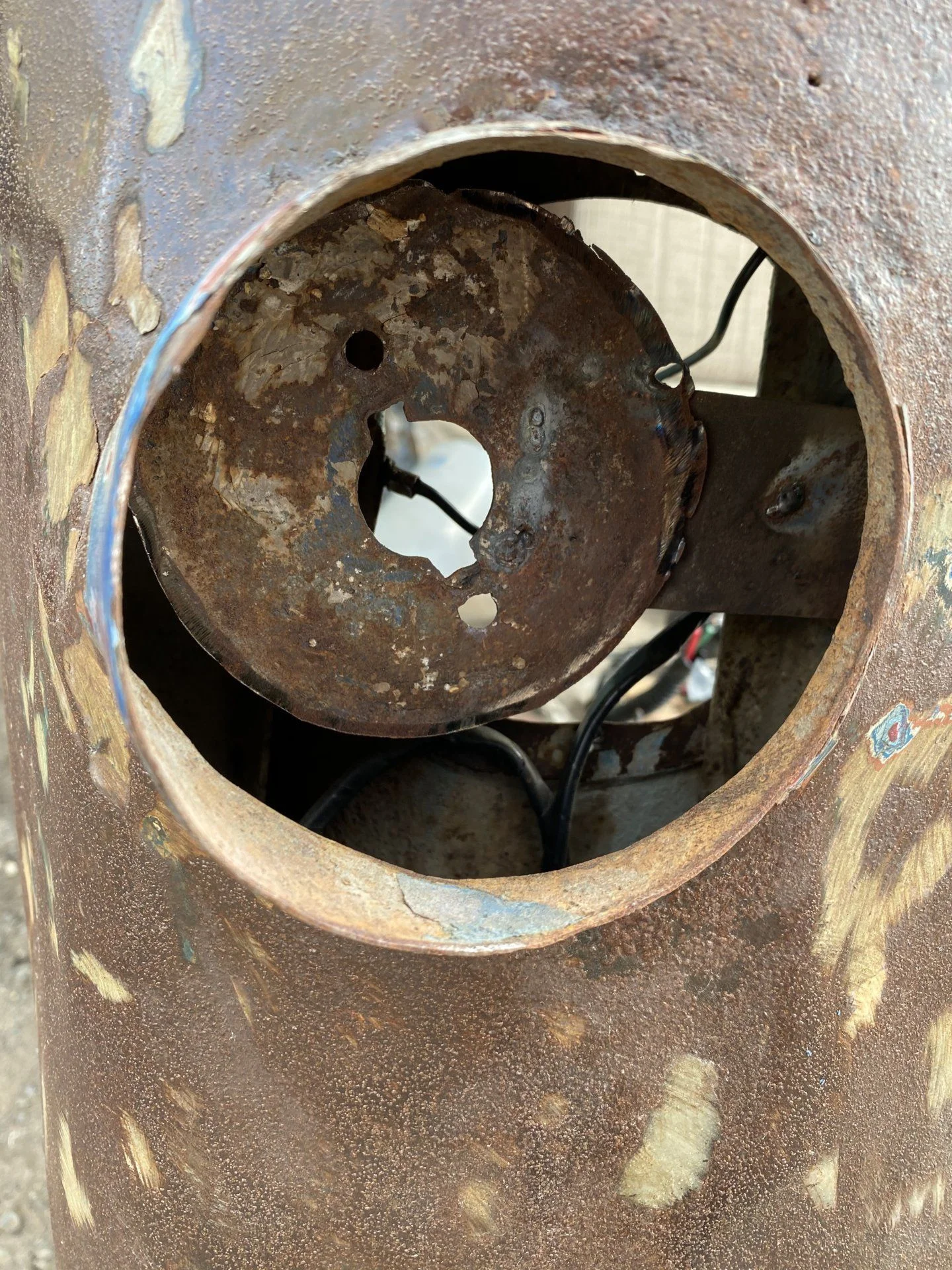

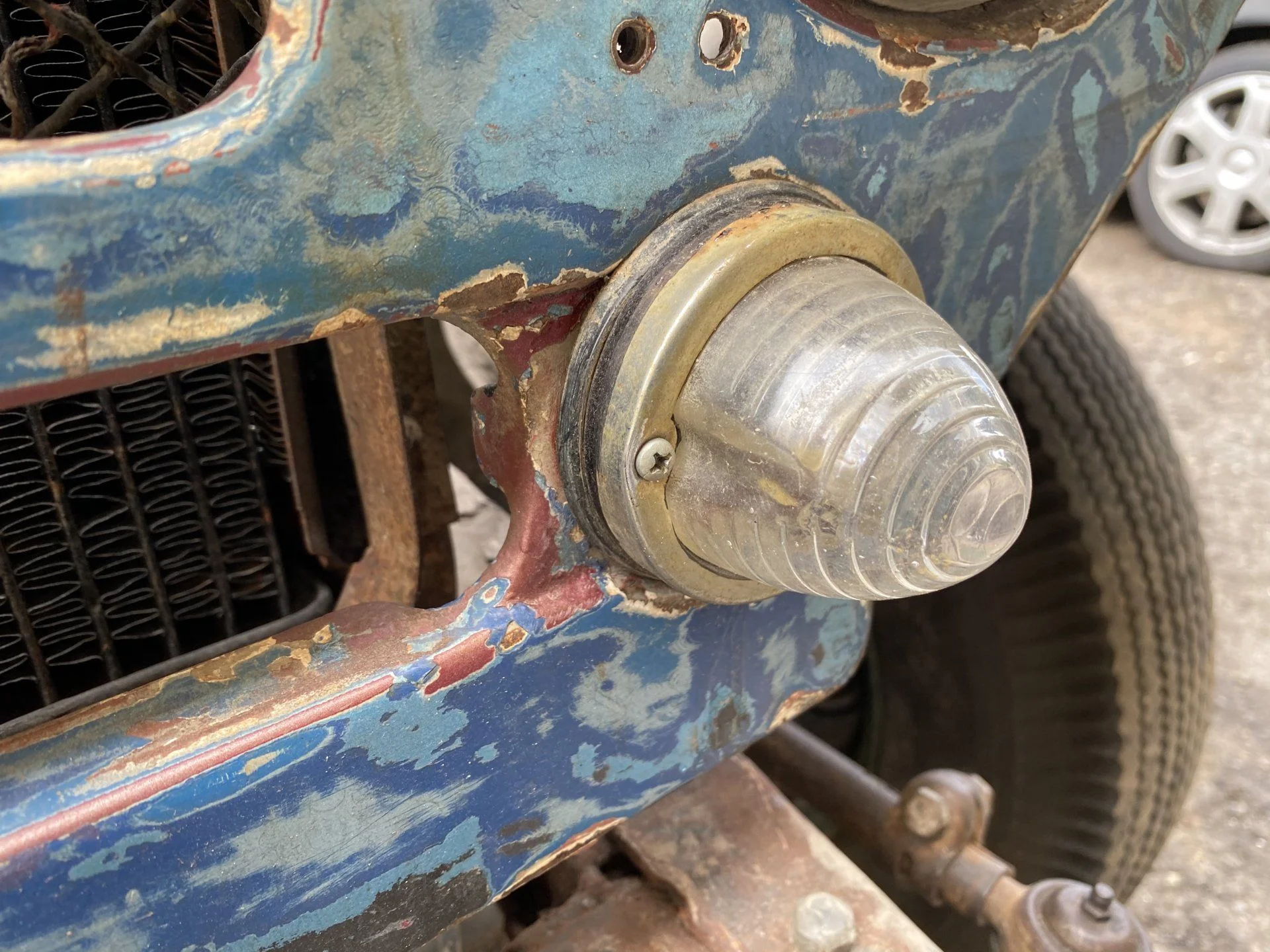

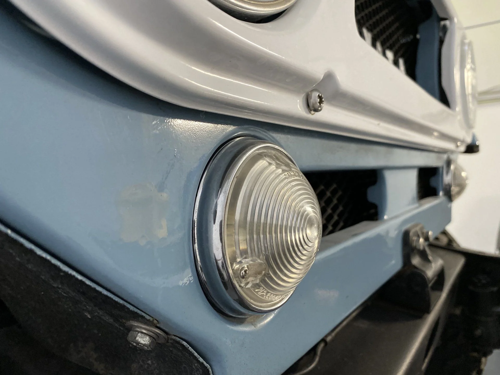

Front marker lights, the ones on the LV are definitely different and are the marker lights that you can still buy new from Toyota. The ones on Lara are a lot pointier and look narrower as well. Are these original to 20-series? If they are, at least the lenses appear to be good but the bezel I'll have to find for one of them. If they're not original, I think I can use the same ones that are in the LV. By the way, I feel like a bad dad - I have a name for Lara but not my LV. I guess I better name that one too. Original owner was geology professors down at U of A from 1966 to 2010, so maybe Geo? Rocky? Anyway, marker light photos

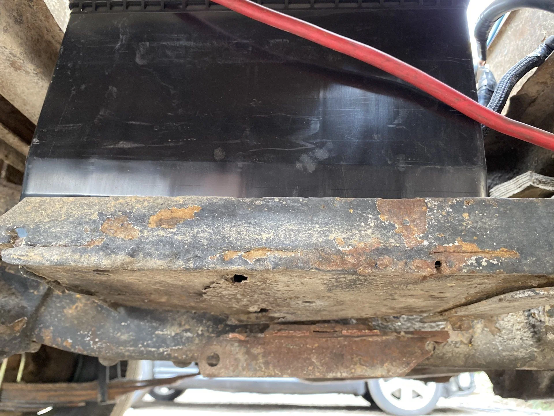

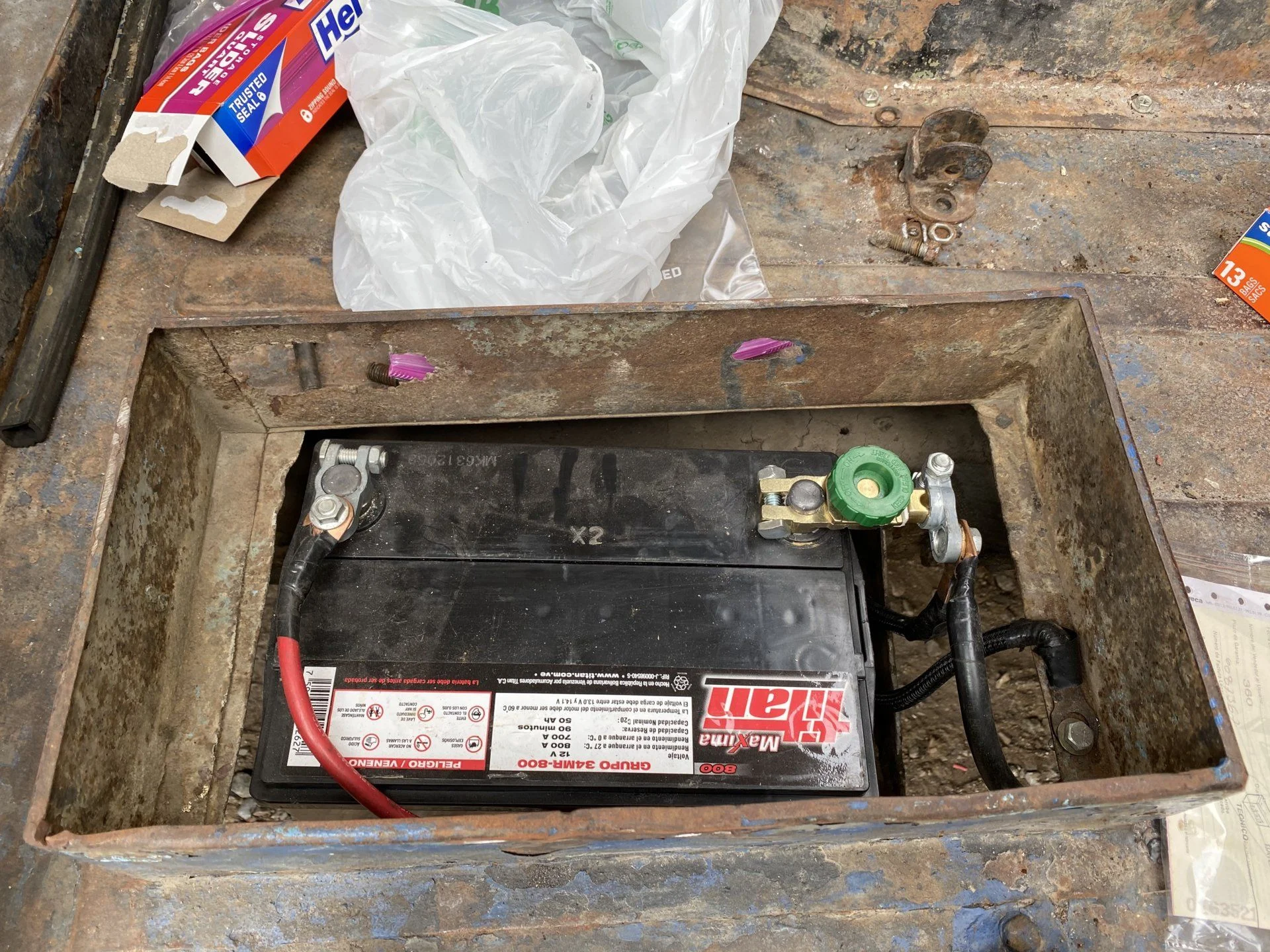

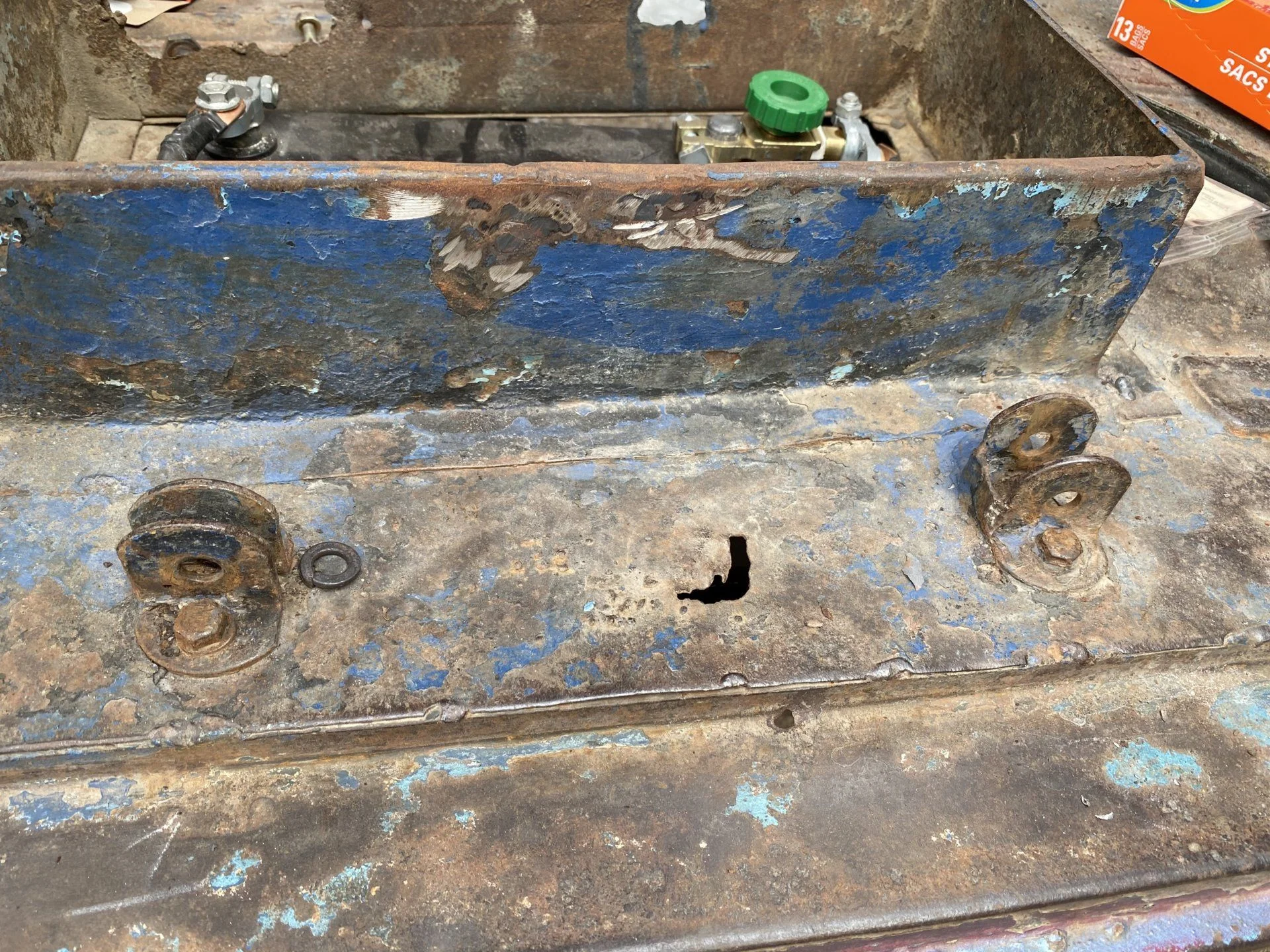

Photos of the battery tray, I don't know why but I think this thing is really cool - probably since every other FJ I've owned had it in the engine bay I guess. It's in rough shape but shouldn't be too difficult to restore as it's a pretty basic construction. the battery tray itself isn't too bad, and the lid is in good shape, but the lip in the floor needs work.

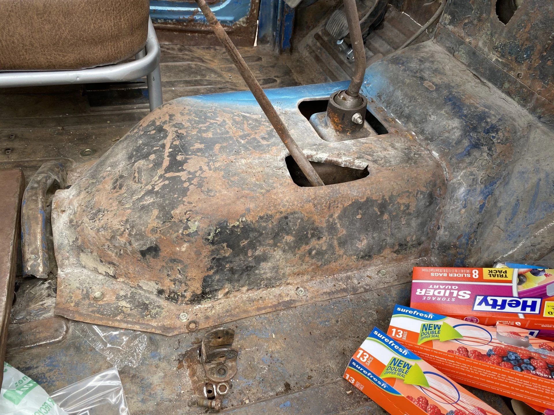

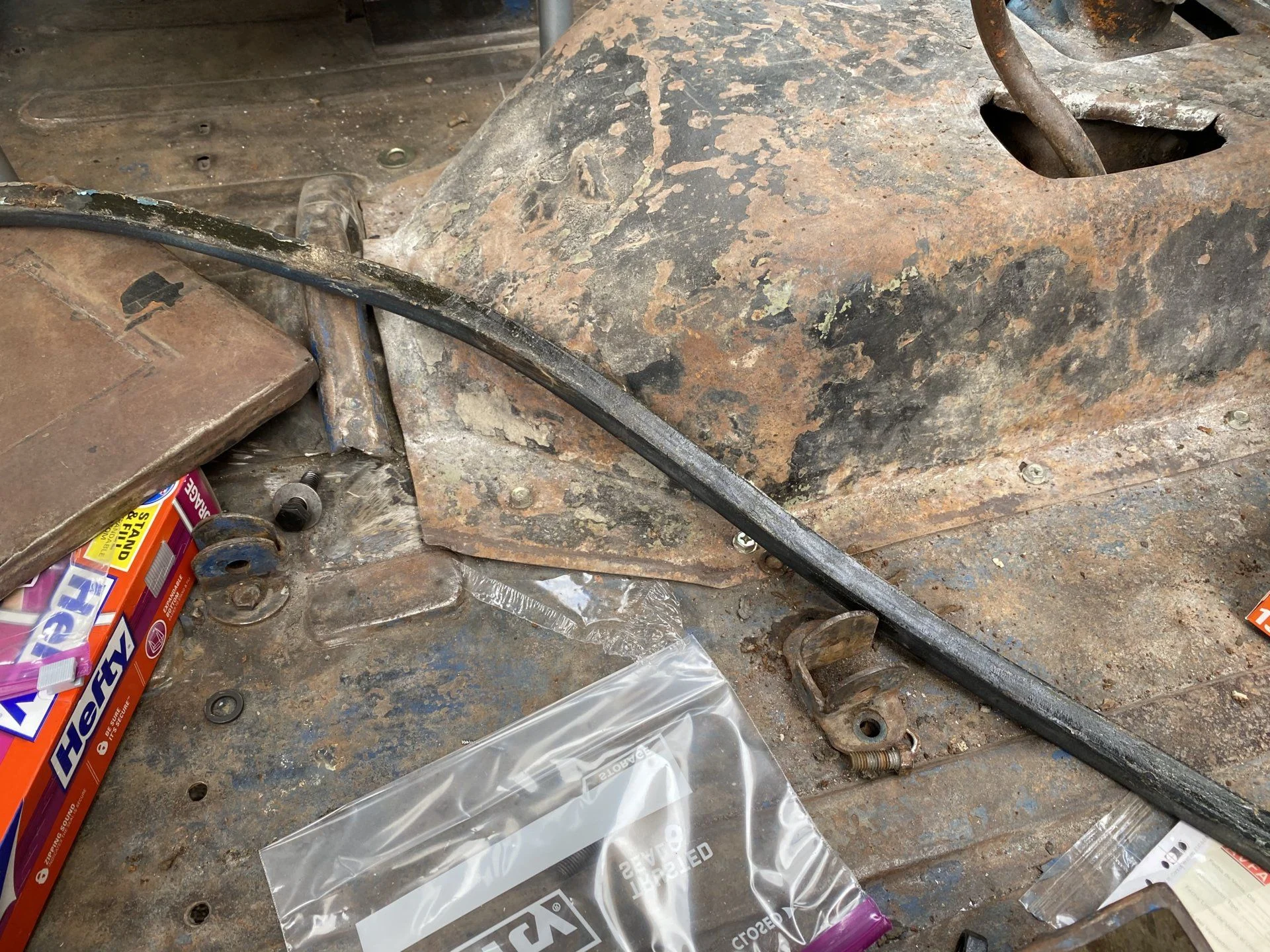

Can anyone confirm that this transmission hump is not original? Doesn't look it to me at all but before we do anything to it would like to know for sure. I'm anxious to get the transmission itself out of there and a better look at it. The shifter has been modified obviously but hopefully that can be remedied. If you look closely at some of these photos up front it looks like we have the original seat mounts in there actually. I'm torn about this news, on one hand cool to have them on the other hand certainly different from the LV seat mounts. Does it maybe look anything like the mounts for an FJ25?

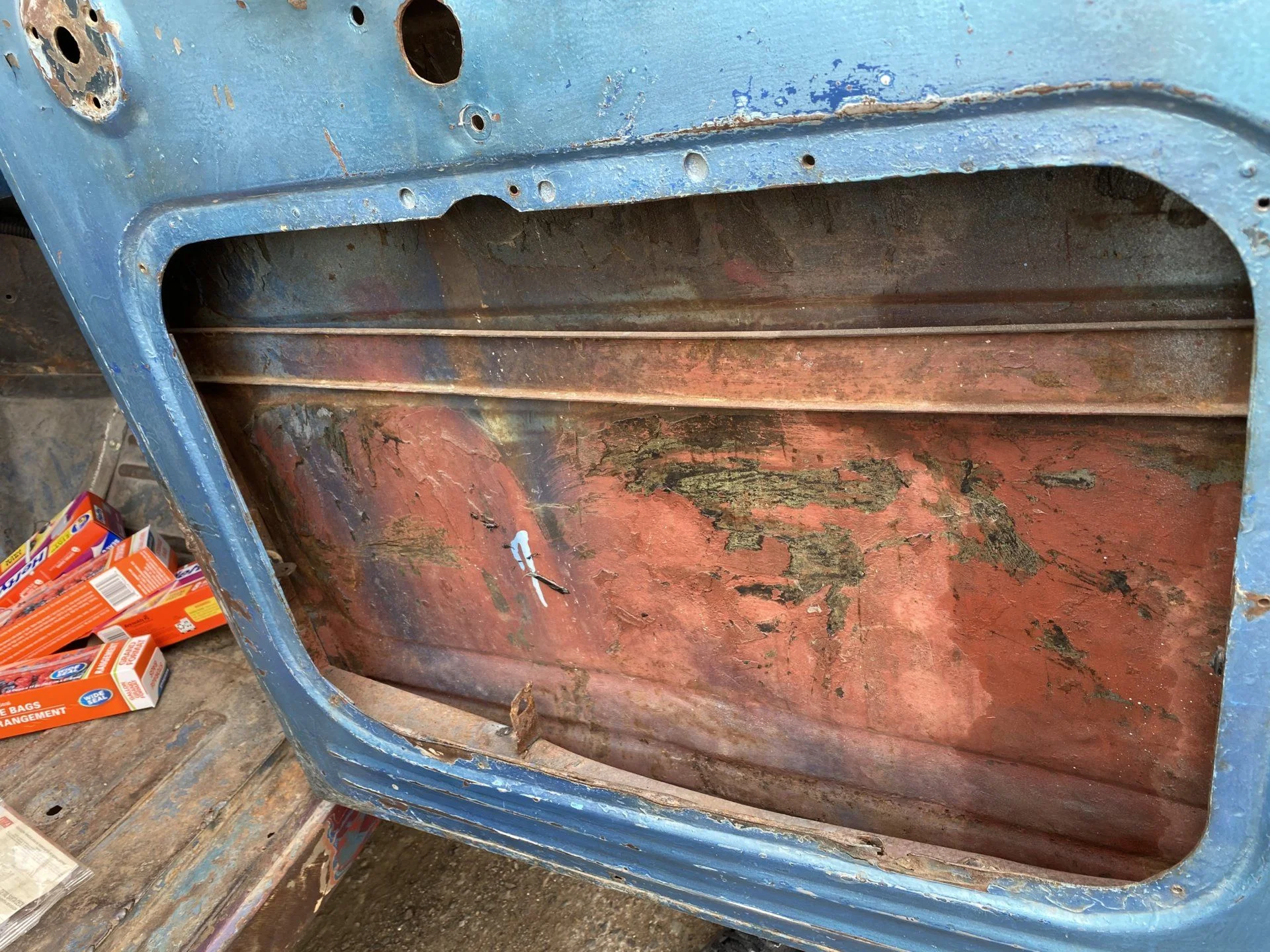

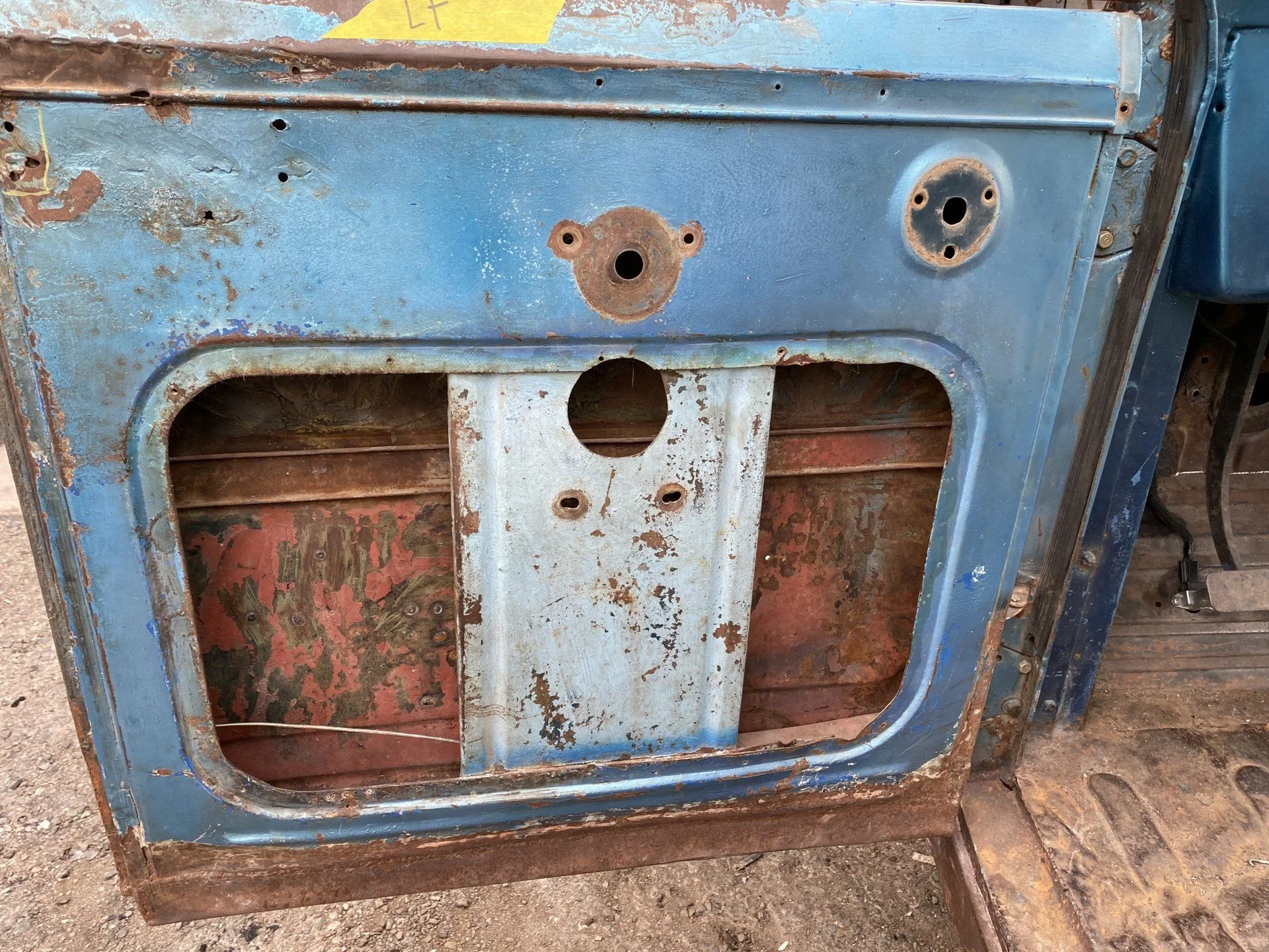

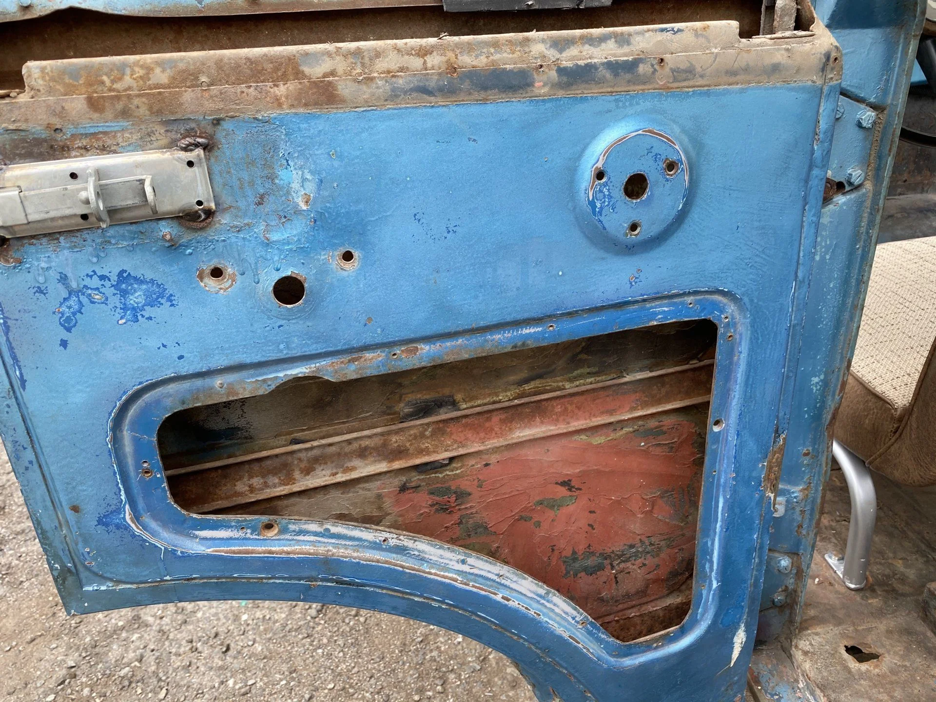

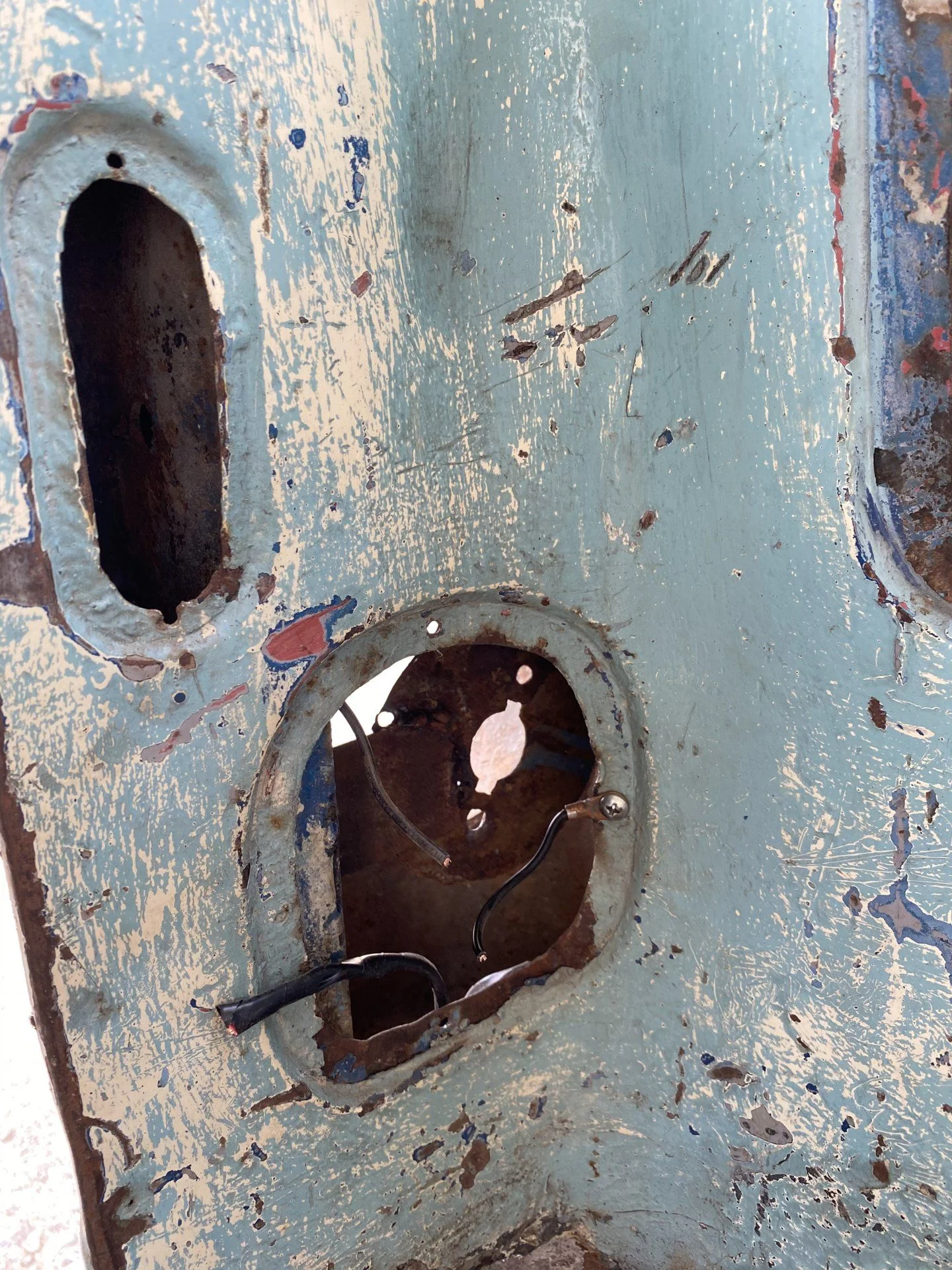

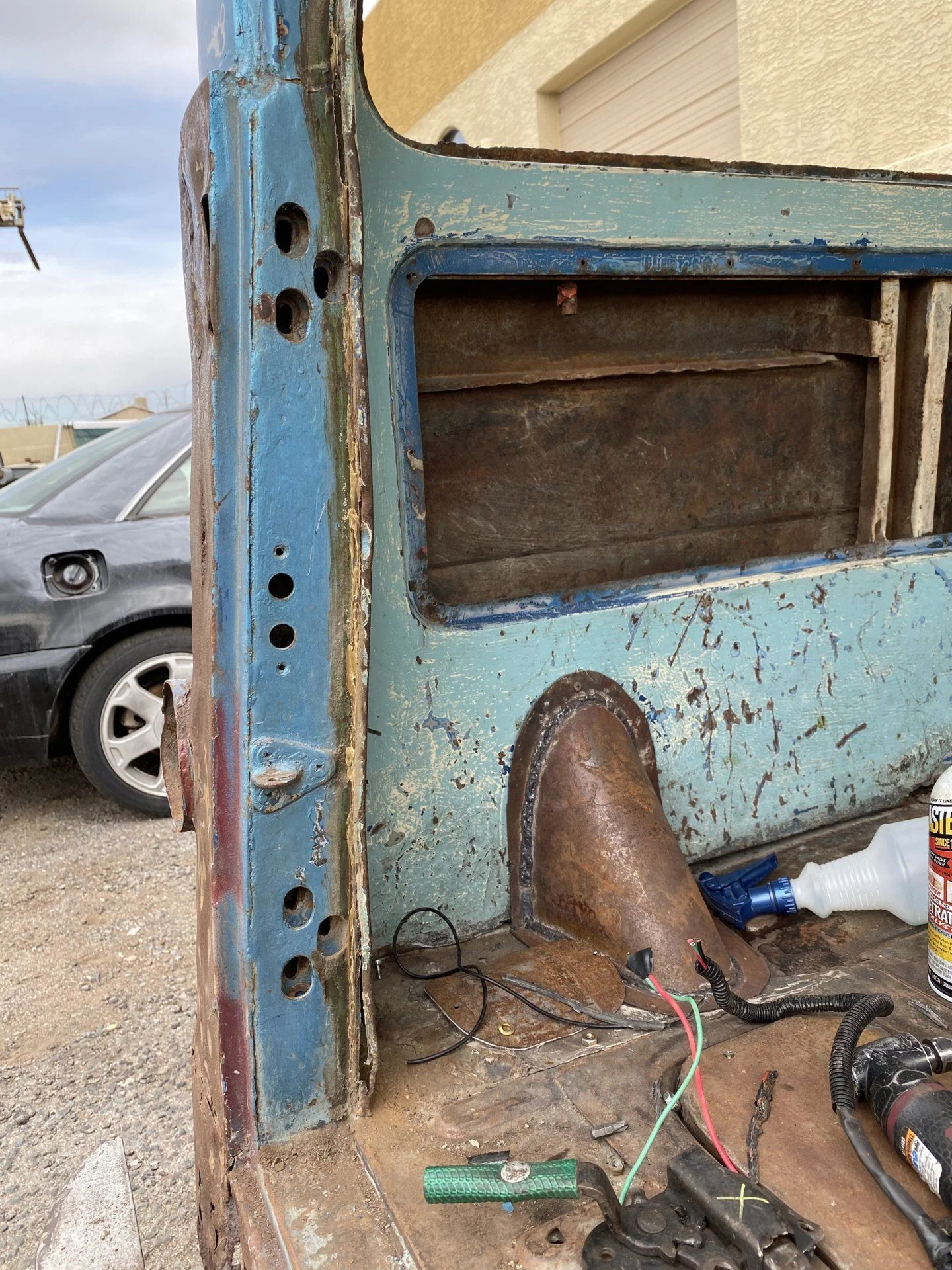

On to the doors - and its as I feared, we basically have nothing inside of these doors outside of a couple of coat hangers. We have one door handle on the inside that doesn't really look like the LV's at all and I don't believe is original. So basically 0 door mechanisms. So if anybody has some, that would be a huge help. We have a guy that can make parts with casting, so might be able to piece some things together using the LV as a template. Also some of the support brackets inside the doors have been cut out and will need to be remade.

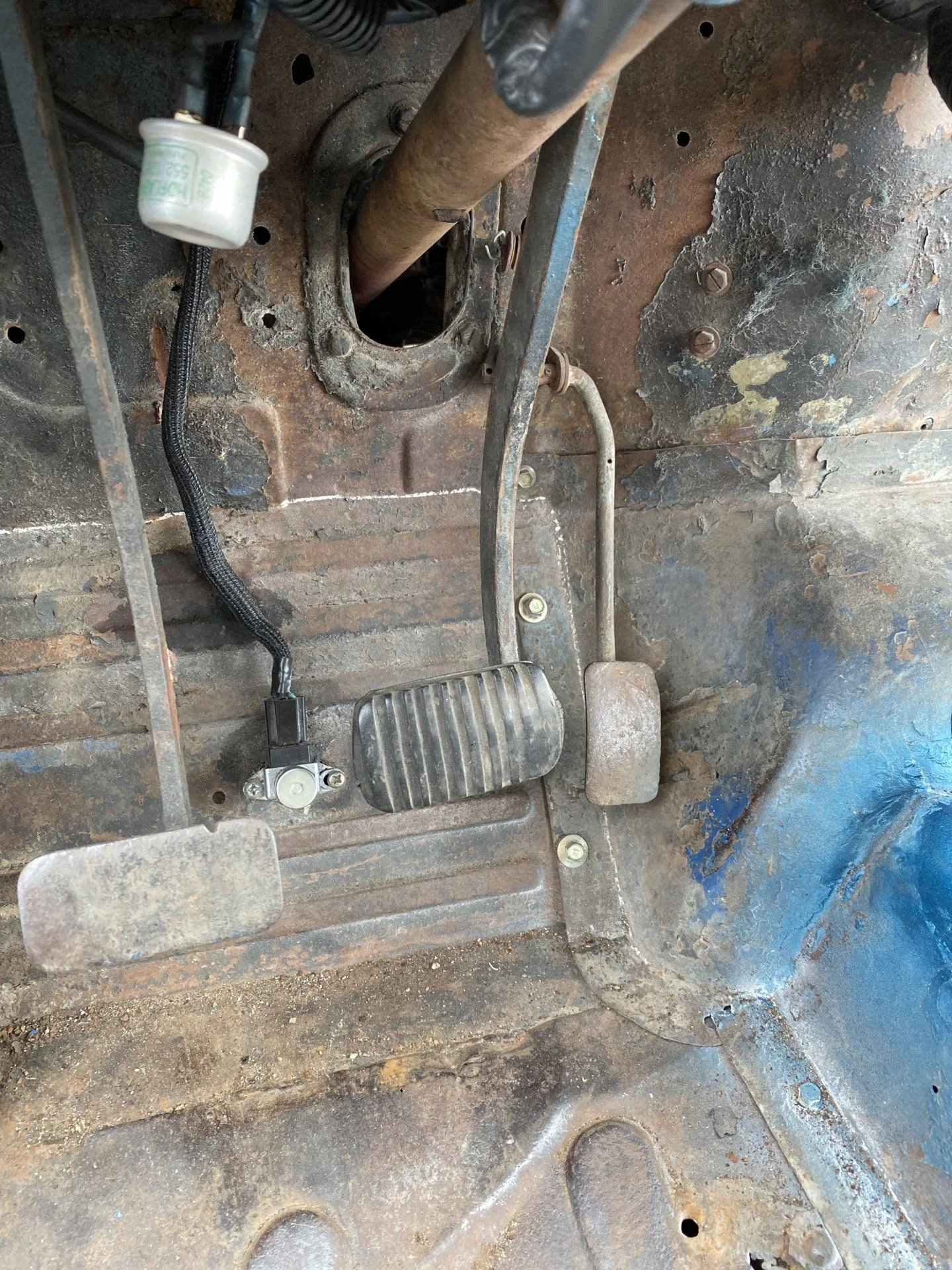

Haven't taken any of this apart to look closely but will be interested to hear if any of the pedal assemblies are original. Certainly that floor dimmer switch is not.

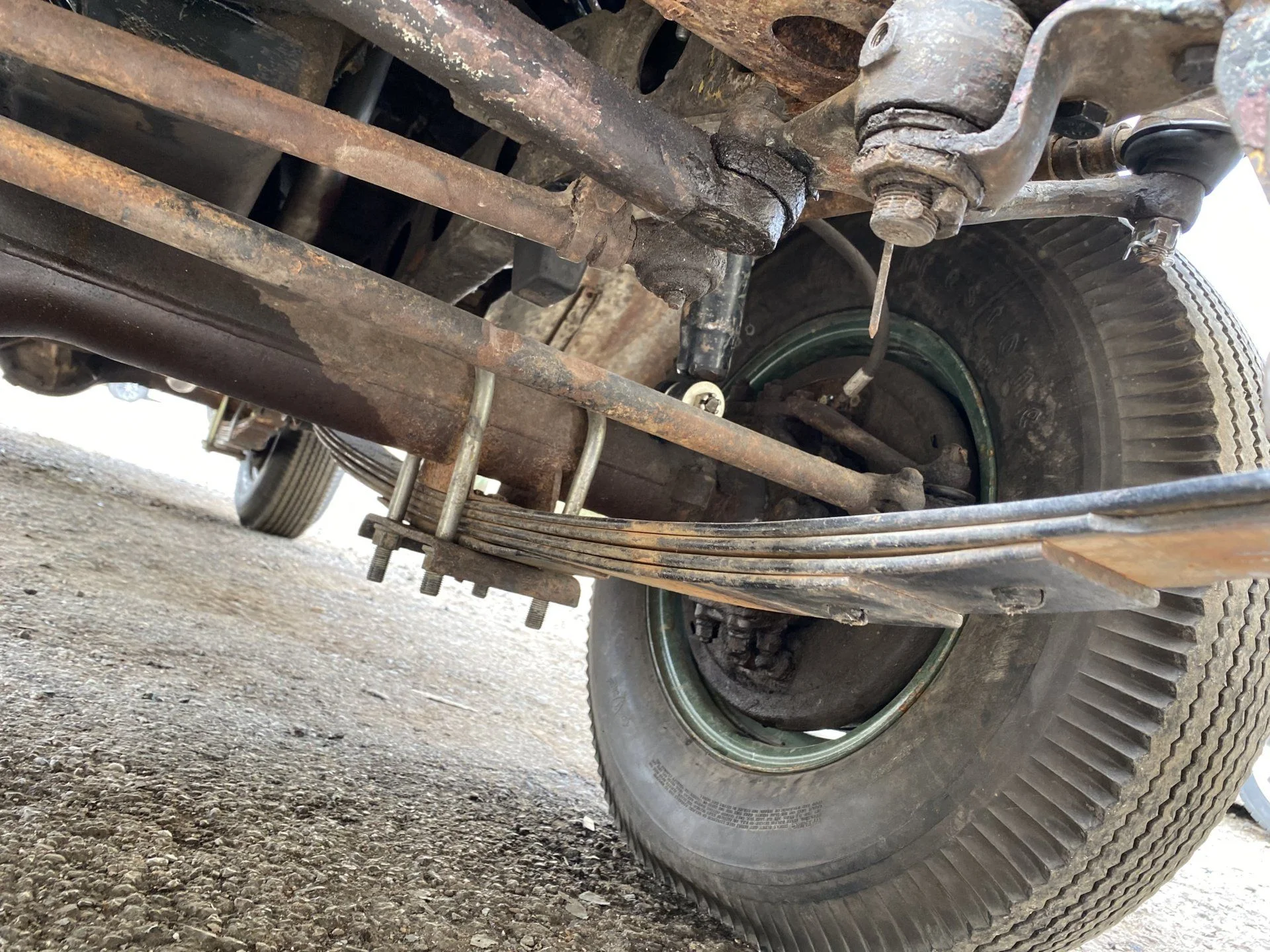

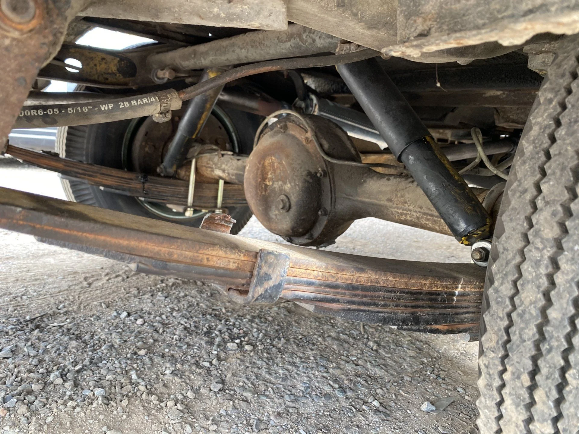

I hesitate to ask a question like this because I think I know the answer ;) What's everyone think about the suspension - acceptable to replace with new or make the original work? My inclination is to clean up the original setup, but I've seen some very very well done restorations where all of the suspension is new and it didn't seem to bother anyone for "originality".

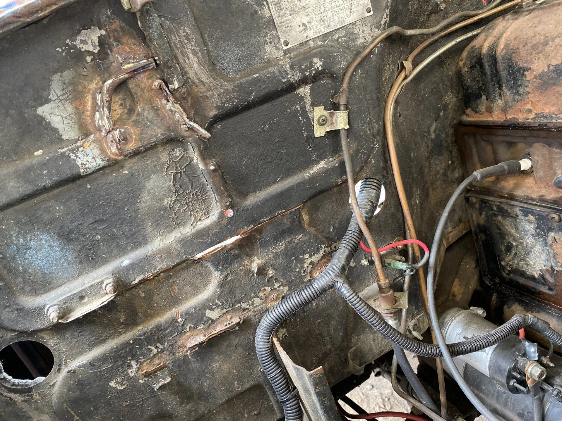

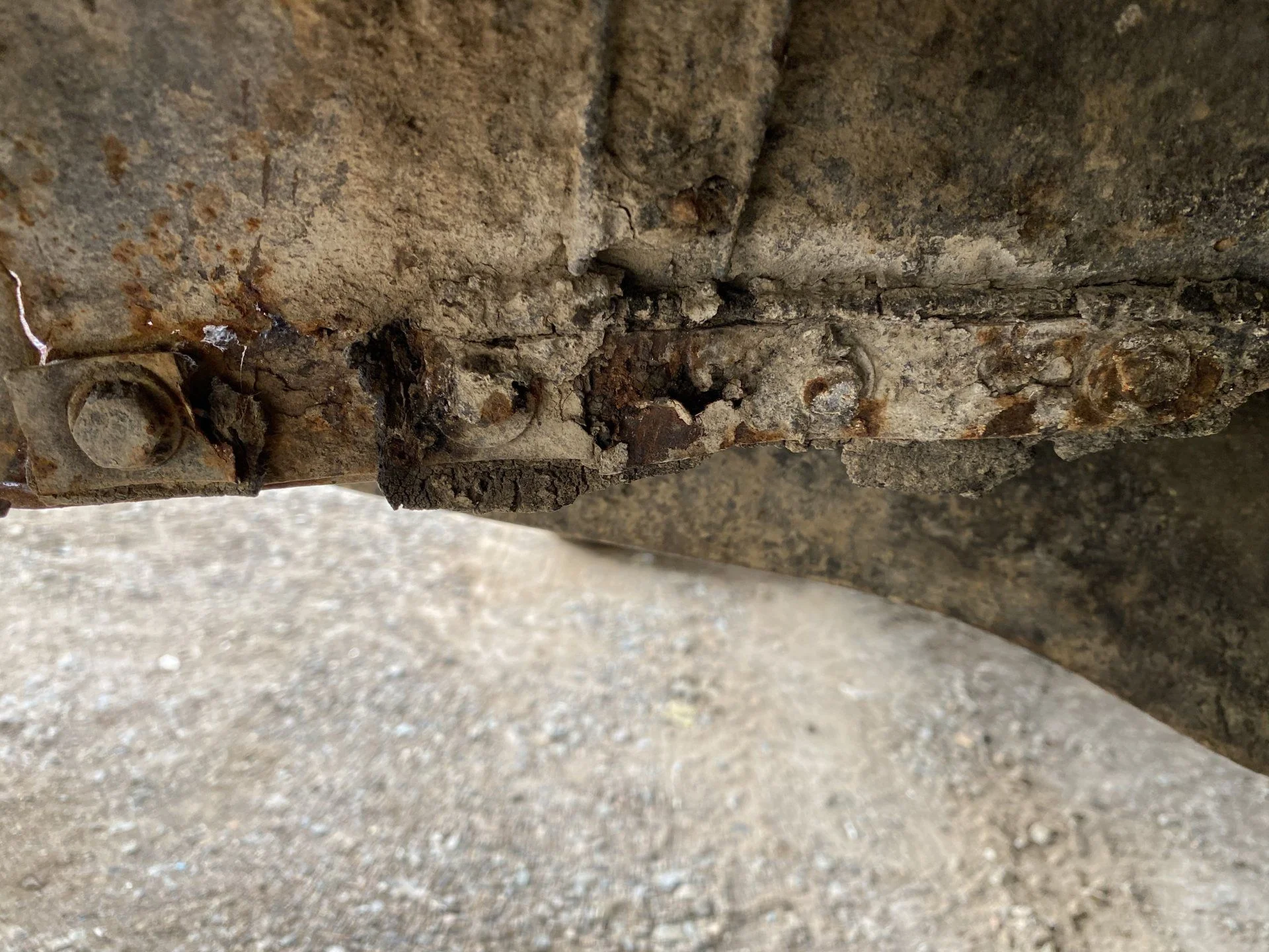

3rd picture is on the engine bay firewall passenger side - any idea what used to be mounted here? Someone welded something on aftermarket at some point but that one bracket lower on the left looks original.

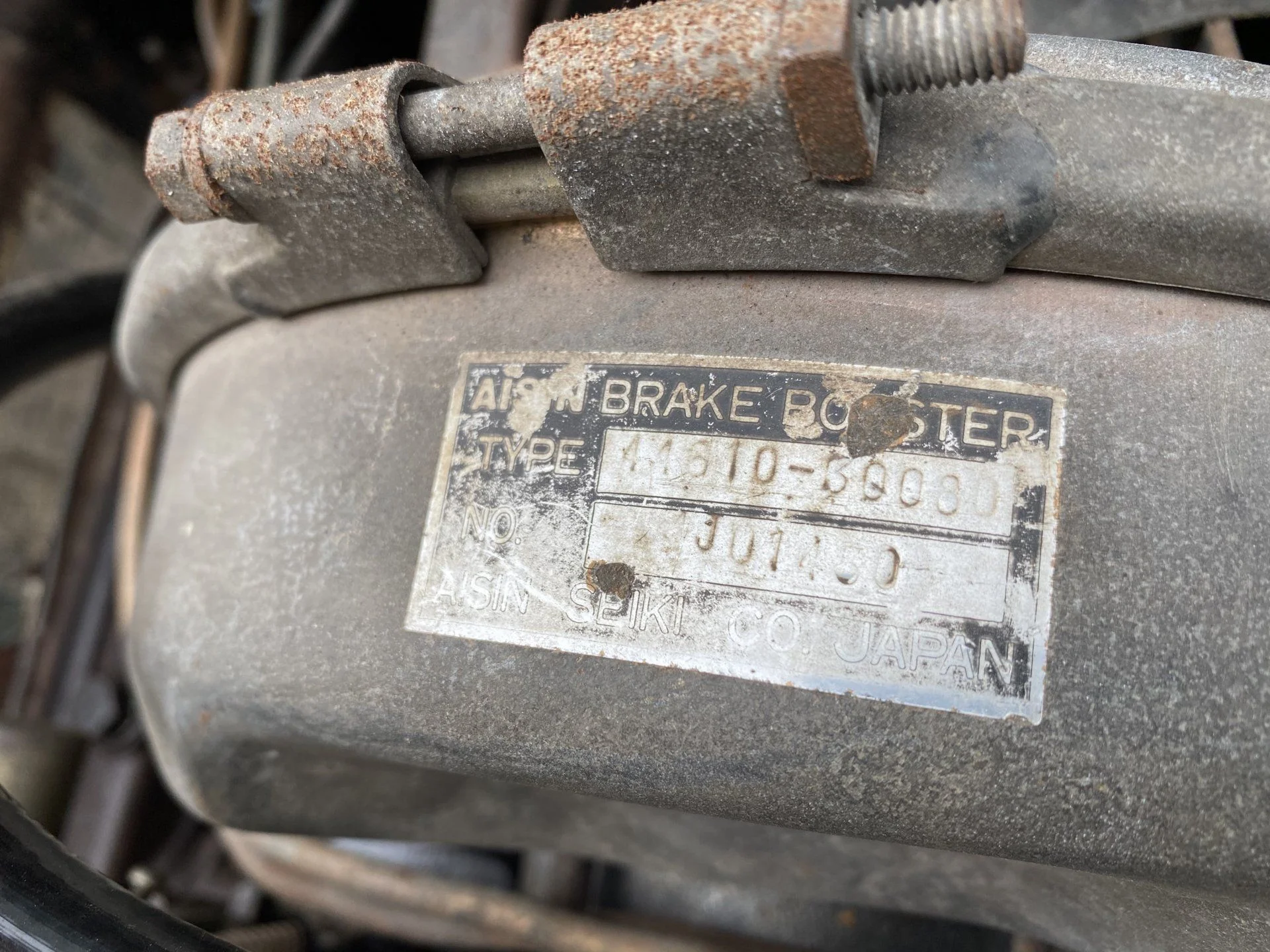

4th picture of the brake booster, any idea what year this came out of? Couldn't find anything on the web about this PN. I see city racer has new OEM ones, still haven't decided what we're going to do with the brake system yet.

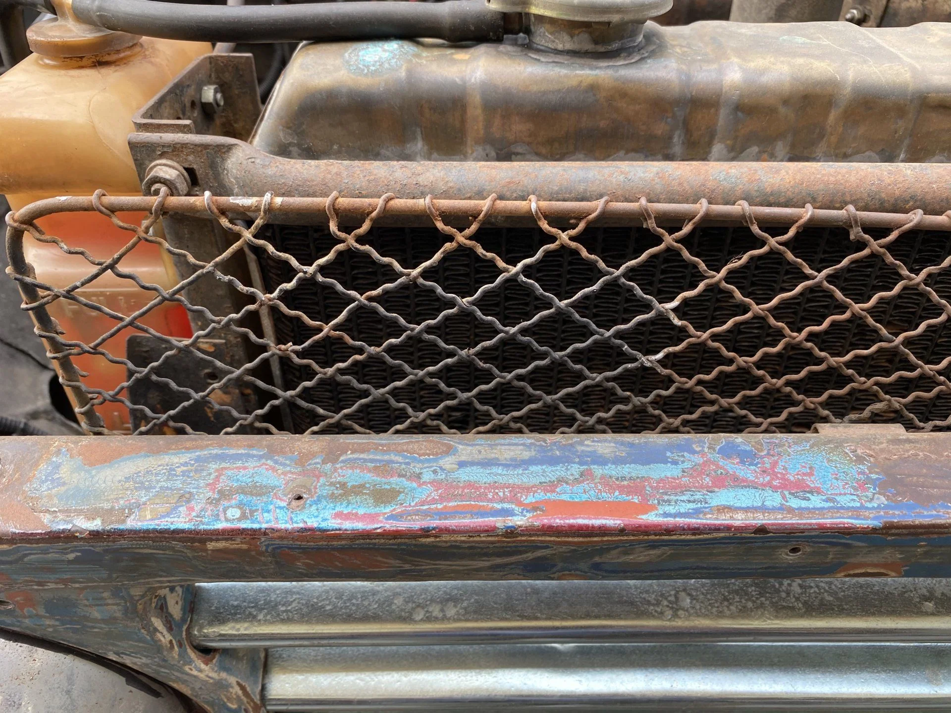

5th picture is of the existing grill, is this original? Its mounted too high, but hoping this is a keeper piece.

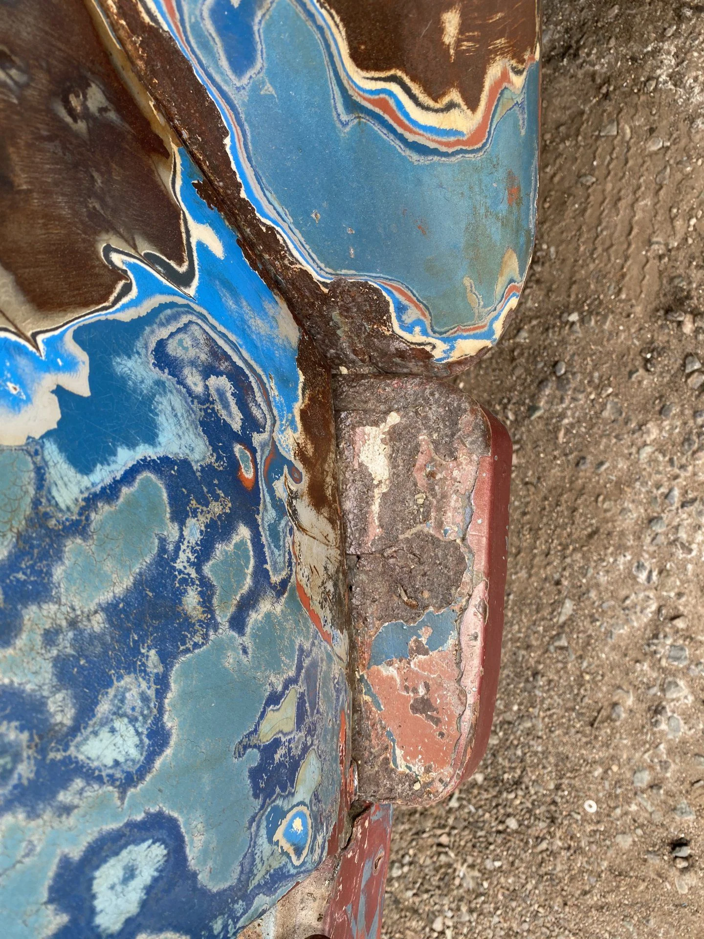

Alright last set of pictures for the day - anyone please let me know if I'm getting into the minutiae too much here and over-posting, but you all certainly know more about 20 series than I do. I just though this was really cool - the original mud flap brackets seem to actually be there! The night I won this auction I bought a set of the "almost Gifu" mudflaps from that eBay guy in Indonesia (maybe someone here knows him) that I used on the LV that looked great. These look to be beyond saving, but pretty cool anyway and should help us make sure we get the new ones correct.
those look aftermarket. look to see if there is a manufacturer mark anywhere
