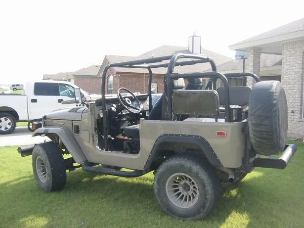

I'm thinking about selling the cage I currently have (see pic) on ebay or here to offset the material costs for building a family cage. It's a nice cage and would work nicely for someone without 3 kids. I'd rather not build onto it, rather just build a whole new one. I'm not talking anything too extravagant. Trying to figure, if it sold for $100-$200 or so (hopefully more) how close that would bring me to the material cost for the new one.

Is yours the stock (OEM) rollbar with an added front loop and connecting pieces, do you know? It looks like the OEM joints where the rear truss pieces connect to the b pillar loop behind the seat.
Um... yeah, I do know... and right you are :D . It sure is the OEM bar with a front hoop added and cross bars attatched. It has nice OEM pads at the knees and over head too ;) .
