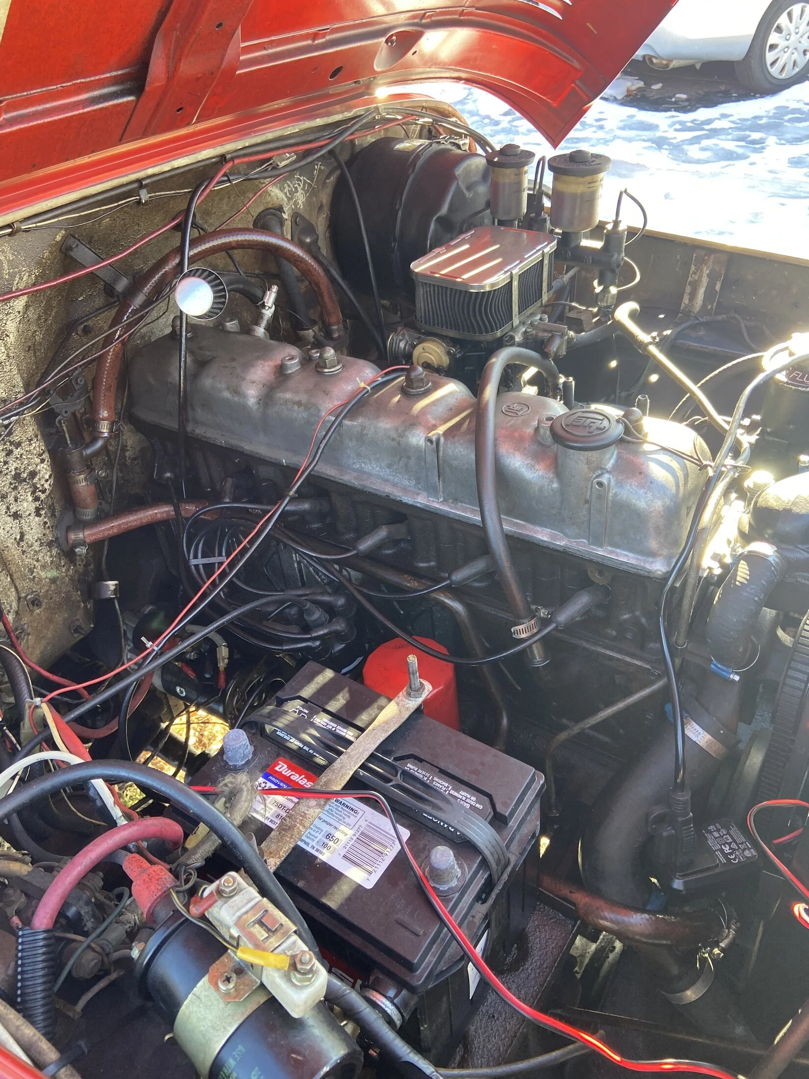

1974 could have an F1/2, pics would tell what it is

I’ll post pictures and any info I can find out tomorrow. Hopefully it will help out me getting mods info from the Mud Professors :)

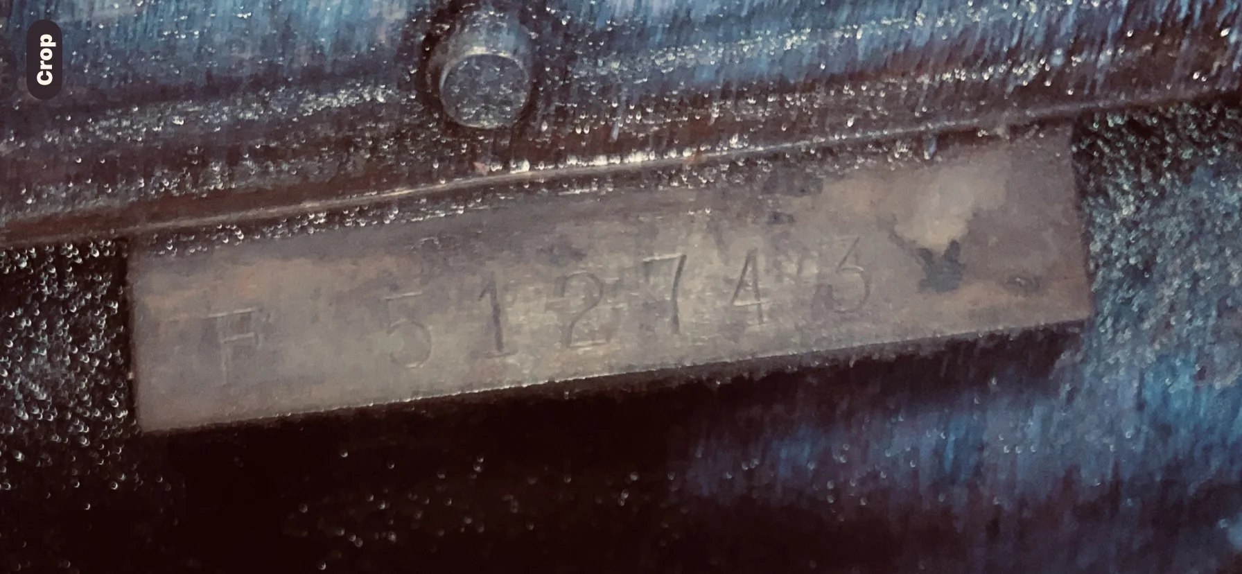

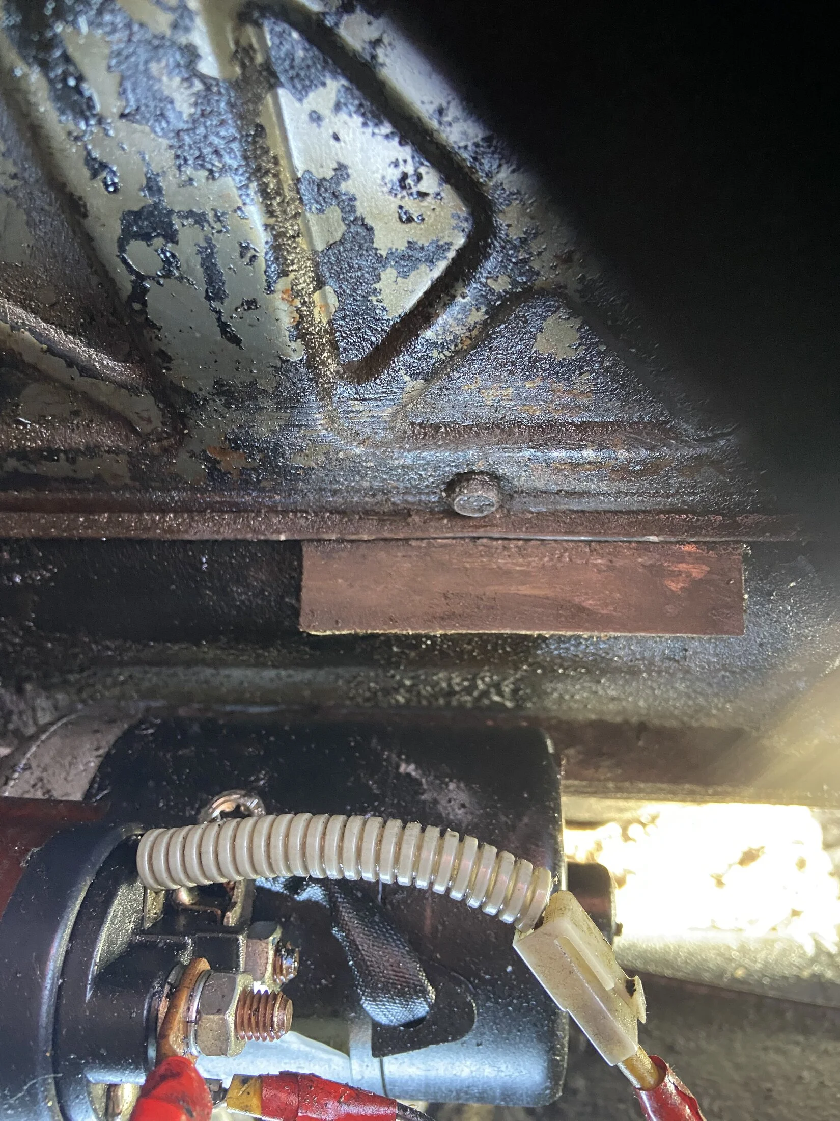

the engine is atleast an F1/2 or 2F, definitely not an F
with no #'s stamped on the block, not sure how else to tell exactly
Sorry but I’m not very sophisticated…what would F1/2 end up meaning?

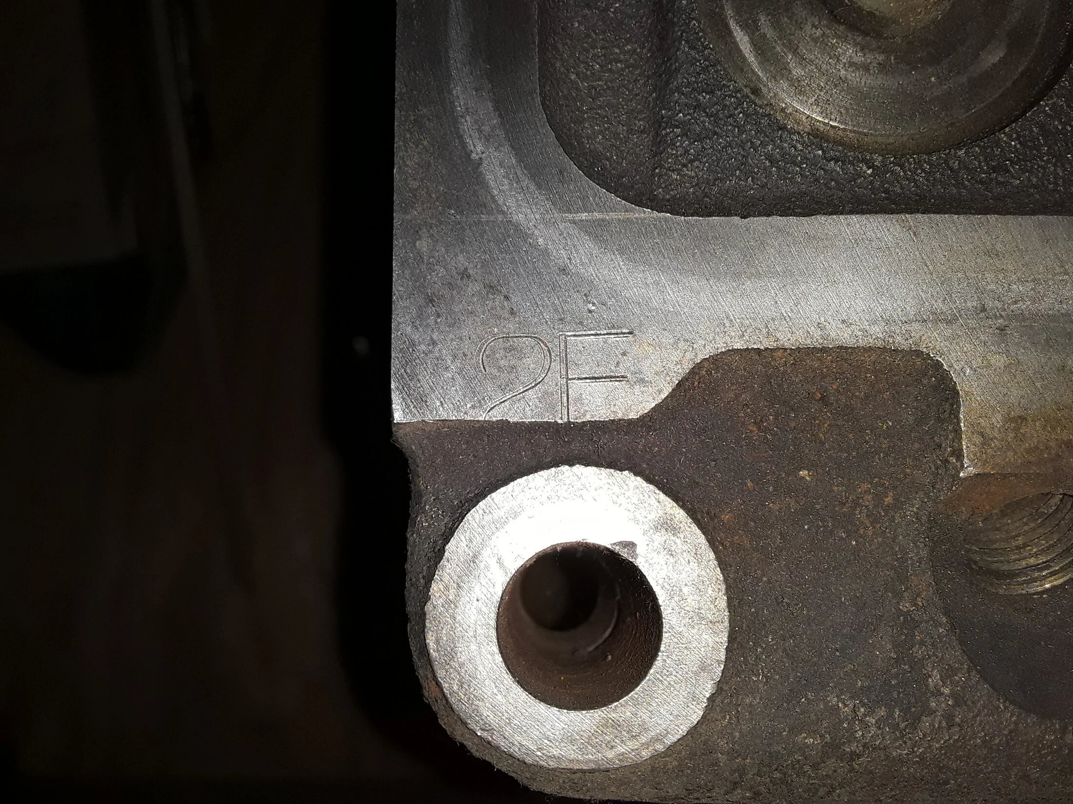

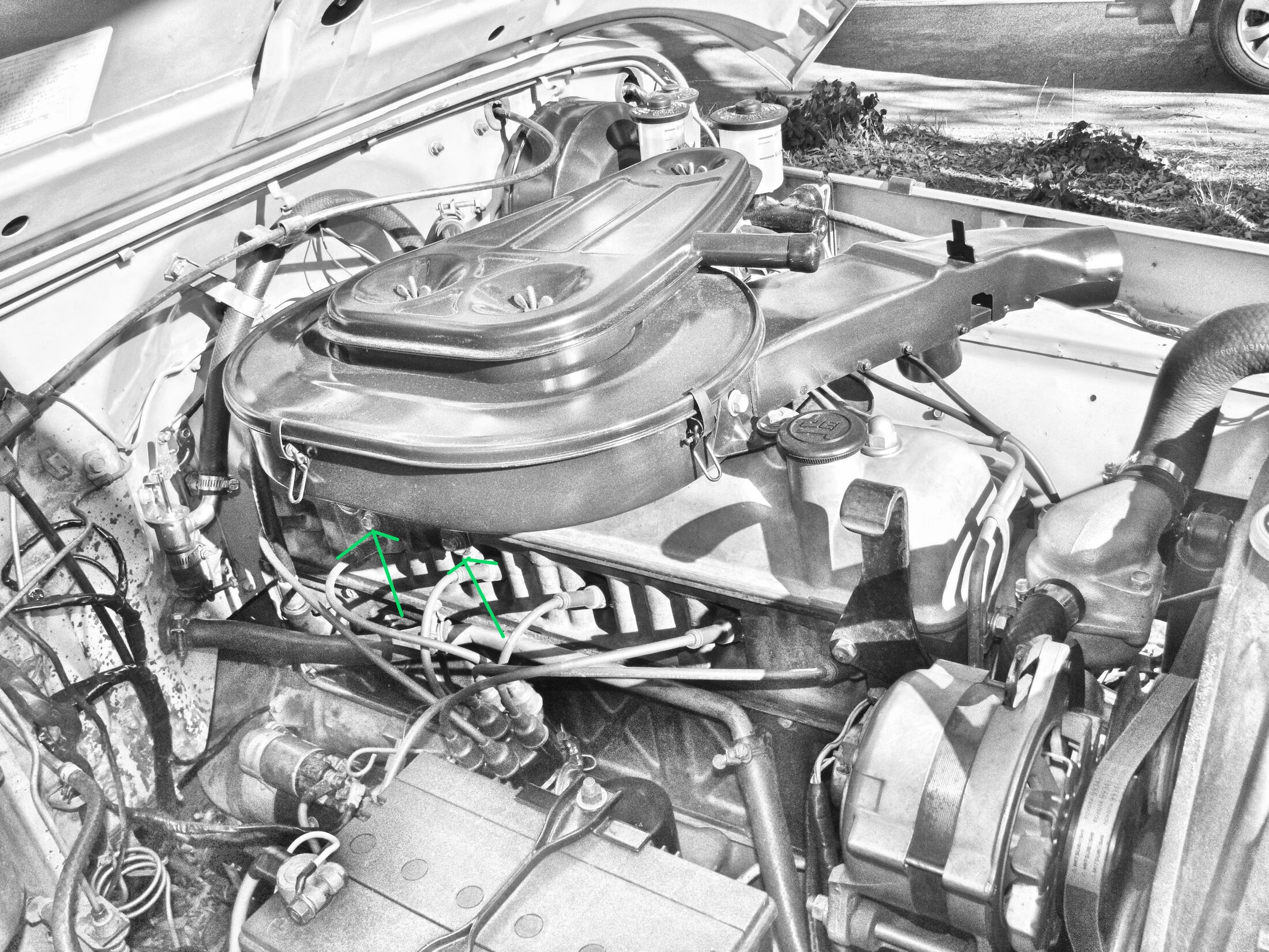

My '75 2F heads are stamped 2F. It is on the front by the thermostat, top, driver's side of the valve cover. Just barely not under the valve cover gasket. It is kinda faint.
Alternatively, someone can decode the part number on the air rail side of the casting.
I don't know if they did this in '74? Maybe it is stamped by the headbolt, next to the smog air rail inlet? Pic has valve cover removed. This is an '82, but, my Feb. '75 has it too, iirc.
Does your F.5 have bosses on the passenger side for alternator and air cleaner assembly?
Yup, I got that. Probably have those too.

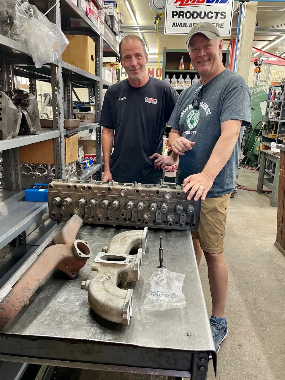

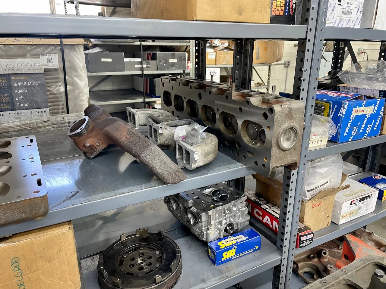

Just went through a blown head gasket. magflux checked, head cleaned, surfaced, replace one bent valve with custom milled 2f valve, hardened valve guides, valve seats, galley plugs, surfaced the intake and exhaust manifold $650 in Denver, Co. and additional $150 in misc gaskets, nuts, bolts, etc. My own slave labor plus $72 in beer.
