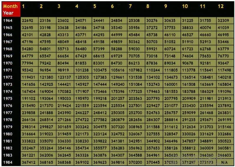

The engine number was F529312. Per the SOR website (old) that S/N engine was built between 9/73 and 5/74.

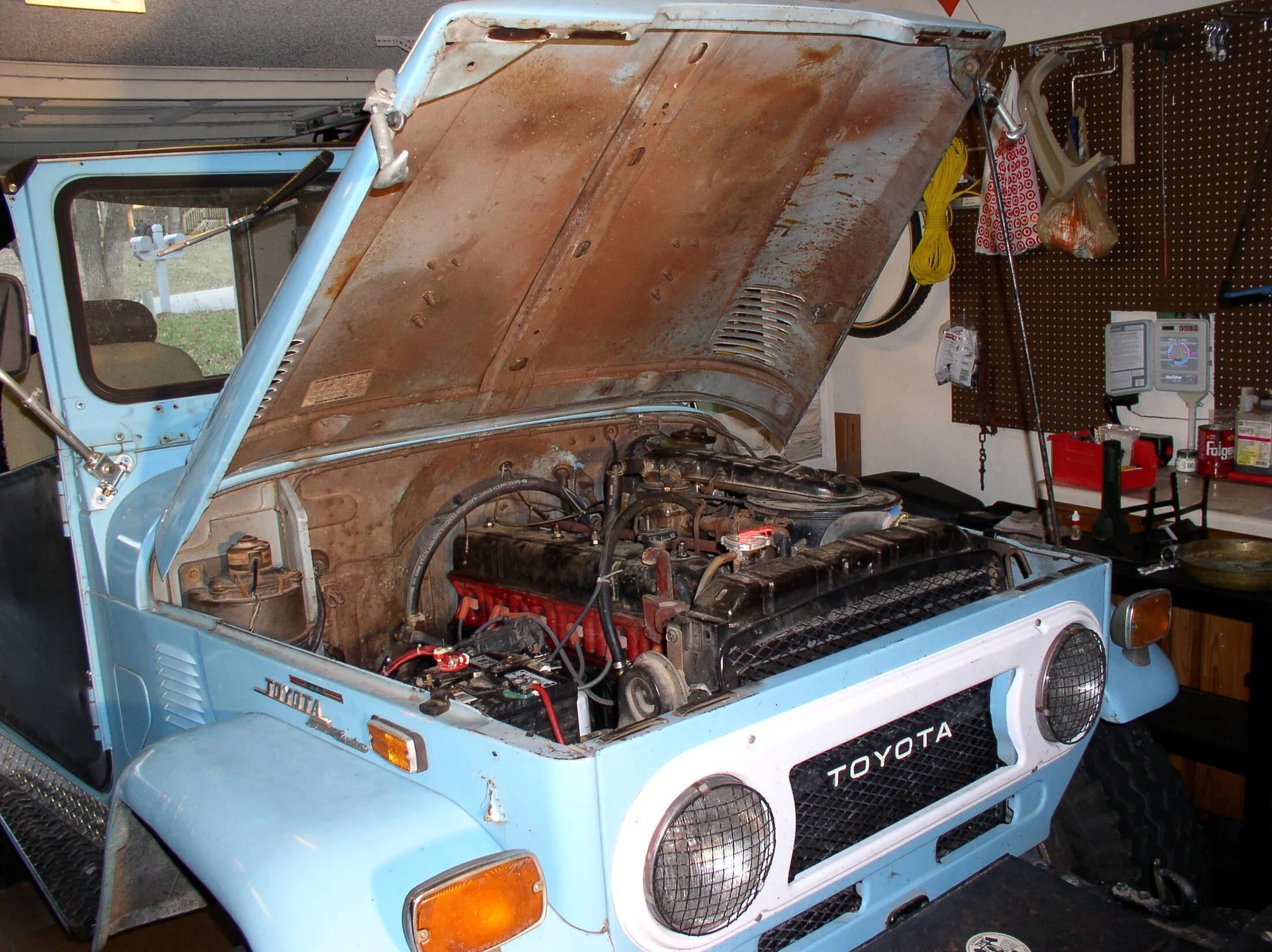

I think someone has been in your truck and change the cosmetic stuff, like the valve cover, and the air cleaner.
But my truck, which was built five months after yours had the stamped sheet metal valve cover, and the big, huge round air cleaner that hung down on the driver side of the engine (the air cleaner doesn't mount on top of the valve cover).
The air cleaner you have sure looks to me like it’s from a much later generation truck, and everybody changes the stamped valve cover for a cast one because they seal better (and look more modern!)…
Here's a picture or two…
(You can just make out the valve cover and air cleaner... Can't find any better pictures... This photo was back in 1998, when we had to use those daguerreotype cameras!).

Oct 73 build date and Vin is a late '73 #. Should be an F engine with 3 on the tree if not altered.
