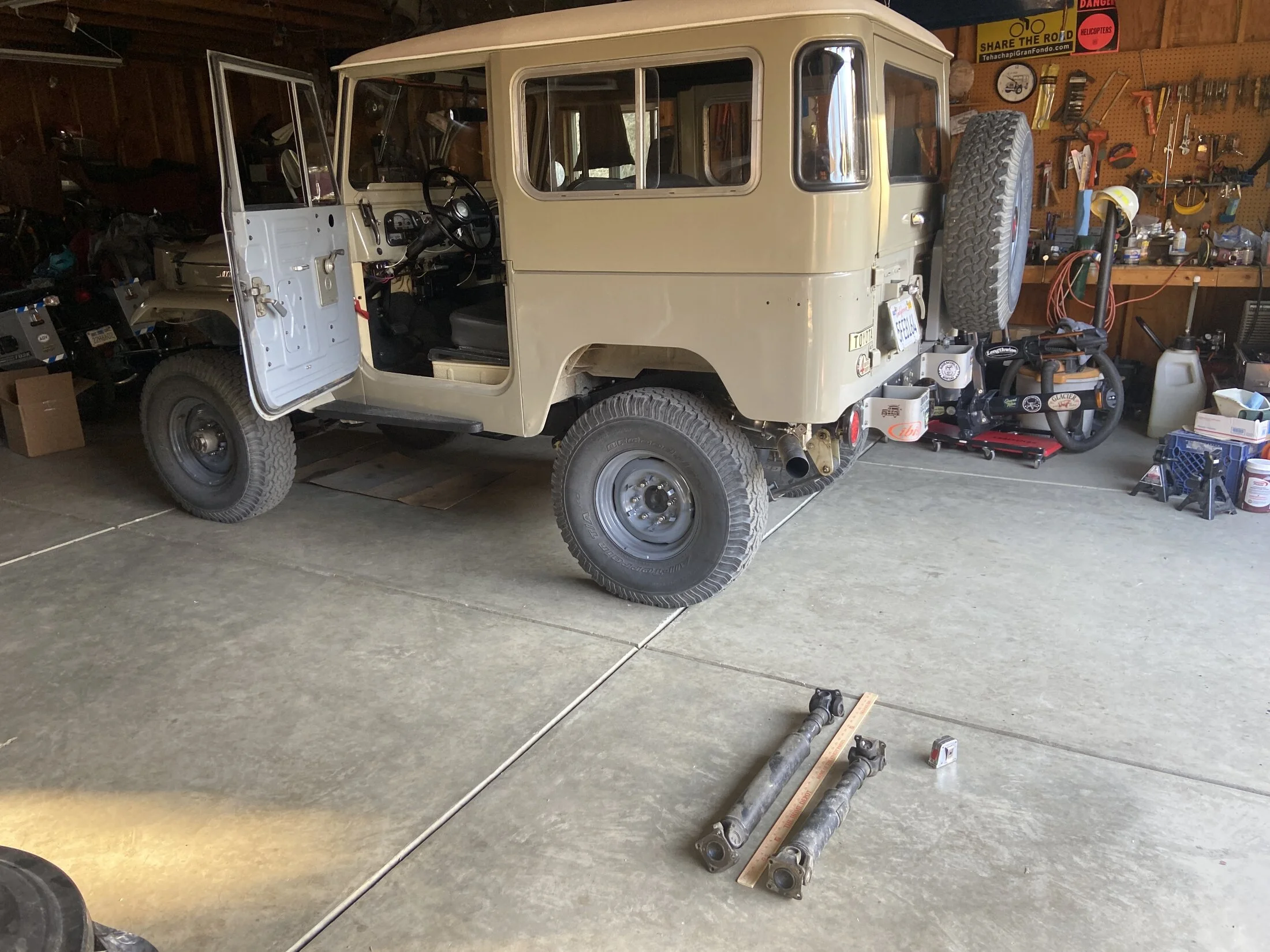

Mine are 29 3/4” front and 22” rear
The rear bolted to the parking brake drum and the pinion. 1967 vintage.
Forgot to say it’s sitting on a 4” OME suspension so they may be a bit long. They were measured fully compressed.

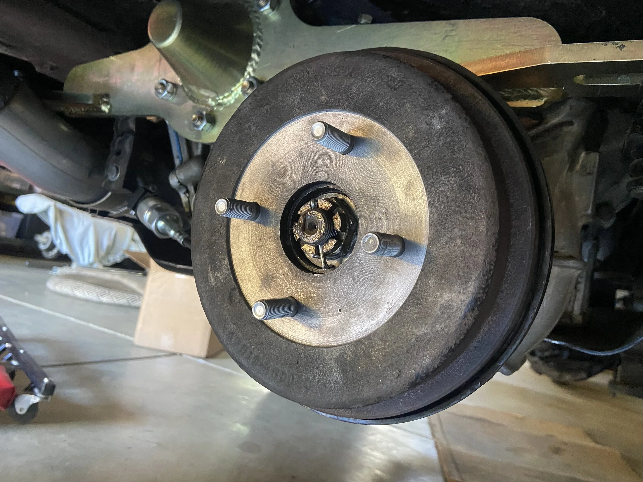

Would like to second the above regarding Tom Wood’s 4x Driveshaft. Just under $1000 for both, double Cardan on the rear and skinny up front. Even turned my parking brake drum down to accept the larger flange on the double Cardan. If you go that route make sure you send them the parking brake drum (conventional flange fits fine).
Installed 10mm studs too. All that for no charge. Great customer service.
