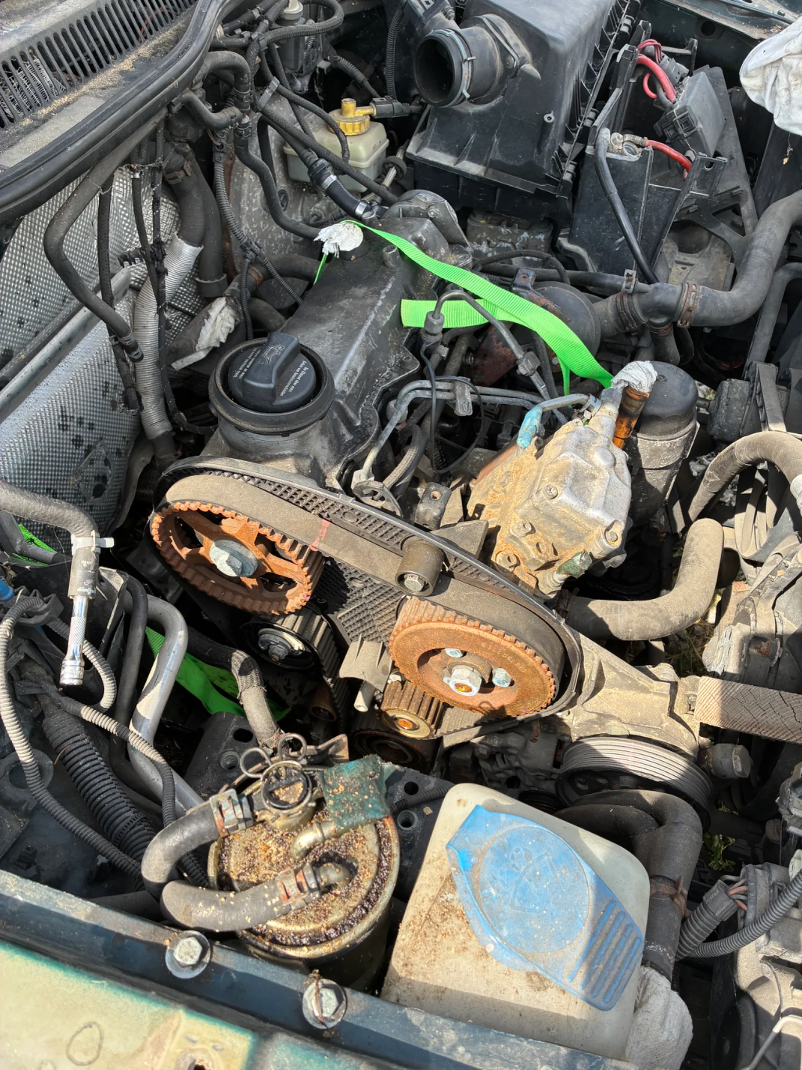

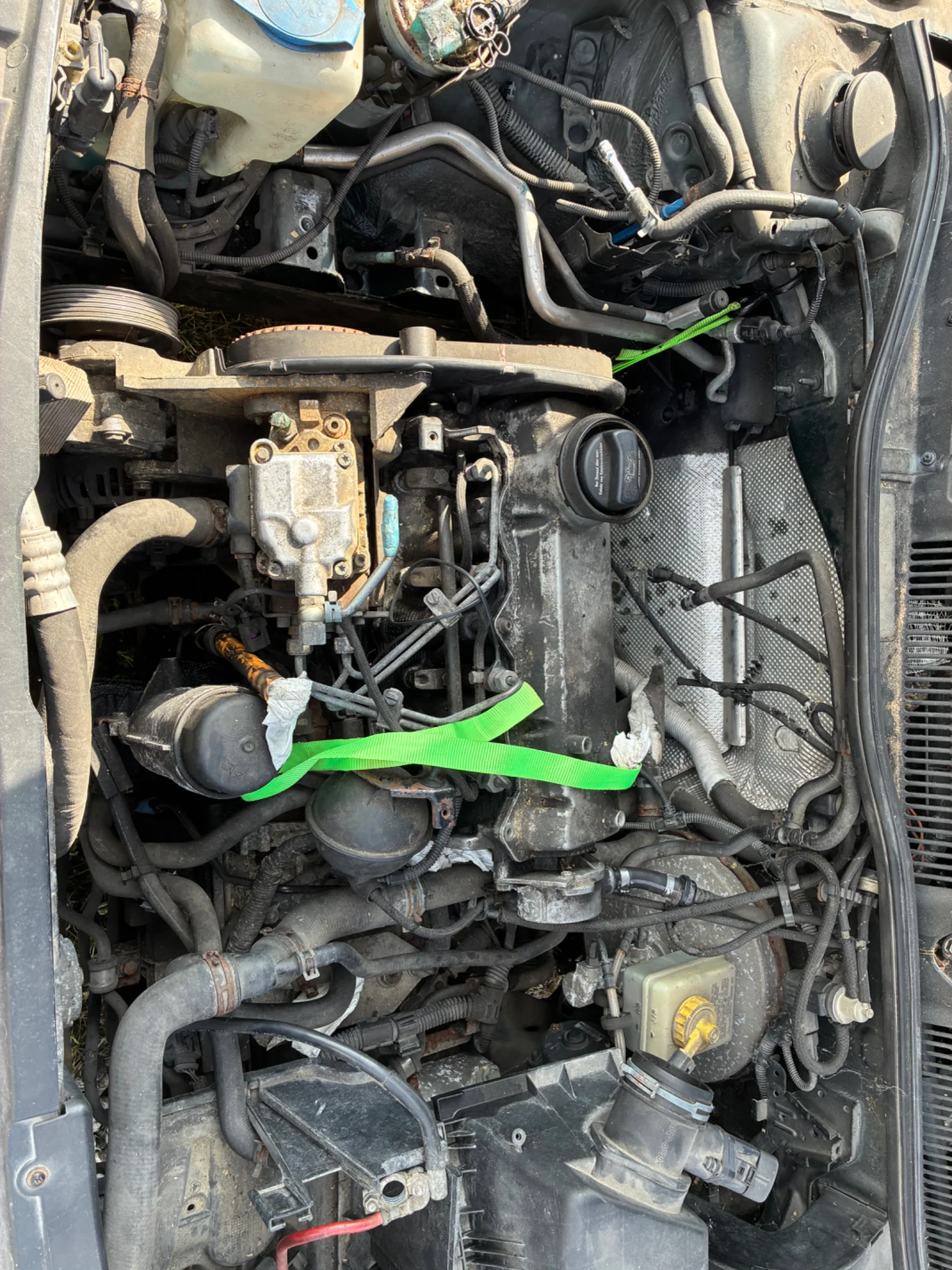

Got a bit more done on Zeke yesterday. Making sure to take my time and document what I'm pulling and what goes to what.

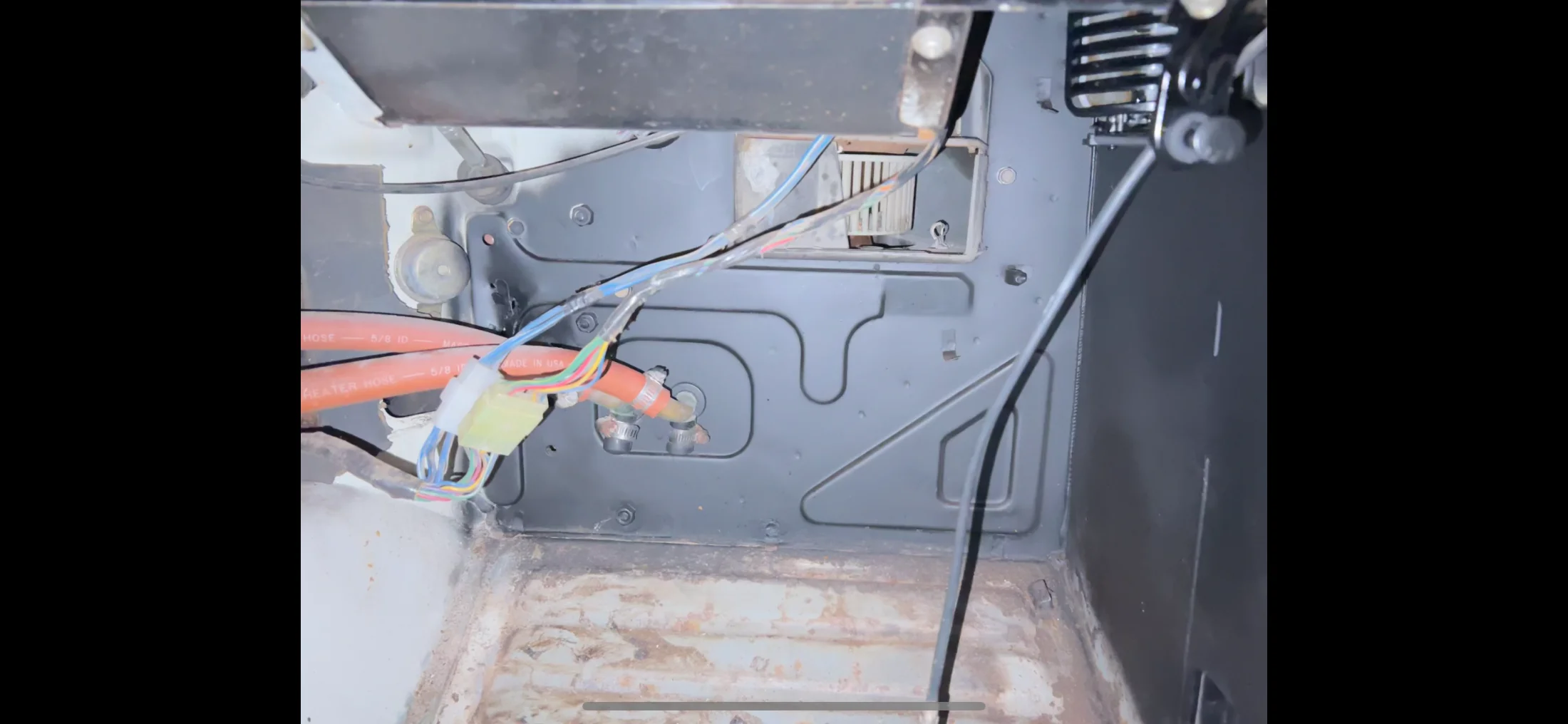

The airbox on the ps side, finally gave up its cover, but I'm having a dang hard time getting the nut pulled off of the retainer... just on the cabin side of the firewall.
Does the dash need to come out to access that bolt/nut?

lol. Yeah, the turbo, timing belt cover, etc., are in the trunk. I'm not going to be messing around too much in the engine bay. Just pulling the engine and accessories. The engine will go on a stand. There are so many potential upgrades to do to it. One of the first: upgrading the timing belt, and likely the gears... for peace of mind. Under heavy use, I think that timing belt service is 60k miles.
