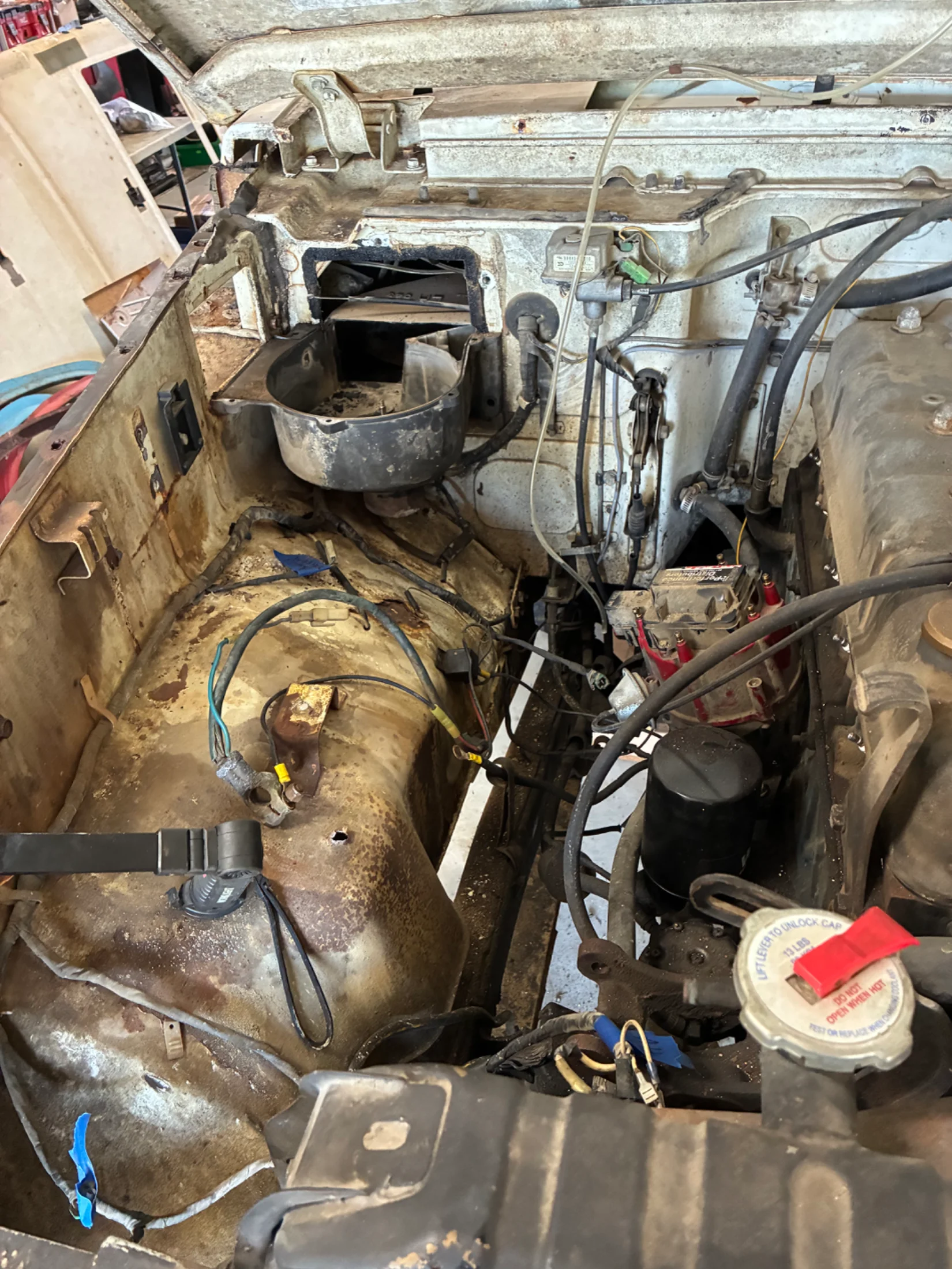

Got a bit more done on Zeke yesterday. Making sure to take my time and document what I'm pulling and what goes to what.
The airbox on the ps side, finally gave up its cover, but I'm having a dang hard time getting the nut pulled off of the retainer... just on the cabin side of the firewall.
Does the dash need to come out to access that bolt/nut?View attachment 3988057
Alright… half of the engine bay is empty. Small steps, but headed in the right direction

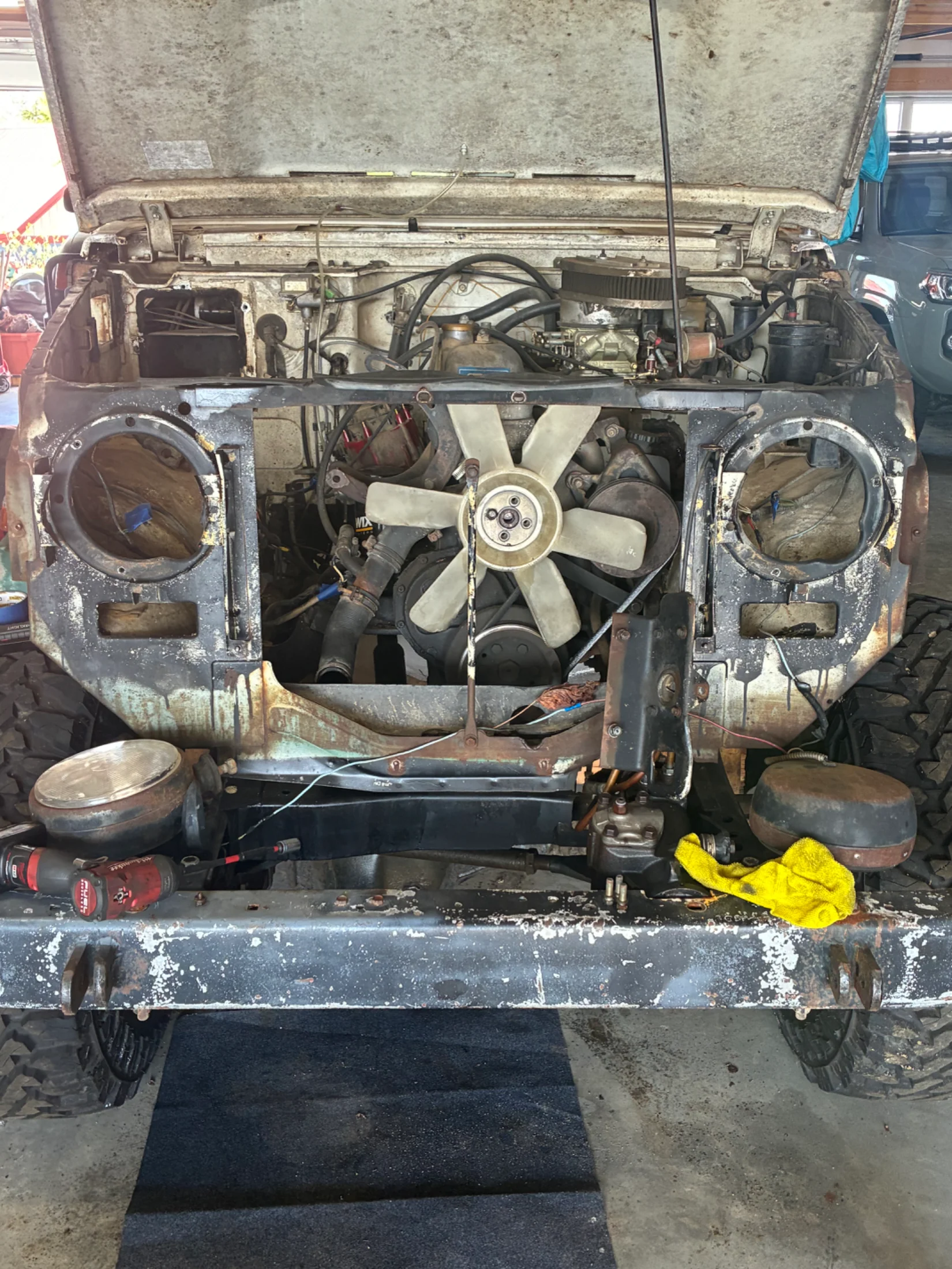

Need to pull Zeke's front apron to make the engine pulling and swap easier to manage.
No pics yet. But... soon.
