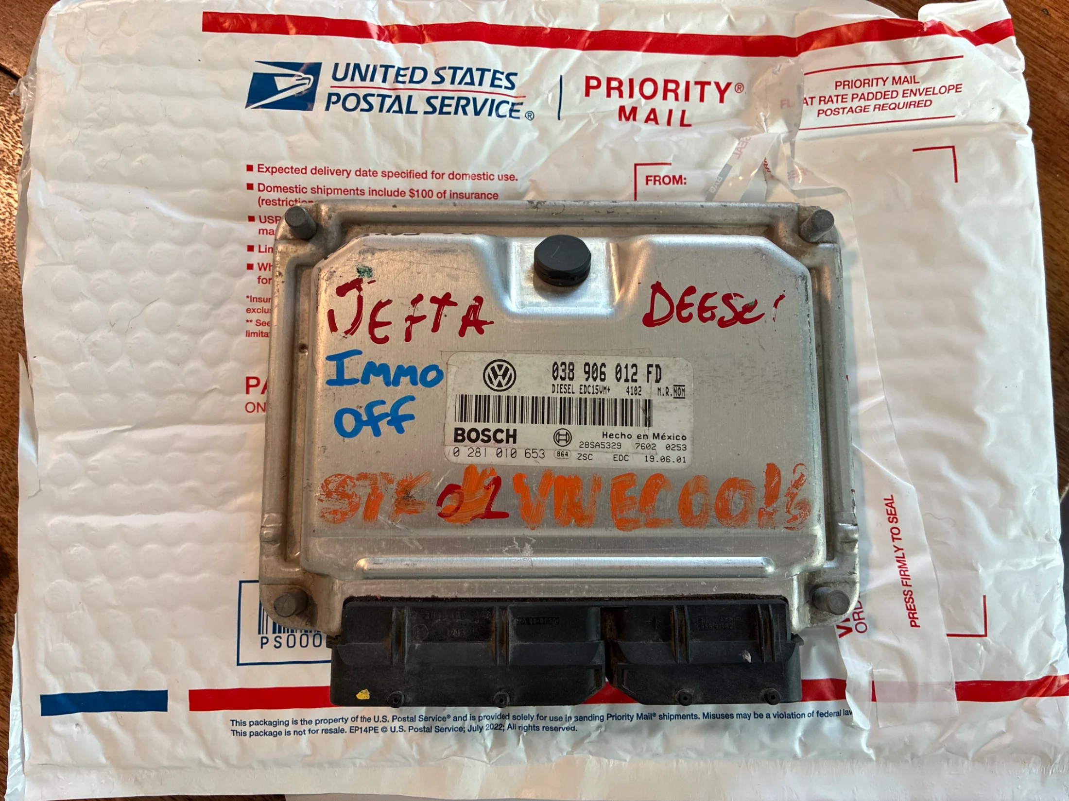

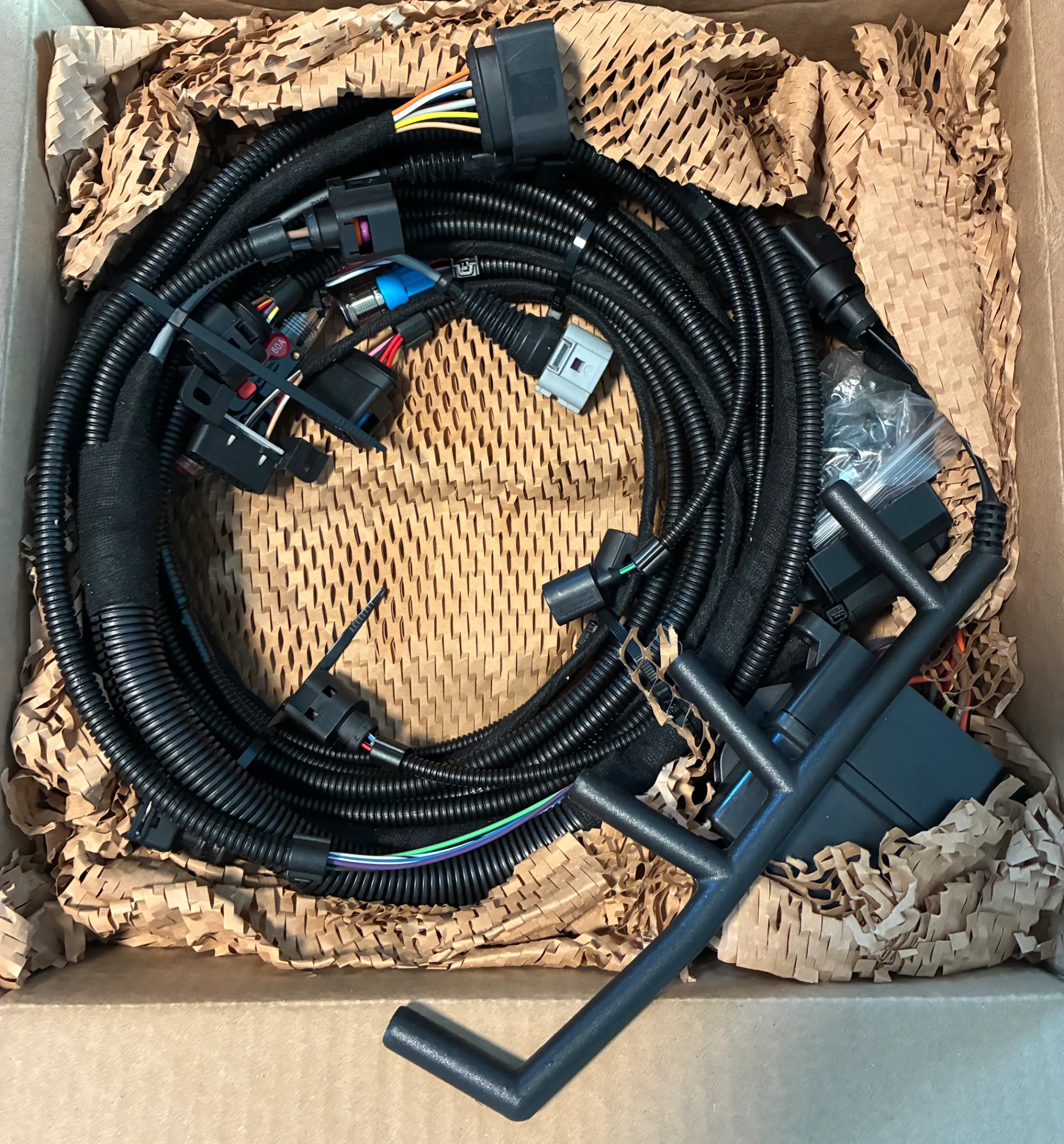

New stand alone wiring harness arrived today, together with a reconditioned ecu with the immobilizer decommissioned. Stoked!

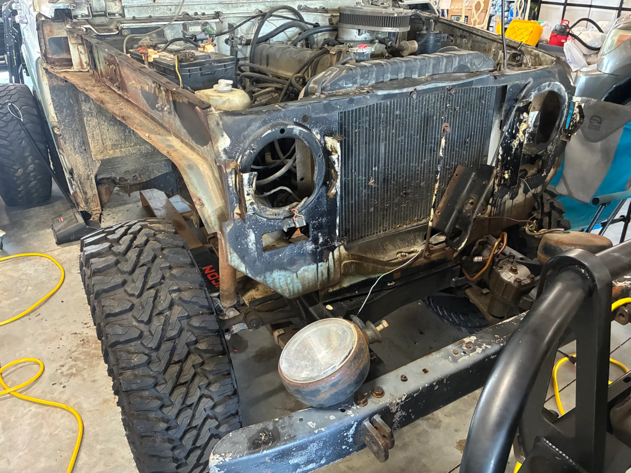

Slow progress today… lots of lube and patience…

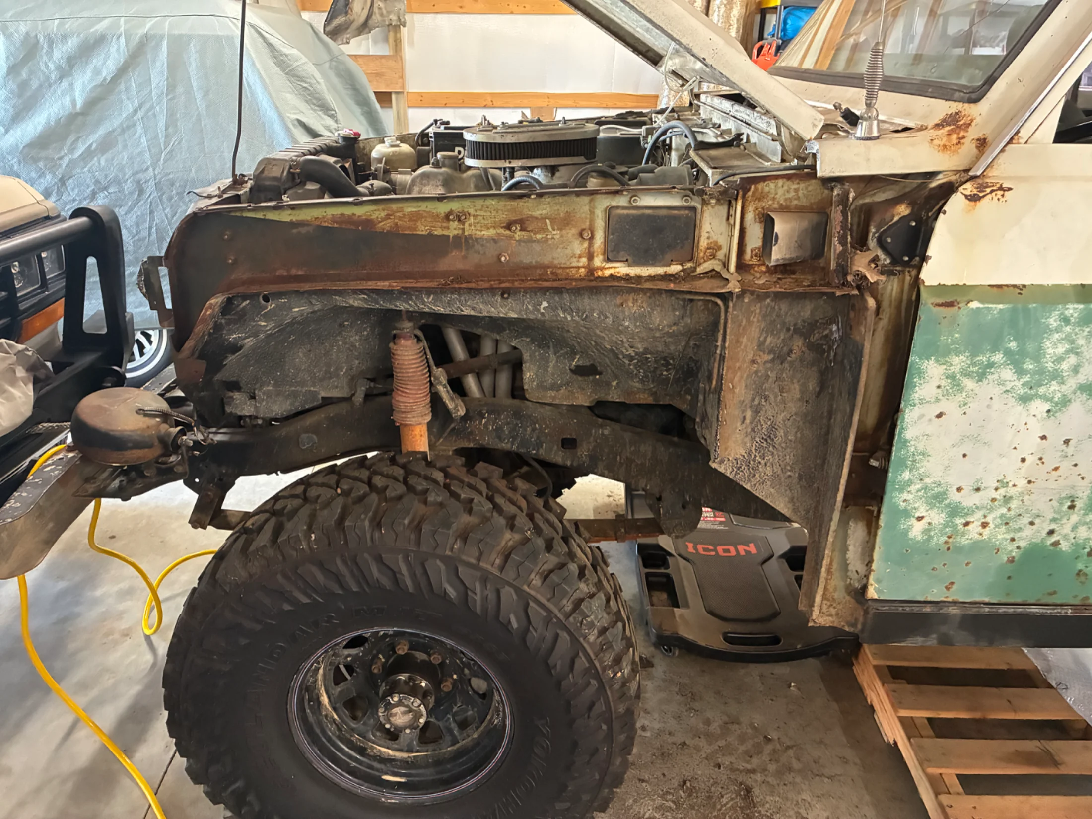

Nice looking battery tray. Sorry; wrong thread. 😁
I had that battery talk in th back of my mind, because Zeke's battery tray does in fact have a rubber covering over it. Sure looks like a factory coating.
That brings back flashbacks. Like when I replaced #5 exhaust valve and broke a rib by leaning too hard against that fender seam.

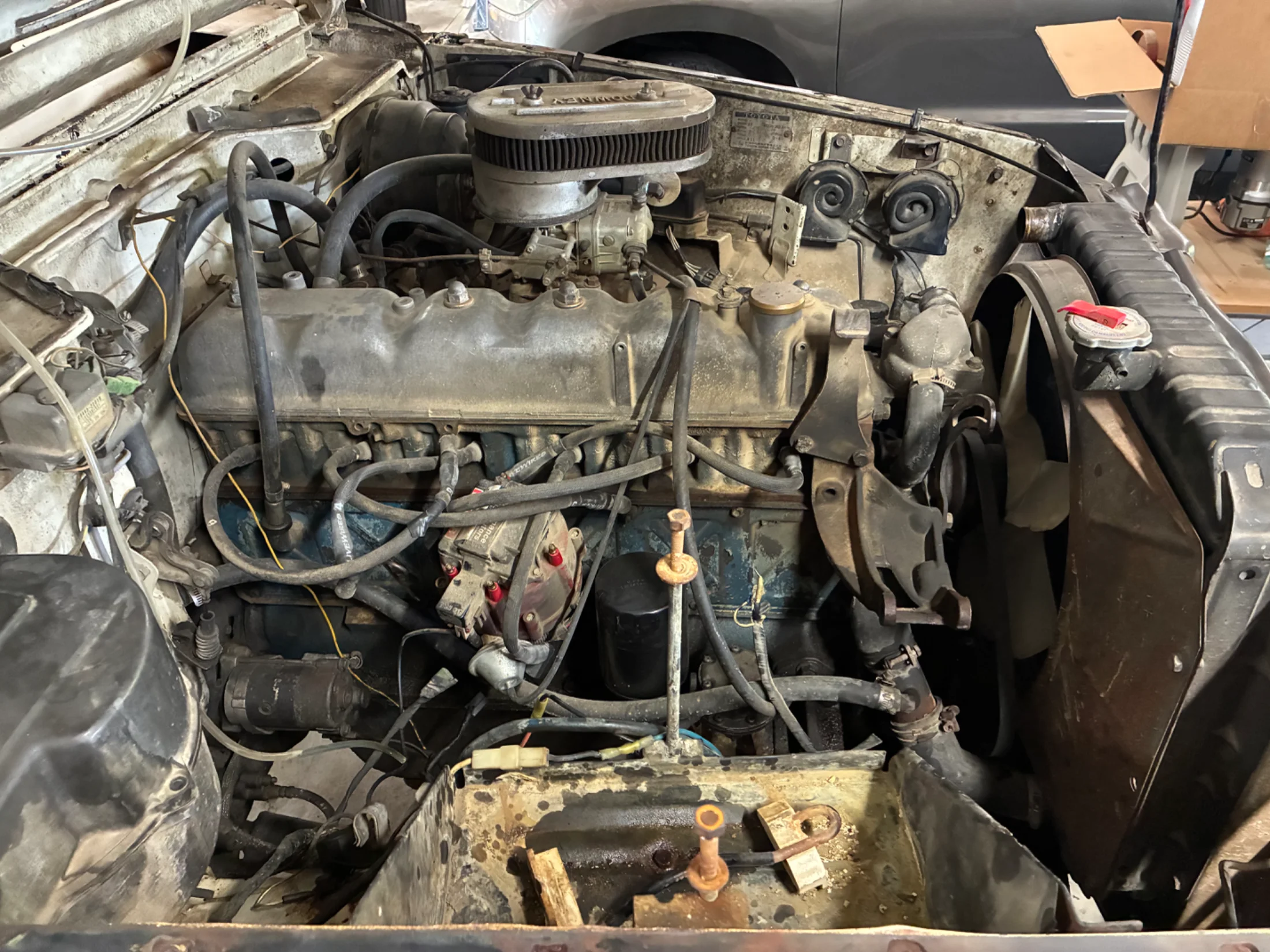

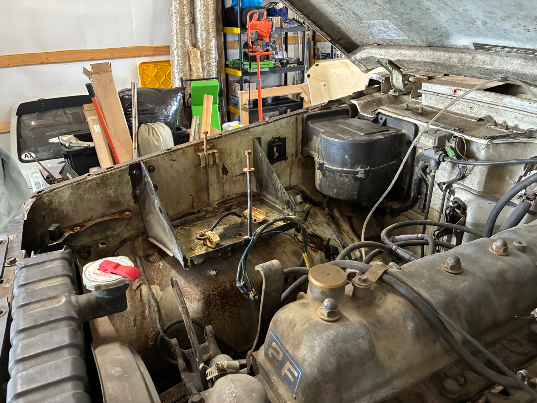

It's fun to see it getting stripped down to see what you discover
No broken ribs yet (thank goodness), just a couple of bloody knuckles so far. Most of the bolts in the engine bay are coming out smoothly. But, there is one bolt on the air filter cap... right up by the firewall that is giving me fits... lol. It's the only rusty one. The others came right out. I may need to slip a sawsall between the upper and lower filter housings to get that one off... lol.
