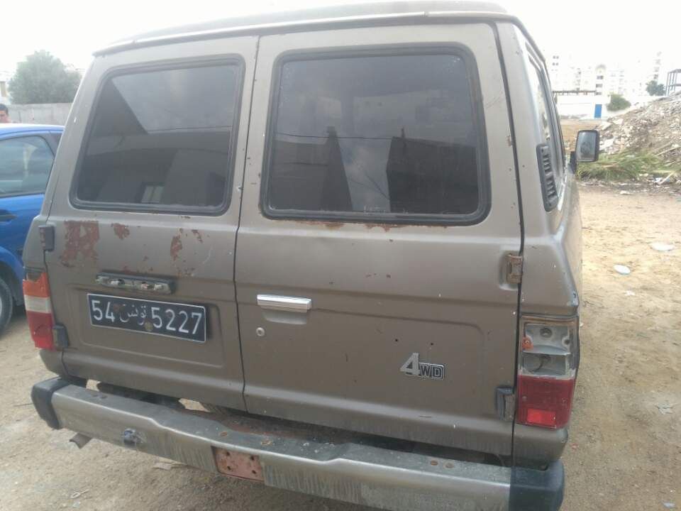

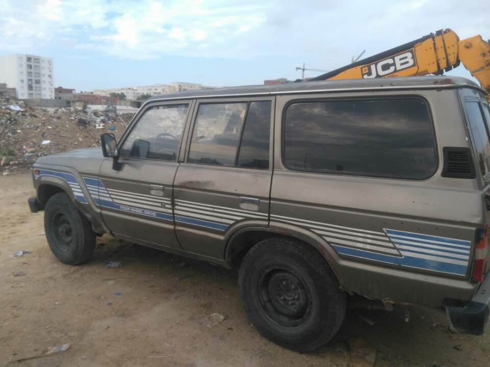

Dear All I presently planning through the restoration of a LC 60 1988.
And the following modification from the original are planned
  • slight suspension lift and slightly bigger wheels
  • Additional Battery with a management system and certainly sockets in the car
  • elevating all breathers to underneath the bonnet & snorkel
  • secret fuel switch (in case of theft they won't go far)
  • Soundproofing the interior
Now I would like to ask you to tell me your top three modifications you did on you LC 60 apart from those ones mentioned above. Modifications you do appreciate in your daily life or in particular situations which may reoccur.
there is another two points I am not sure yet what to do, but for this I will dedicate separate threads.
Thank you already in advance for your input.
and by the way see below the "patient"
Projekt BJ 60 by Christian Tomandl, auf Flickr
