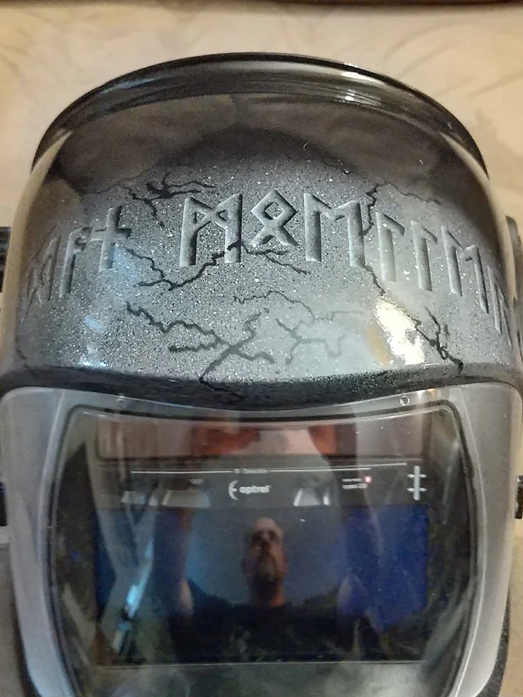

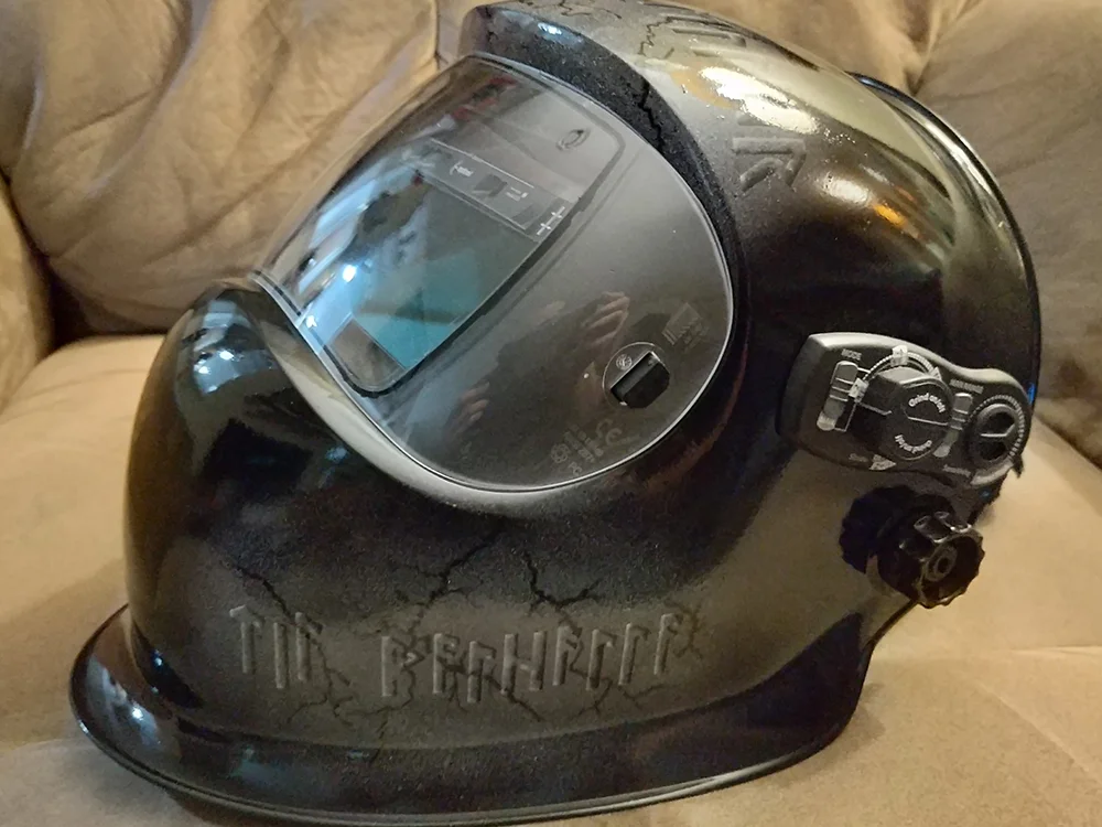

Optrel welding hood. Very nice. I invested in one when I worked as a Tig welder on inconel bleed air ducts. Had a co worker airbrush it for me.
Dude that paint job is so awesome! I never thought of getting my welding hood painted. Didn’t even know that was a thing! I originally got mine for TIG but I use it for everything now!
Have the same helmet got as a gift from a customer it is a nice helmet.
It’s hard to go back to my old miller helmet that came with my Mig welder after using this Optrel helmet. You can’t see anything!
I'm getting old and gotta use readers under my helmet my sight ain't what it use to be still get the job done also don't fabricate near as much as I use to.
Yeah the dude did a great job. On the top is a letter for letter translation in Elder Futhark of my name, and on the left side is "TIL VALHALLA". Granted letter for letter isn't a true, accurate translation, but it's more easily translated.
Same on the Lincoln hood I have. It's a good backup, but the Optrel is FAR better for visibility when I'm welding.
I learned tig with the cheap miller helmet that came with my mig welder and when i switched to the optrel it was like turning on the lights and being able to actually see haha
