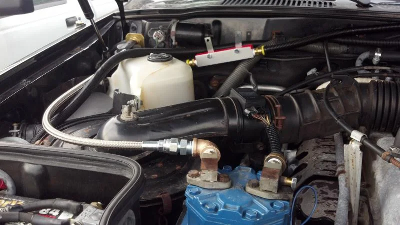

That separator looks a bit close to the exhaust....you may bake it. Moving it further down stream would allow the oil mist to "condense" a wee bit as well. Kirby or a pick and pull is about the only place for flanges. Could always swap comp heads and thread the ports internally for NPT fittings.
This!
The further you can locate your coalescing filter from the compressor the more efficient it will be at doing its job...think "cooler".
This!

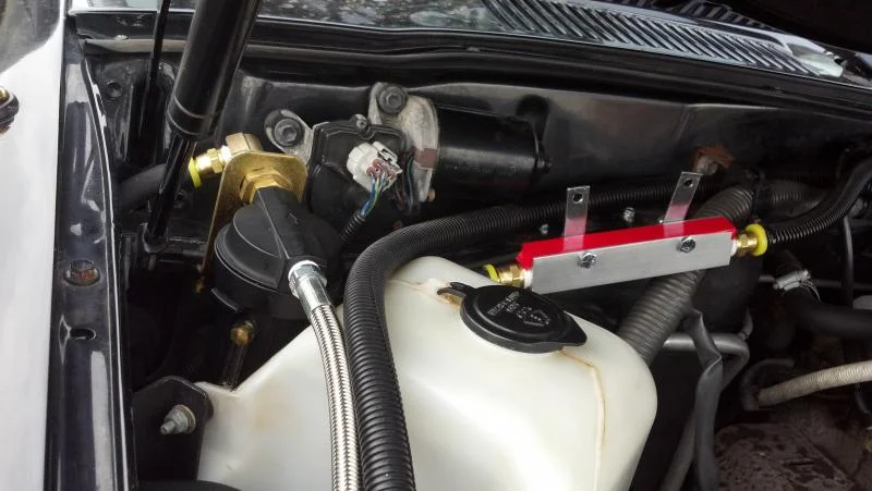

Thanks for the advice guys. Mine was an example of rigid thinking. It seems like a few of the threads I've read on the net had the filter mounted very close to the compressor and I was just going that route. As I look it it (and in my pic it is very obvious), it would be simple to mount the check valve directly to the air manifold seen in the back of the pic and then the filter directly to the check valve. I can easily create a bracket mounted to the firewall for support.
Finally getting around to installing my system. Here it is mocked up. I will make some heavier brackets and TIG the inlets and outlets to the flanges. Have you guys found any different sources for the flanges?
It's not completely clear in this picture, but it looks like you built a bracket to hold up one side of the coalescing filter and attached it to the MAF. But the air filter housing and accompanying MAF are bolted to the body, while the compressor is bolted to the engine which rotates from torque forces. This is why there's a big rubber flex hose that connects the MAF to the throttle body. Once you start torquing the engine, something is going to break, most likely the small pipe that connects the coalescing filter to the compressor.
Yes - good catch. The plan was to both mount the bracket to the air cleaner with rubber isolators and mount the filter to the bracket with rubber isolators. But…I think it will be easier/cleaner to mount the filter to the firewall.

How much does mounting it on the firewall like in the pics obstruct access to the power antenna motor?
