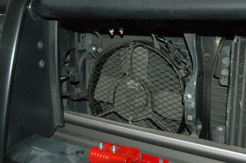

Well I bought the JDM fan from SOR and just added a relay, got power from my aux. fuse panel and added a Toyota switch to my dash. I decided I wanted the fan to go on when I wanted it to go on. Works perfect after a 3000ish mile drive to Yellowstone from LA at the end of August. Nary an issue.
what is the diameter of the JDM fan? 12in? or 14 in?
If I had to guess I would say 12" but I'm not sure and the truck isnt here to check it.
