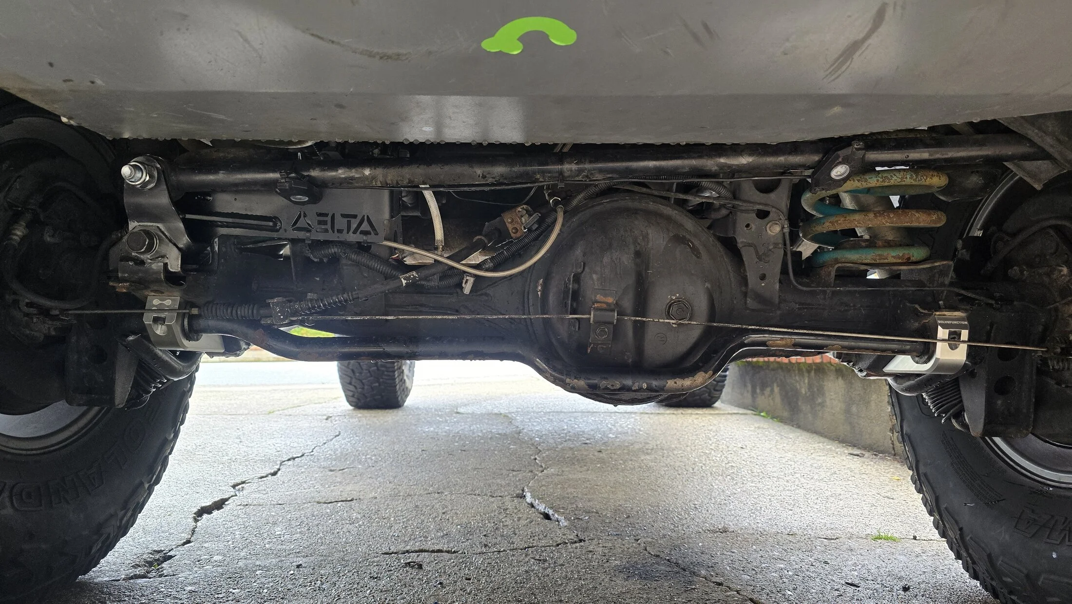

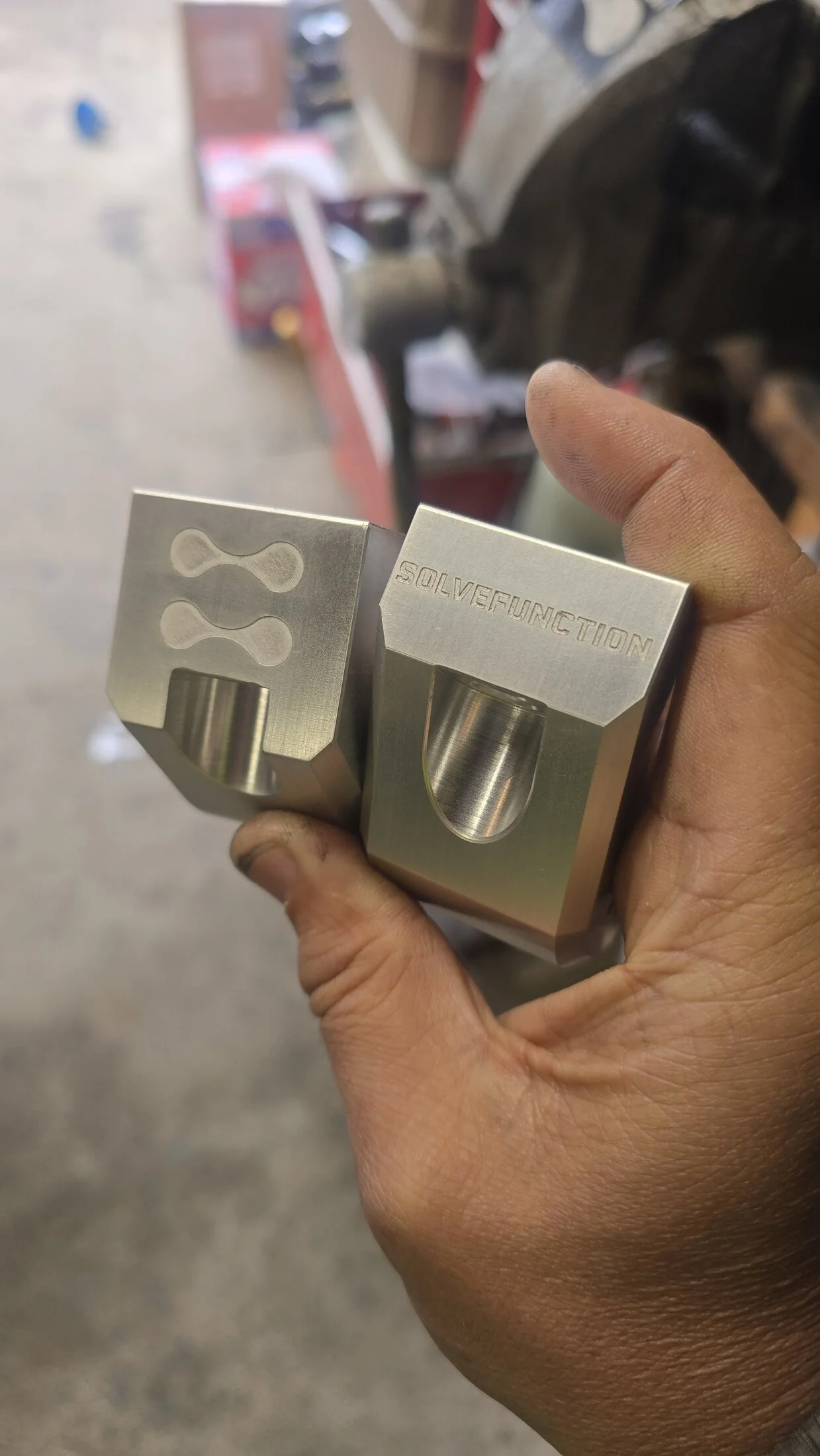

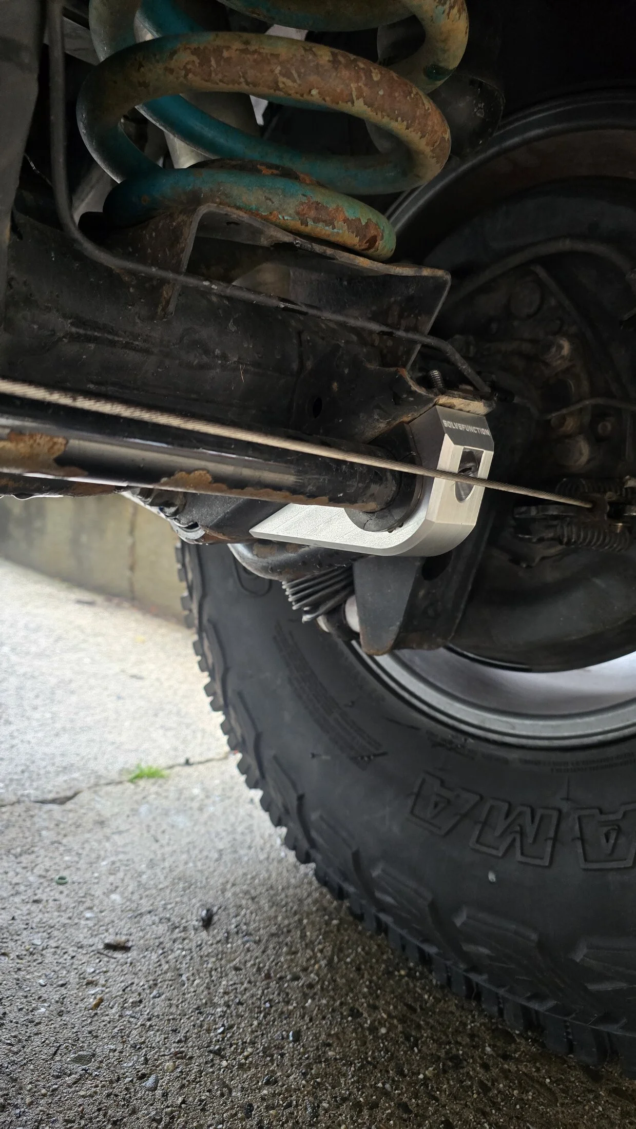

I designed these bad boys for the 30mm heavy duty rear anti sway bar.
The original hardware has been broken and beaten before. Wanted something stout and also incorporate a smooth transition from the rear lower link to the bushing.
That came at a cost to much more material and work.
I think it was worth it they came out awesome in my opinion
If you have any oem bar @Delta VS will have an option available soon.
Always good to have options. Though I never understood the desire to keep the swaybar in the factory location, its aweful.
I like to think of the rear anti sway bar as a skid to keep rocks away from the lower shock mounts.
If only. My lower shock mounts are screaming in protest.
But this is a great option for those not looking to relocate.
