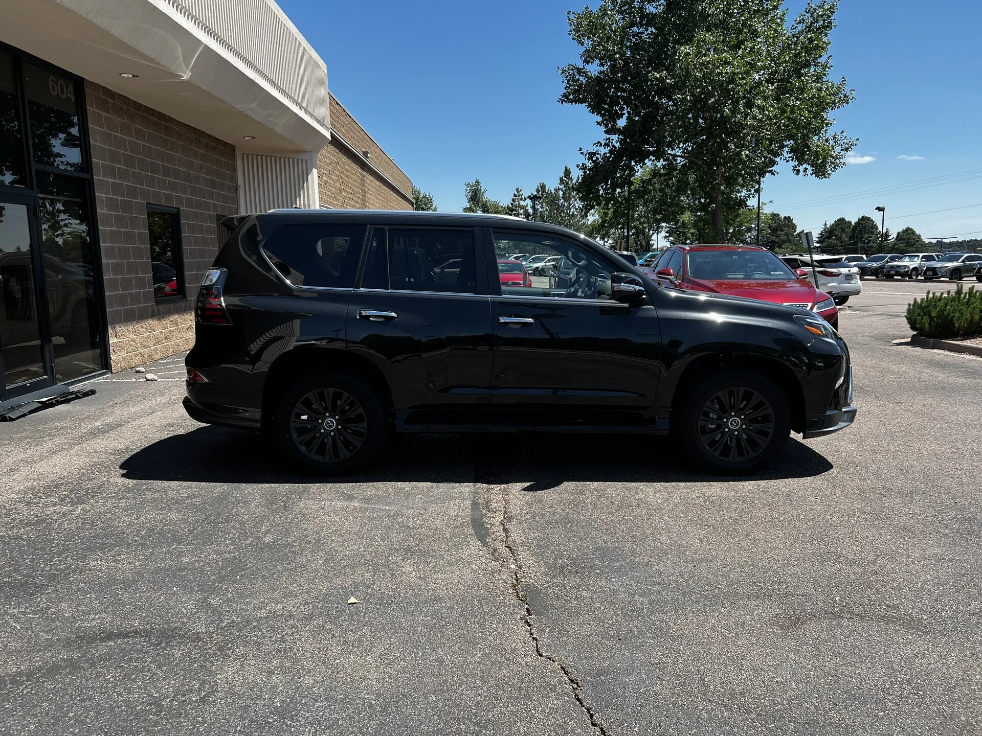

Day of pic:

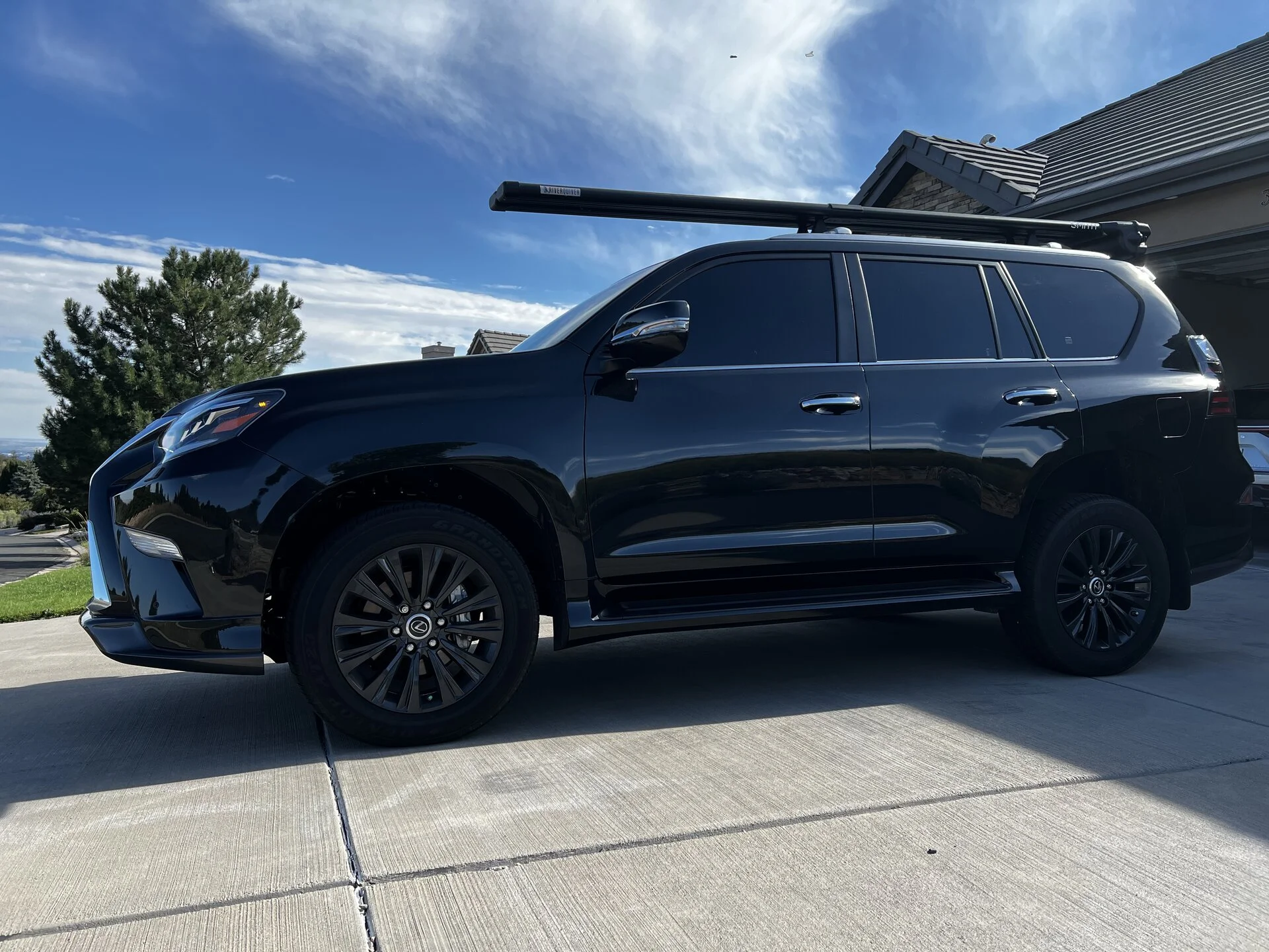

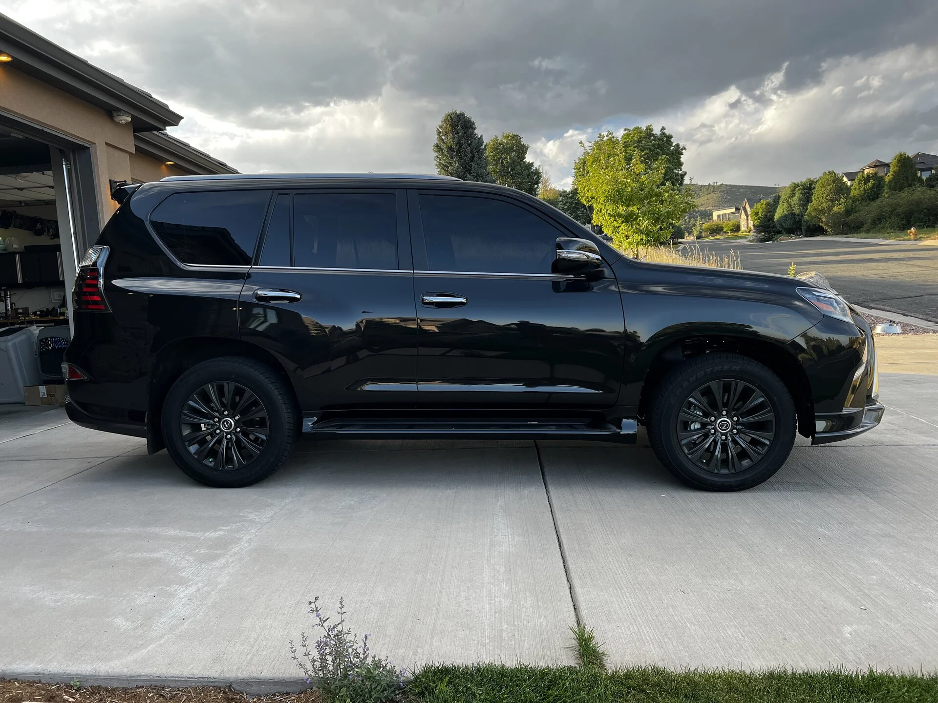

After tint:
Did some small things like the auto mirrors/windows down/up mod and the filter mod.

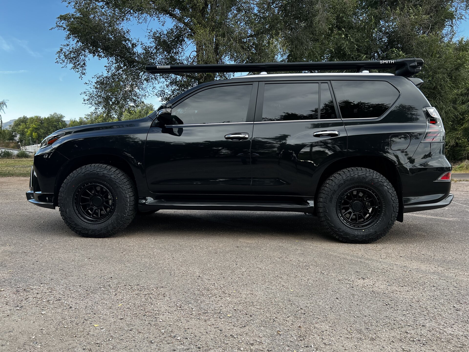

Bought factory rails and a rod quiver:
Then picked up new wheels and tires:

What are you wheel and tire specs? It looks perfect!

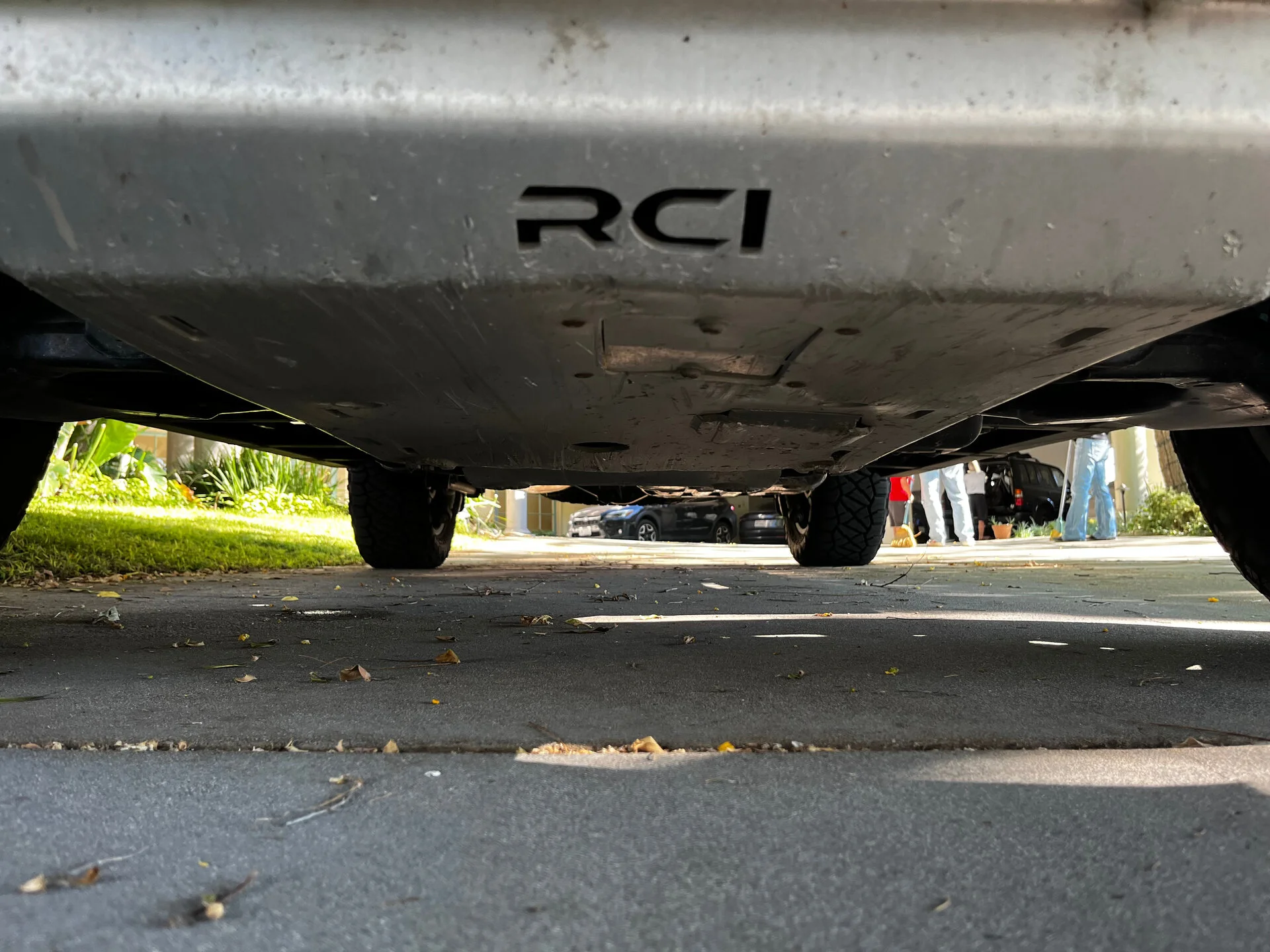

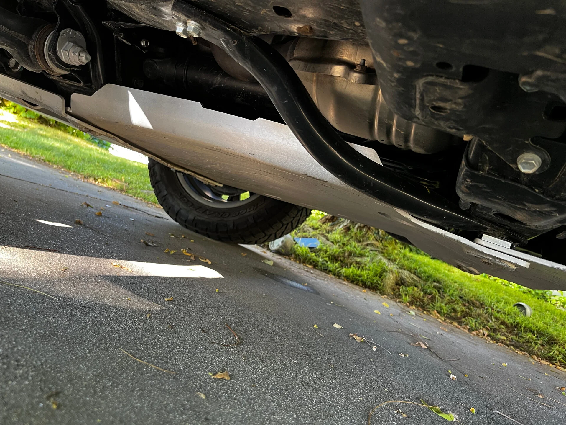

i missed that you are looking at rci skids. all of my skids are aluminum skids from rci. they have held up on the easy to moderate trails i've taken them on in the california desert and sierras. i'd defiantly get skids even if you are going on trails that 4x4 drivers call easy (level <4).
here are some pics. it is hard to tell depth from photos but they are dented.
engine skid
transmission skid
