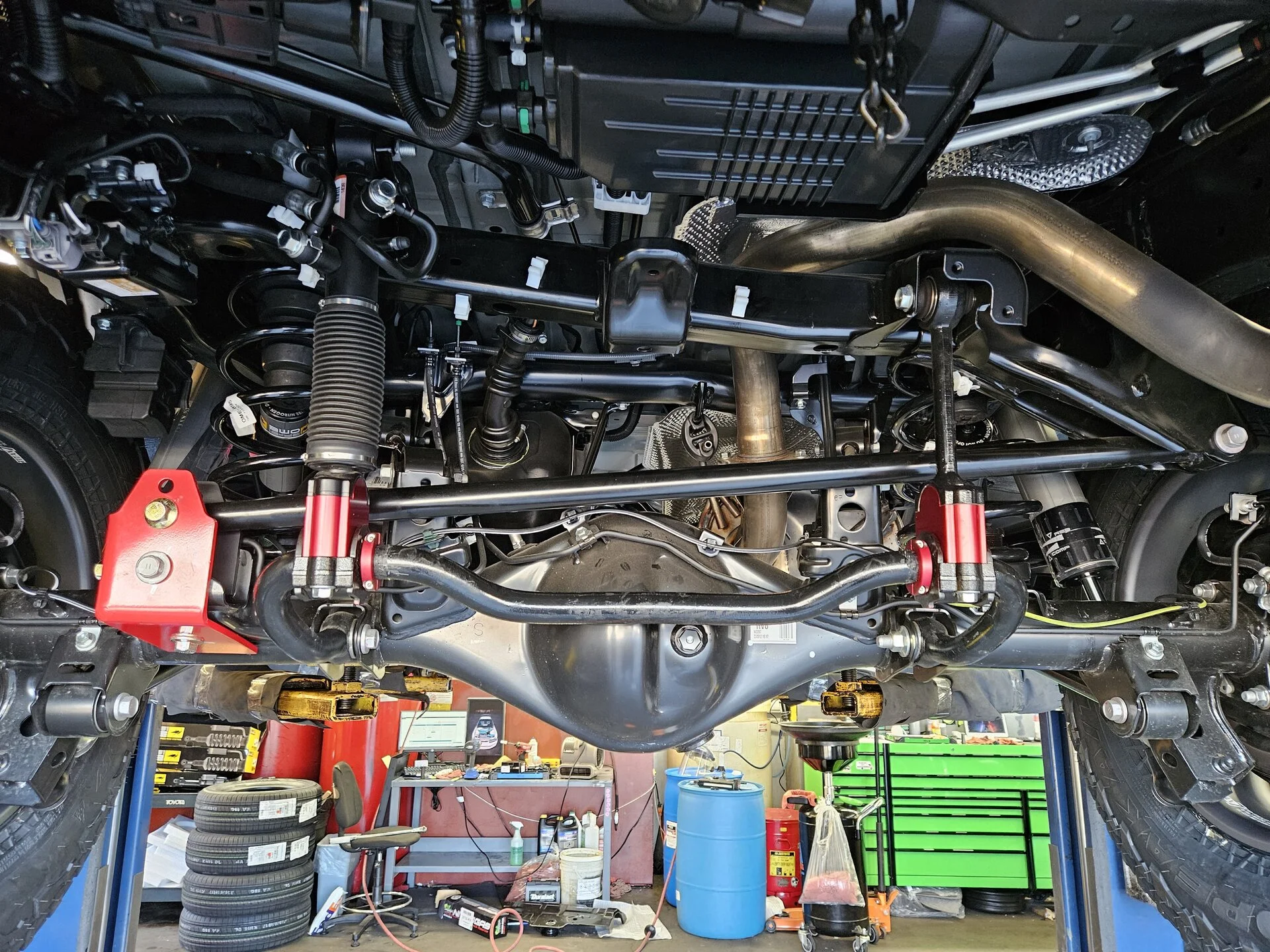

I drove the car back from LA up to Seattle and almost immediately had it in the shop (Nomad Overland Adventures) for a lift, wheels and tires. Here is a list of the initial parts:
- OME Lift with BP-51's and OME UCA's
- Ironman Airbag delete with OME rear springs

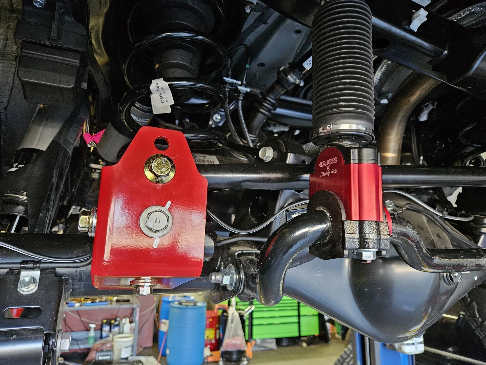

- DrKDSS Front and Rear swaybar clamps, bushing brackets, rear KDSS Drop spacers, BOTCK, and KDSS front swaybar adapters
- Titan7 T-AK2 wheels in Satin titanium (17x8.5 - 6x139.7 -8 offset)
- Falken AT3W tires 285/70-17

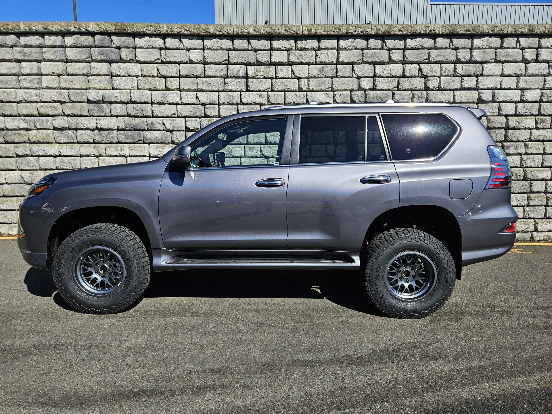

I have to say that the rig rides just like stock with just a little tire noise, but I expected that going from the all seasons to the AT3W. I can only post 5 pics at a time in a post, so when I have time I'll post up the following phases that have been done.

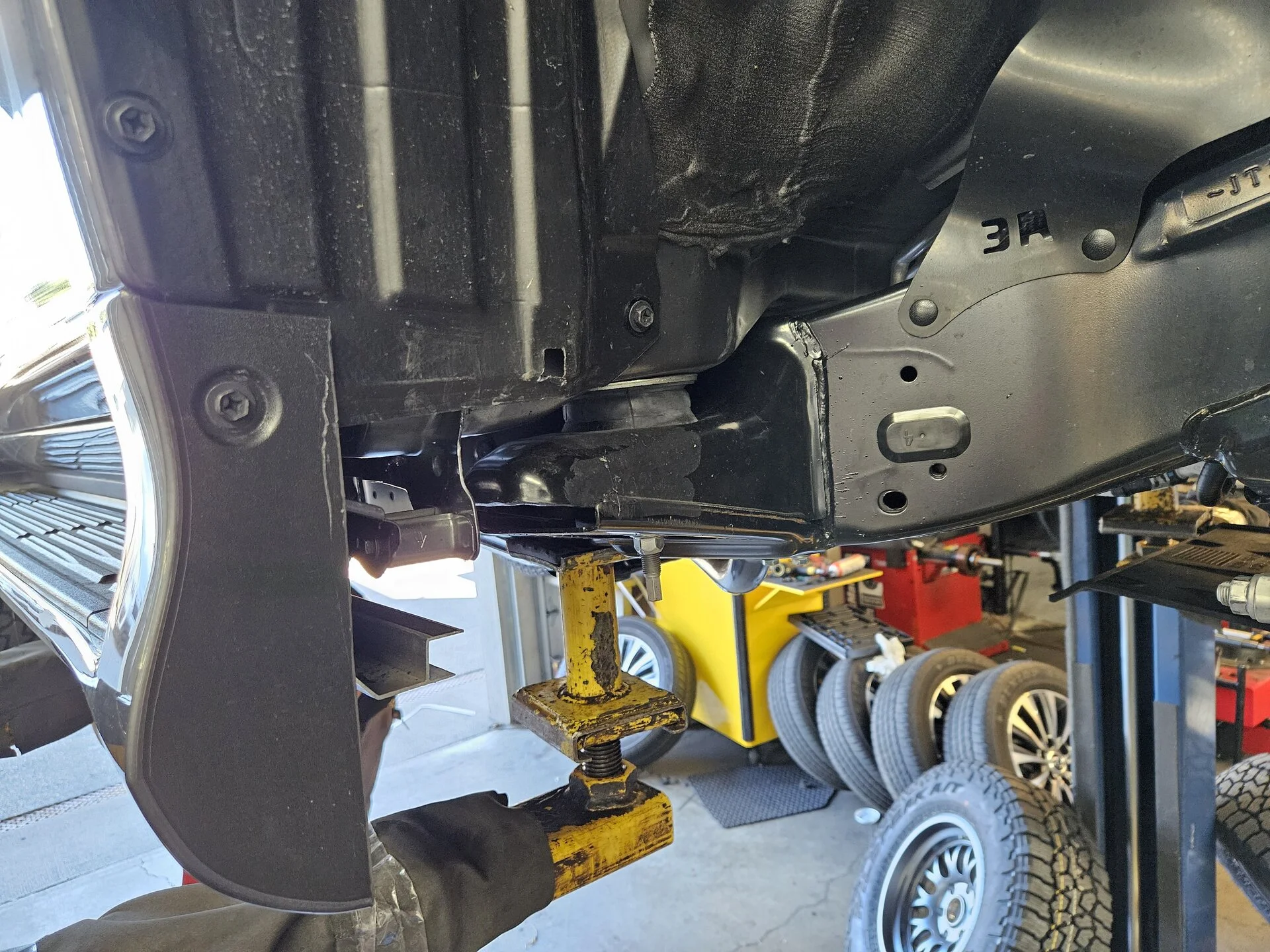

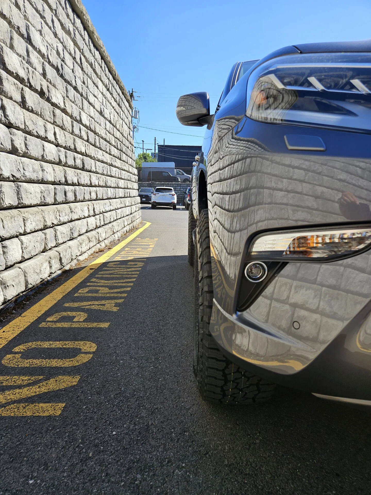

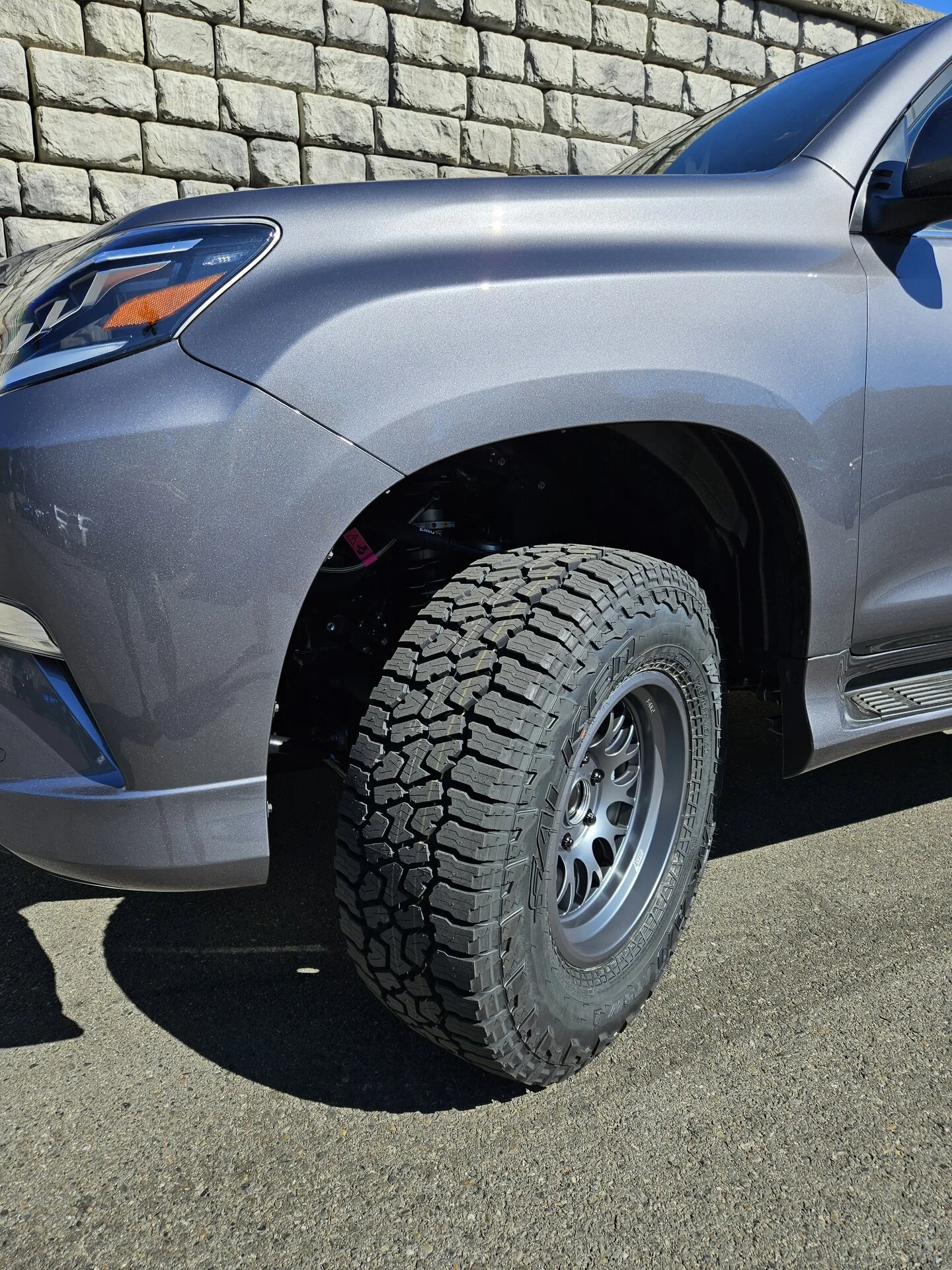

Your tire size choice, 285/70/17, is what I'm looking at for my next set. Have to ask, any rubbing issues? I see you added an OME UCA, did that help with preventing rubbing?
There will certainly be rubbing issues on the wheel well and possibly on the control arm of offset is wrong.
Thanks for the welcome everyone!!
As for tire size and rubbing, the tech had to do minimal trimming of the front and rear plastics but using the OME UCA's and a -8 offset wheel, the tires just stick out a little and I have no rubbing and didn't have to do the body mount chop.

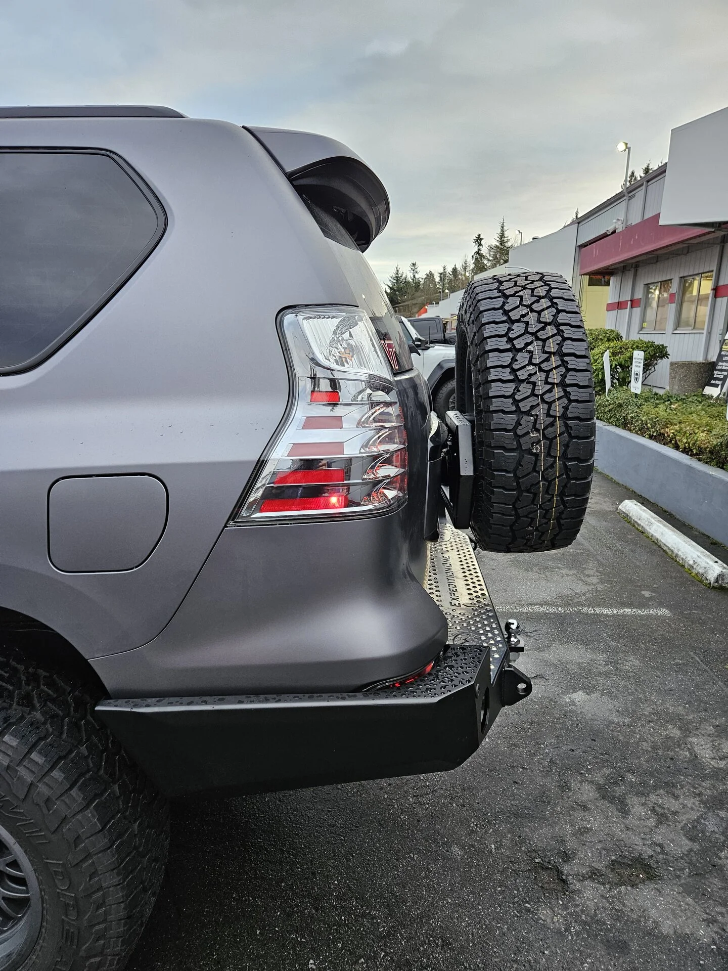

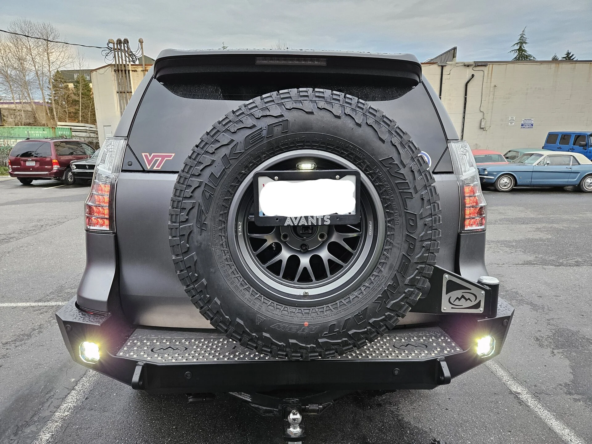

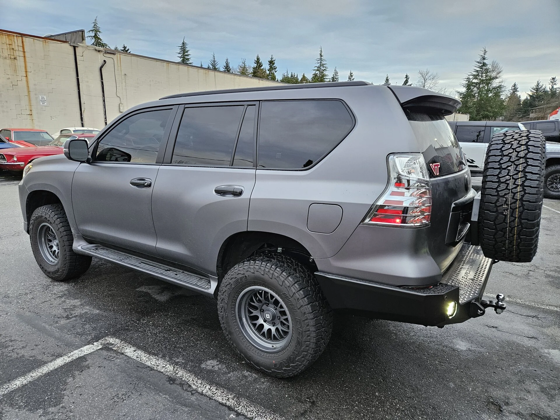

As for the spare, I just had the Expedition One rear bumper with single swing arm installed and so now my spare is out back. I'll do another post for the rear bumper as there were a LOT of fitment issues that the shop had to deal with.

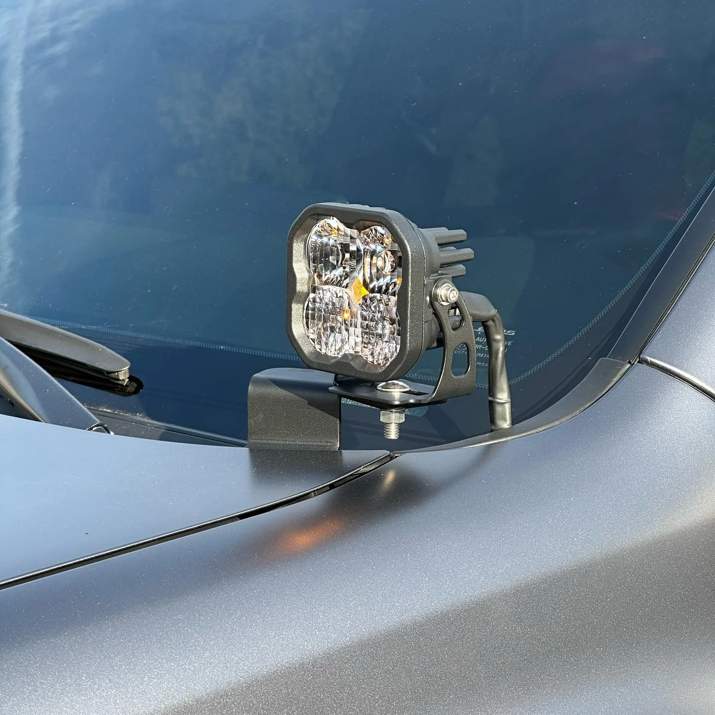

Diode Dynamics SS3 ditch lights on SDHQ ditch light brackets

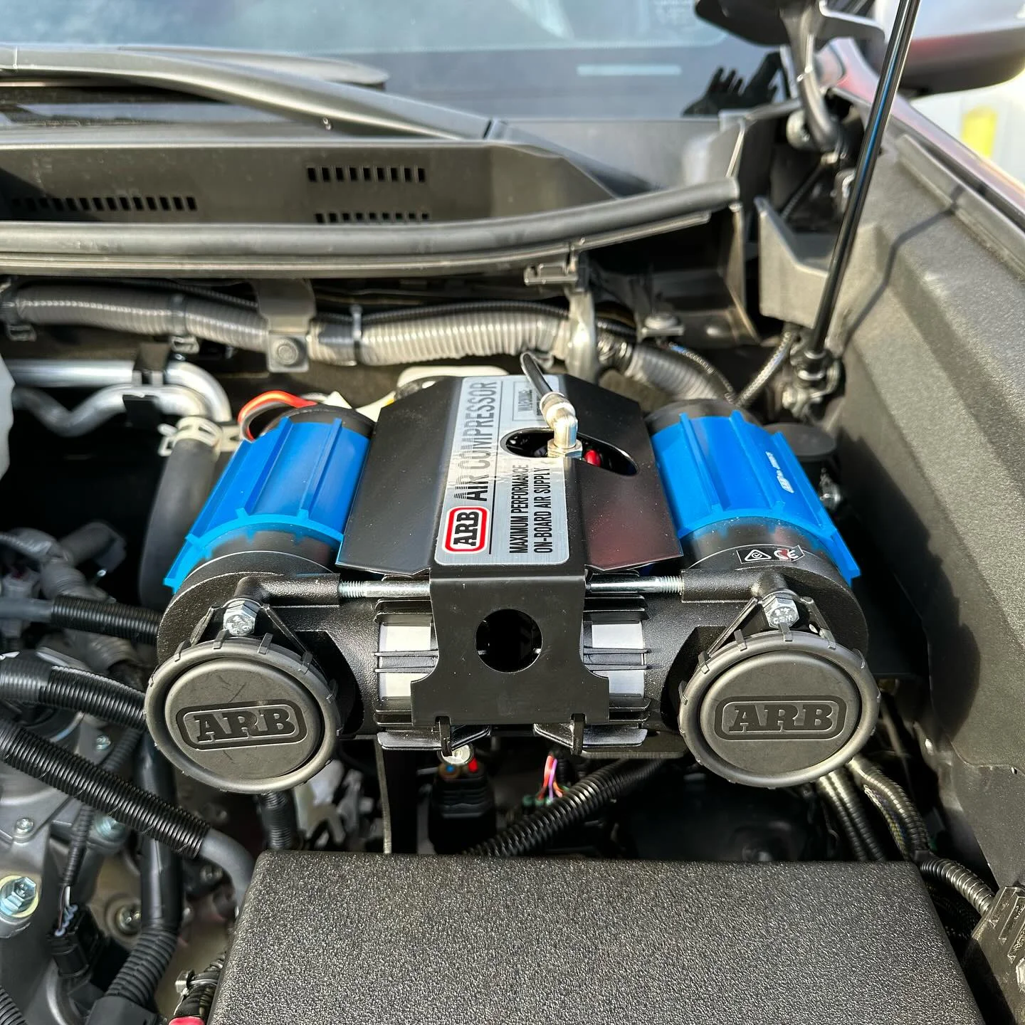

ARB Dual Compressor

Did you leave the body mount open like that or add a plate? Don’t know about the structural integrity of the mount open like that. edit: NVM I realize you didn’t cut the body mount.. you will probably rub on that.
Wow. Looks amazing. Great job!
I have turned lock to lock and don't have any rubbing, but haven't flexed the suspension at lock to see if it rubs on the body mount. If it does rub at full flex or if I decide to go to a bigger wheel/tire combo, I know I'll have to do the body mount chop, but for now there isn't any rubbing.

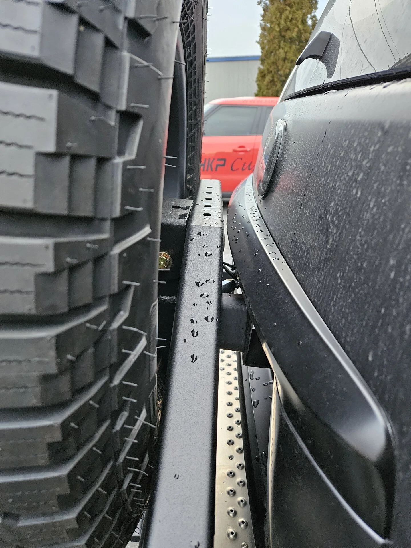

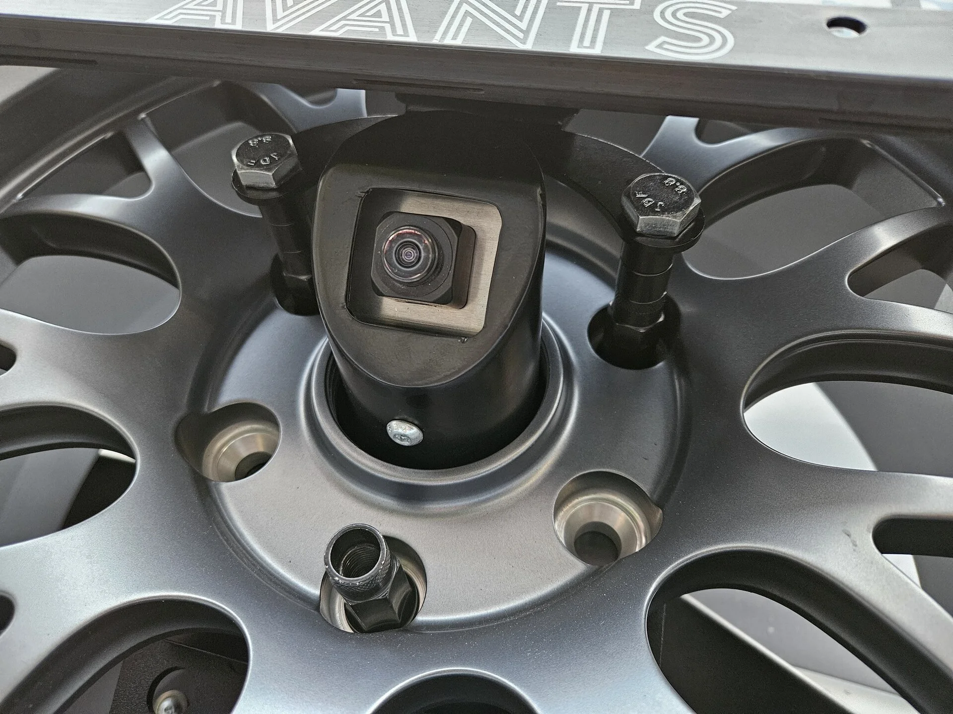

Love the camera housing! But, boy, is that arm close to your rear door! You may consider putting a foam pad, maybe a short section of the slitted round black insulation tubing used for water pipes. Unless you can loosen your bumper and pull it out a wee bit?
I can just see that banging that rear door first time you take it out on a washboard road.

How do you like the rear bumper? I've been looking at this one because my spare doesn't fit underneath. How is the fit/finish.
@r2m I think the swing out mounts to where the license plate used to be and then swings out with the door. That's one of the features that drew me to this bumper. I know my wife will not want to play around with unlatching and latching the spare swing out haha.
I've been running a Dirtcom Trailswing for 2 years and can confirm that wives are not interesting in unlatching and latching the tire carrier swingout lol.
