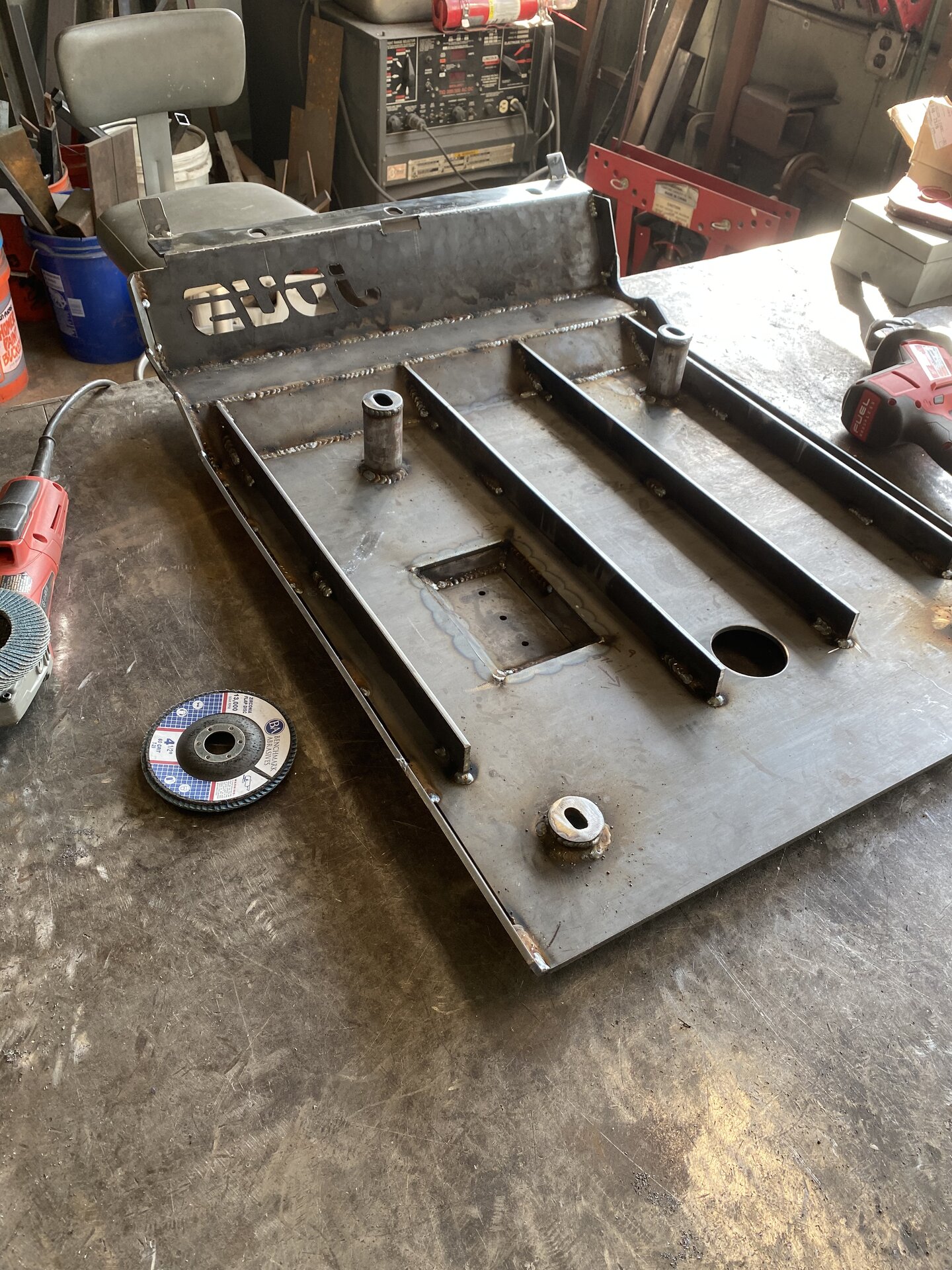

I see a lot of RCI skids out there in photos but havnt had anyone I know run them on the trail. The only caution I would have is they don’t have internal reinforcement. Depending on how hard you bash your rig around, that may make a difference. I’m not sure if budbuilt is still around or what companies do make skids with more support anymore but I’ve bent ARBs and even 3/16 plate versions. Now I have a custom skid, with support. View attachment 3454617
RCIs skids hold up very well, no bracing needed. I often purposely stick my GX for class no damages to them at all.
