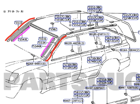

Parts diagram from PartSouq
red: "Rain Gutter", pink: Moulding (is that even right?)

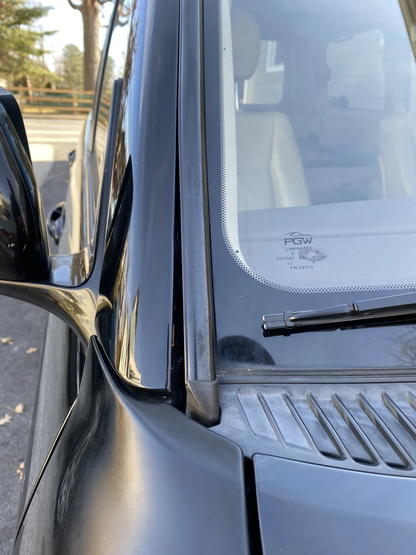

Driver side "rain gutter". You can see the rivet holes with nothing in them

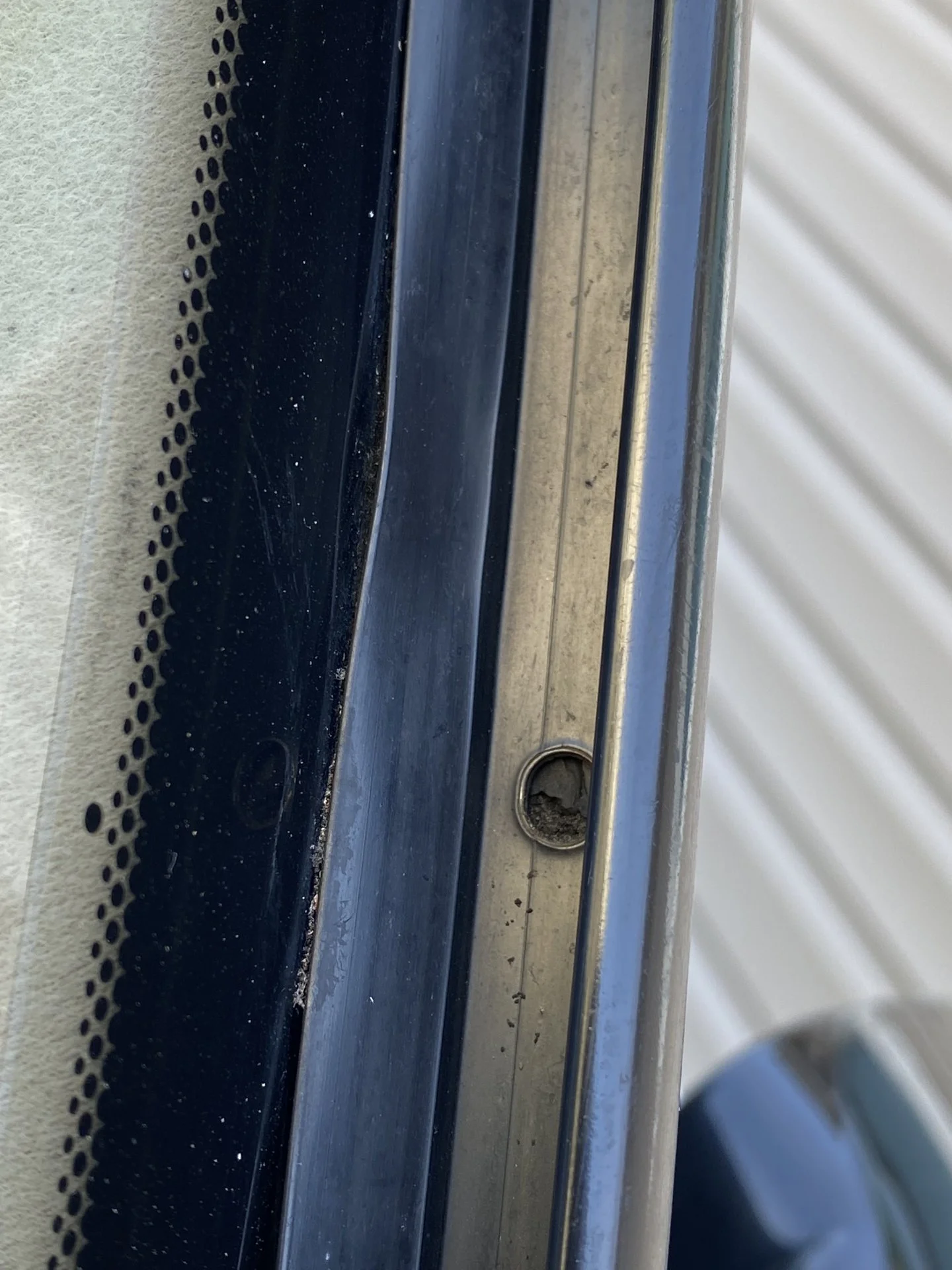

Close up of one of the rivet holes, they all look like this. No rivets, just adhesive.

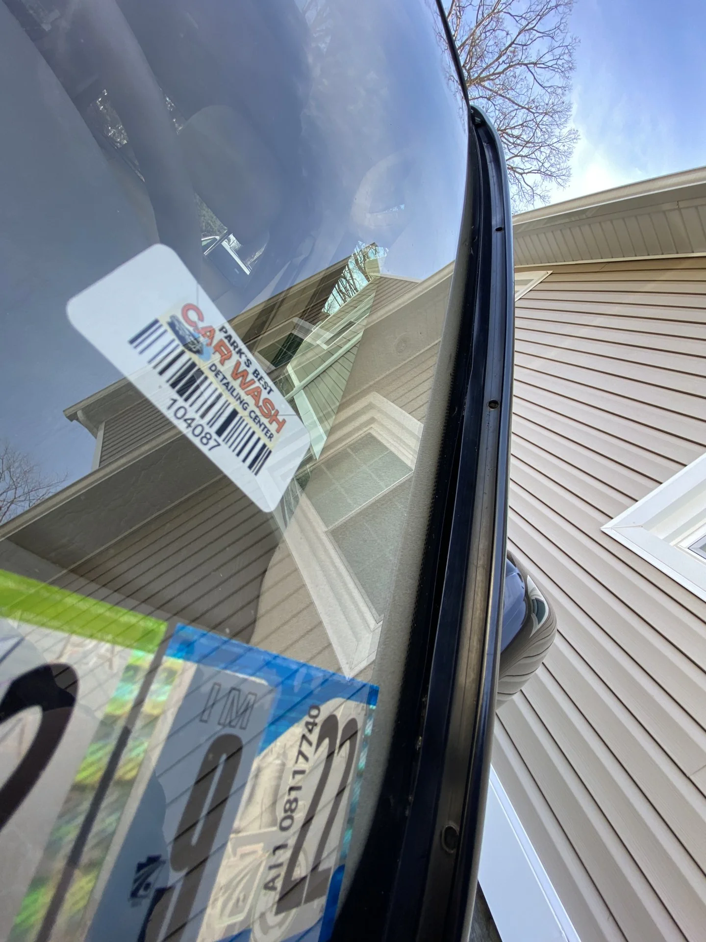

Passenger side is peeling away at the bottom, but the piece is fully intact, unlike the driver side...
Driver side "rain gutter" is broken at the bottom. This is where the most noise comes from.
Side note, the top of my windshield doesn't look great.
