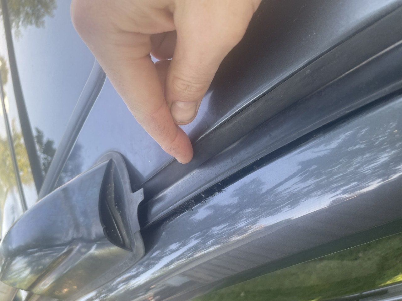

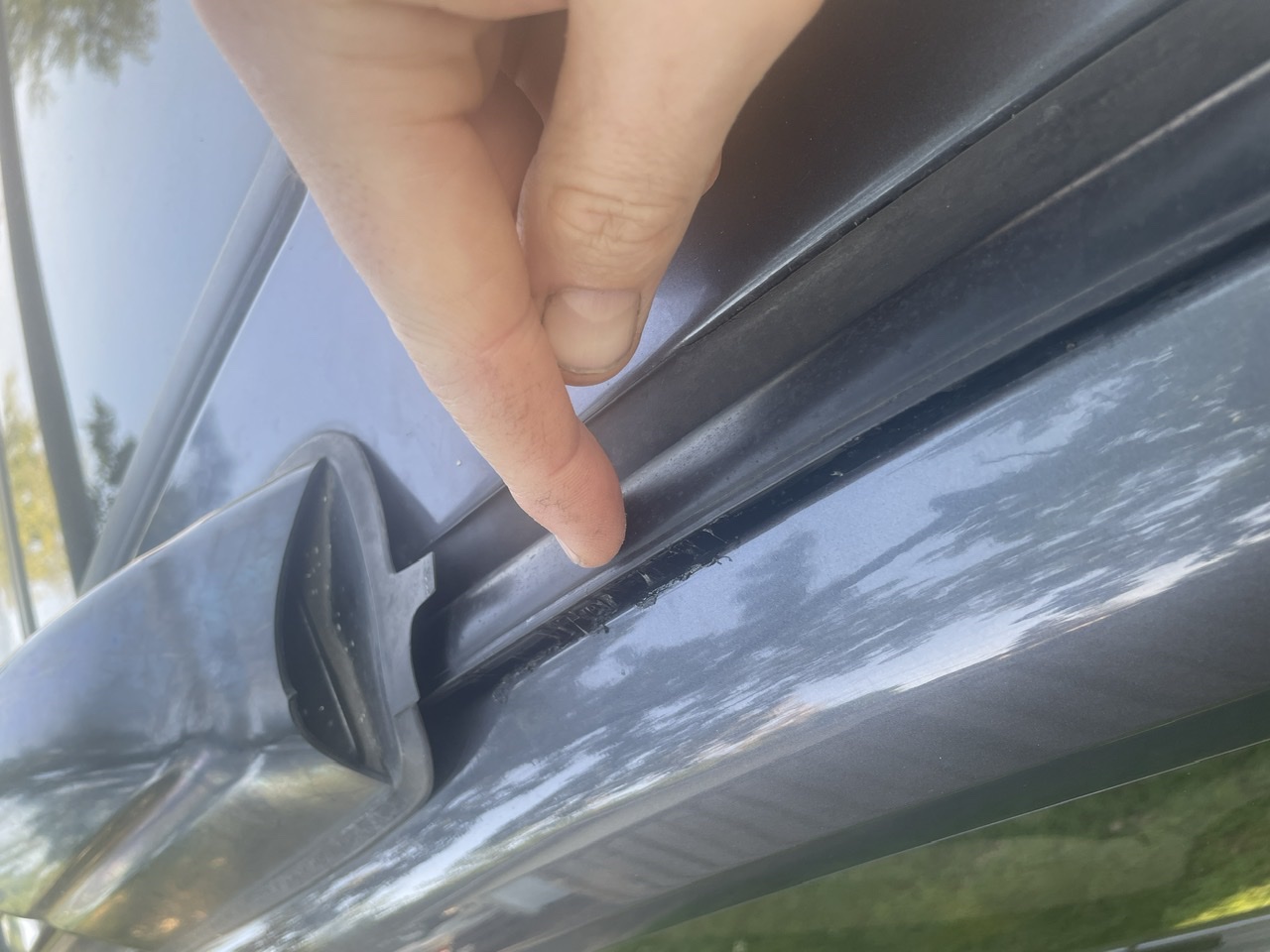

Went through this thread and I think I know the part numbers. Just need some help confirming before I drop money on them. I just bought this 100 series and noticed the passenger side moulding (weather stripping) was lifting up where it meets the roof rack end cap/cover.
It looks like the strip that sits in the inside of the channel is not fitting into the channel of the moulding (garnish?) that is riveted to the A pillar. This is the piece that seems to have gotten bent upward and no longer follows the natural curve of the roof line.
Trying to determine if I need to replace or if I can pry it out a bit more, apply some heat and bend/curve it back.
Thoughts?

You can definitely try that. I've had mixed success with a good cleaning and 3M Trim tape. Previous window installs had left a bunch of crap in the track, old tape, old silicone, old black rtv. Eventually got new window trim and the proper rivets and even the new trim had trouble staying down on one side.
Thanks. Does anyone know if water ingress will happen if I’m driving in rain with the weather strip like this? I read that the only point of ingress is the bolt holes for the roof racks. Curious if this is true or not.
