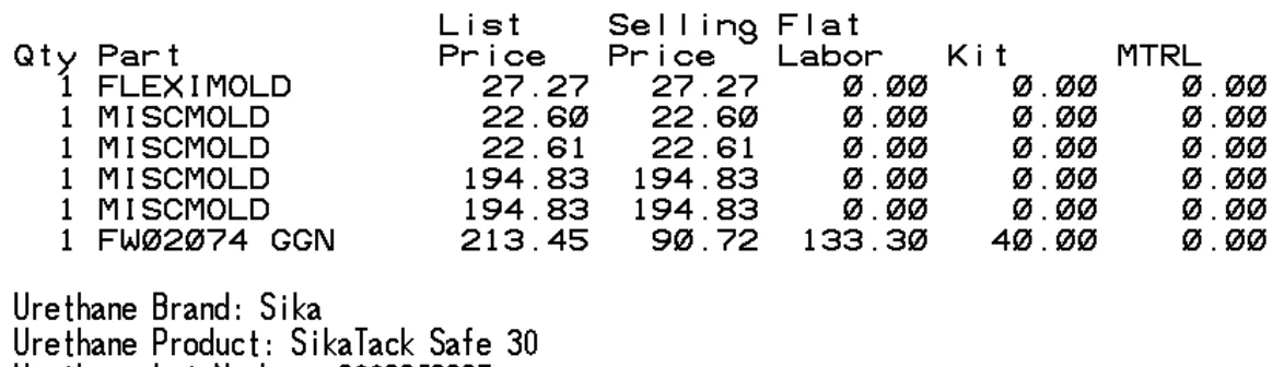

For what it’s worth, Safelite called and said Nationwide will cover the cost of the moldings. They arrive in a couple days.
Happy to say that Safelite successfully billed my insurance company the full >$700 for the windshield and all of the moldings. They also supposedly riveted them back in as well. The first windshield arrived at the shop but it had a minor "wavy" blemish in it, which they noticed before the install and basically asked me "is it ok if we order you another windshield, even though it's going to take 3 hours?". They paid to Uber me 15 mins back to my house while they sourced a non-defective windshield and then paid to Uber me back to the shop.
Windshield looks great, no issues so far. They have a guarantee against leaks, so that it yet to be determined. But overall, I would definitely recommend Safelite in Durham. They even tightened up the wobbly-ass rearview mirror that was driving me crazy. Keep in mind, I drove to their shop rather than have someone come to my house. I did this on purpose because I know the LC/LX can be challenging so I wanted to ensure they had all the resources they needed on hand.
I took a screenshot of the receipt just in case it helps anyone in the future when referencing parts cost.
