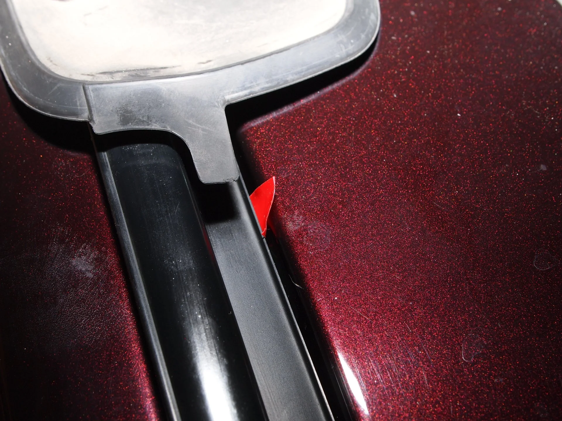

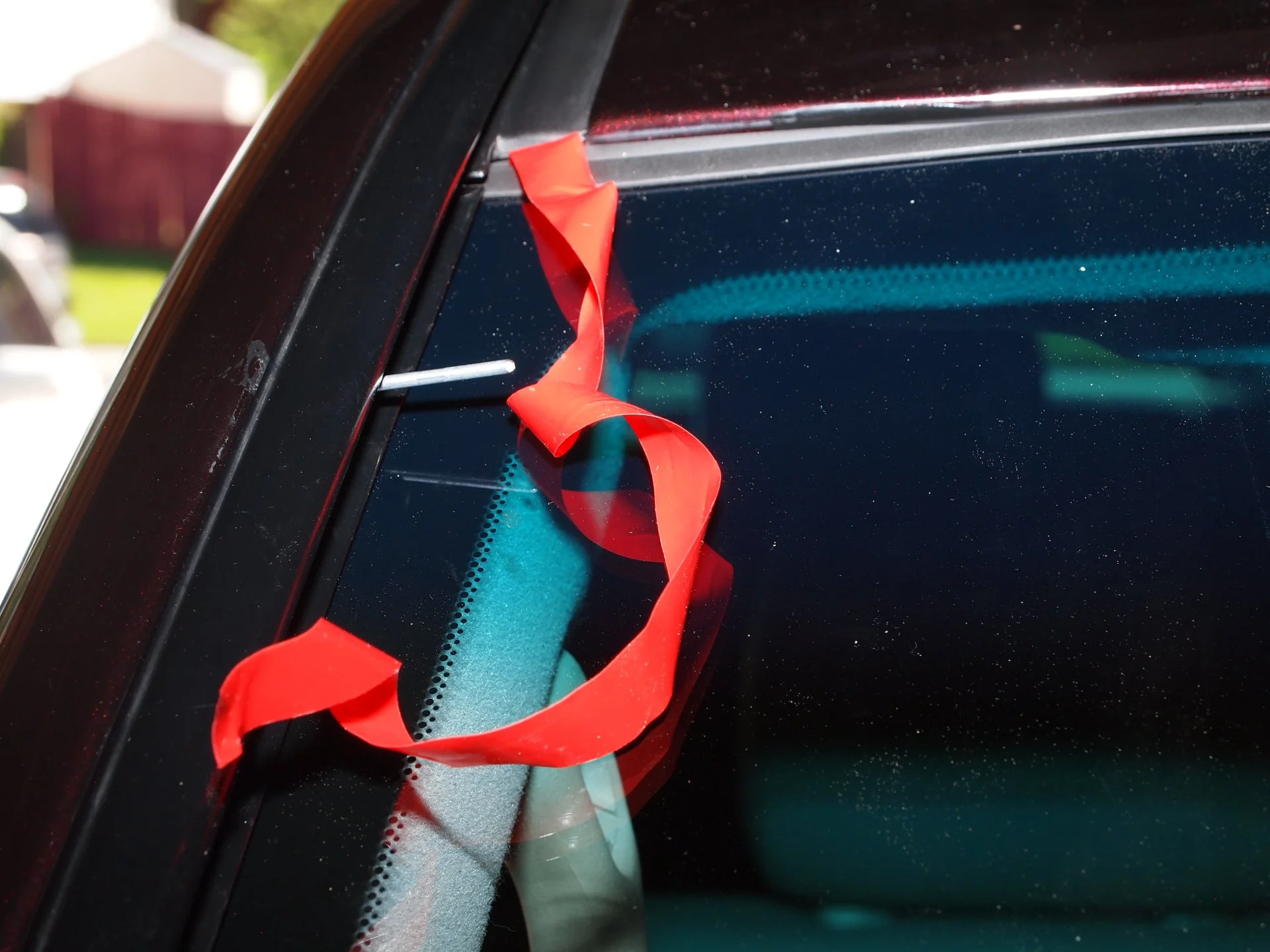

Tips:
To install exterior side molding, lining up easy, fast and perfect ever time (even in the dark shadows of a shop):
  • Install side molding, before bottom molding.
  • Do not remove backing from double side tape yet. Just peal back a corner, creating a tab to grab later. Place molding in position and place in a rivet or all 4. You can set a or all rivet(s) at this point or not. I do not set rivets yet. I just use them to center molding. Than once rivets in place centering molding. I grab the little tab of tape backing and pull off as I press down on molding, sticking down tape to body. I then set rivets which i do last, just in case issue with tape. I use corrugated cardboard to protect glass from rivet tool shock or scratches. As I fear shock would otherwise transfer into glass and fracture it.
Double sided tape backing tab, sticking out just enough to grab after alignment of molding with rivets.
Tab pulled from tape tape, rivet not set as you can see it's shaft stick out. Perfect alignment every time and fast
