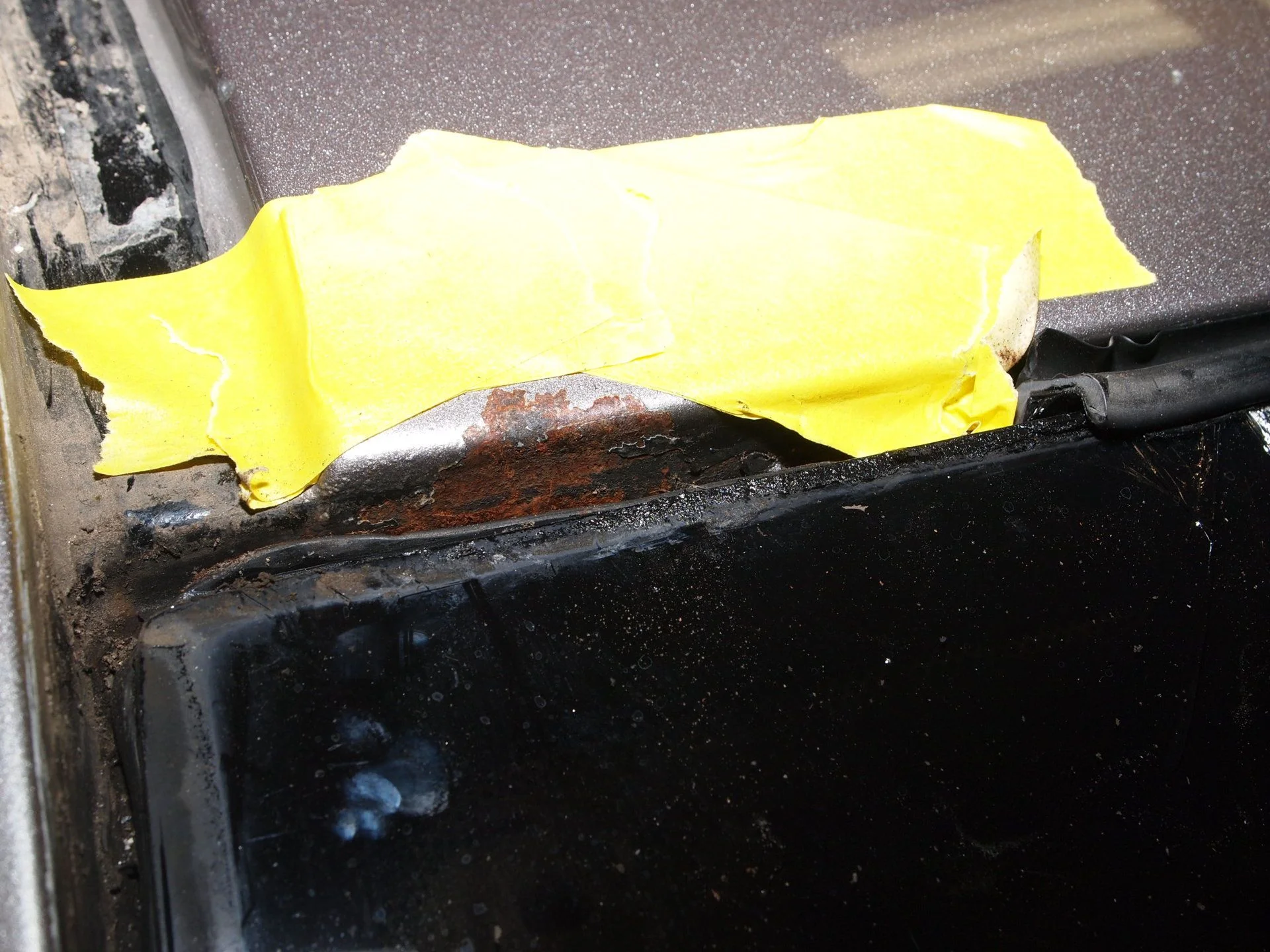

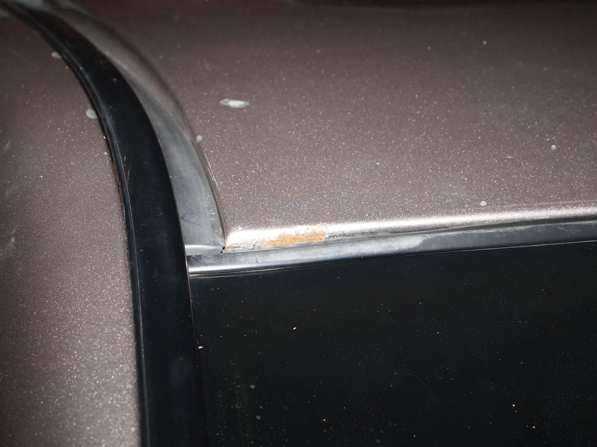

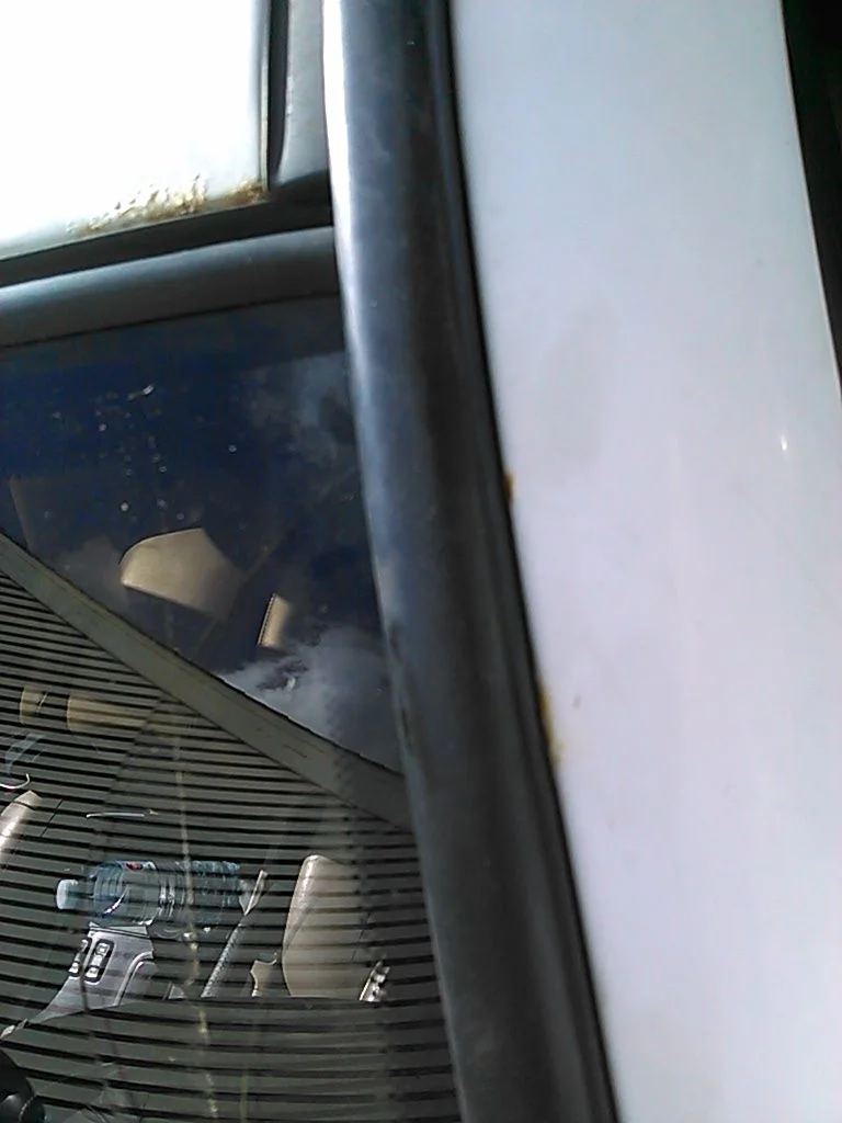

But first before new owner take delivery, I wanted to take care of a tiny spot of paint bubbling (rust sign) above windshield on The King. I didn't want it going out of here with a potential problem in the making.
First year I noticed:
A year or two year later:

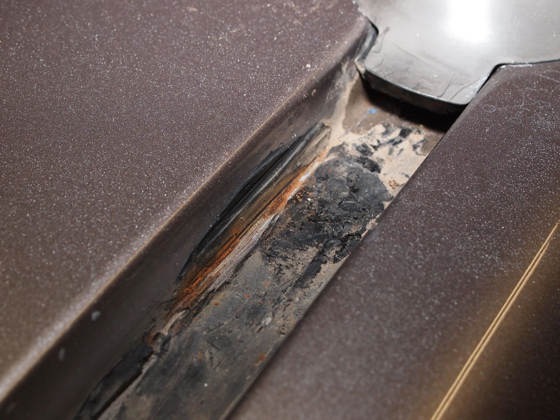

I scraped the bubbling paint away to see what I'm dealing with:
The windshield is and issues in the 100 series. If any paint bubbling seen, even the tiniest spec if found around windshield you can bet rust is starting to take hold under molding/windshield. The sooner you address the less damage to deal with.
I took mine to a body shop and they said it's not bad enough to deal with,,,wrong. Although rust did not perforate metal "yet" it did leave some pitting once ground out.
Obviously the older the rig the more chance of rust. But it seems this is less of and issue after 2005. I say this not due to age, which obviously plays a roll, but Toyota may have made some adjustment to the manufacturing process. Toyota settled a "rust" class action that only 2005 and up can make a claim from what I've heard. I've notice bare metal chips in paint on the 2006 & 2007 models, don't seem to develop rust as fast as older models. This makes me think Toyota legal team navigated the cut off date carefully.
The argument of why we have windshield rust issue is two sided. One side says it windshield installers, the other states it a design issue. To date, I've only seen in windshield that have been replaced. It's not to say factory installs don't have any issue. It just what I'm seeing is installer nicks paint during removing of urethane with a razor blade. The body has some bump out along roof line under windshield molding and tight spaces along sides and roof line. Any nick not treated, no matter how small, will start the rusting process.
Newer vehicles have been design more open and flat under windshield and around molding. They also have less molding. This make windshield removal easier and less like to be nicked. So design was changed. So do we have a design issue, yes in this respect.
The another design issue has to due with three things: The metal, paint and design. Does the 100 series lend itself to rust around/under windshield organically, perhaps. If those here in mud that have factory windshield report issues with rust or without we would then have data points to gain a better understanding.

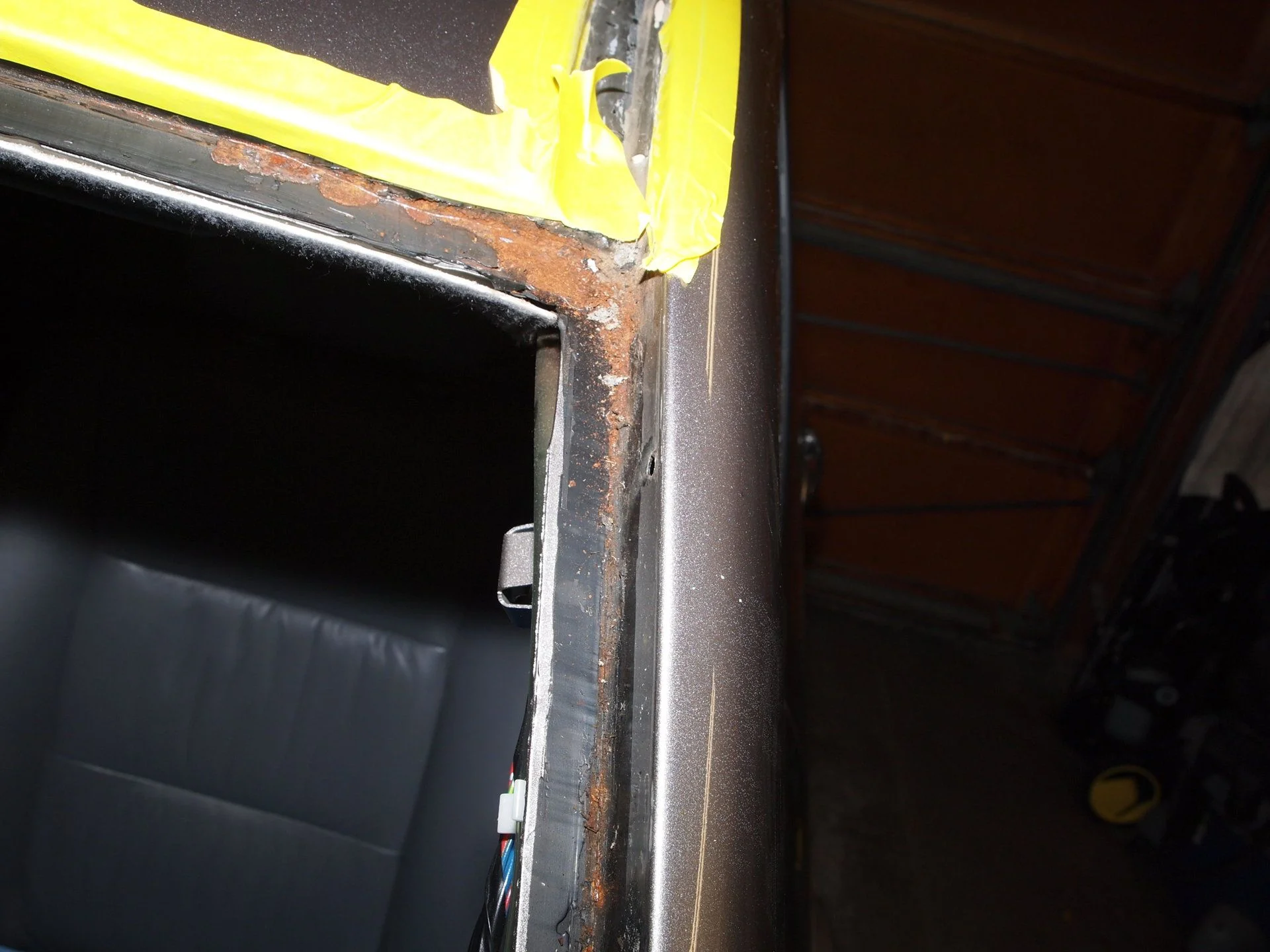

You havnt seen anything yet. Yank that windshield pronto and then tell us what you see. That is classic example of an inexperienced windshield installer scratching the pinch weld and it creeping up under the molding after he refused to use primer during the install.
Always remember rust is cancer. Find the source and attempt to eradicate.

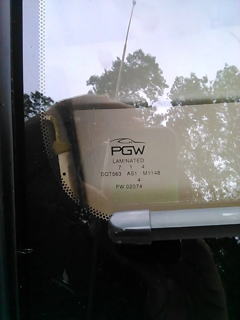

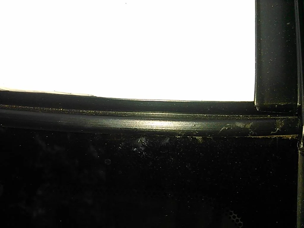

Can you post a picture of the glass DOT bug on the right lower.
Sorry don't think I have one of DOT around, if I find I'll post for you.

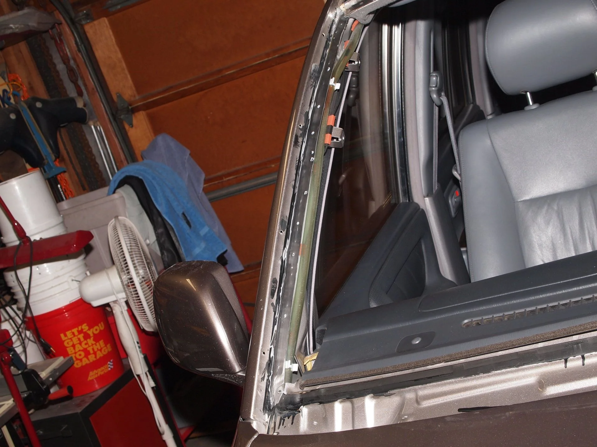

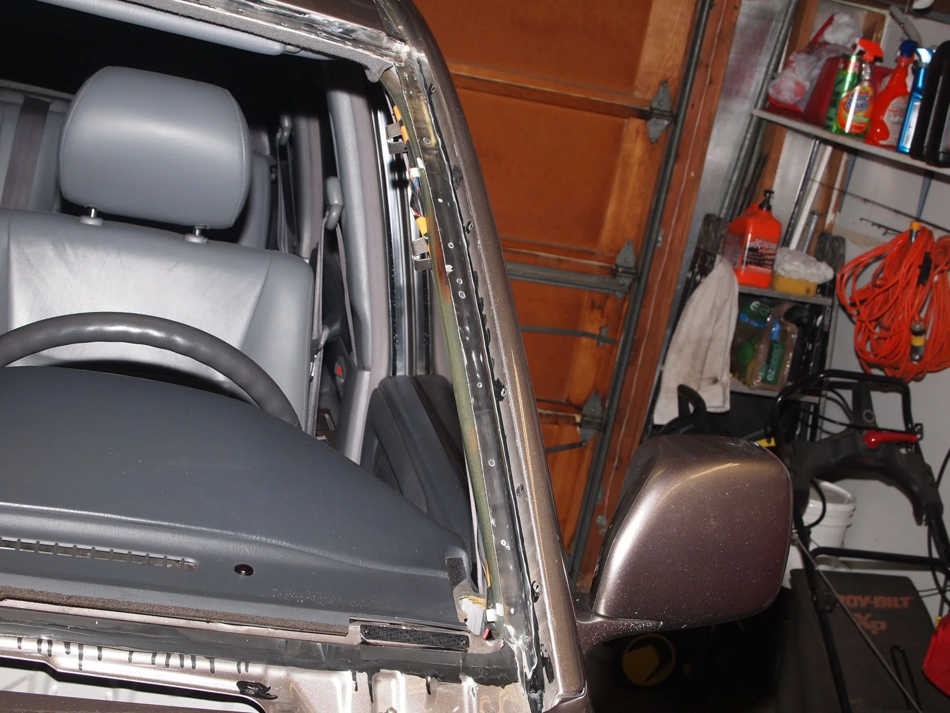

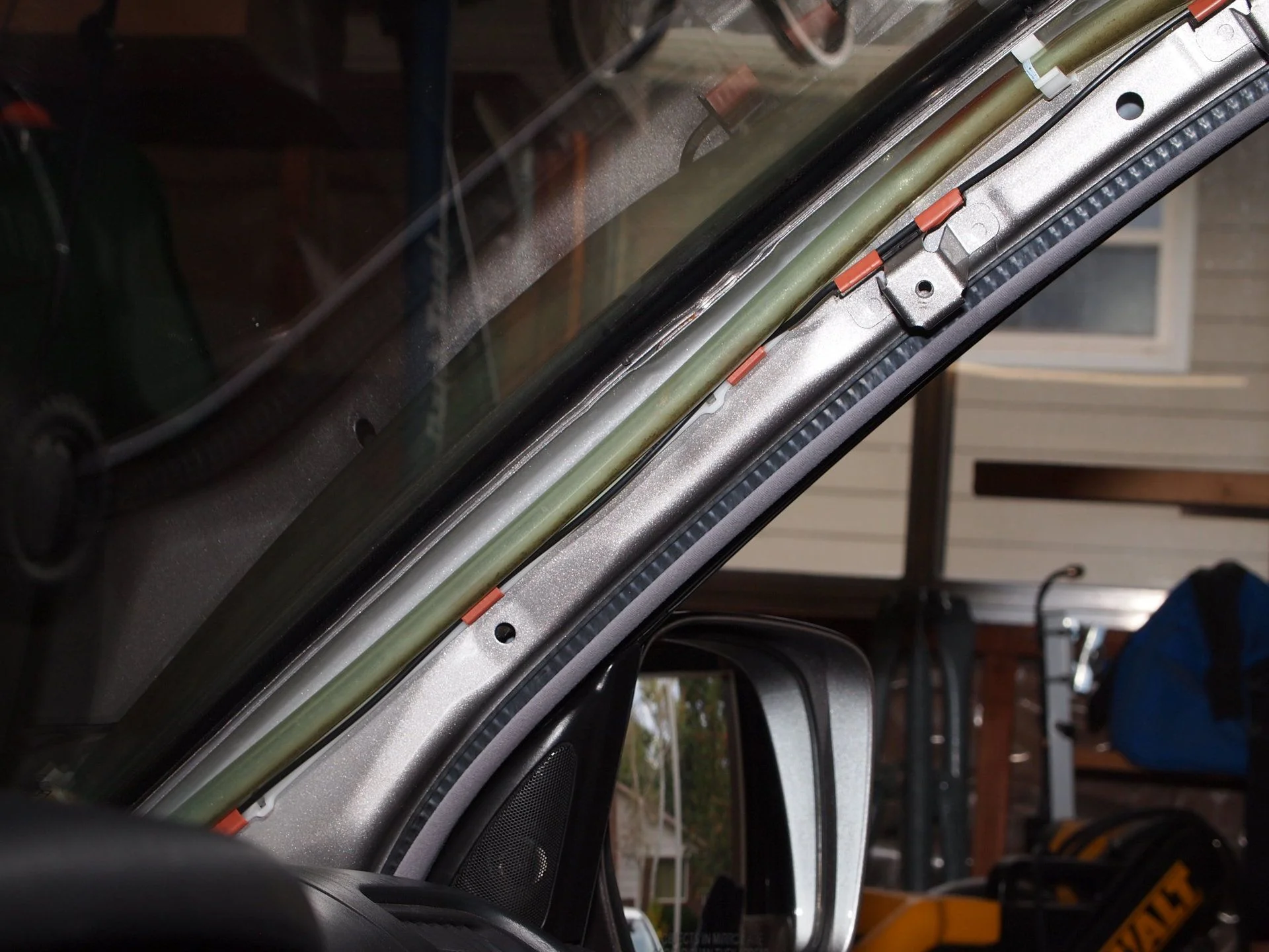

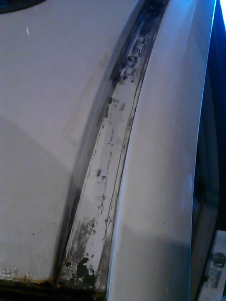

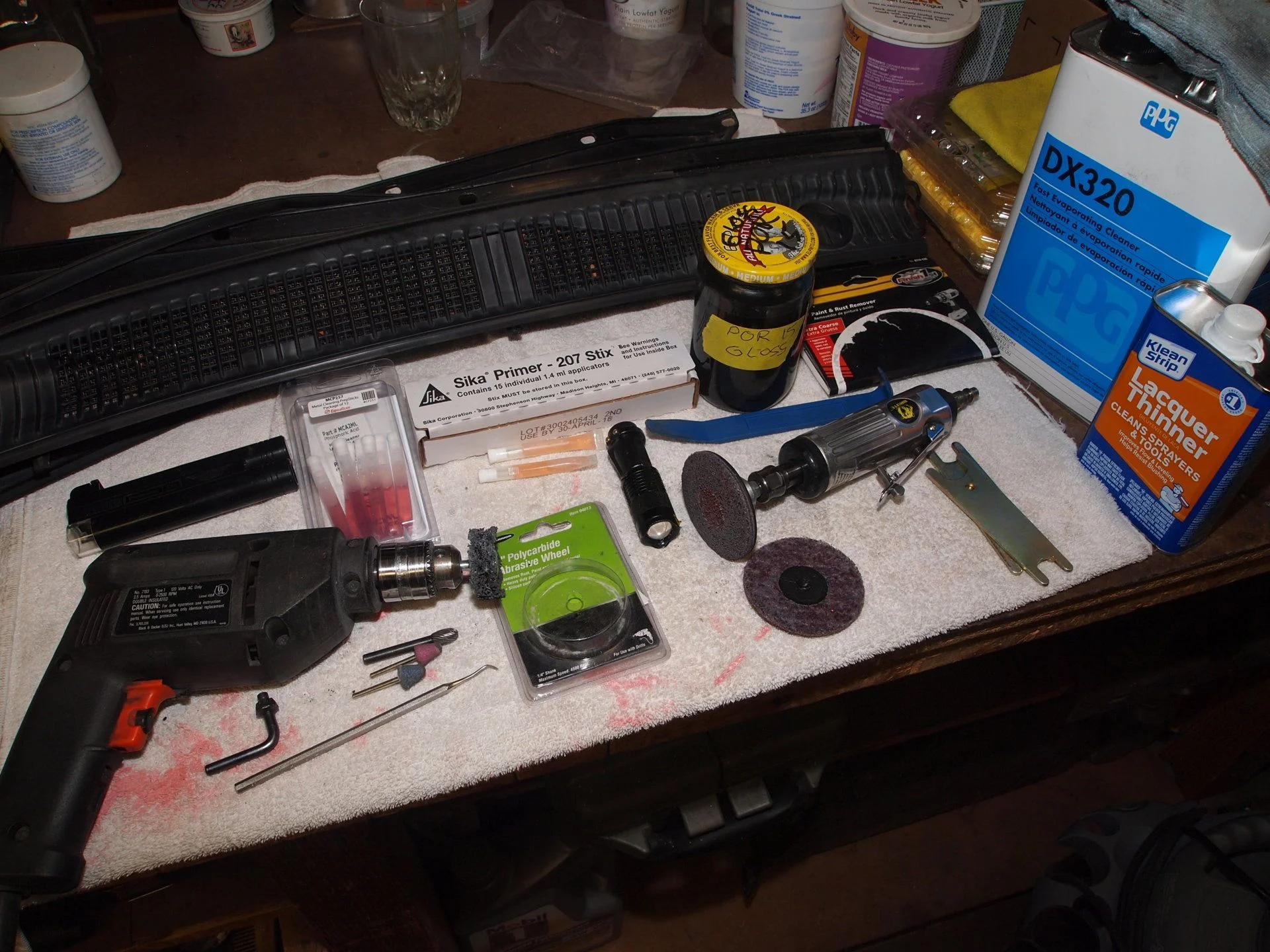

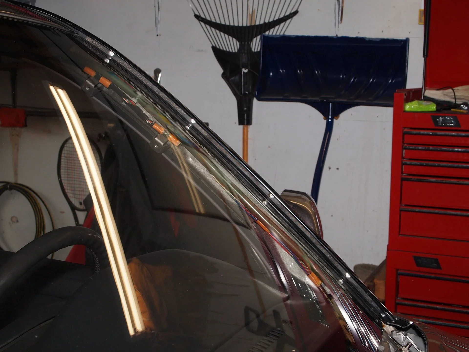

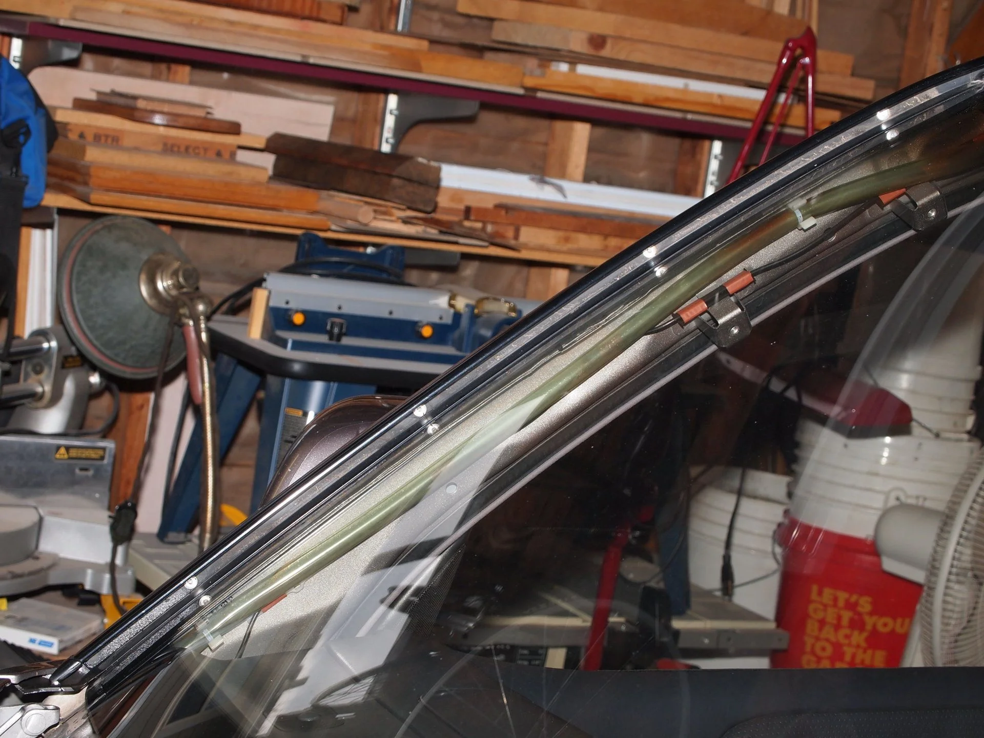

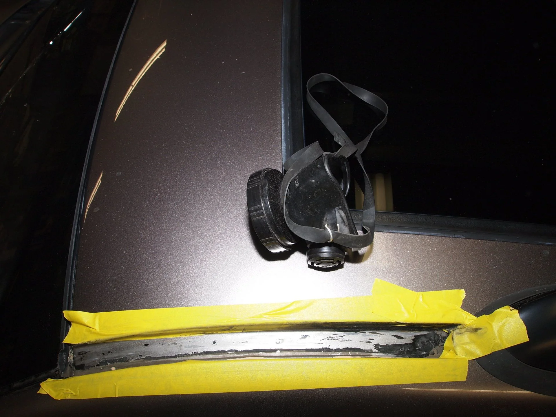

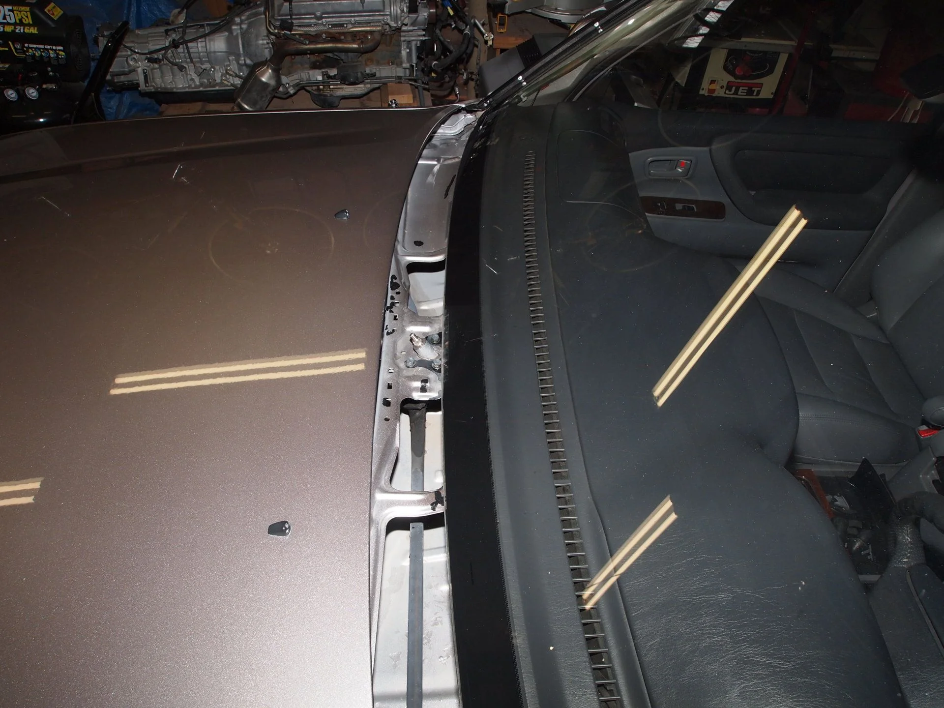

First I pulled the molding. Installers tend to run drill through molding, I like to just drill out head of rivet. So I removed side molding and cleaned up the urethane used to hold down the molding in the rain gutter (RG). I will never allow that urethane again to hold molding down in RG. The stuff is a pain to remove, and must be removed to go back to proper install with two side tape. I also like to remove inside molding and lower molding in prep for installer. They like to see me coming.

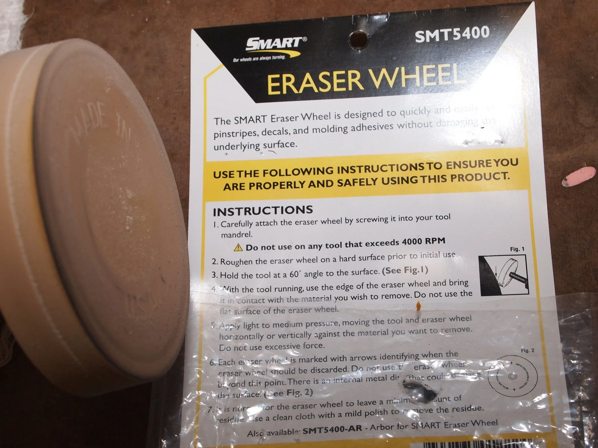

I use and eraser wheel to get heavy urethane out of rain gutter. This particular wheel is not my favorite, as only the outer edge is working surface.

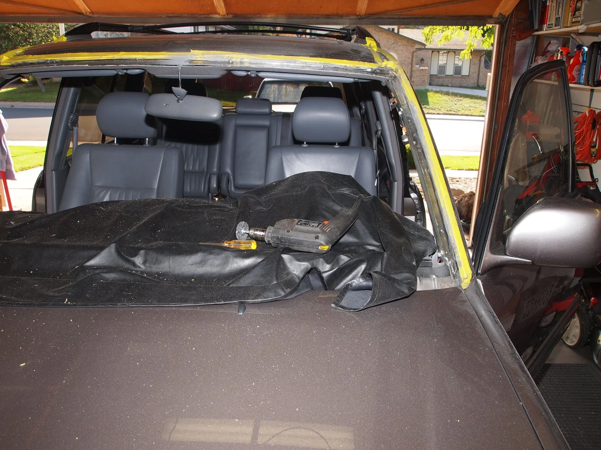

So now I'm ready for install, or should I say windshield remover:
I wish I had you do my last windshield. They claimed the rivet holes were "oblonged" so decided to urethane the side mouldings on. This was after they attempted to pop rivet them back on and chip the glass.
The 100 definitely requires a skilled installer.
I never thought to try a stripe eraser for removing urethane! I know they work magic on body side moulding double sided tape and pin stripes.

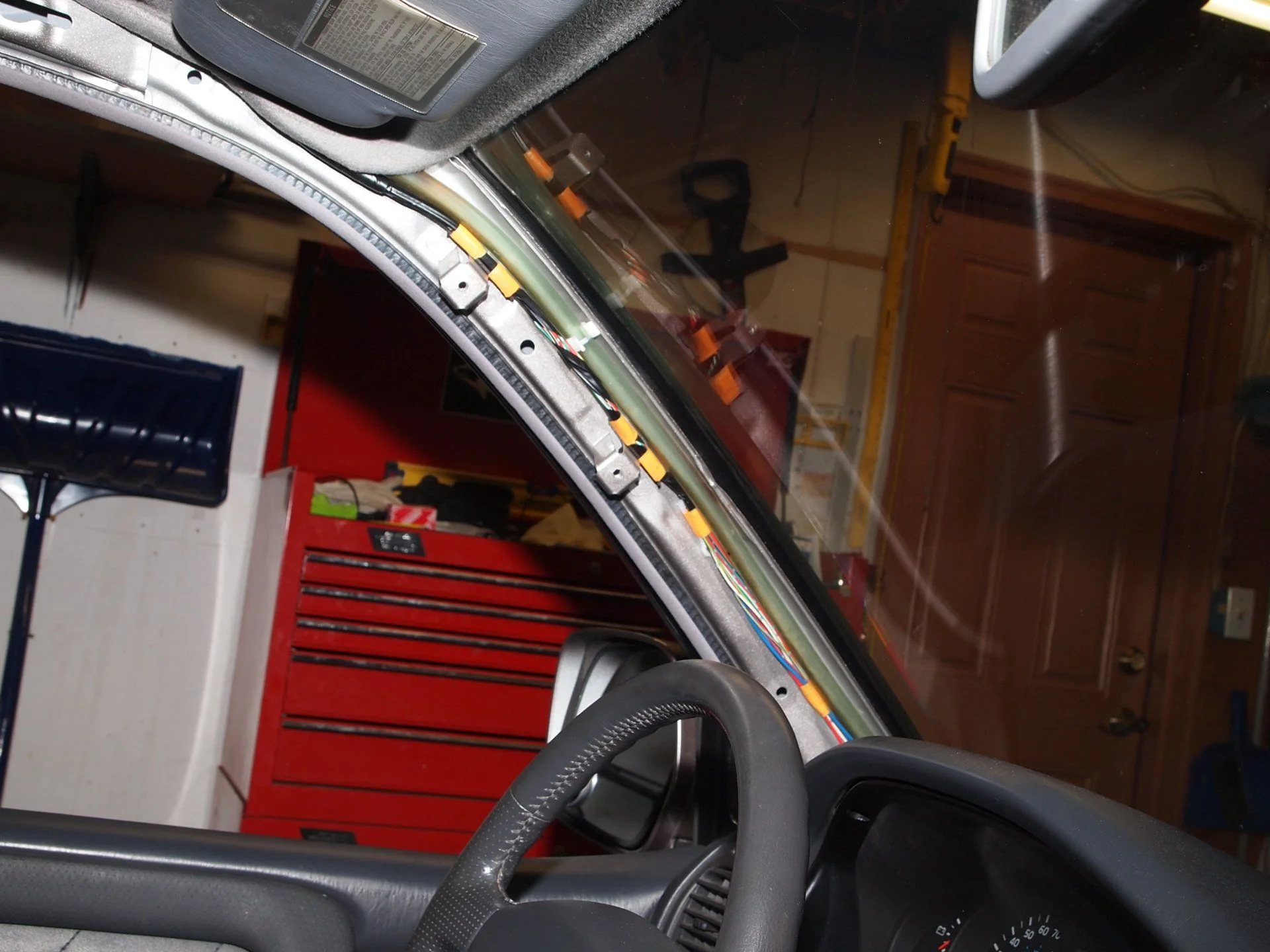

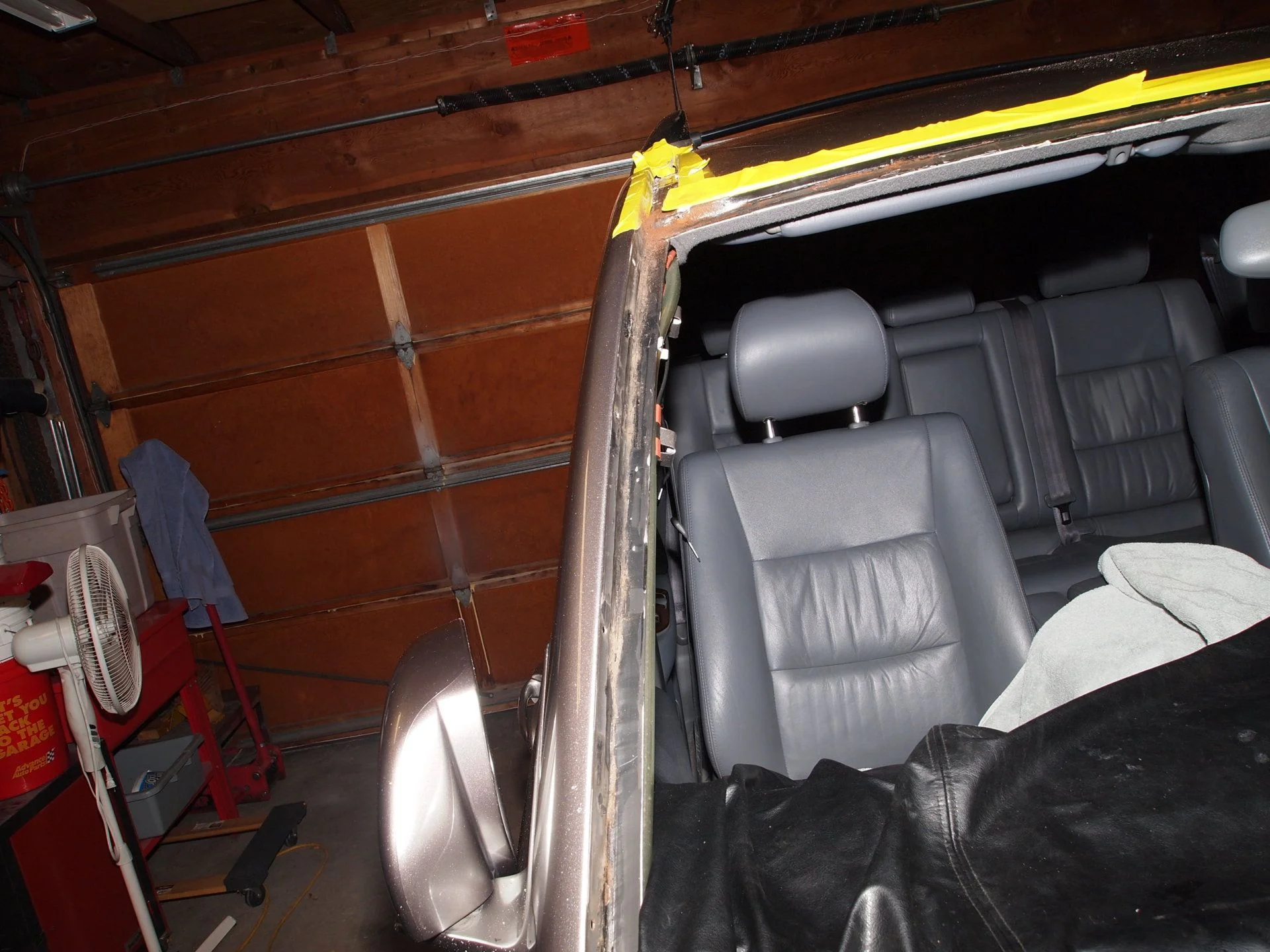

I was hopeful installer could get job done, but he only had a cordless drill and wire wheel. So I sent him off. He'd waste to much of his time and wire will glaze over the rust, making hard to see. I then went up to the safelite shop and they gave me some sweet rust removers wheels. I'd seen them use these wheels before with air tools. They know me as the Land Cruiser guy, so had no problem with me doing the prep job with their air tool attachments, It's my third windshield in a year. When I come in with molding removed, they don't mind so much it's a Land Cruiser, normal they don't like to see a Land Cruisers coming in. They know it going to take hours and they'll have to deal with rust most times. In fact if they see a crack glass coming from a rust spot, they will not take until it's gone to body shop.
Note: The Sika 207, was used on glass as black poly adhesion promoter by installer..
Edited 4/22/25 :
I did not use the POR-15 cleaner degreaser. I used DX320 paint wax & oil remover. Used the phosphoric acid for 3 mins, seen below in vials. Rather than the POR- Metal Prep (milder phosphoric acid) for 30 minutes/wet. One or both, may have been a critical error. Or perhaps, surface not scratch enough, by polycabide wheel.

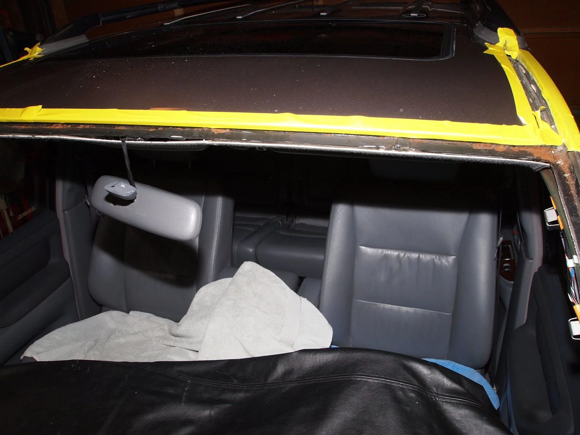

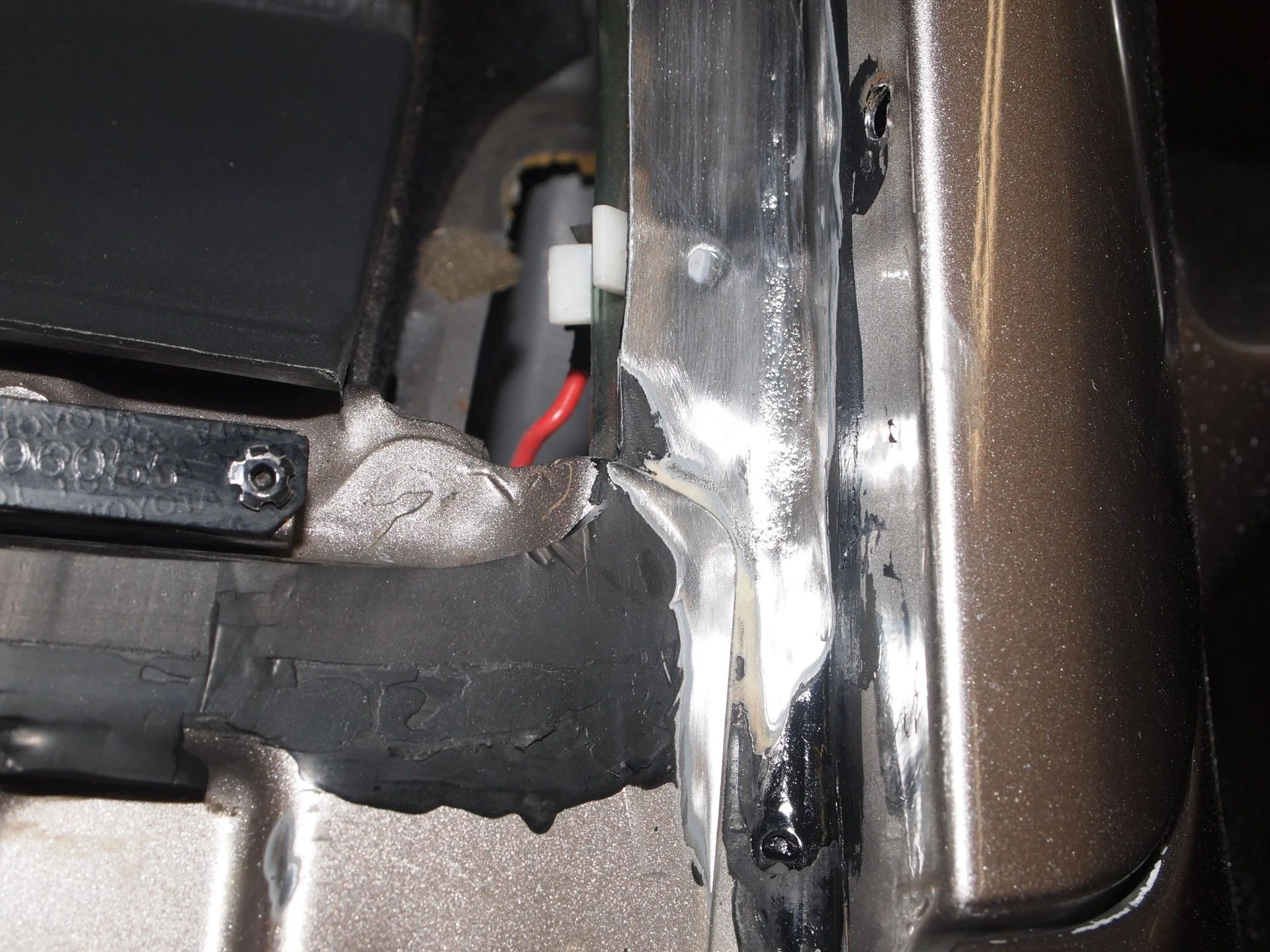

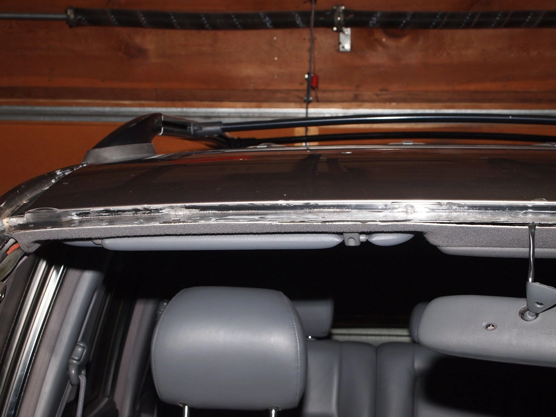

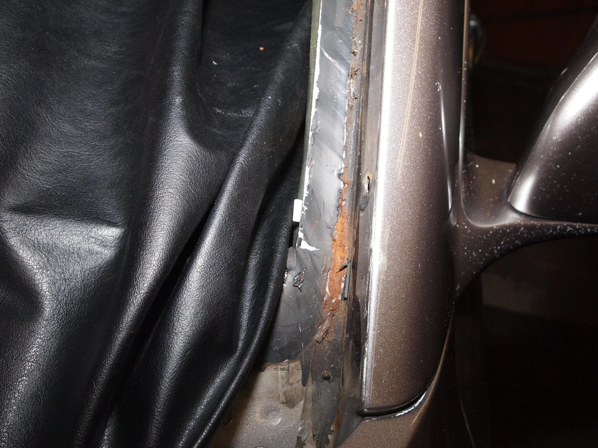

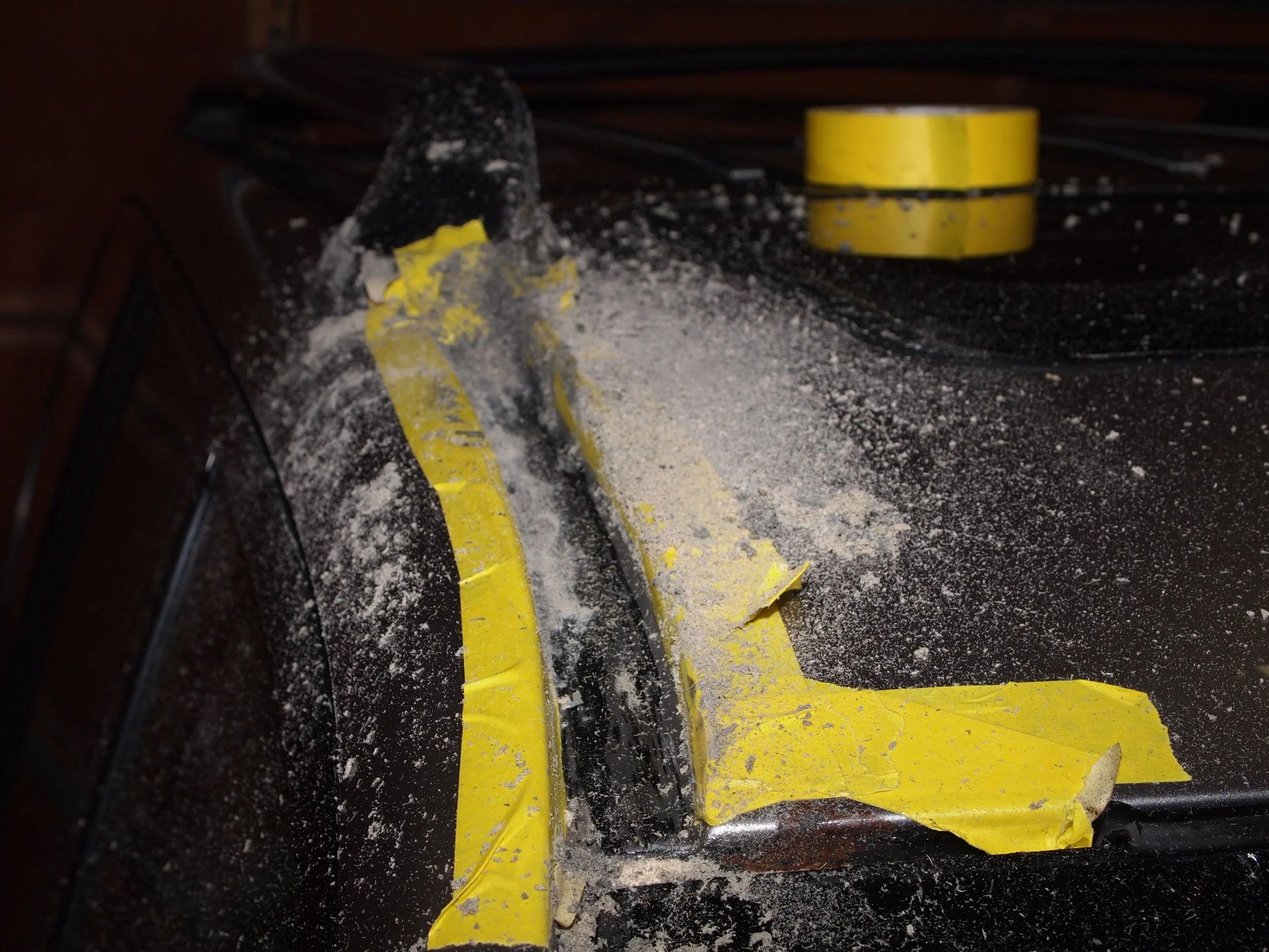

I use a small stone bit for getting into corners and tight spots, like the bump outs molded in for strength along the roof line. These spot are targets for the installers blade. As they cut off the old urethane they nick these spot and others. That is leading cause of rust IMHO, installer nicks.

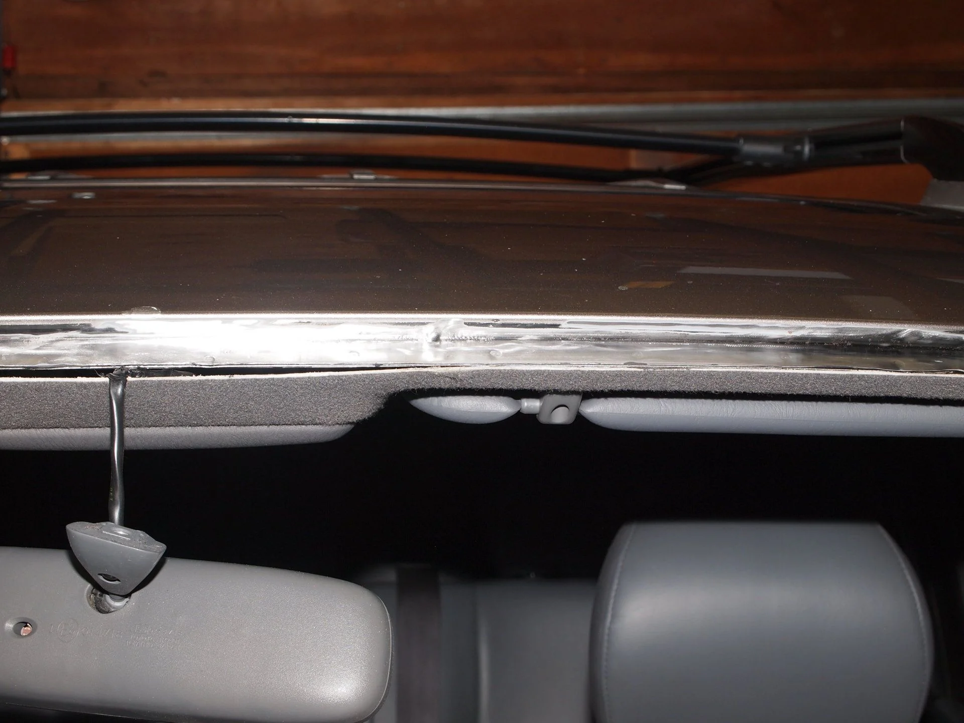

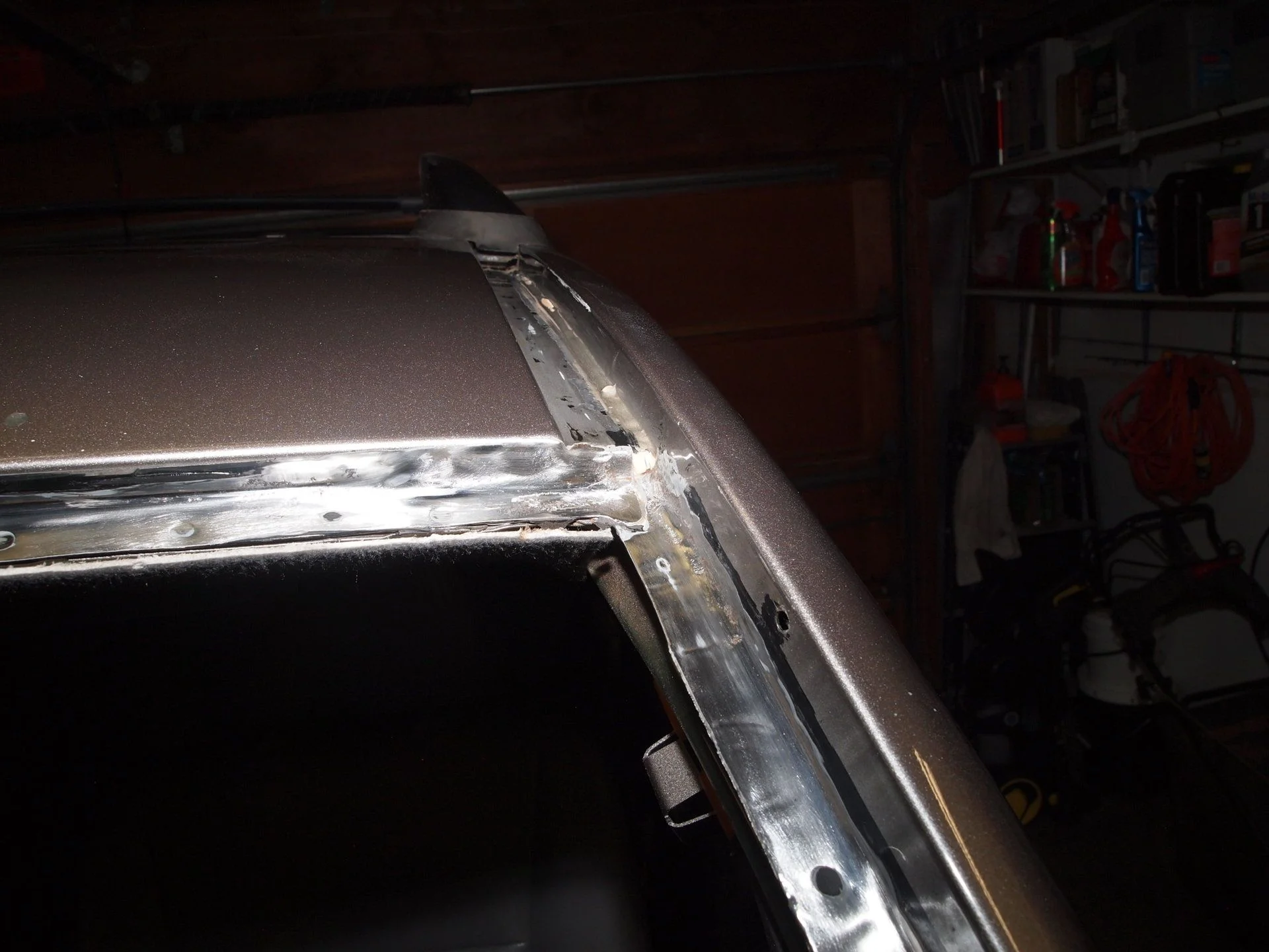

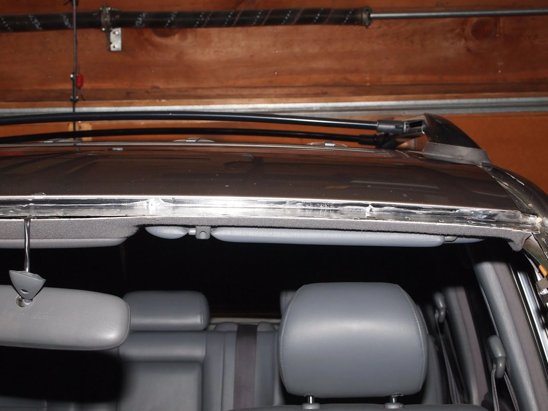

I ended up removing all urethane from all sides. I wanted to get a good look at metal and have good clean surface for painting.

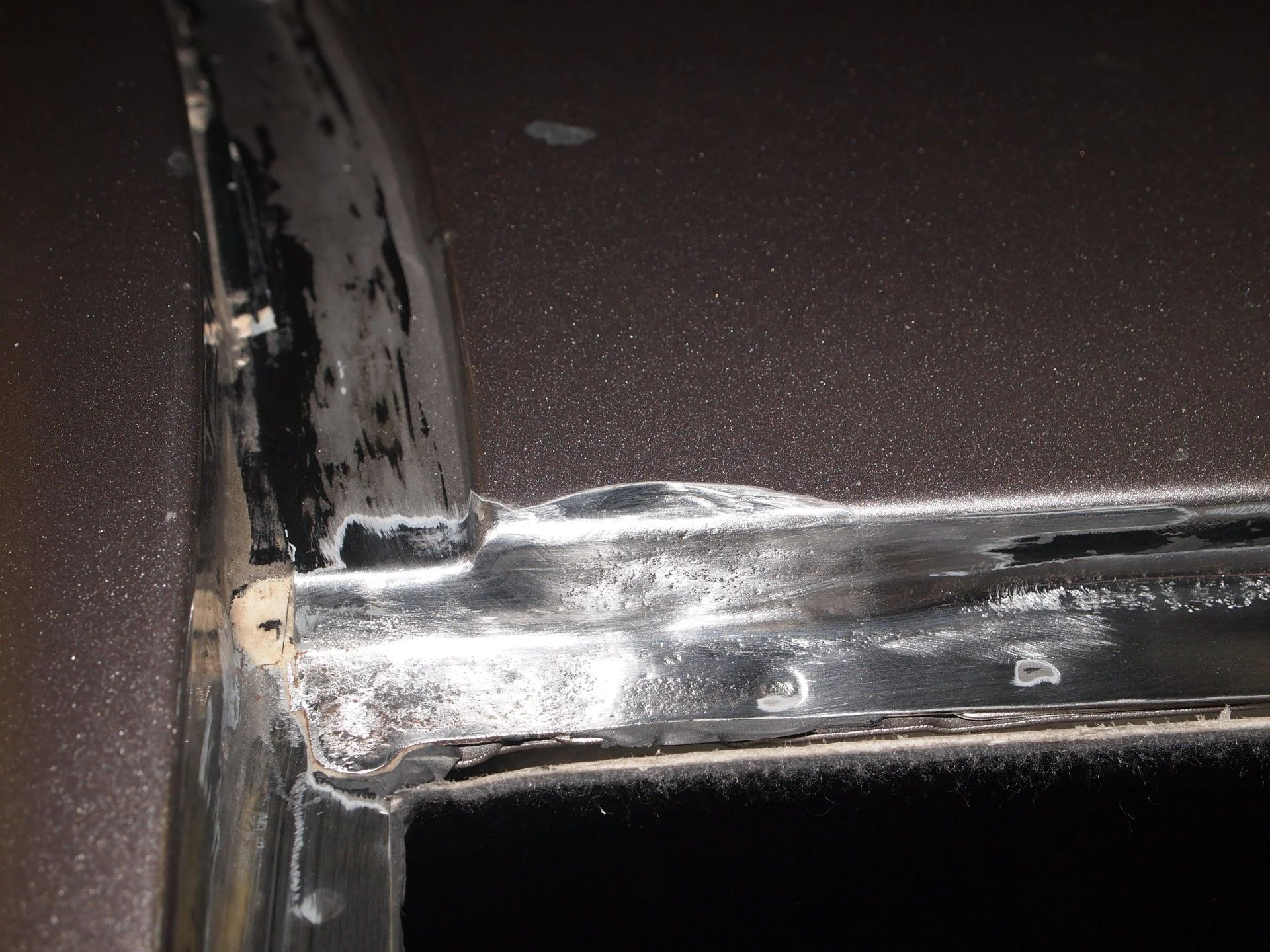

I think I got it all, "rust" that is, it really wasn't to bad. Some minor pitting, but no perforation. I'll go back at it tomorrow when I'm rested, keeps me from short cutting. I'll remove any small spot before I chemically treat in prep for painting. I'm also going to sleep on my thoughts on how to proceed. My current think is; use the POR-15, then come back with black auto paint upper half along roof line for UV protection of exposed areas, then Safelite supplied Sika 207 Stix primer for improved urethane adhesion on lower half under the glass. I'll call Por-15 and Sika to ask about compatibility, I'm hoping for positive response.

I used turtle wax sticker removal with blue shop rag to get the remaining goop from prior installer.
Here is the dot stamp and some other pics. Going to do a writeup on it when I have time.
Next windshield I am going to prep and setup for the installer inside and out. What a nightmare I dealt with, I will try and post pictures as well, although I believe I have posted under windshield install in other threads previously.
I used the Eraser wheel in rain gutter, where I want to keep factory paint. I have had the Erase pull paint also, so learn to use sparingly. I'll go back over today with plastic scraper and 3m adhesive remover to get a very good surface for tape of molding.
Under windshield I used the thicker rust/paint remover on the drill. I also triple tape the areas around my target area.

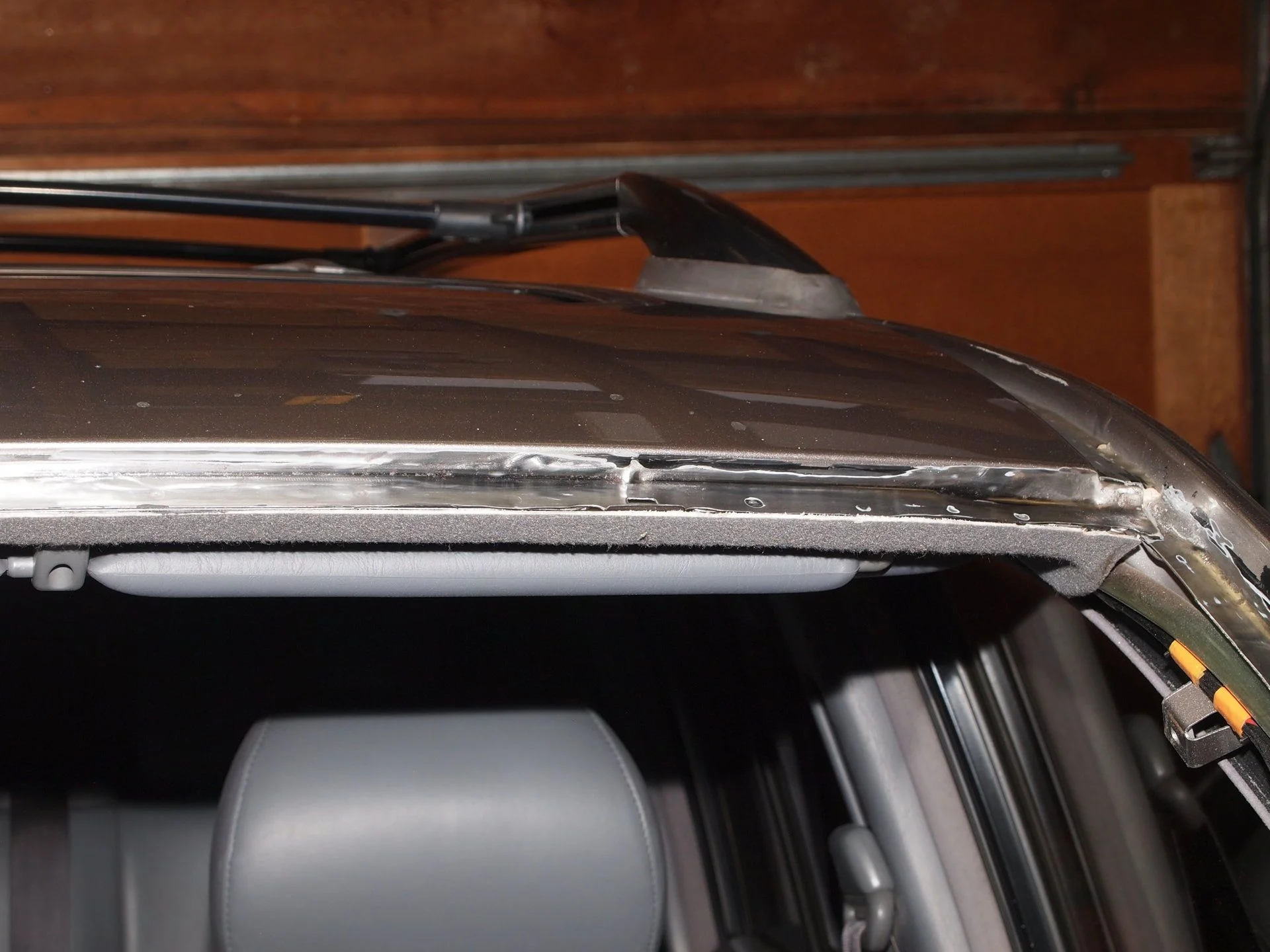

I see i didn't give any good picture of rust, so here are few before and after. Looks worst then it is.
