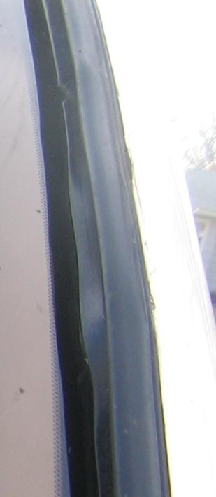

I did a close inspection of the windshield and I think mine is installed wrong. It is an aftermarket windshield that the PO had installed. This is what the outside of it looks like. Now I do not know anything about windshield installation, but this just does not look right to me:
The rubber strip is all warped - is that the weather strip? Could this be what is giving me all the windnoise in high speeds? Does this warrant a reinstall or just an adjustment of this strip? Ideas?

Any ideas on whether the weather strip install in the previous post looks wrong or is a non-factor as far as wind noise is concerned?
Your windshield install is definitely wrong. There is a raised, rigid mouling w/ rivets underneath , no flap of rubber.
Damn they screwed that up

It seems like the turbulence caused by the sloopy install is what is giving me the wind noise. At the very least, that is. There might be more wrong with it. So again, like yours - a sloppy install.
