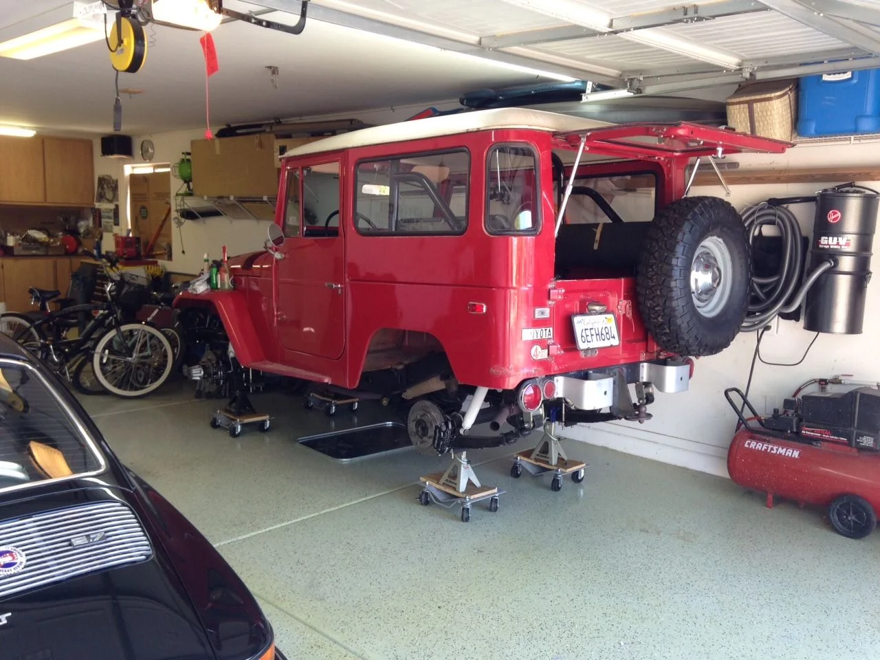

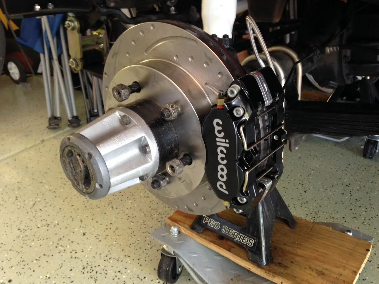

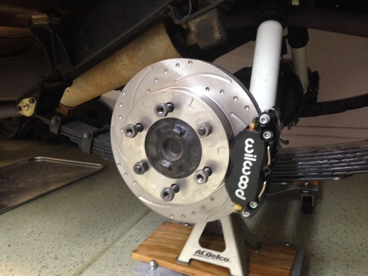

Hello everyone... am a newbie to this site and I wanted to post some pictures of my Wilwood 4 piston conversion. I did both front and back conversions. I purchased the kit from TSM brakes. It was a complete kit except after I was finished I had a small problem....My stock wheels hit the new Calipers. I need a 3/8" spacer and longer wheel studs. I found 2" wheel studs though Summit racing and they will be here Wednesday. I will post pictures once I install them.

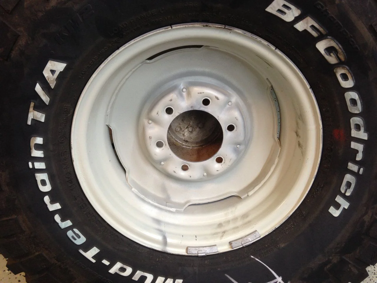

Yes... I tried them on both front and back, They hit both.... I ran the lug nut all the way down to the rotor and then the wheel
cleared the caliper but I have only Two threads showing. I took a square and measured across the face of the rotor and 3/8".. I think a 1/2" spacer will do the trick.

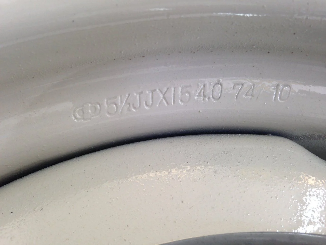

Here is a picture the wheels mounted on but cannot get the lug nut on all the way.

Huh... I wonder if they made early Welded wheels and later ones...I will do some research... I want to thank you guys for all your help.
if I can buy later wheels that will work, I will. I want to keep the FJ as stock looking as possible.. even though Wilwood brakes are far from Stock, my wife will be driving her, along with my Two daughters... I would rather have safety than factory correctness. The FJ is not heading to a museum, just maybe to a local car show, or to pick up a 6 pack of beer.:)

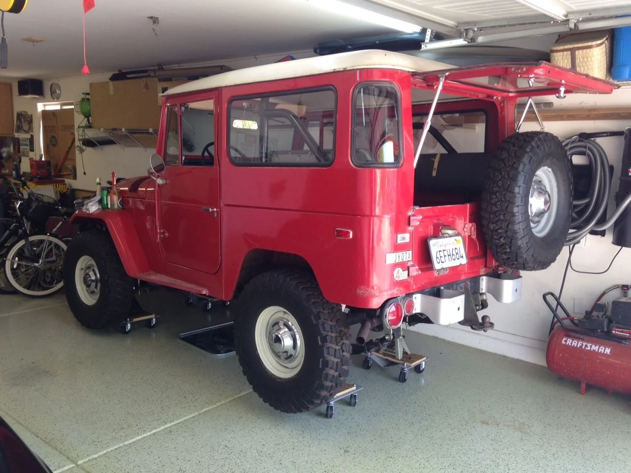

Does anyone else think the 4 jack stands on wheel carts is a bad idea? Safety check...
