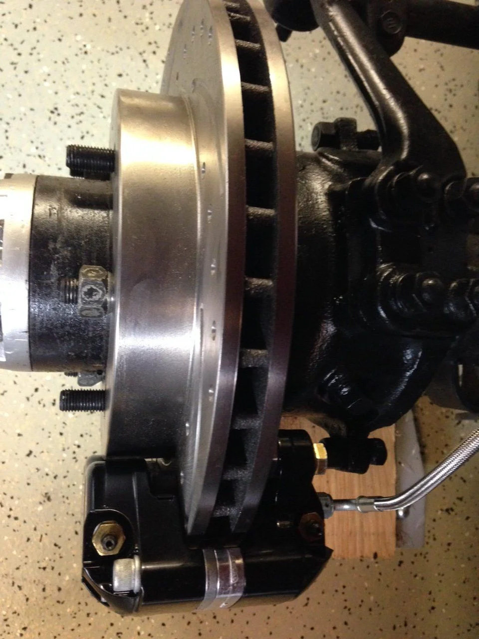

JohnnyC..... Well I'm glad I purchased the correct wheels. The FJ came originally with riveted wheels but I found a used set of welded wheels online, knowing that I was planning to upgrade the brakes some day. I was a little worried I bought the wrong ones. thanks for confirming that I had the right ones.

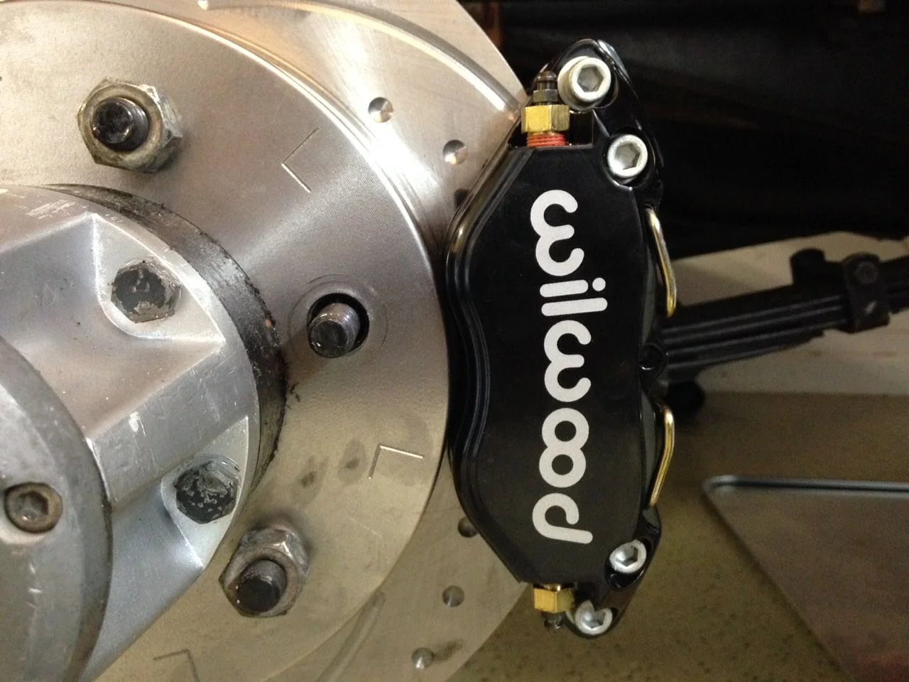

I think the rotor is a little thicker where it mounts to the axle and hub than the stock drums and now the caliper is upper close to the rotors.
I have attached a few pictures why I think the wheel is hitting the Caliper... The Caliper is an 1/8" from the rotor and sticks out past the rotor face by 3/8".
So I'm hoping the longer wheel studs and the 5/16" spacer will solve my problem. The only draw back I can see is the tires will stick out almost a 1/2" further. I'm hoping it's something I can live with.

Spacers should do the trick, I've been running 1/4" spacers for 22 years in the front and 17 in the rear with no problems. FYI, I found studs that were longer to use for my rear conversion from a mid 90s Land cruiser. I'm not sure which year as I brought in a Chevy stud that was the right size from the donor truck and the parts guy at Toyota brought back 12 Landcruiser studs that were almost the same... Just the correct thread. It was about 17 years ago, so I'd start looking around 95.
The ones I bought from Summit Racing, the guy said they were for a Ford.
Everything was correct except the threads.. I had to buy all new lug nuts.
Will see how they work when they come in tomorrow.
