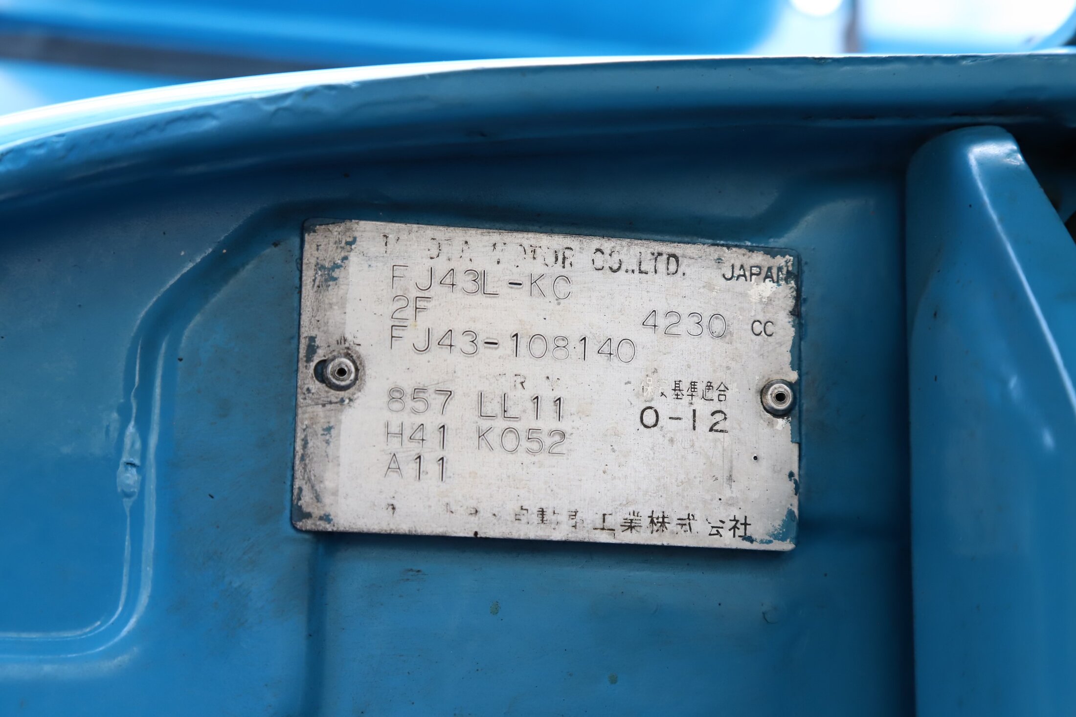

Thanks boss! I will get some pictures of the drivetrain today. Here is the badge on the firewall. If you could introduce me to your wizard that would be great.
FJ43L-KC
F = six cylinder petrol engine
J = Land Cruiser
4 = 40 series
3 = mid wheel base
L = Left hand drive
K = four speed transmission
C = ambulance doors on the back. Because there was no V after L which would be a hard top the back doors would be two piece with removable vinyl covered top half. The current top was made locally in South America (most likely Columbia). If Toyota made deal to deliver these without the back doors, bows and vinyl I don't know. If they were all there originally there would have been a lot of them somewhere. A lot of these tops were added to FJ40 and FJ43 soft tops in Columbia and sold new that way.
KO52 would be 3.70:1 diff gears.
H41 is the lower first gear four speed. US market had the H42 which is a more street friendly gear set.

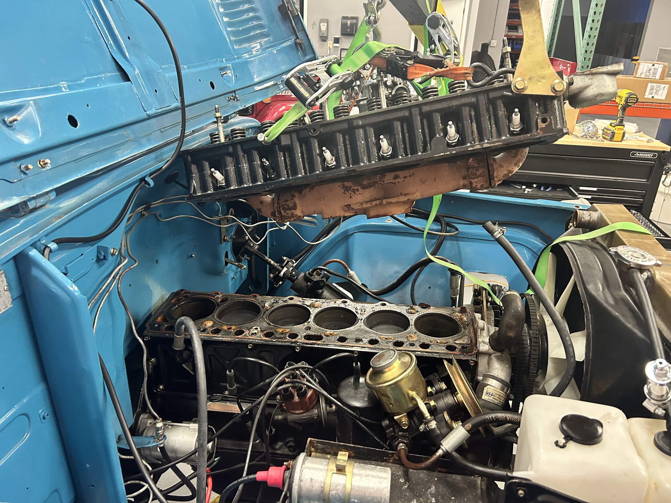

Thanks Buddy. I am impressed with everyone’s knowledge. I am relieved. I am fine with the aftermarket hard top. I started poking around it yesterday and someone did an amazing job restoring it. I got it for $18k as it wasn’t running. The dealership did deceive and said the compression on all cylinders was fine. I got it running yesterday and found it has a blown head gasket Easy fix. I can’t wait to drive it. Just love the extra length. I have a Large Rottweiler that also loves Cruisers.
Yep that's a big boy. If you are happy with what you paid, and you can get plates/insurance for it so you can drive on the road then I think you did ok. I would chase the head bolt threads in the block Tap should be like $20 or so. Inspect all the freeze plugs now while you can.

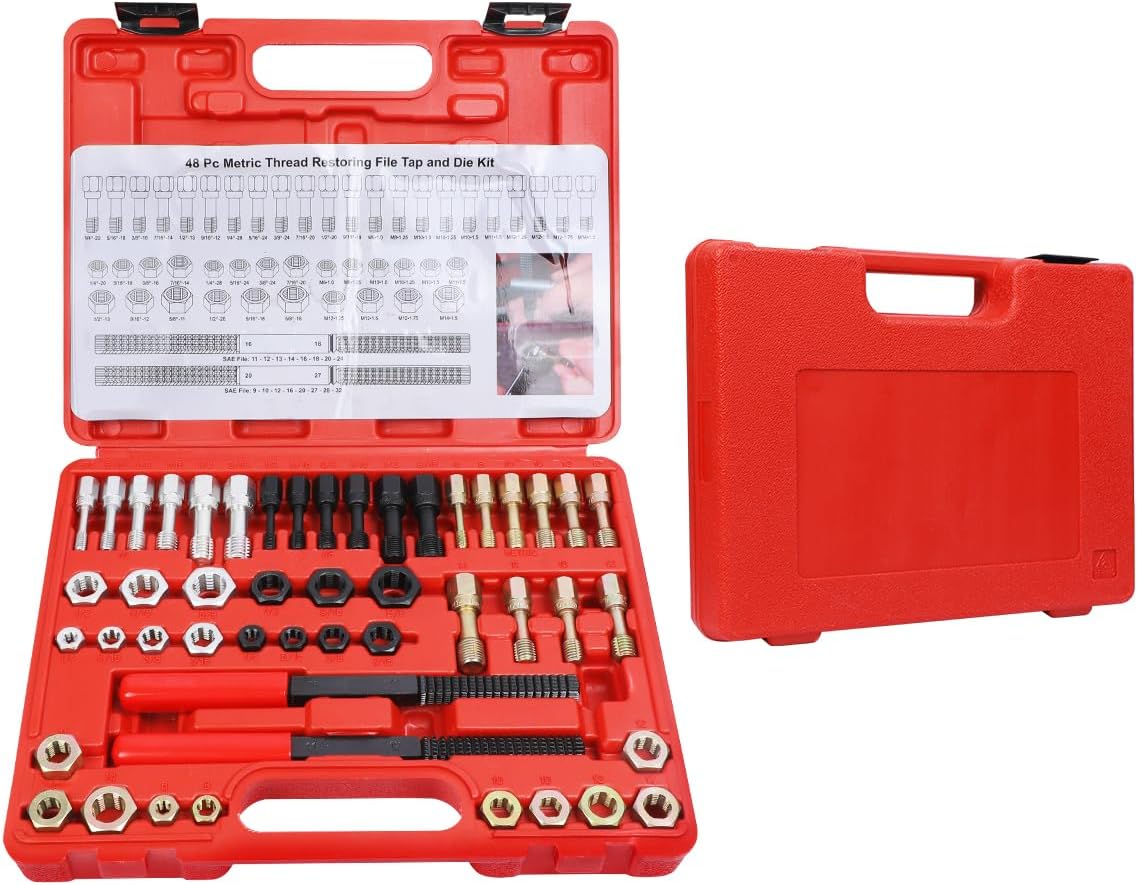

DON'T use a tap. Invest is a set of thread chasers.
The difference is taps will remove material making threads sloppier where thread chasers will reform and remove debris without removing material keeping threads tighter.
I have never had issues with quality taps cutting too much but then again I learned from gunsmith's and aircraft & power plant mechanics. Not sure what tool quality you get for a buck a pop.
