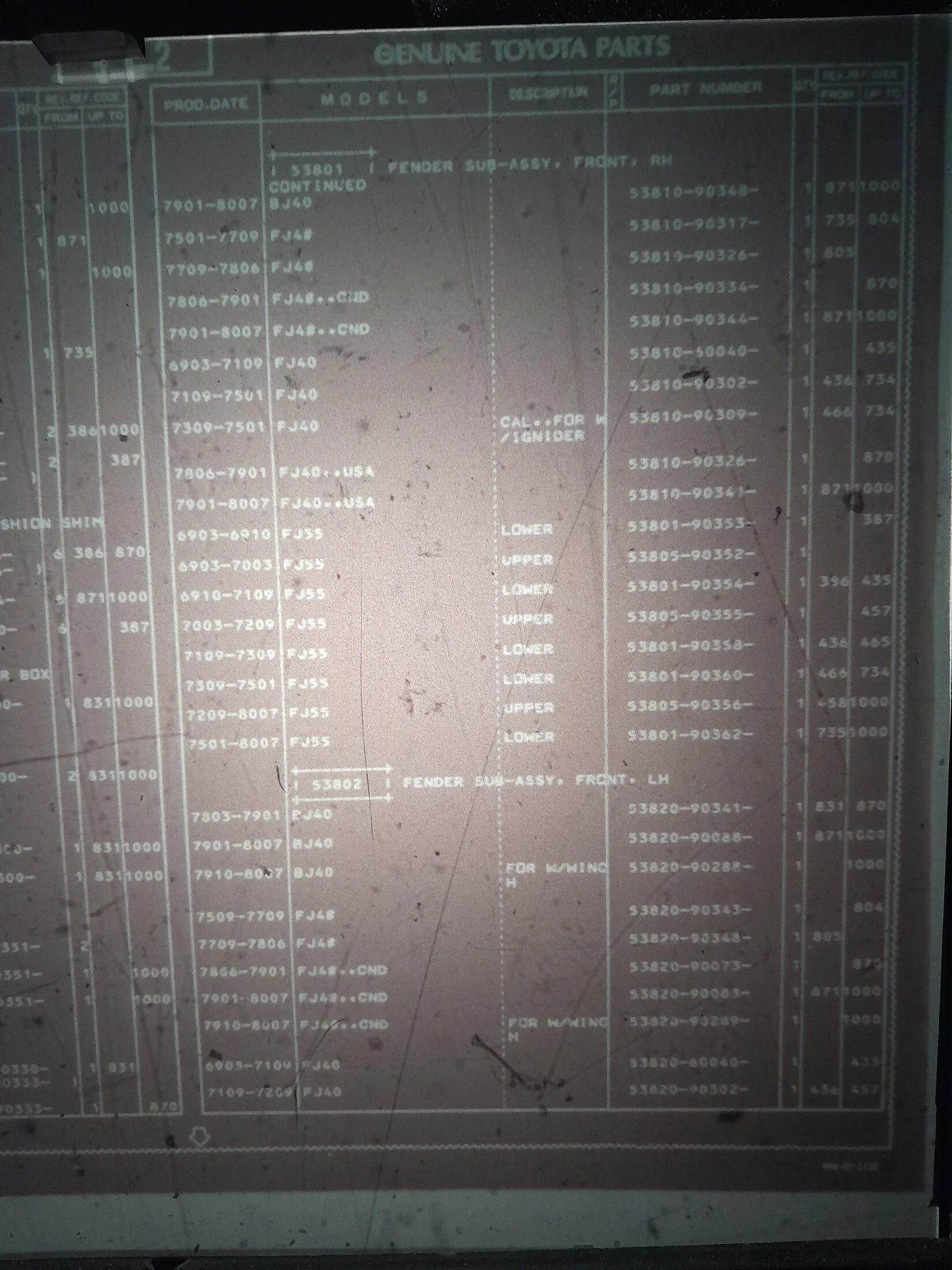

Cruiser Corps OEM Fenders 1958 - 1984 is what they advertise, aren't there some differences from year to year (see picture)

Cruiser Corps advertises OEM fenders 1958 - 1984. I know they are all same basic shape but aren't there some differences year to year.
I am helping a friend with his 1979 FJ40 restoration. If these will fit without modifications he is going to buy them.

All OEM fenders have now superseded to two part numbers still available: RH/LH.
Make do or pound sand. That’s the answer now.

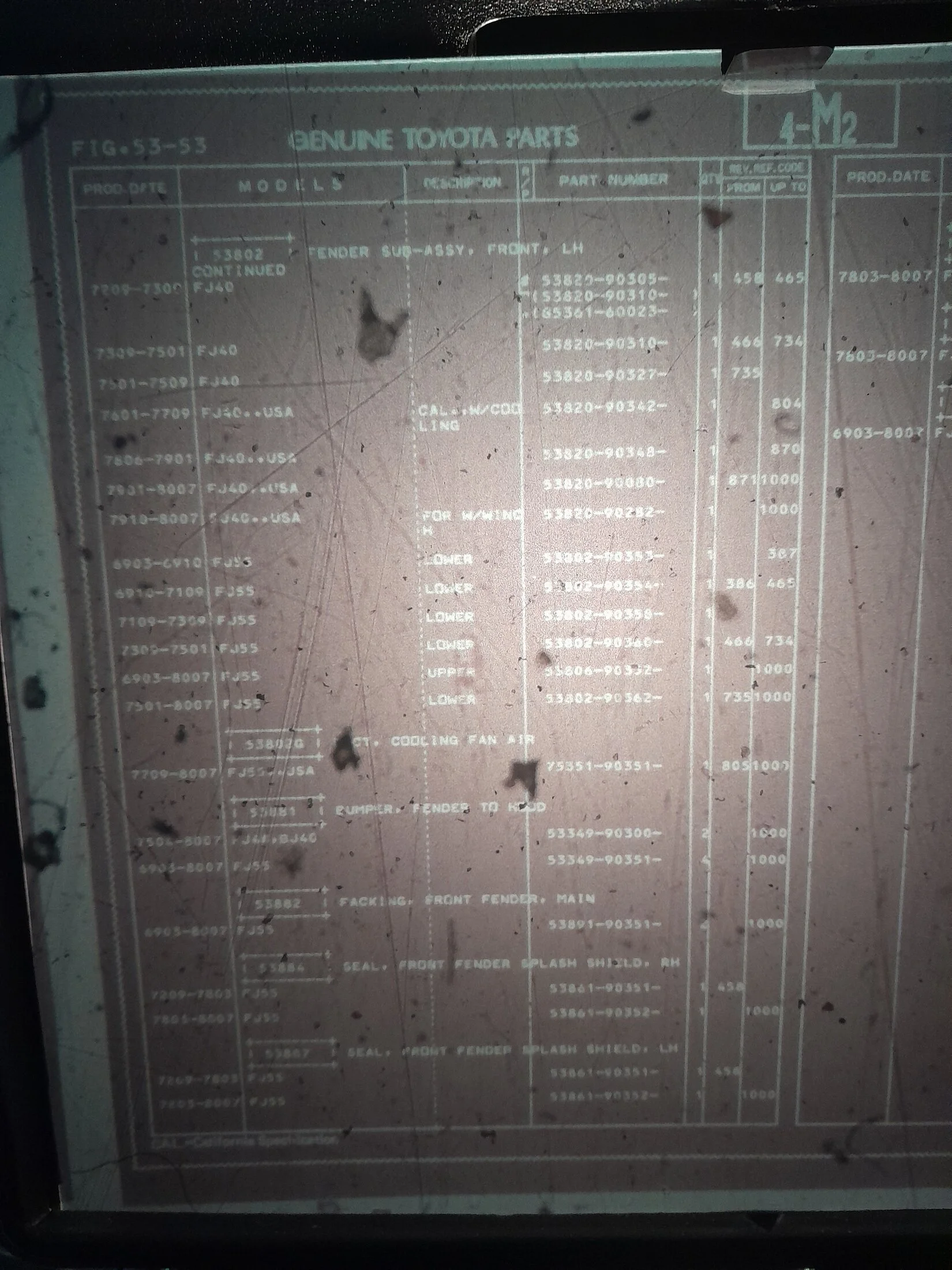

Visually the fenders do look the same, externally, for the production period, however there were enough changes to warrant the many p/n changes. Possibly mounting hole or mounting bracket placement changes. See the p/n changes in the attached pic from my microfiche set covering the US and Canadian market from 03/69 to 07/80. I bought a set of new OEM fenders a couple of years ago from Patrick (dieselbj42) with the p/n's shown in the attached pic. Not sure what year/years these fenders are used on the FJ40's, but it had to be after 07/80. As OGBeno indicated above, this is all that's available.
