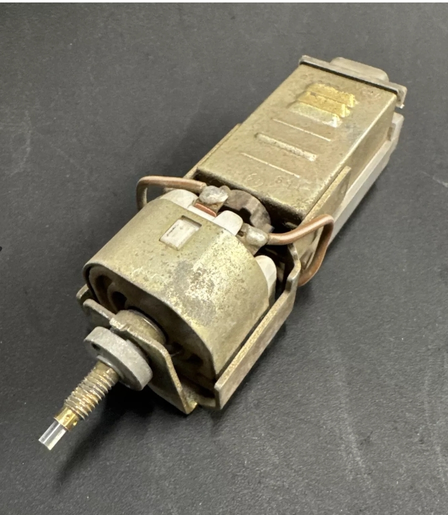

I pulled the headlight switch and cleaned (with vinegar), the contacts as well as the dimmer rheostat that controls the lighting on the cluster illumination, the light behind the headlight swutch (illuminates knob) if you have that option, and maybe the under dash light.

Where is the dimmer rheostat? But i’ll get out the Haynes manual in the morning

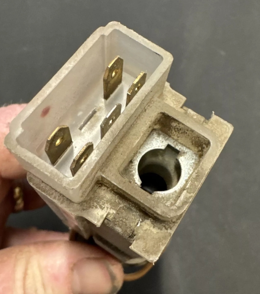

Pull the headlight switch and if yours is like mine, you'll see it behind the knob, a circular coil with a brass wiper.
