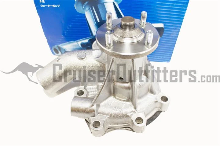

@cruiseroutfit, it looks like the one that I need (1977 FJ40 with fan clutch and no oil cooler) is Part# EGW61070 (Fits 8/76'-1/79' 2F W/Out Oil Cooler) - $105.50. Correct?
Sounds right to me
EGW61070

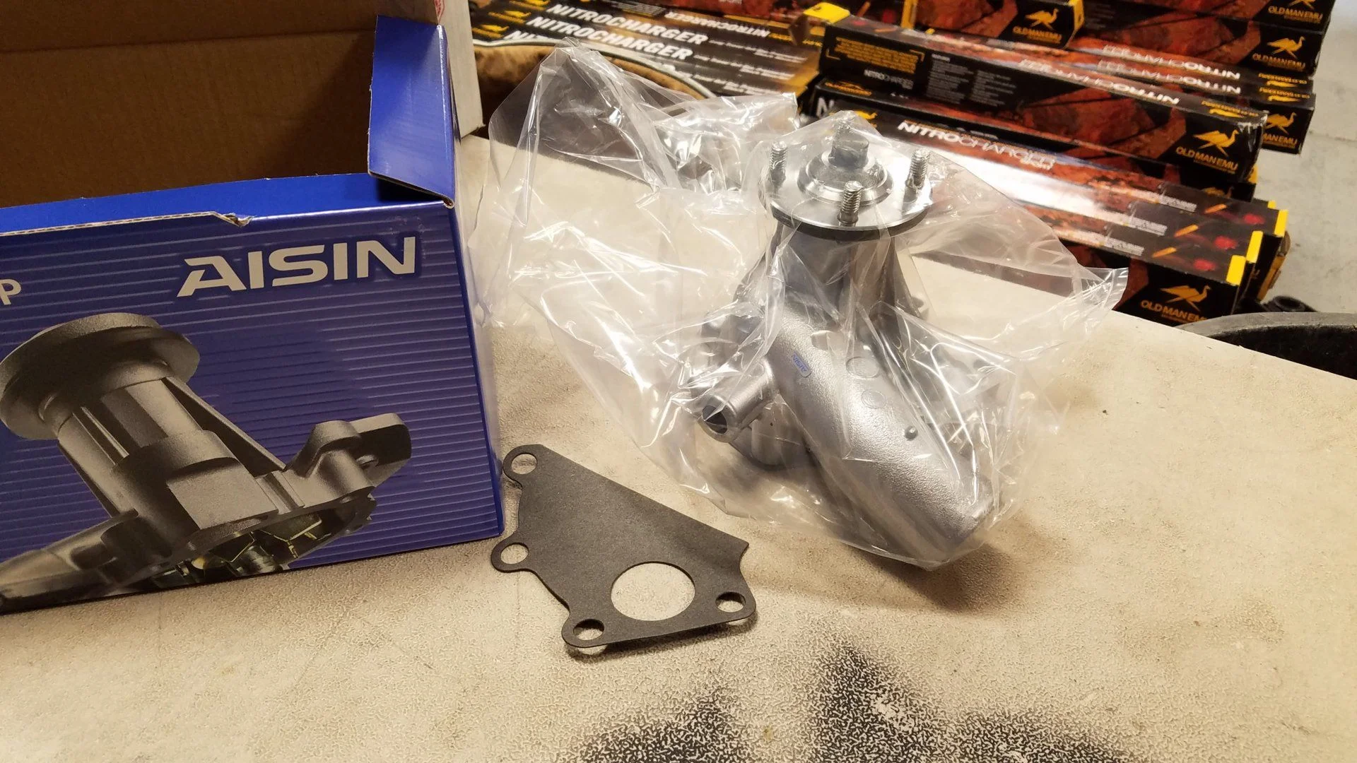

@cruiseroutfit, I just placed an order for the Aisin. Airtex is leaking again. Cant wait to go back to OEM.

Any chance you have a second one on the shelf? I also have a 77’ without oil cooler. Let me know and I’ll send payment.
You betcha!
Give us a ring (801-563-1277) or shoot us an email (info@cruiseroutfitters.com) with your shipping address and I'll calculate a total for you. Thanks!
